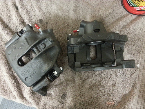

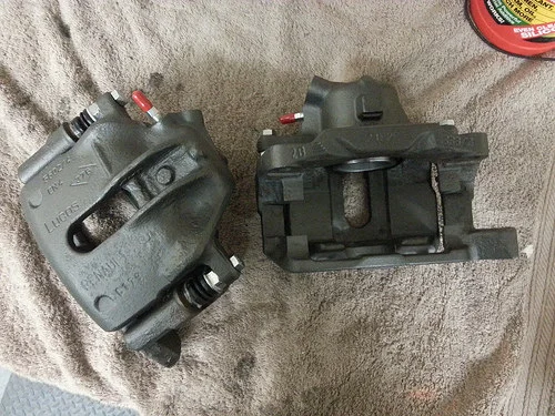

Full Front Caliper Rebuild Kit

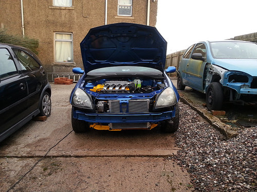

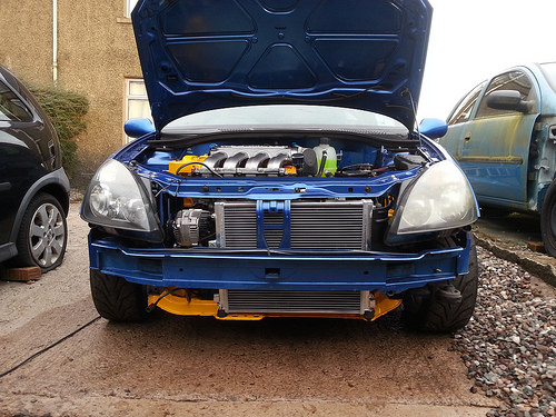

Update
Finished off a load of bits today, got the car moving for the first time in months. Still need to get the alternator bracket made up, some cable ties held up for now :wink: Brakes are all on and suspension built back up. Really happy with the result of the brakes, look brand new.
Not much to do now before MOT, on a downside I'm going to need to replace the gearbox 5th cover as its leaking! Raging as i wish i just replaced this when it was all out.

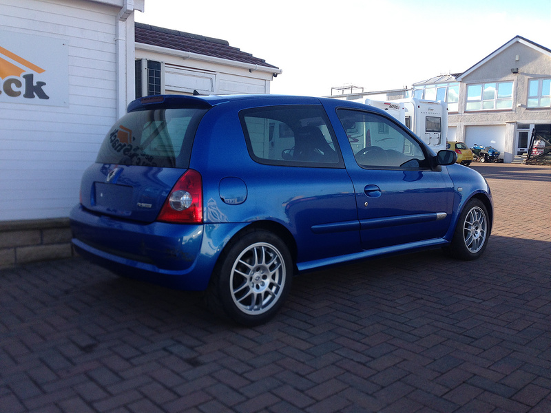

20150203_212244
by Arran Bell, on Flickr
20150207_154831
20150207_154842
20150207_155257
Was really pleased with how it looked in the sunlight, shows off all the newness better :smiley:

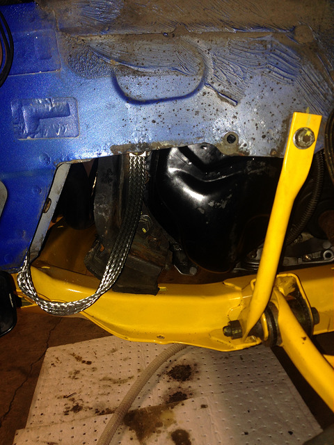

Not done much as of late due to being away with work but got a day on the car yesterday.
First was to set about fixing the leak coming from the 5th gear cover on the gearbox. Ordered one from Adam along with a new earth cable and set about fitting. A bit awkward to wiggle out but managed by moving the lower gearbox mount out the way.
Untitled
Still getting the electrical light on with limp mode, can't figure out whats causing it!

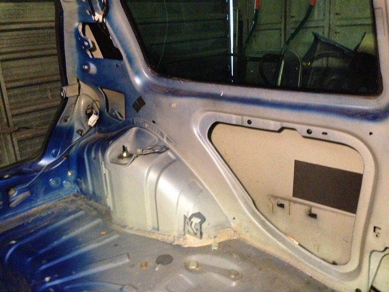

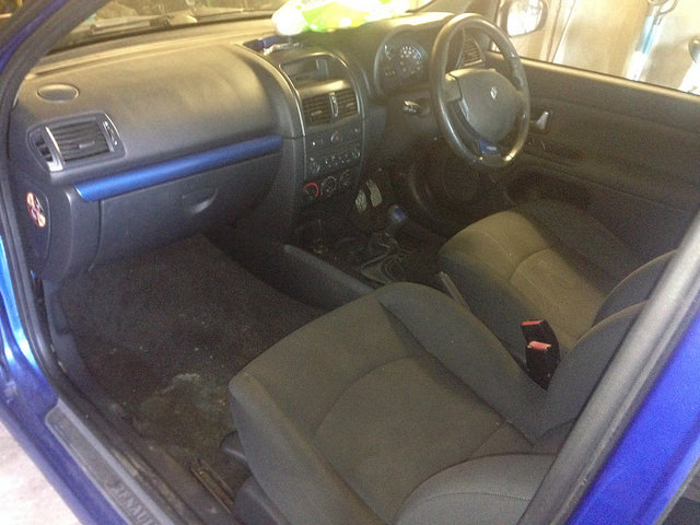

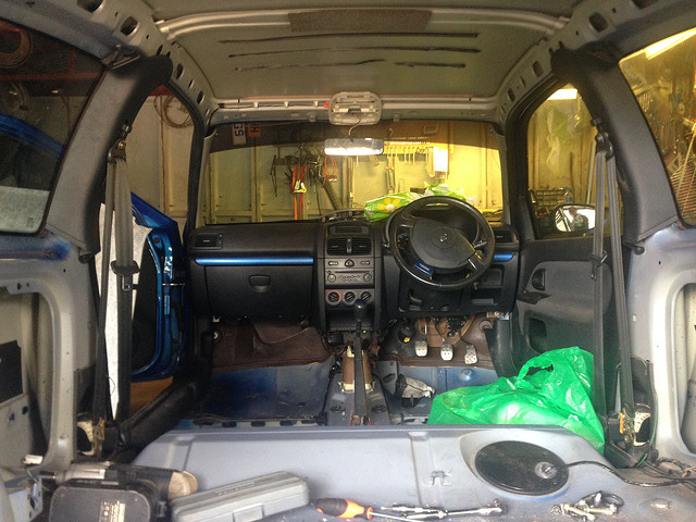

Next up i decided to go a bit destructive and start ripping the interior out, so much fun 😂
Started off with this:
Untitled
To this:
Untitled

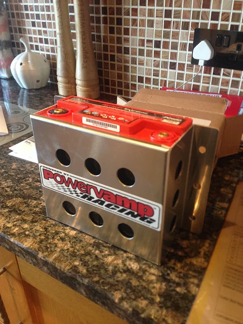

Along with all the wiring/fuses etc to relocate the battery which will be going under the passenger seat.

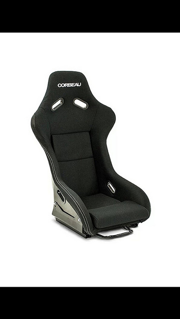

I'm really liking these cheap seats that Corbeau have brought out, similar to the Recaro pole position. Are they FIA approved, would you consider a swap for one of them when you get it for a nearly new Corbeau Revolution to use as your drivers seat. I wouldn't mind changing my passenger seat to a non winged version and they both have the sawn stitching etc.

Yeah they seem cracking for the money, £300 for the pair however not FIA approved that'll be where the price drops. Perfect for me just starting out getting the feel for it all still. I did look at the Revolutions but i think i prefer the smaller seats, as assuming you'll need FIA approved anyway?

Yeah you cannot complain at that price. I will be using it as a passenger seat only for pax laps, do they come in XL etc too and do they come with sidemounts etc? For the future you don't actually need an in date FIA seat to go racing, it just has to have once been in date, whereas the belts need to be FIA approved and in date. Same applys to extignuishers, they can be re calibrated and some scruts will let you race as long as the pressure gauge is in the green.
Yeah it will get you buy just fine.
Fitted in the Mrs cup on wed, good seats like, come with side mounts and runners for £300!
Greeny.
  440i + 182
I have one of these seats, brilliant for the price tbh, just removed it off the sliders and lobbed them on shitty OMP mounts.
Rubicon_
  L110, RS6, Westfield
Yeah I got mine in XL mate and they seemingly come with the side mounts and runners too. Never knew that with the seats, good to know!

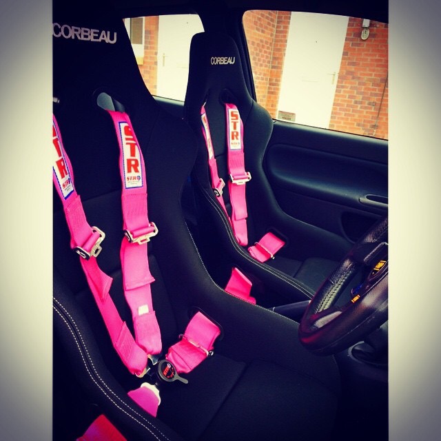

Sweet! Straight forward enough to fit?
Rubicon_
Don't like being to tight, I'm 34" waist and been told there snug with 32".

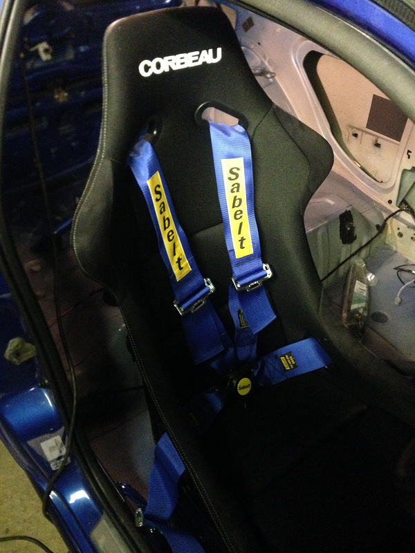

Delivery today!
Untitled

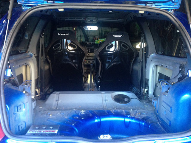

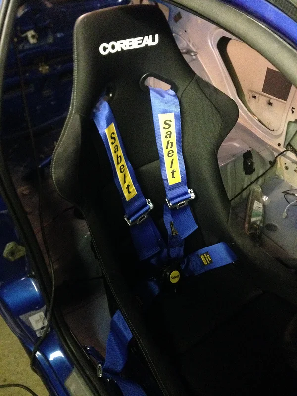

And the seats threw in, still to bolt down and get harnesses. Excuse the poor photo was too dark at the front! Glad i went for XL! For reference I'm a 34" waist, i think the standard would of been too tight.

I also received 3m of 25mm cable and some earth cable for the battery along with a junction box and mega fuse so will get that fitted soon hopefully along with a kill switch.

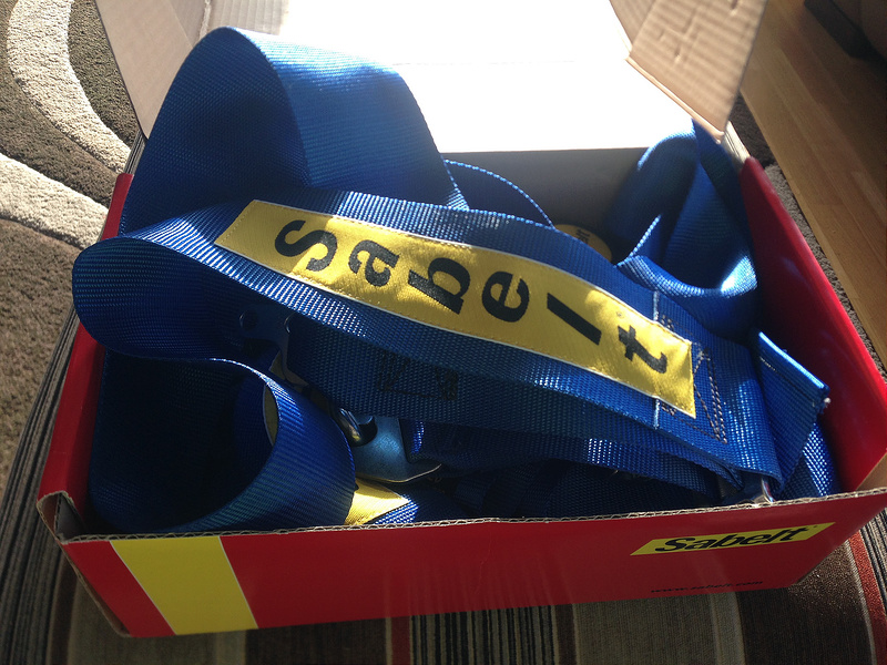

Harness arrived, matches the colour scheme perfect :wink:
Untitled by Arran Bell, on Flickr
Spent a while wondering on what way to mount it all but in the end went with a way I seen @Sir_Dave describe in another thread with the Schroth bracket and a couple of extra M10 eyebolts, so thanks Dave!

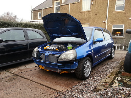

Spent the last couple of days finishing off little jobs on the car, inner tie rods + ends, Aerocatches, steering rack loop and a few others.
Took it out the garage first time since it arrived last year, first thing I noticed was how hard it was to manoeuvre at low speed with the pas removed lol anything above walking pace is perfect so I can live with it!

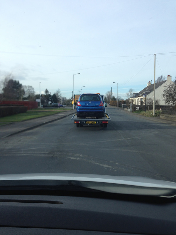

Anyway, got it picked up and delivered to my local garage to get the battery wired in and get an mot. I'm away working for a month so once im back it should be drivable :D

Have you driven it since you stripped it? I took out the spare wheel on mine once and immediately noticed the difference so I can imagine ripping out a full interior would be awesome (if loud) especially at low revs.
Rubicon_
Yeah it's very loud mate heard every little stone hit the car etc lol It's not a daily though so i can live with it, it's actually ok though.
