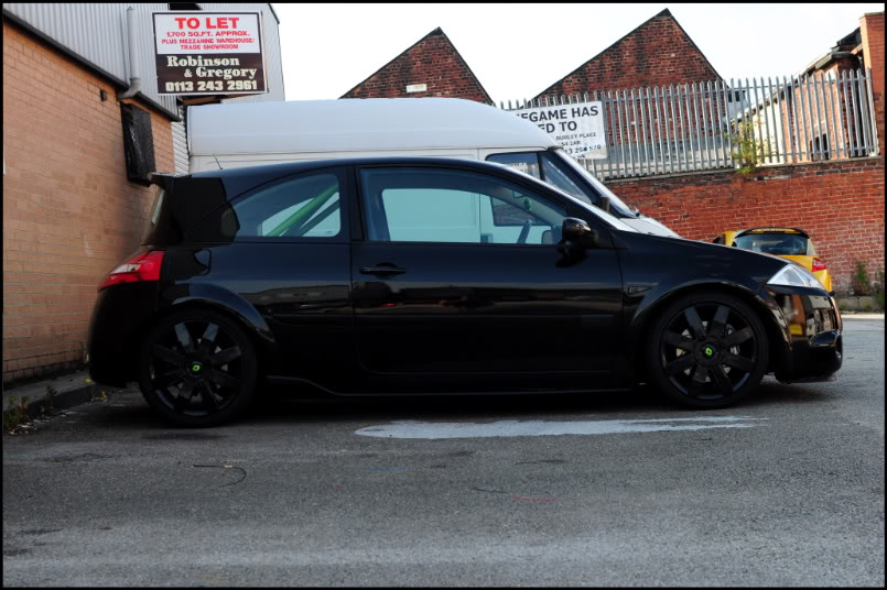

looks good with the skirts, do they fit well or have you got to do abit of chopping to get them to fit and are they the same oens as the the 197 has? mr 'if its carbon it has to be real' ;)
whats that meant to mean?! just because they have a mild cf effect, can you even imagine the abuse they'd take, i fitted these for no other reason that they look mean as hell and lower the centre of the car ridiculously.
they arent easy to fit really and require cutting, i guarantee you'd fcuk it up. ;)

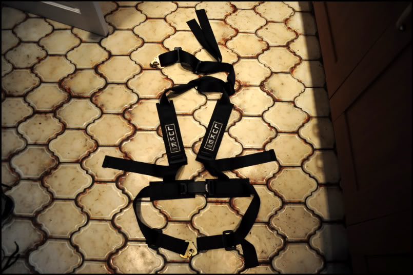

I was going to make a little thread about some nice little harnesses I bought ofF brown bear ready for some buckets when I'd saved for a month or so...
but in true renaultsort style i took it to the next level...

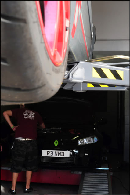

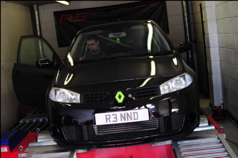

after some messing about and finishing off some other cars i got on the dyno.
the coilovers arent set 100% and the car needs the corner weighting sorting out again as on the dyno she was pulling all over, something I can live with as I knew it needed sorting out.
so onto the dyno...
first run... the car makes stock, on a stage 2 map... Paul looks worried, I thought he was joking. he tweeks and plays and asks how old the sparks are, old enough is the answer, so he bungs some of his own in to check, this instantly raises the low end power but again the car hits stock. So at least the sparks need changing regardless of the little problem I was thinking, little did I know...
then we move onto the cambelt, it hasn't been done in a while, I was shown receipts for it being done when I purchased the car and that was four years ago, it needs changing asap is the answer to which i agree and know i need to sort as it might be the timing thats out.
Exhaust issues and turbo failure are also ruled out.

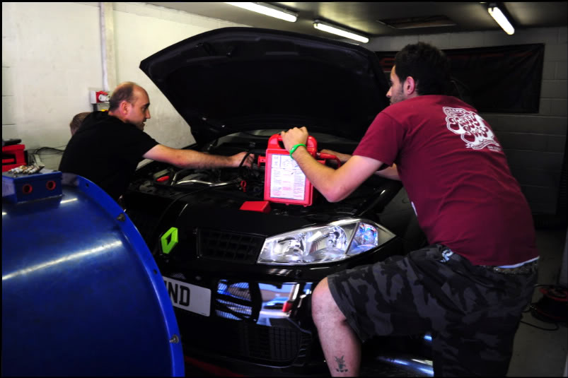

Paul wanted to rule out other things so he attached a booster to the battery and did a compression test with Wade (Hughesclio) who happened to be there at the same time.
cylinder 1: 130 psi
cylinder 2: 150+ psi
cylinder 3: 140 psi
cylinder 4: 70 psi
And there in lies the problem, the compression on cylinder four is low, as in LOWWW. thats why the car has never made the power a stage two would and has/is gradually losing power, the severity of this shown by the fact a stage2 map (one that has been tinkered with for ages) only gives the car stock power.
The car boosts at 1.3 bar and is still making over 30 ftlb torque so the turbo side of it is fine. Paul put the map up from his R26R and compared it to mine, the similarity between the maps was scary, they were exactly the same minus the fact mine was 55bhp down on his, but the curve, drop off and boost were identical.
The general consensus is that there might be a water ingress into the cylinder head, as the car is losing coolant slowly (dumping the tank at Oulton in January, but only slowly since) something to do with it creeping into the chamber through a gap. Also one spark was discoloured and paul was certain of water present, along with mild frothing in my coolant tank during all the checks (no idea what it means, but it means something bad). in pauls words... 'its fcuked naithhh' :(
