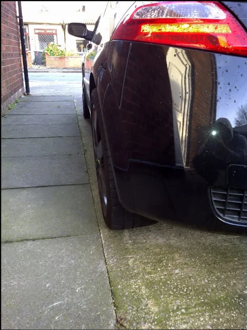

on the way home i was driving along normal, exited a roundabout, warren about 100 metres behind, straight road and felt nothing like it before, the car snaps violently to the right like its swapping ends, the wheel had locked itself against the brake and with instantly felt like rear suspension failiure lifting the front N/S the back slammed into the curb..
now i'm no Alonso but I can pilot a wagon as well as some, but there was nothing i could do... I pulled continued for about 50 metres saw a locked tyre and sparks...

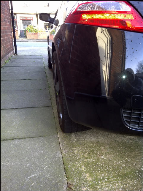

monday morning, lets have a good nosey. from -1.5 neg camber to plus 4/5. nice. (luckily i'm after some very special rims that hopefully will be ok to use..)

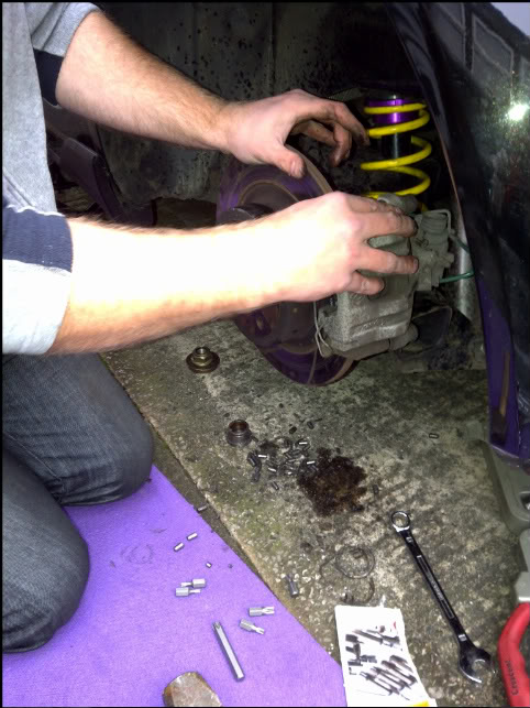

I asked around on the sly, the general consensus was the axle needed replacing, I obviously thought (maybe through hope) that it was just the bearing that had gone inside the disk. So this morning 'mat-nos' comes over and we strip the rear down.
At this point i'd like to thank renault for building cars and assembley that have about 6 combinations within a wrench and allen key set for a single applience (the rear brake unit)

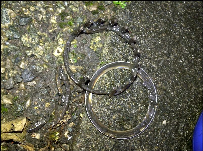

yes thats the bearing internals on the floor :(

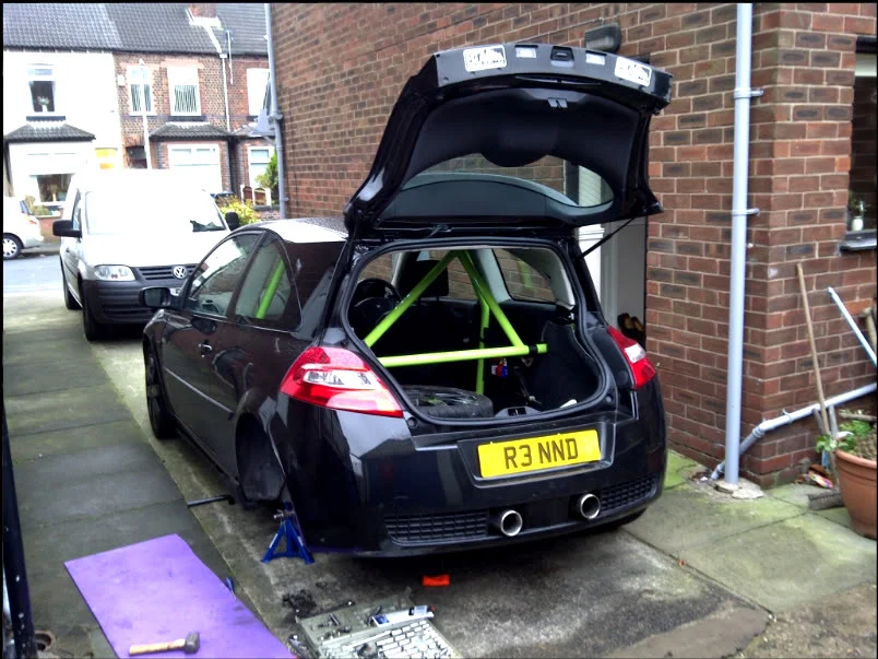

we stripped the rear assembly down with alot of cuts and trips for tools to my local motorsh1tworld,

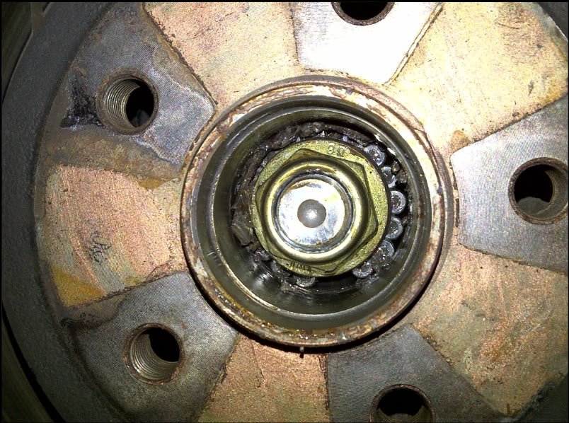

getting to the hub nut... it was not on tight, when i say not tight i mean its most probably the cause of the bearing moving about and causing it to fail, I now know its the bearing that failed as upon pulling the hub nut cover off the bearing internals fell out like sick. We eventually got the caliper housing off too and the disk, which considering the impact and the ABS marks is in good condition (obviously bar the bearing it houses).

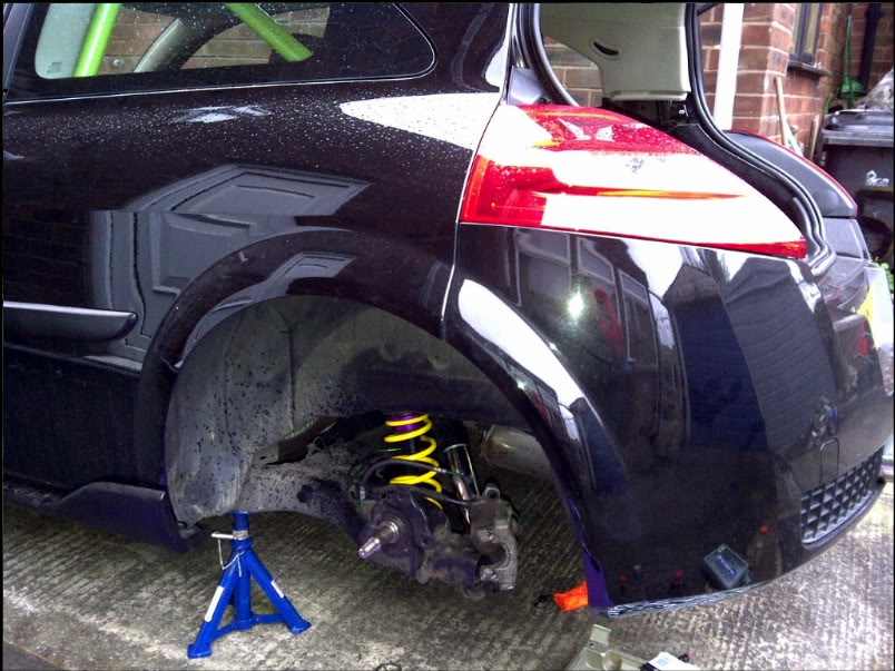

In theory we could press the bearing out and have a new one put in but for the price and safety of a new disk housing i'll just get a new disk ordered in, im hoping the Stub Axle isnt bent, on first impressions its hard to tell as the cars sat on an axle stand. For money and time more than anything I cannot afford it to be an axle replacement, but i dont think it will be. but I also dont fancy dying yet, so if theres a chance it could be mashed its getting replaced.
and here she is...!!1! lol, stub axle on show, sat on an axle stand with carrier bags covering the assembly, hardc0re.
tax runs out at the end of the month and whether its via trailer or slowly driven there she's off to Birmingham to hibernate, she's not coming back for a while... time to get the blanket out and say goodnight for the winter me thinks.

problem is naith i dont think its a long term fix by just getting a new disk/bearing as the failed bearing has worn a lip into the stub axel which means a new one might not fit as tightly, but at least it can go back onto four wheels and put onto a trailer... fred can make a call on the axel if its not visibly bent when it goes back together!!!
lol at not bringing the right tools then buying the wrong size bit..... FAIL on my partbut we got there in the end!!
