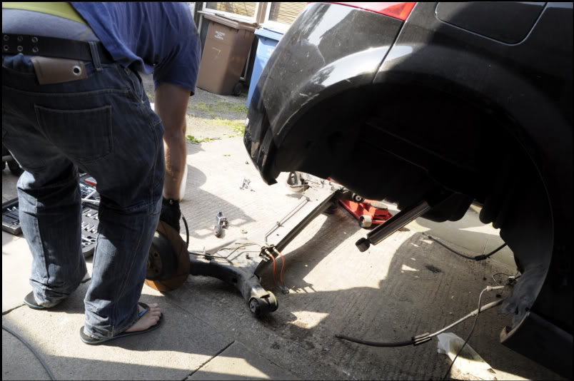

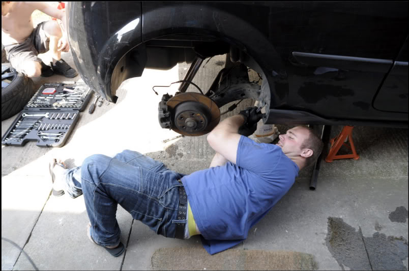

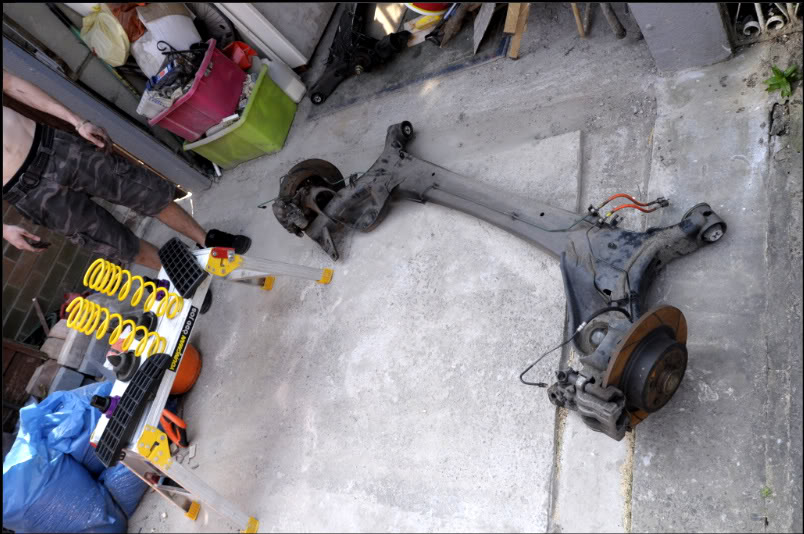

so with the new beam bought we set about swapping it over today to the new stub, axle, lines, basically everything. I say we, I mean mat-nos and 'curtis' who put alot more graft in than me, I was site forman i guess ;) excuse orange in pics and on the car, been having alot of house renovations done and the car is FILTHY.
the whole process took about two hours and as everyone got cuts and bruises we eventually dropped the old rear beam, arb and axle which had seen better days.

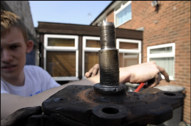

when the rear wheel went back on to see whether it was just the bearing that was knackered it showed (with about 3 deg of positive camber) that the problem lay deeper, beam off and inspected the stub axle shows the true story of the damage....

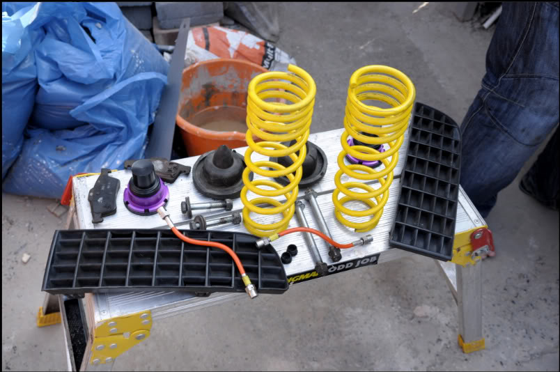

Anyhoo, all rear components were removed and the new beam tidied up. The braided lines will be added back onto the new one tomo after they've been cleaned along with the KW springs and dampers/adjusters. And hopefully the calipers are erm, given a treat :)

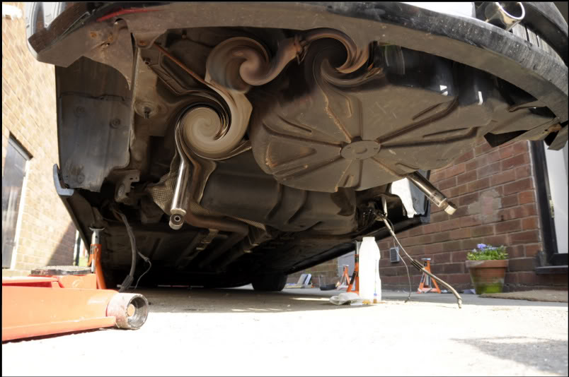

Anyway, the car will sit like this till sat morning when we add the beam back on, hopefully with new rear brake disks, the boot floor will be coming out too and replaced with a CF blank, to enable the exhaust to sit VERY differently...
I also thinnk it only fair to explain the exhaust seen as its asked everytime i'm at a meet, the in depth accurate pic is below

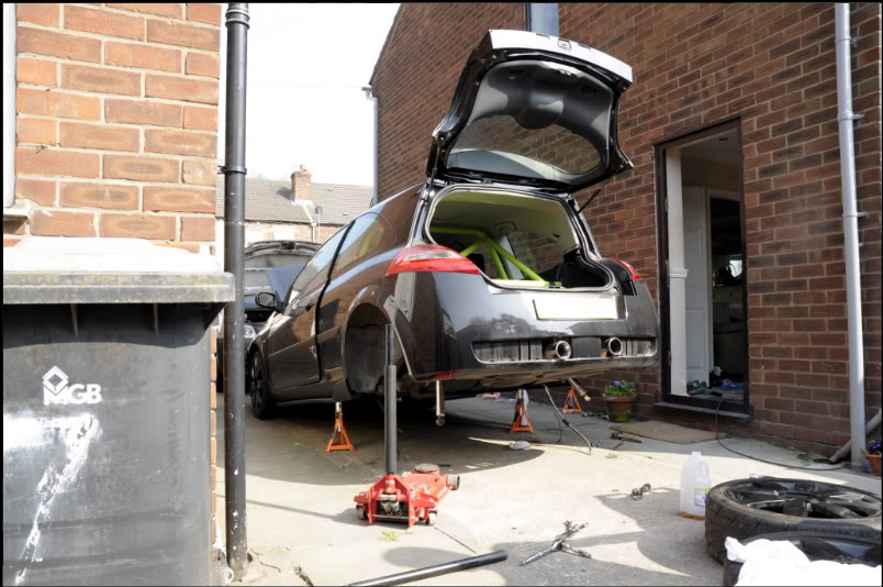

full new phase 2 beam is on, curtis! and mat nos to thank for their sterling efforts, all 4 hours work as it wouldnt sit properly uintill we got angry and erm how do i say this, beat it in...the temp left rear disk i wanted to run was also cracked in the bearing so bought a disk from BTM this week, well from renault via BTM but whatever... its fitted in this pic just didnt have time to get the caliper and brake assemblys on unfortunately.
going to build the brakes back up tomo, bleed them and get her dropped down. took the adjusters out from the back suspension so she'll look decked, not sure if i'll like it but its not hard to put back on so we'll see tomo....

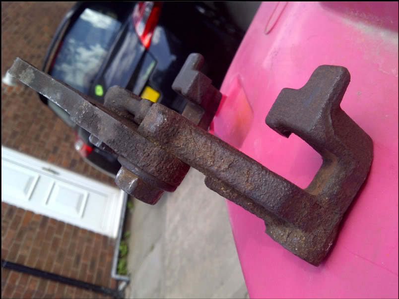

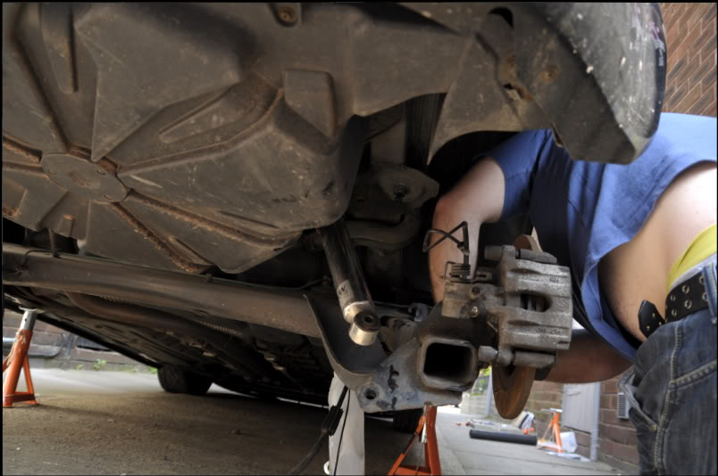

when the bearing failed and the wheel went the side impact mashed alot of things up, we thought all the parts had been replaced. the caliper carrier however is bent, fitted to the new disk it rubs on the top and is wide on the bottom which tells the story of the bottom of the wheel hitting the curb the hardest and bending it. looking at the pic below it was so fcuking obvious too...
i now have two options, i've emailed a guy on ebay breaking a 225 in salford, if he comes through then happy days as he'll be local. other option is a new carrier from renault, even after being 'looked after' it still rocks in at 80quid roughly. I'd need to soak the arms of the ajoining carrier and vice the bolts out too. whichever way i look at it, its a setback i didnt need. on the positive at least the new carrier wont be rusted up to the nines :clown:

:( gutted pal. Can you not just bend that one back? Doesn't look too far out.
Pink Salford Wheelie FTL :rasp:
i 'could' but tbh mate its not worth it, its the top bit thats bent, the bit on the left for those not in the know. it must of been a HUGE force to bend it like it has so i dont know if i fancy it catching during a high speed run, so to speak. Ive recently started trying to do things properly on the car too, sick of being a pikey! lol
