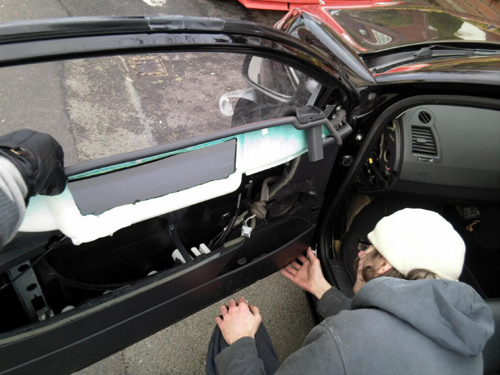

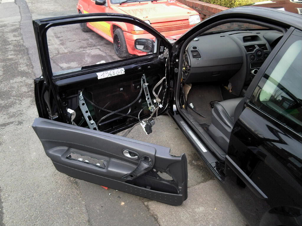

instantly taking a like to my polycarb window, we set about pulling the most awkward doorcard off in the world. i had started on sunday night but gave up... talk about a ballache. I imagine to a renault tech it would be easy but it was stuck fast...!
Winst was looking for more leverage as we had removed pretty much everything we could...
i got annoyed and ripped it off (which in hindsight was all we needed to do) :D

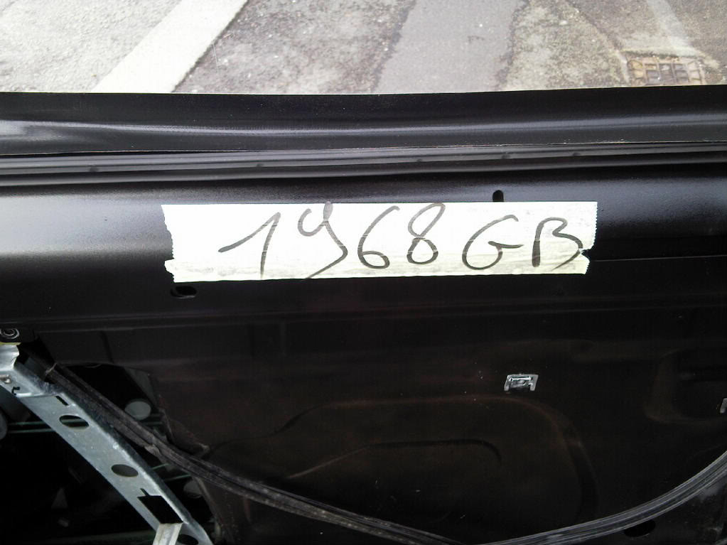

we wondered whether the car had a new door as there was a ghetto style sticker on the interior. you would never see writing in the UK like below (unless its my dad writing) and obviously the GB gives it away too... so yes we realised it was original and cracked on.

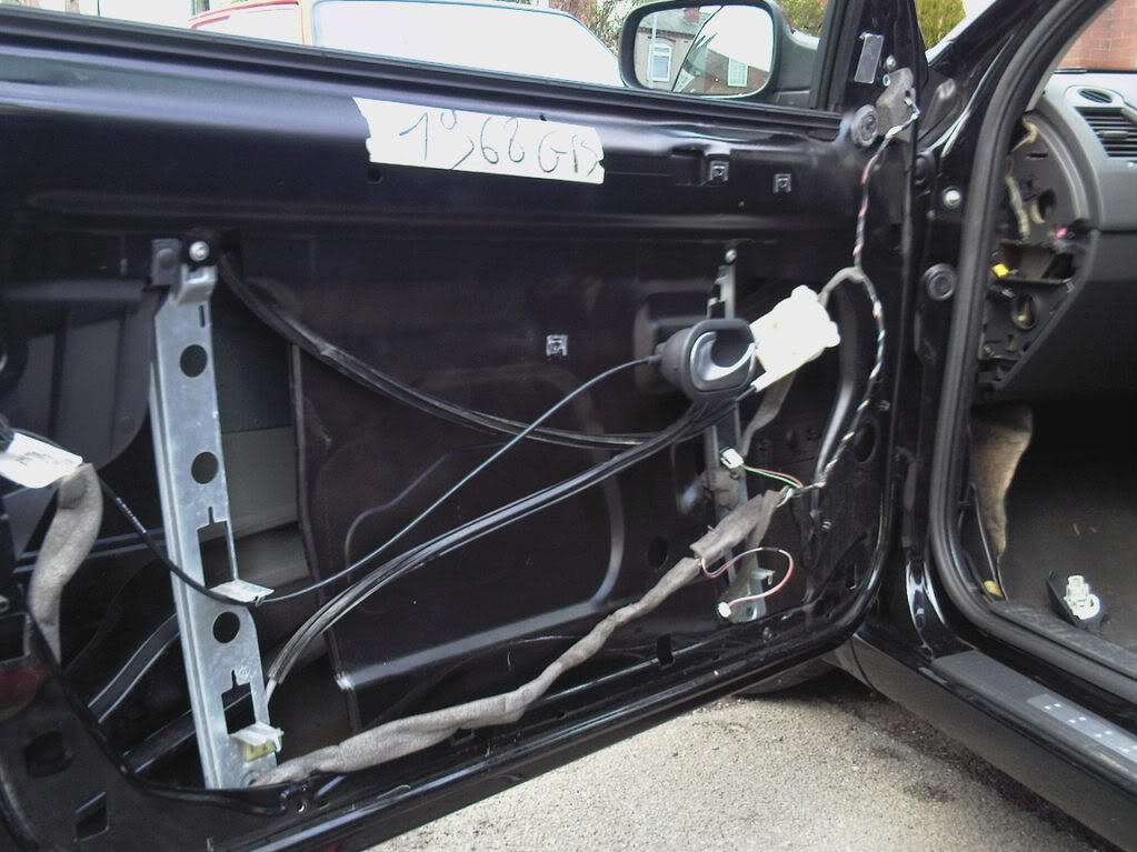

winston disconnected the motor, I dealt with the plug and plays and the whole doorcard eventually came off from the wires and connectors. As the motor in effect turns a wheel i turned the wheel manually whilst winston pulled the window up, it stayed up.
the car door basically looks like this now (minus the white box and thick wiring loom which is hidden)
The problem being now, I actually like it, carbon door skins with some of the parts put back in, maybe with manual winders? keep it stripped and use manual winders? put it back to OEM or electronics all in but with no doorcard.
all depends on what money I can muster and if I do any of the above (bar OEM) it will mean pulling the driverside out too. but this will need to be done as the regulator on the drivers has gone too... god bless renault!

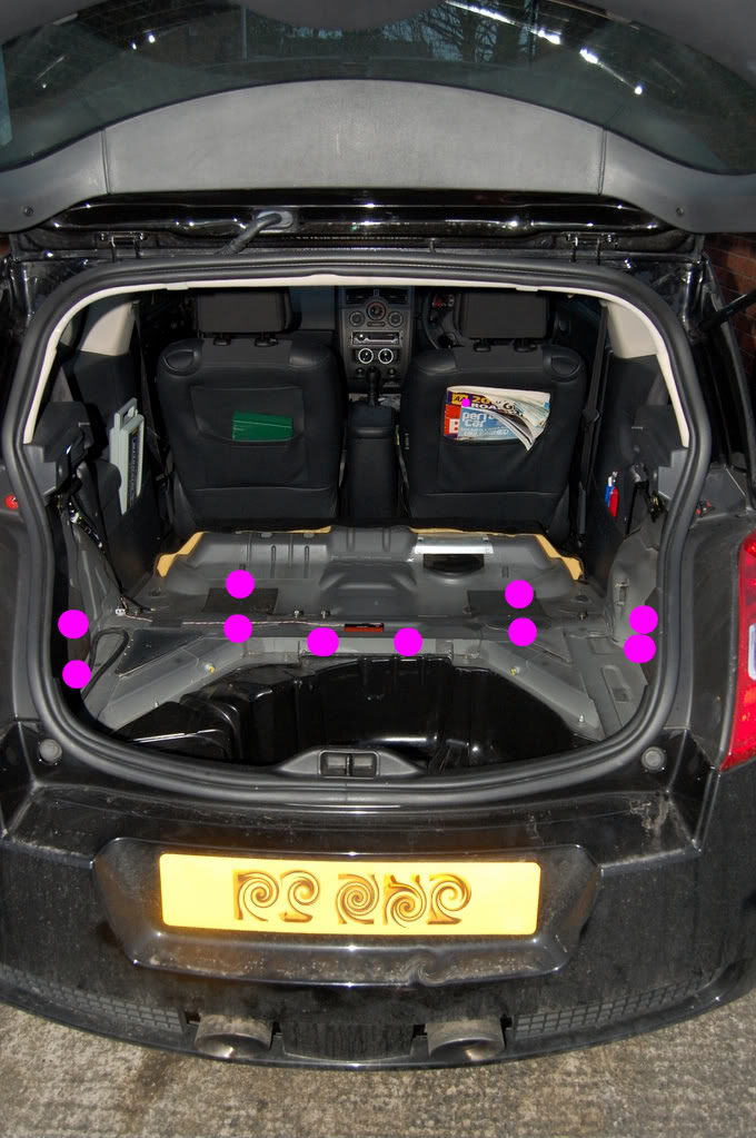

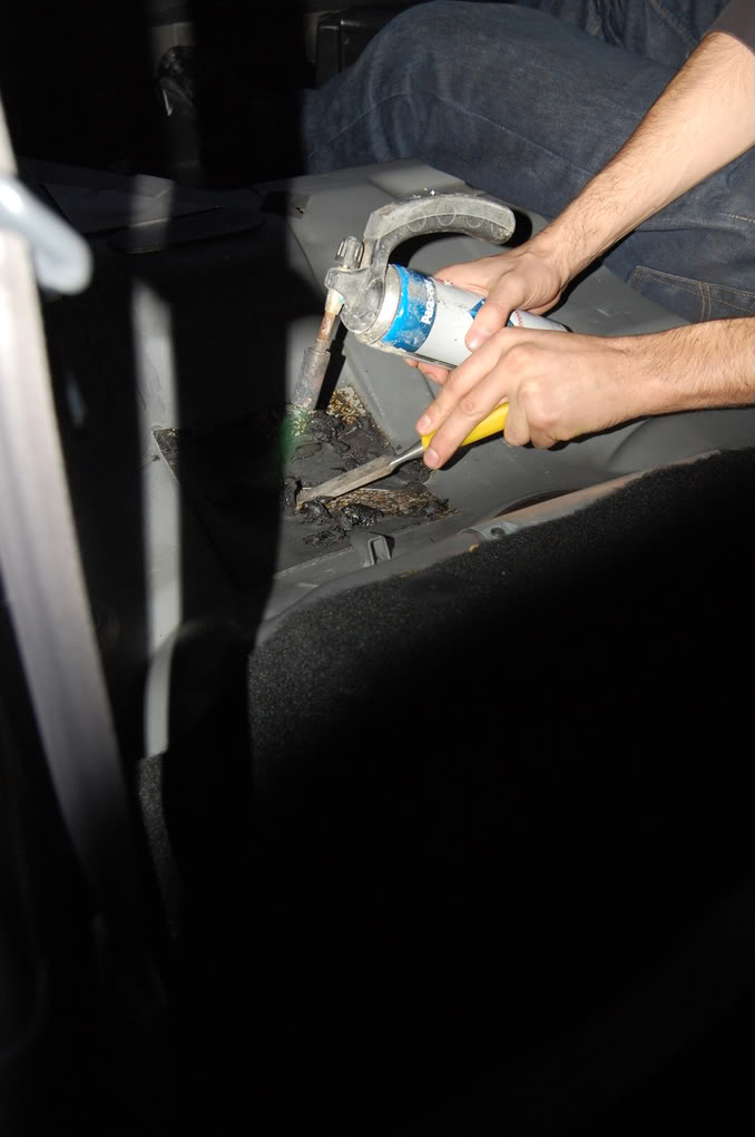

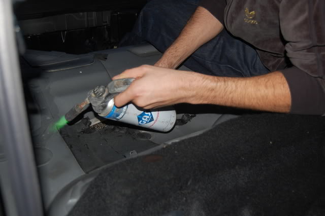

managed to get about 2KG of weight out just with all the sound deadening, not much but all adds up. ive made alot of inroads in other areas and still 50/50 on whether to remove a/c pump... ive used it twice i think tops!

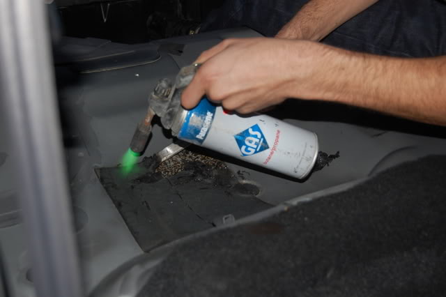

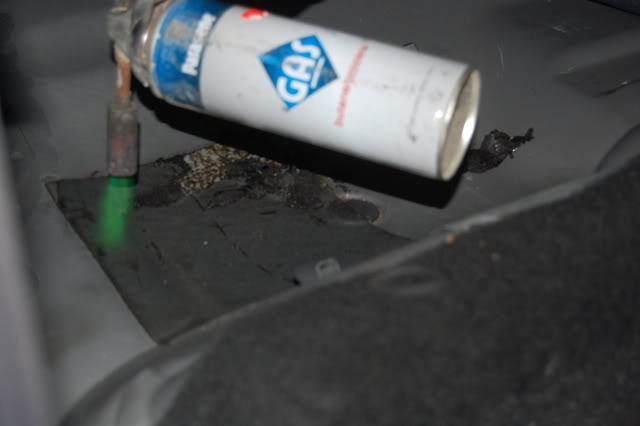

so today was just about getting the rear ready for a spray, mostly consisted of removing side rear carpet and blooming tar. a few foam coverings with hole in too (just into the chassis)
below shows the main points of removal today (purple dots), surprising how much tar was there in hidden areas, cars not exactly quiet anyway so its all out now

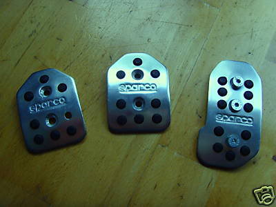

these also arrived today, nothing special i know but getting some sparco bits in soon so thought i'd spruce the pedals up as they look... 'used'
fitting tomorrow
Ali
  V6, Trackhawk, GTS
Pedals may be fun to fit...Depends where the metal is behind the pedal. IIRC you have to angle the clutch pedal to make it fit!
