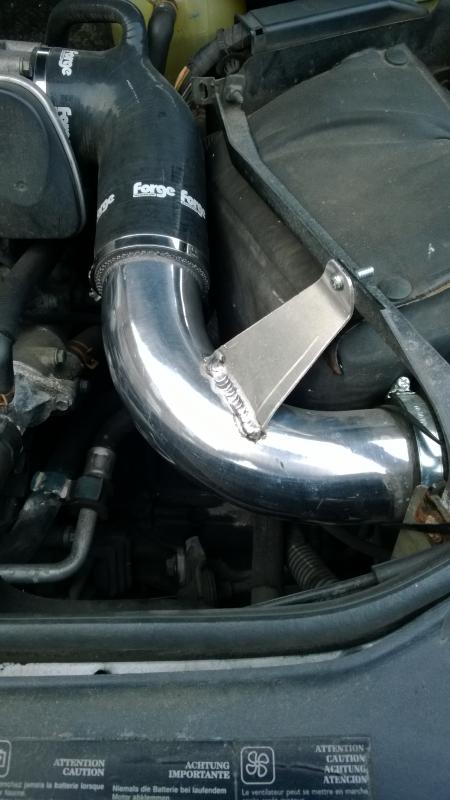

It's exactly the same parts as fatty except for a black silicone elbow matey. Can get a pic up later if needed
the filter you linked was a bit bigger, just wanted to see how it fitted, if you could get a pic would be appreciated!

My filter has just turned up. It looks quite small, well smaller than i expected.
photo? its should be 2.5cm smaller at the wide end (but the same at the bottom end), and 5.5cm smaller in length than the one in the pic? take a pic of it in the area it is going to go, you should be able to get it in there without is touching anything (which is a problem with the one in the OP as it got damaged by rubbing on everything).

fitting instructions btw:
(1) put filter in position behind headlight (and under the negative battery lead)
(2) connect alloy pipe to rubber elbow on engine side - don't tighten
(3) fit alloy pipe into filter, making sure you have the jubilee clip in place already
(4) line everything up then tighten jubilee clips
(5) secure filter around the jubilee clip area to car body with a cable tie
I took mine out whilst I had the front bumper off for something else, so you could do it that way too.
