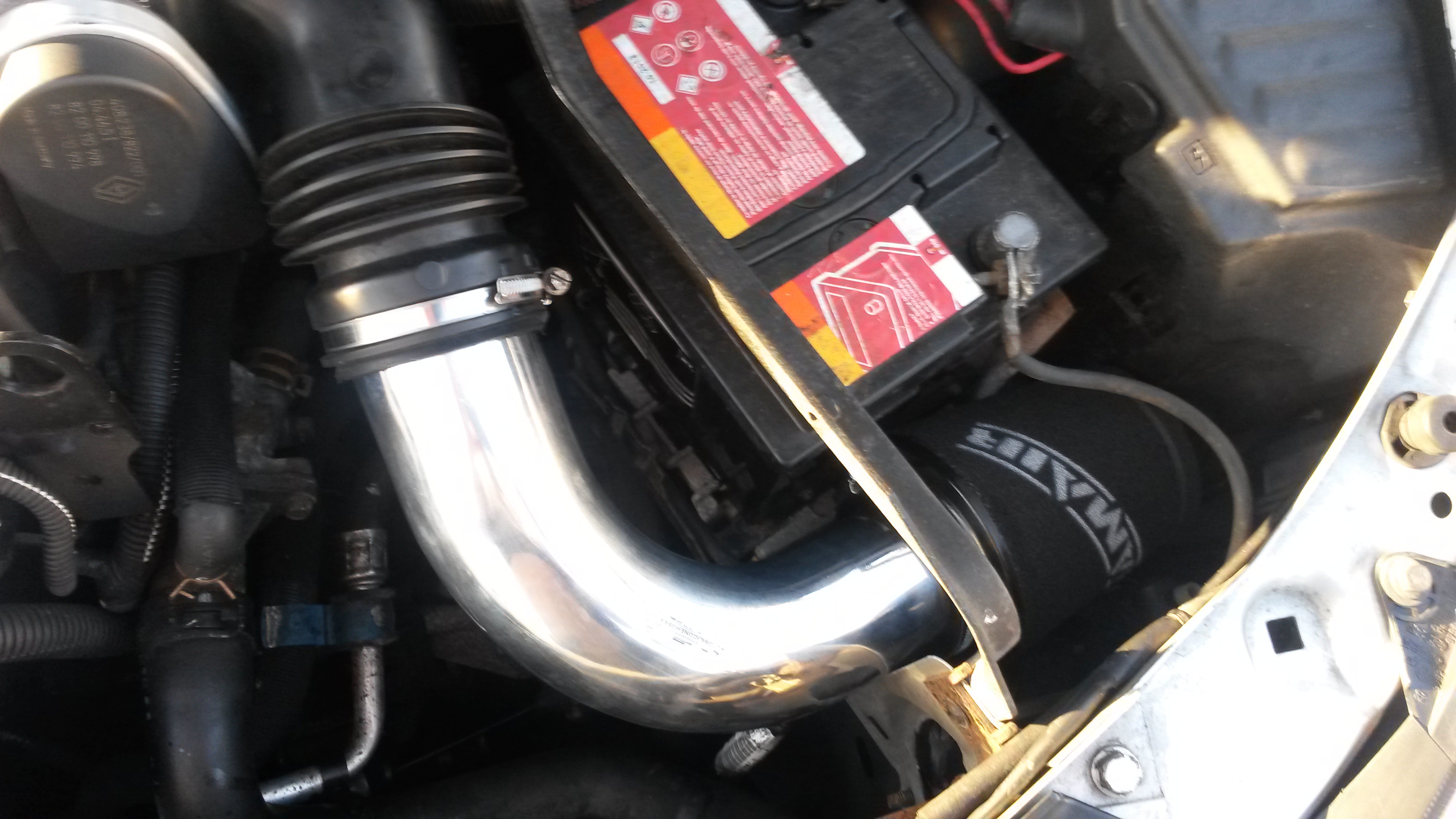

Ok so here it is all plumbed in.. sounds pretty good tbf.. seems to work well as suggested fits nicely behind the headlight, just need to get a cable tie

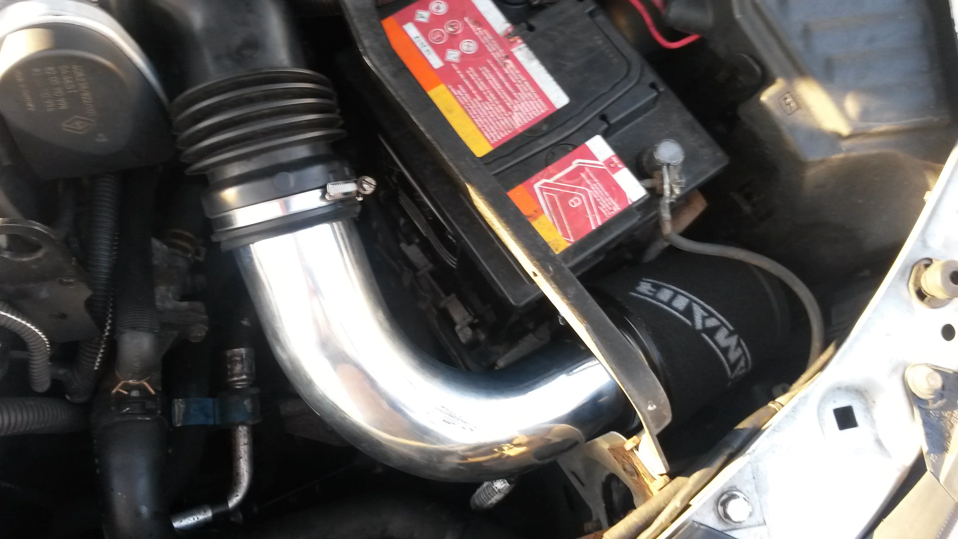

looks a much better fit that than mine size wise! Looks like you have the offset at the top though, if you turn the filter to the offset in near the battery and make sure the alloy pipe is a far in as it can go in the OE rubber bend, it should move things up just enough to stop the alloy pipe hitting the ECU bracket mounting plate.
