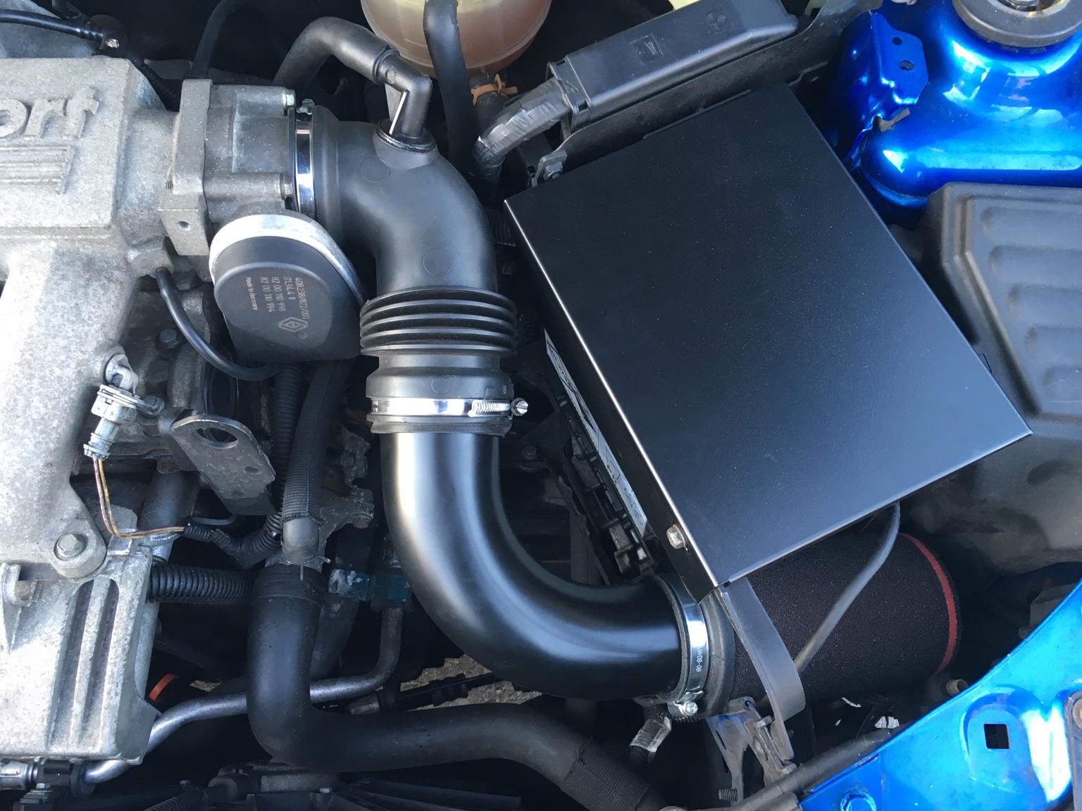

This is what I bought:
https://www.ebay.co.uk/itm/200967481273 (70mm external diameter, swaged ends, 150mm leg length)
https://www.ebay.co.uk/itm/390629059729
It all fitted together nicely and no other purchases were necessary. The filter came with a Jubilee Clip too, even though it's not shown in the eBay listing. I went for the alloy pipe based on looks and cost.

Oh and don't forget cable ties to secure everything, other than fabricating a bracket this seems to be the only way to keep the setup steady.

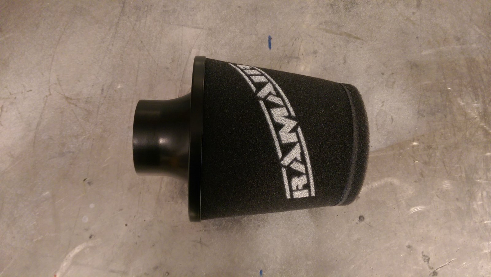

Did everyone use the filter they received that looked small!?
I ordered the CC-115 which is 120mm at the base and 125mm tall and it looks tiny! Wondering if it's being used without issue or if I should return it for the slightly larger one

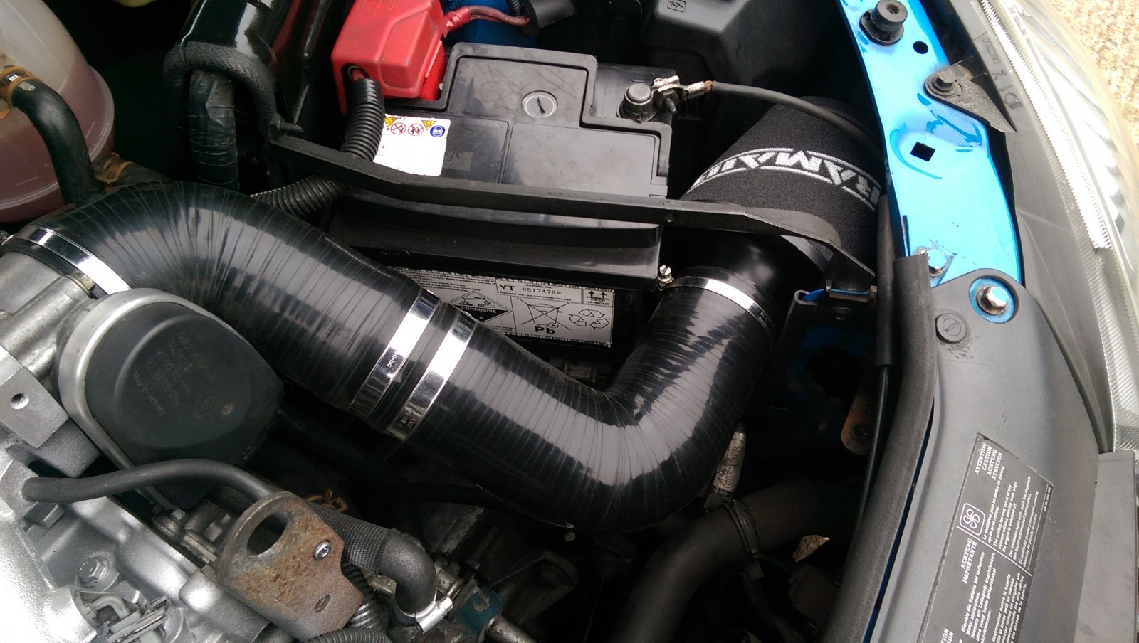

Guys I have really struggled to get the kit to fit. I went for a 70mm silicone hose rather than the solid one Fatty uses and the hose just won't fit to the existing bend and to the ramair filter. Has anyone experienced this issue?
Ol’ Tarby
  Clio 220 Trophy
You are gonna need some kind of joiner to fit a silicone bend to the existing bend
  182 FF
It has a neck. So in essence I need two number 70mm dia ally joiners and that will fit perfect to the existing plastic intake hose that goes into the engine and then one that then goes into the new filter
