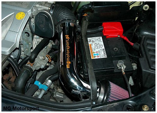

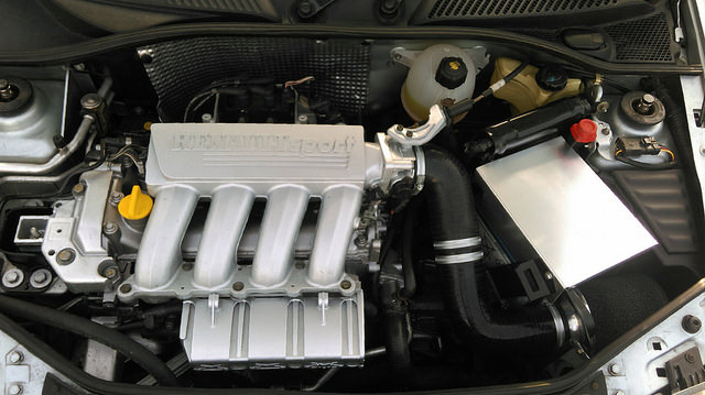

The Fatty's KTEC alternative induction setup that works just as well!
Also in the Netherlands is it a good modicication :smile:

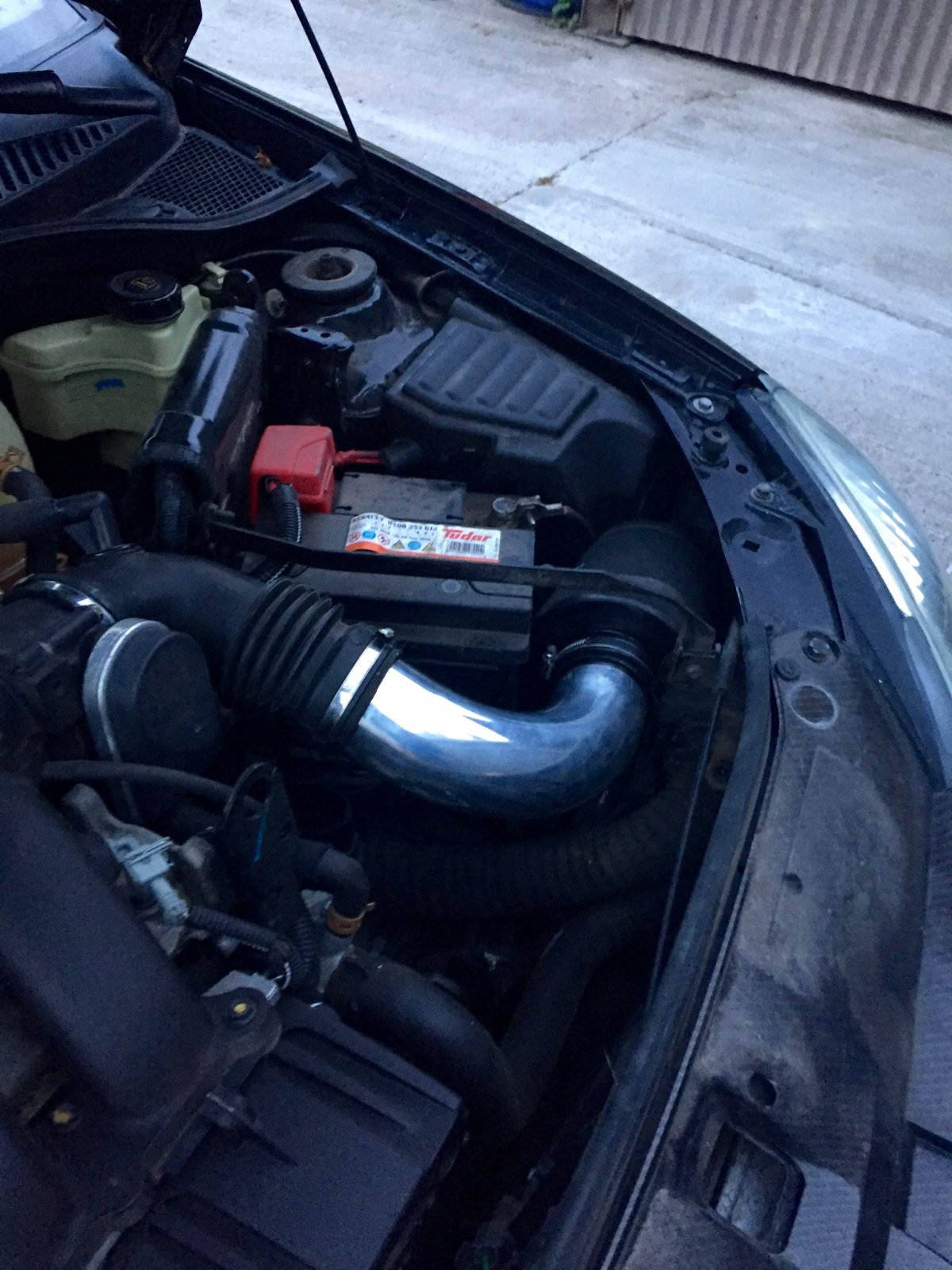

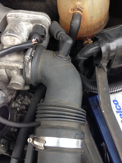

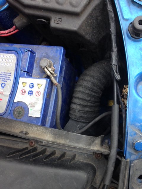

To fit this then do i just leave the existing 90degree hose that's coming out there - it seems to have another outlet (at the top near the water bottle in the 1st pic) I presume that needs to stay - what is this for as some @imprezaworks doesnt seem to have this on his blue silicon hose?
Also in the second pic do i just get rid of all that gubbins of the accordian type hose that goes down behind the front bumper?
Thanks a lot.
Justin.
Yeah mate keep the top pipe that connects to the throttle body unless you have a silicone hose? & yeah can keep the oe air feed if you like or take it out.i removed all of mine & the accoustic valve.
Cheers, so the oe air feed isnt joined to the airbox that I'm going to remove? I haven't really looked down there too much yet :-)

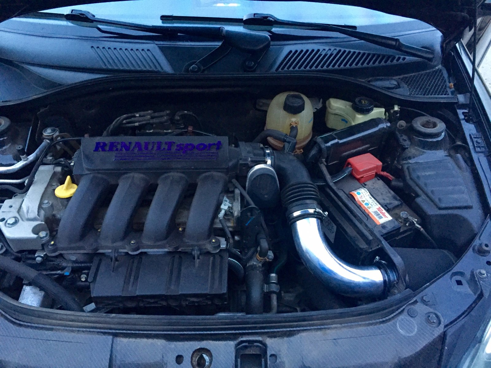

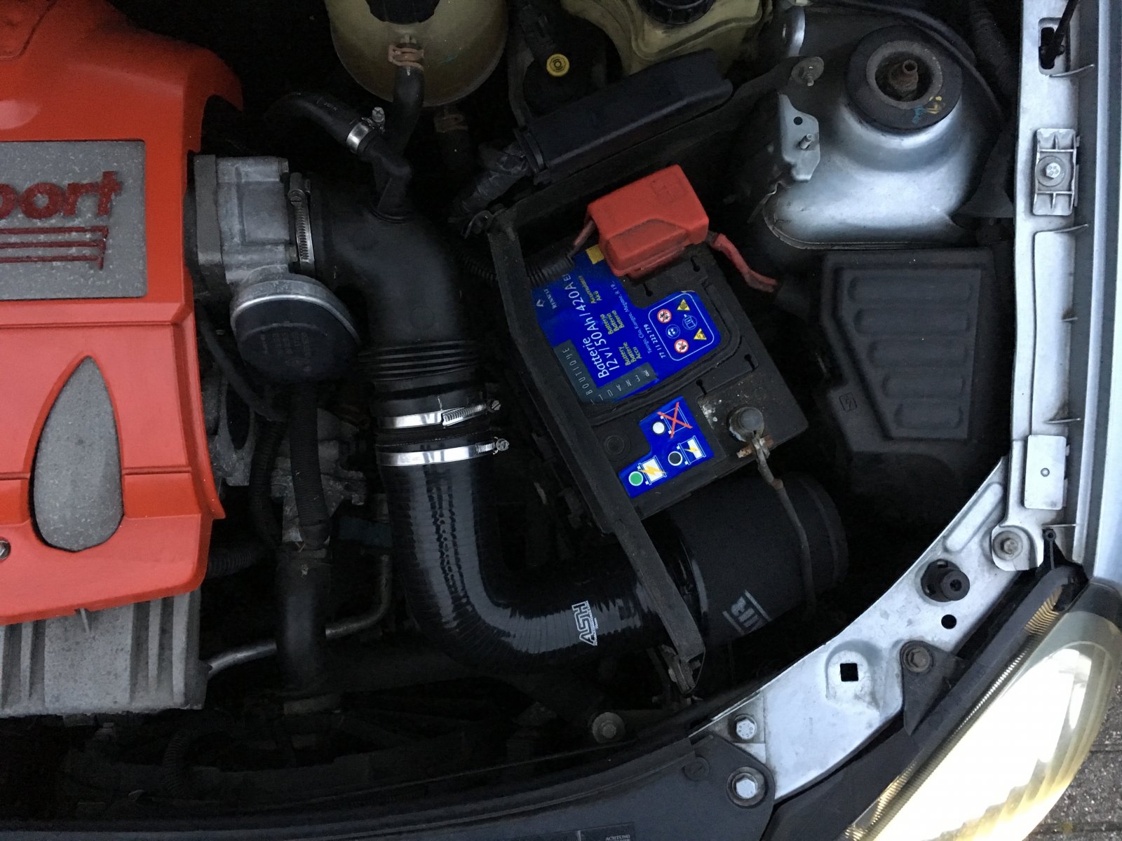

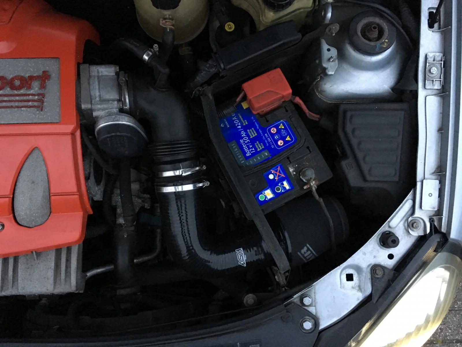

Got mine all fitted:
From what I've seen most cable ties there's to the bracket running along the side of the battery and onto the ECU, but I found if I did that the metal pipe would actually stop the bonnet from shutting properly!
So I've cable tied it down onto a hole below the metal pipe, next to the headlight - which pulls it down which I don't think will be a bad thing as there is more room and closer to the CAF.
Literally gone for a 2 minute drive, and bear in mind I've got a full straight through decat system which is seriously loud, and a stripped out interior, so I'm not going to be hear it as obvious as most!
But in my very quick blast, from 3k+ revs upwards you can hear it - a lot more noticeable with the windows down but that just due to my exhaust I think
Sounds epic though, really does sound awesome! Interestingly though it seems the noise dies down at certain revs, for example 3800-4200, but just the noise as such doesn't seem to be a flat spot

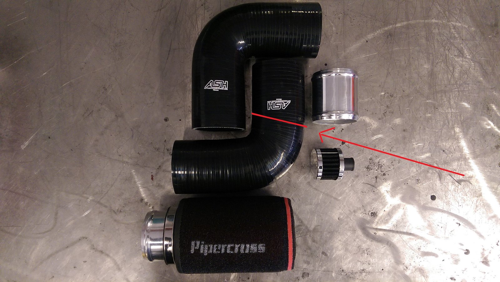

2 x 90 degree bends, 70mm
http://m.ebay.co.uk/itm/Auto-Silico...086576?varId=431063786095&txnId=1216063093003
Ally joiner for the silicone pipes. If you buy a filter that has no neck, you will need another one of these to go from the filter to the silicone pipe.
http://m.ebay.co.uk/itm/Aluminium-A...r-Swaged-Beaded-Long-/190884993451?nav=SEARCH
I had this filter on my ph1. Sounded awesome and looks oem.
http://m.ebay.co.uk/itm/ITG-JC60-67-cone-filter-o-d-70mm-/152099450638?nav=SEARCH
Obviously it's your choice of filter but make sure it has a 70mm outside diameter on the neck or or at the end if your using a joiner.
15mm breather filter. Obviously any colour you want.
http://m.ebay.co.uk/itm/Chrome-Blue...-Oil-Crankcase-Small-/350495839874?nav=SEARCH
Pipe for breather filter off the ICV. Select 16mm.
http://m.ebay.co.uk/itm/310793012250
And jubilee clips for all the parts. These can be had at halfords. You'll need 60-80mm for the filter/silicone pipes and 18-22mm for the breather/ICV.
Then you can have this:
Can use whatever one you want. I current have a pipercross one, but going to swap for a bigger ramair or itg one as I don't really like his one.
As long as it's got a 70mm neck/joiner to go into the silicone pipe you be fine.
The silicone pipe requires cutting. Hold on and I'll drop another picture in here of where.

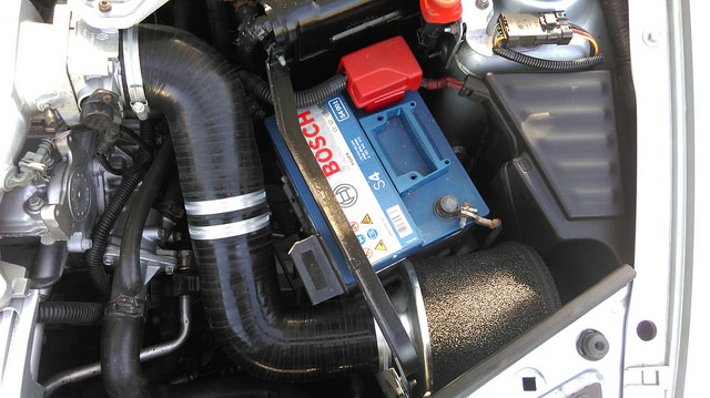

Had mine on for 3 days or so now and I'm undecided...almost sounds like a Honda coming onto V-Tec, seems to almost give a loud 'hmmm' then the roar I was hoping for
Wondering if these Silicone hoses rather than metal bend would give a different noise?
