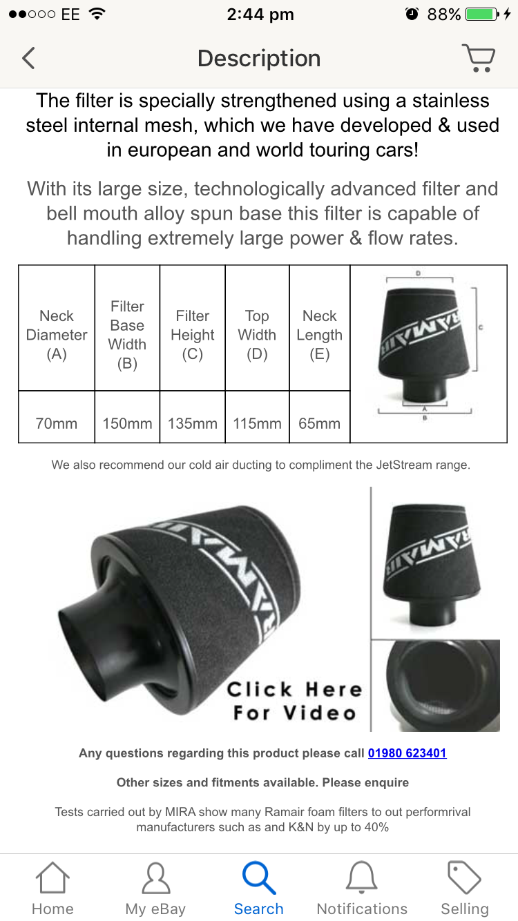

Will this ramair filter fit?
https://www.ebay.co.uk/itm/271763944731
Ideally want the one with the neck on as ill be using 2 90degree hoses and want it to look tidy as possible

Sorry for resurrecting this old thread, but have people generally found it possible to fit the Ramair CC-296-70 in between the battery & headlight?
Swaged should be ok, but certainly no need for them.
I went for a plain end coloured version (not much choice at mo tho!) that needed cutting down, but probably helped get the fit just right.
https://www.ebay.co.uk/itm/70mm-2-7...oler-Boost-Intake-Pipe-Clearance/251865816687
Cheers, I was thinking the same that the swaged wasn't really needed. You're right there's very little choice on those other aluminium pipes though as there are only purple ones left (far too fast and furious for me) 😧
I think I will go with the silver swaged ended one as per the links in my previous post, along with the CC-296-70 cone filter (non offset) and hope they marry up to one another. From reading some of the above posts it seems others have already bought these exact parts.

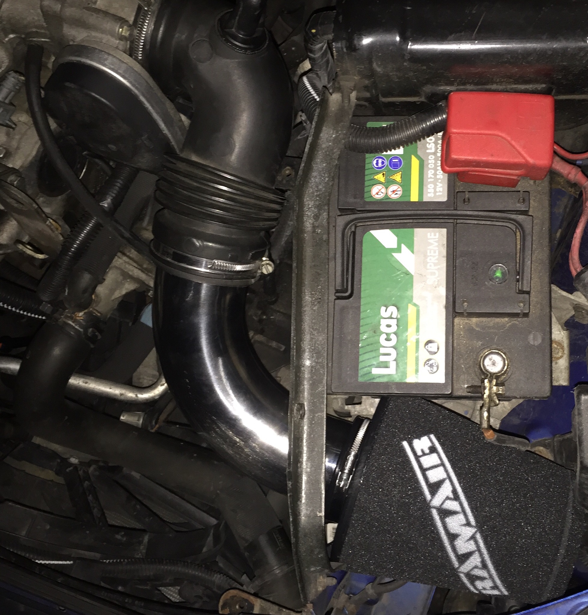

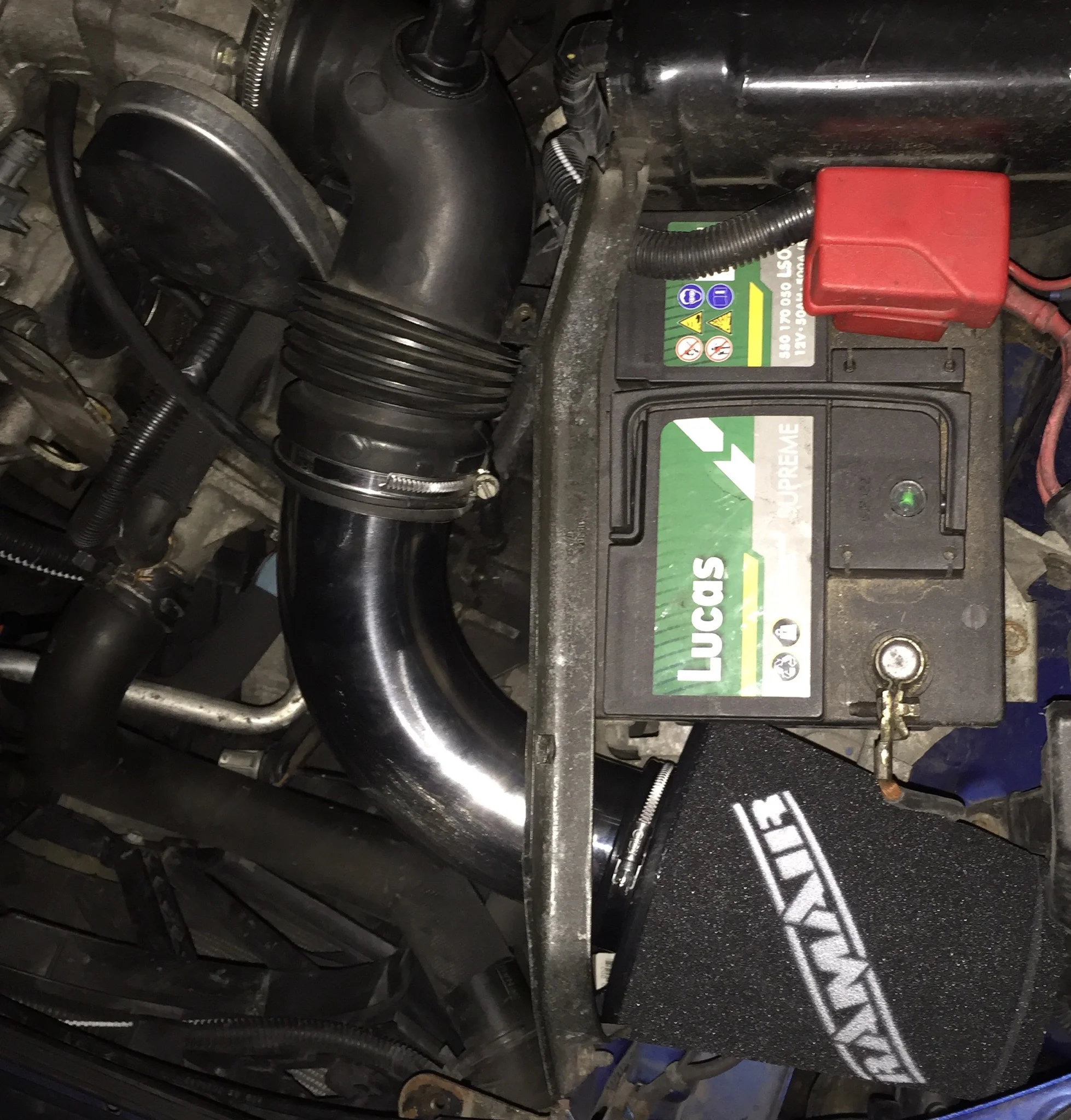

I’ve fitted the fatty and it’s just as good as I hoped. The sound is absolutely fantastic.
I noticed that the alloy pipe, which is 70mm diameter doesn’t sit snugly inside the plastic intake hose though. I.e the jubilee clip needs a fair bit of tightening to grip the alloy pipe. Has anyone else had this issue, and did you use a sleeve on the alloy pipe or just leave the jubilee clip as tight as possible to try and prevent any air leaks?
I don't recall tightening it too much, the alloy pipe was a nice fit. As long as it's tightened up I wouldn't worry about it mate.
Cheers guys, glad to hear it's nothing to worry about. I was thinking of putting some kind of rubber sleeve over the alloy pipe to give the plastic hose some more grip but it's not worth it really. Also I don't want to risk anything it getting sucked up into the throttle body!
