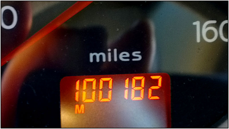

My Trophy has now come of age. Sadly I couldn't catch the 100k shot as I was driving down the M1 so I got the next best thing. :D
Christ, I never ever would of guessed it was that high! I always thought yours was pretty low miles.
You're only 4k behind mine ;)
Car looks great for 100k.
That's it, see... I'm catching you up! :D

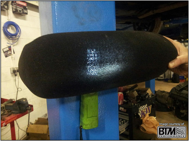

So I got a call from Fred at BTM today explaining how he was checking a few things over on the car prior to taking out the engine in the near future. It would seem a few issues have been identified already. The first issue is something that should perhaps be a concern to others who are running a filter similar to the one shown below (this is a second-gen filter that comes supplied with the K-Tec DTH ITB kit). In a nutshell it is poor. Very, very poor. The truth be told it's not much of an improvement over the first (poor) design but this really takes the biscuit. I don't like bad-mouthing anyone (especially businesses that have been helpful in the past) but I think people should at least be aware of potential problems that can, in turn, lead to other problems. And problems that can end up costing a LOT of money to fix / put right. :(
So, here we have the filter as removed from my car a few hours ago. The important thing to note here is that this car and it's components has been looked after meticulously - including cleaning and spraying of the filter, etc. It's not degraded through lack of care, attention or abuse! You can clearly see that the foam has all but disintegrated away. This explains the large build up of black crap that I regularly see when cleaning the bodies.

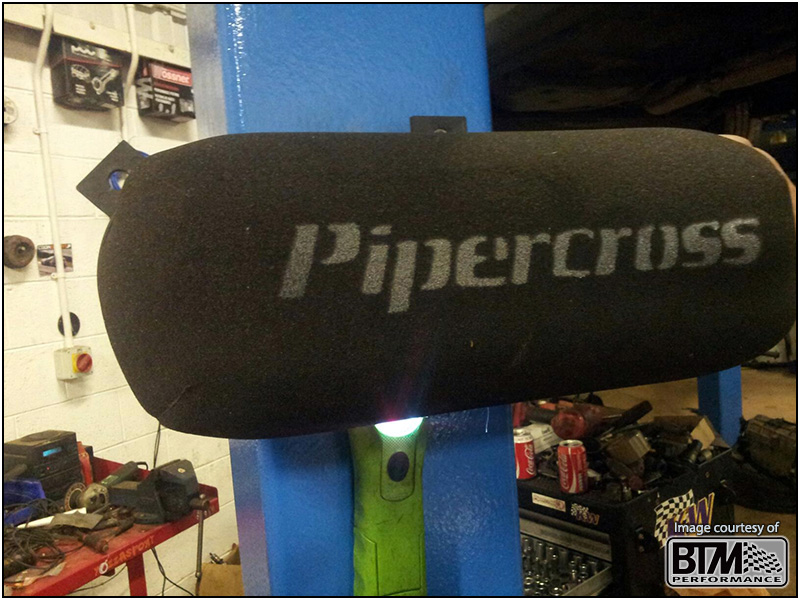

Here's what a decent filter should look like.

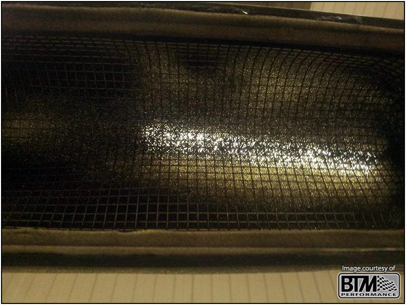

And again, for comparison, here's my filter photographed from the opposite side.

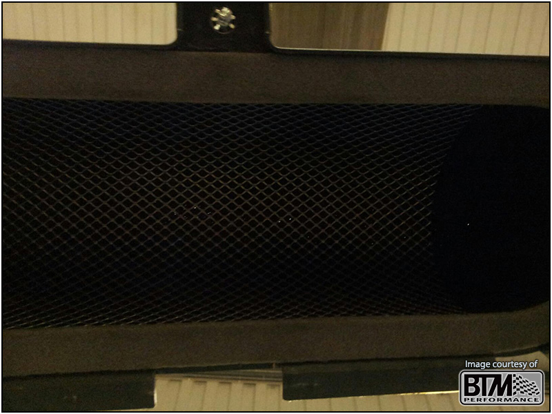

And again, a decent filter for comparison.
I'm glad it's going and to be replaced by a decent item (in some shape or form).
