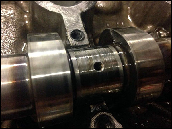

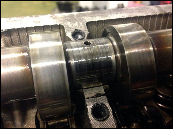

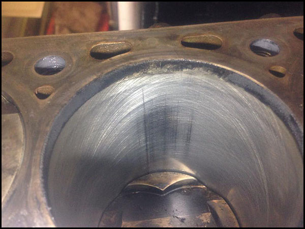

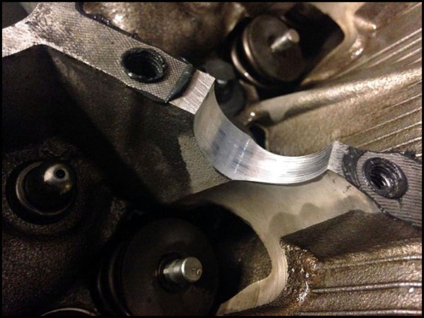

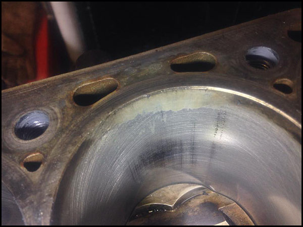

Recently, following the work that Russ has kindly done on my car, the Trophy was trailered down to Dan at SJM to give it a look over. As mentioned in my last few updates it's not quite been running right and something has felt amiss. The 18mpg, the lack of torque, the difficulty in driving the car below 3k rpm and the bogging down of the engine at sometimes seemingly random times. Due to the problems the car has been sat idle for the last couple of months or so until it could be looked at. I spoke to Fred (who's a little busy to say the least) and he kindly offered some suggestions as to potential issues and things to look for. As it was at Dan's and was convenient, we were able to carry out a compression/leakdown test and take a quick look at the bores to see if they threw up any indicators as to what might be contributing to the problems.
Unfortunately cylinders 3 and 4 were smoking and some 60-70 psi down on cylinders 1 and 2. The pistons were also rattling like a b!tch in the cylinders (even taking into account the fact they are forged and take some time to warm up). There also appeared to be some marking on the cylinder walls. I spoke to Fred again and, as Dan and Mike were available to take a look, I asked if they would be happy to do so. It was something I didn't want to do but it was stripped down to see what was going on. Ah, the joys of modified cars... LOL!
To cut a long story short the engine has suffered damage; scored cylinders, cams, to name but a few things. The head has also been damaged. The upshot of this is that a new engine is needed. The good news is that the conrods are ok :smile: The piston rings were obviously not in the best shape and neither are the pistons; which are a little oval in shape now as possibly are the bores. I was given the bad news and able to see it for myself and, alas, sh!t happens. Again and again with this car 😧
Sorry the pics aren't too clear but you can see a little scoring on the cams, bores and cam journals; quite a lip on the scoring in places.
It's not easy to say how or what went wrong (and I'm certainly not pointing the finger as I fully believe this has been pure bad luck) but it looks like incorrect fuelling may be the culprit; possibly some injection/injector or fuel pump problem. It's a risk you take at the end of the day and sometimes things don't go to plan and such things can't be accounted for 😧
I won't lie... it's upset me more than a bit and it has hit the wallet hard. I'm not going into hard figures but thousands has been spent on this car and it's about time it gave me a break. Maybe one day it will :smile: In the meantime it will be SORN'd and engine-less whilst I decide what to do next. Fred has kindly offered to source and help with parts if needed and Dan and Mike have kindly offered to incur the wrath of the Trophy whilst discussing potential routes to go down next. Obviously I need to spend some time considering things. The Jenvey ITB's and GEN90 ECU (in perfect condition and hardly used) will be sold. The ITB's haven't even seen 4k miles yet and not been used in anger due to the ongoing problems with the car. I will most likely keep the conrods as I've grown attached to them! LOL!
As said, plans are being discussed but it might be a while before Le Clio Bast**d Rouge sets tyre on tarmac again. I'm sure it will, but I've no idea in what shape or form. Regardless, if I do decide to continue then it will effectively be the last throw of the dice with it. If I carry on and have problems then I will cut my (hefty) losses and crush it. Simple as that. But then again maybe it will be 4th time lucky!
As said, I'm not pointing fingers or accusing anyone of anything. I'm purely updating my thread to keep the story of Trophy #165 alive and up-to-date. Those involved with the build have a good reputation and for good reason. I wouldn't hesitate to recommend or use them again; hence I don't want to see any s**t thrown or rumours spread when they are unfounded (I know how good the Interwebz can be for s**t throwing and rumour spreading!)
I just don't know what to do next... but I will say a big "thanks" to those of you who have been following for some time now. I look forward to hopefully bringing you some more news and updates soon and I'll post again in this thread as and when something worth mentioning crops up. Apologies if the thread goes quiet for a little while...
Cheers,
(A somewhat numb and gutted) Andy
