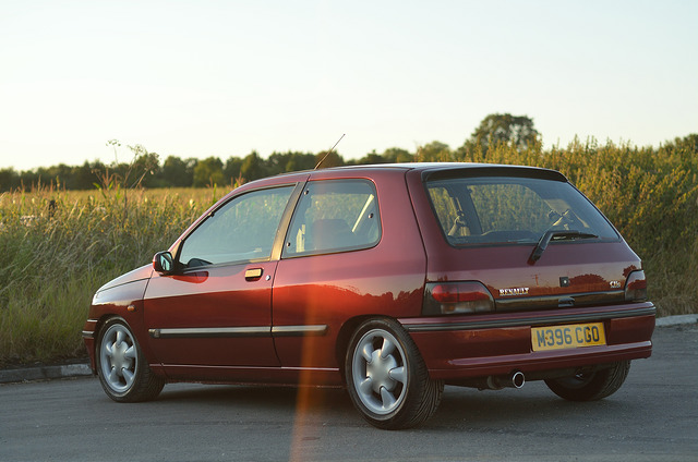

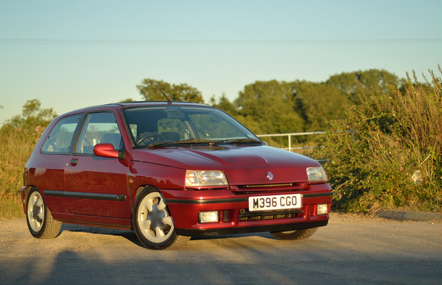

I would keep the centrecaps grey. Just not as grey as they are now.
It's a tough one really mate. They look brilliant here:
And then in certain lights/angles they look really, really dark, like here:
Which I'm not too keen on.
Hmmm.
