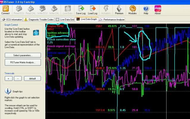

look at this,this is not normal.
Performance calibration 6500_5404 RON 98
Ignition advance goes from 24º to 19º
THIS IS NOT NORMAL!!
There is a combination of slow knock corrections and fast. The rapid dips in ign are the fast ones. Check your engine mounts especially if they are after market. Apart from that it doesn't look too bad really!
Yesterday I remaped the car to 6100 version(mother ecu map)and car feels better.But I still having a question.What are the normal ignition advance values for a stock car?
5514rpms--------------->21.375º
6000rpms--------------->21º
6388rpms--------------->22.125º
6500rpms--------------->22.5º
My mechanic thinks that the problem was the remap 6500 :S
Yep that sounds about right. Could be your fuel available is not up to the task. Here is a std tune log from my car:
