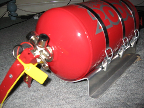

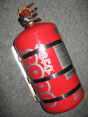

Time Attack states you must run at least a hand held extinguisher, but i felt more comfortable with a plumbed in system, so if there was an engine bay fire i could put it out rather than stand back and watch the thing go up in smoke!

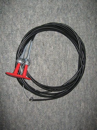

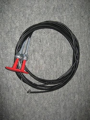

complete with internal and external pulls

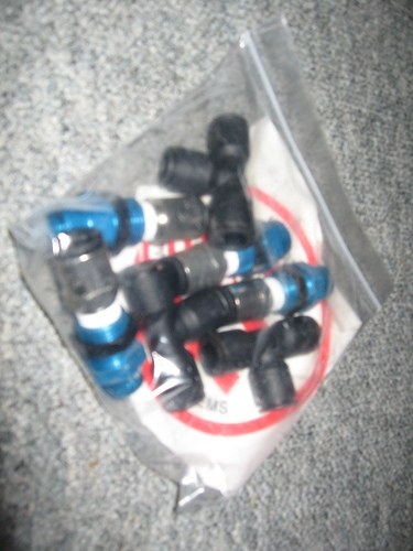

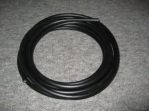

Tubing and connectors allows system to do engine bay in 2 places plus passenger and driver foot wells.

Those extinguishers arn't very good i'm afraid; they arnt really designed to stop the car going up, just to damp it down enough for you to get out.
AFFF extinguishers are just like soapy dish water really :)
There isnt any car plumbed system that is designed to totally put a fire out. The lifeline systems are very very good at what they do.
We had a tank explode in a superlight this season and the extinguisher system dampened the fire enough to save the car and total write off.
The charged systems are only needed on cars with values of like £250k like the mondeo i ran in 2007. However that extinguisher cost a fortune to run and service.
  clio 200 F4Rt
well if it gives the car a few more minutes life till the track side fire service arrives, then it gets my vote.
obviosuly it wont put out a blazing inferno! But its 1000 times better than some hand held item i gotta scrabbled for, then get out, then try and aim into the engine bay!!!!
If heard people say they have set their AFFF extinguishers off by accident, and all it did was dribble out :)
The most important thing for the AFFF ones is the correct placement, aiming and installation of the nozzels, else they loose most if not all of their effectiveness.
It's typical, Halon extinsguishers were banned because they are bad for the ozone; but i'm guessing their not as bad as the whole car going up, which is definitely happening more now :)
I am probably going to try one of the Lifeline Zero 360 ones in my car, it's a gas discharge one rather than AFFF so hopefully it will stand more of a chance.
fingers crossed i never have to reply on it, but if i do, and its pap, feel free to say ' i told you so ' :D
