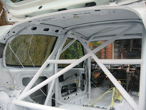

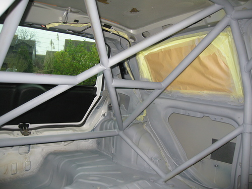

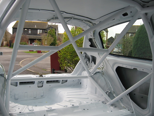

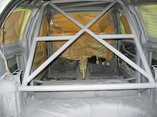

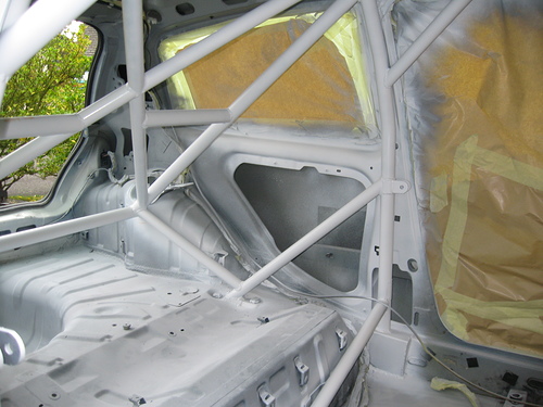

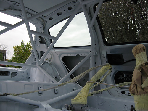

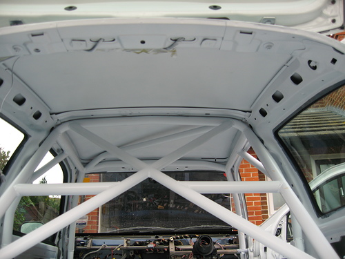

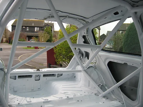

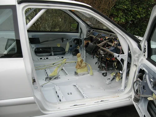

love the cage, lovin the seats even more tho, ow much they set u back?
Fantastic job there, looks solid!

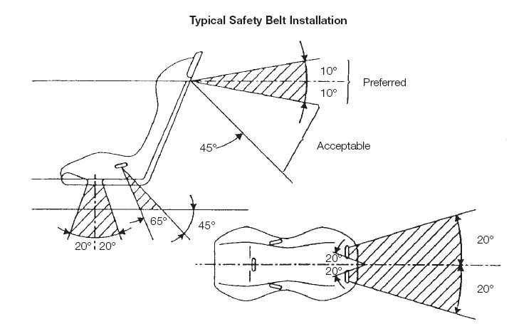

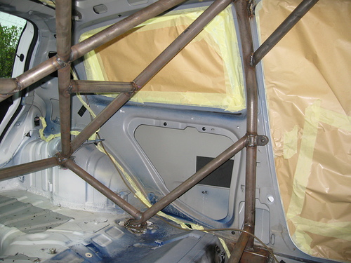

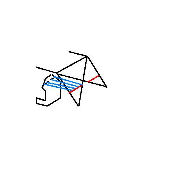

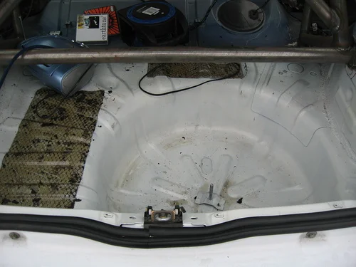

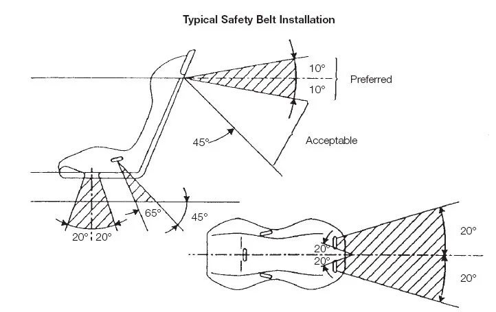

Although I don't think it does the car might need to be checked for safety and otherwise it would fail. Other caged cars on here arn't checked for proper race compliance.Nice to see someone on here has proper harness bars!![]()
For those who don't know here how a harness should be
http://www.cliosport.net/forum/showthread.php?t=224554

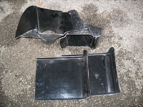

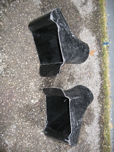

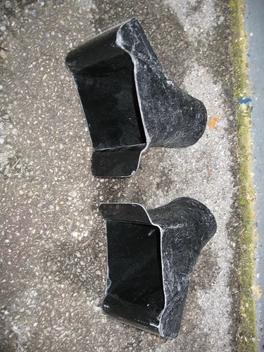

Matt, pm me if you need any advice on fitting the ducts.
Pain in the ass doesnt begin to describe the job. Lol
