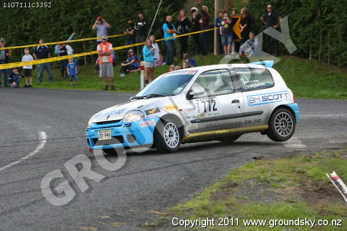

Have a Cup gearbox, Quaife ATB, new lightened flywheel and clutch that want to fit into ITB'd Phase 1 172 now in tarmac rally spec (attached pic shows one reason for wanting ATB in - that was expensive!...) There's not a lot of experience with Clio's here in New Zealand - and while the engineer is very competent - he isn't able to put his arms around how long it might take - and time is of course money...
