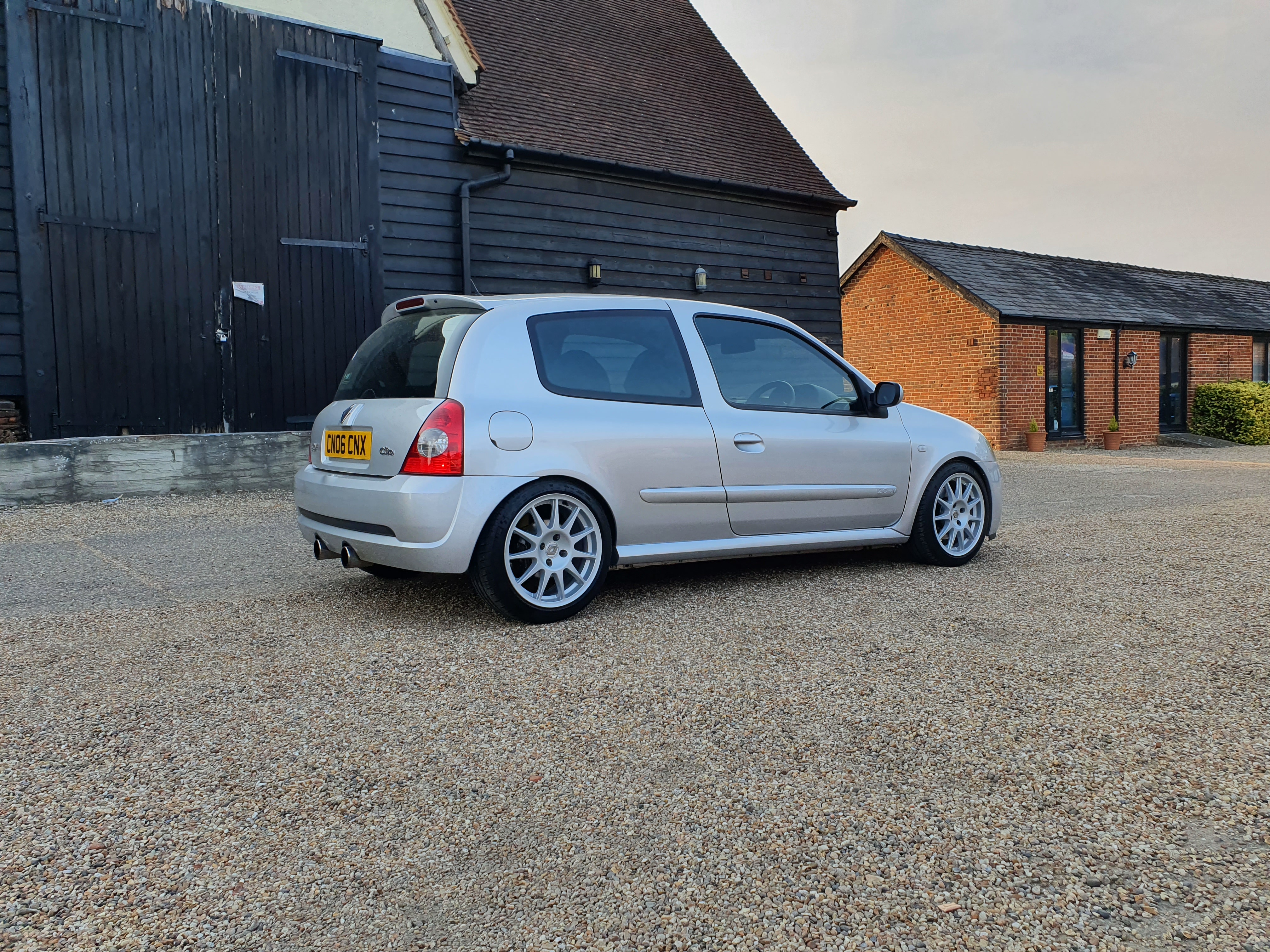

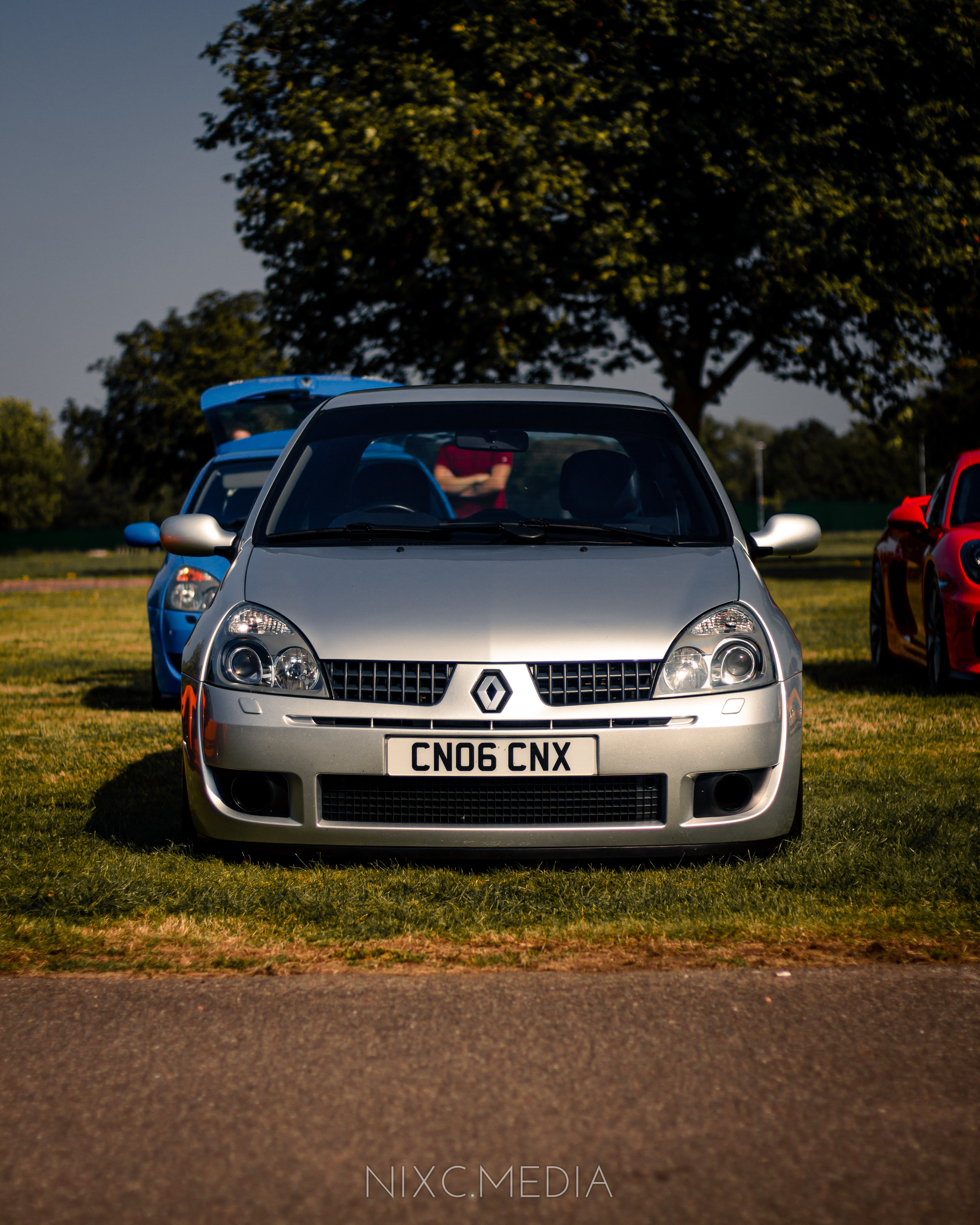

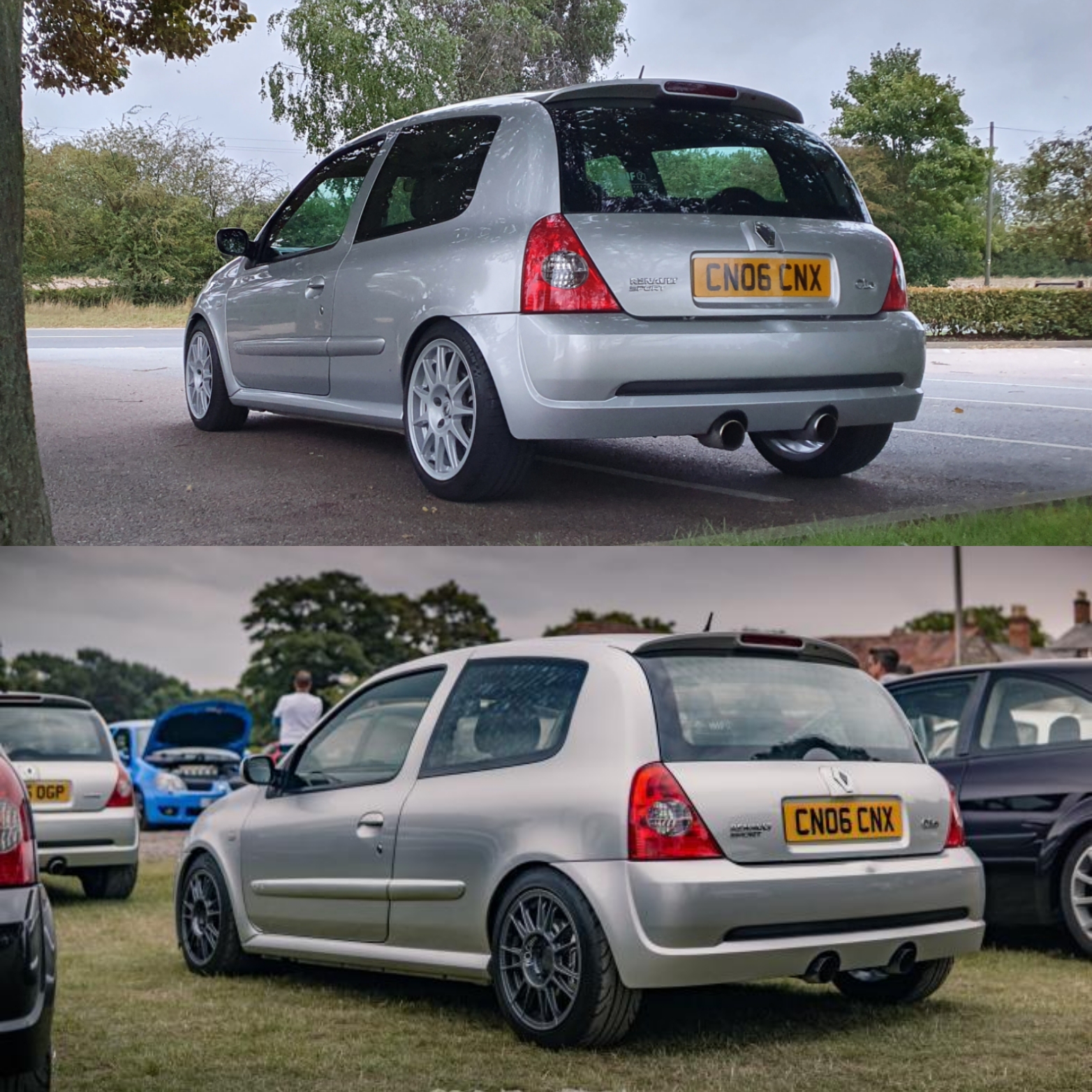

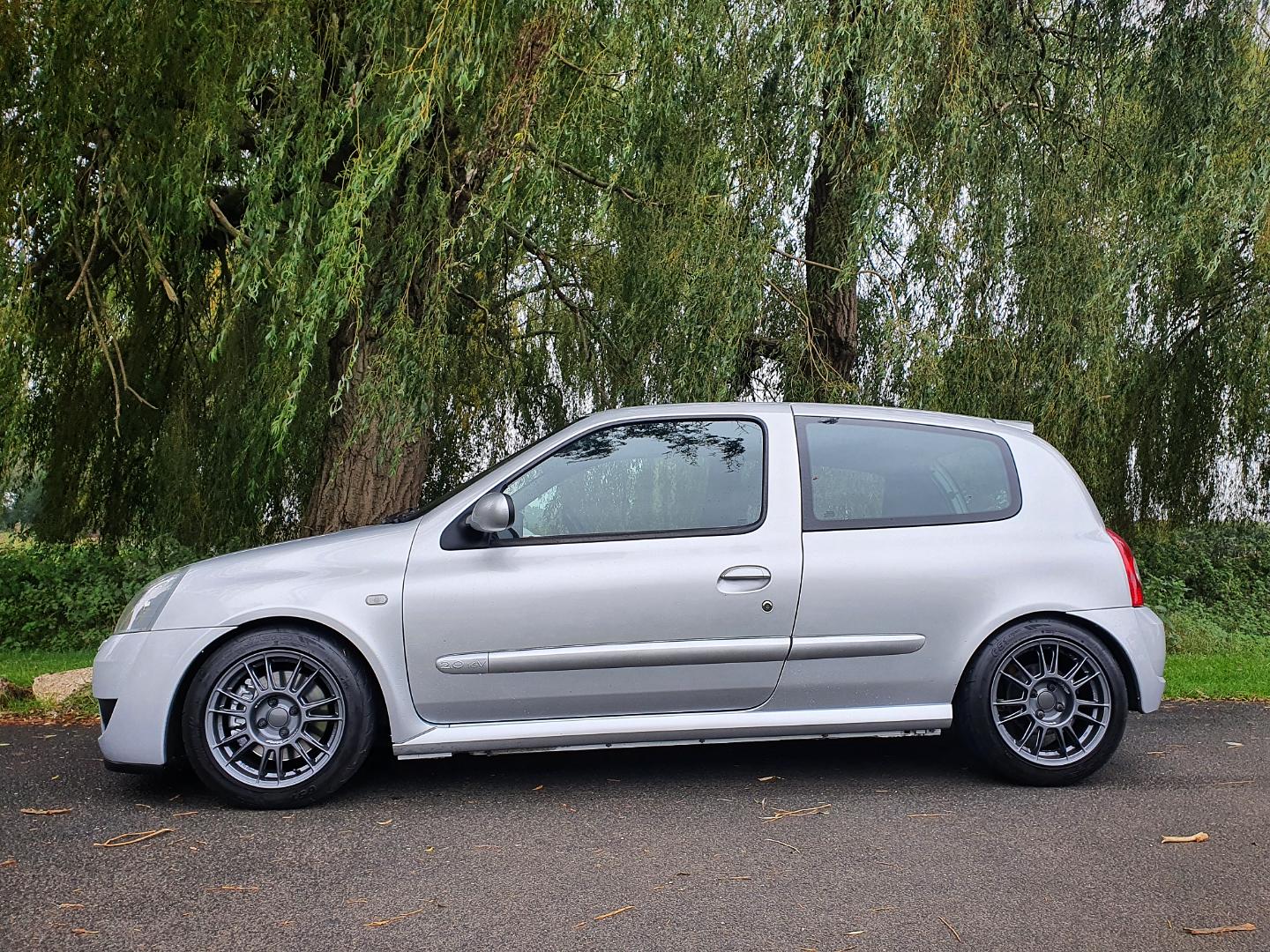

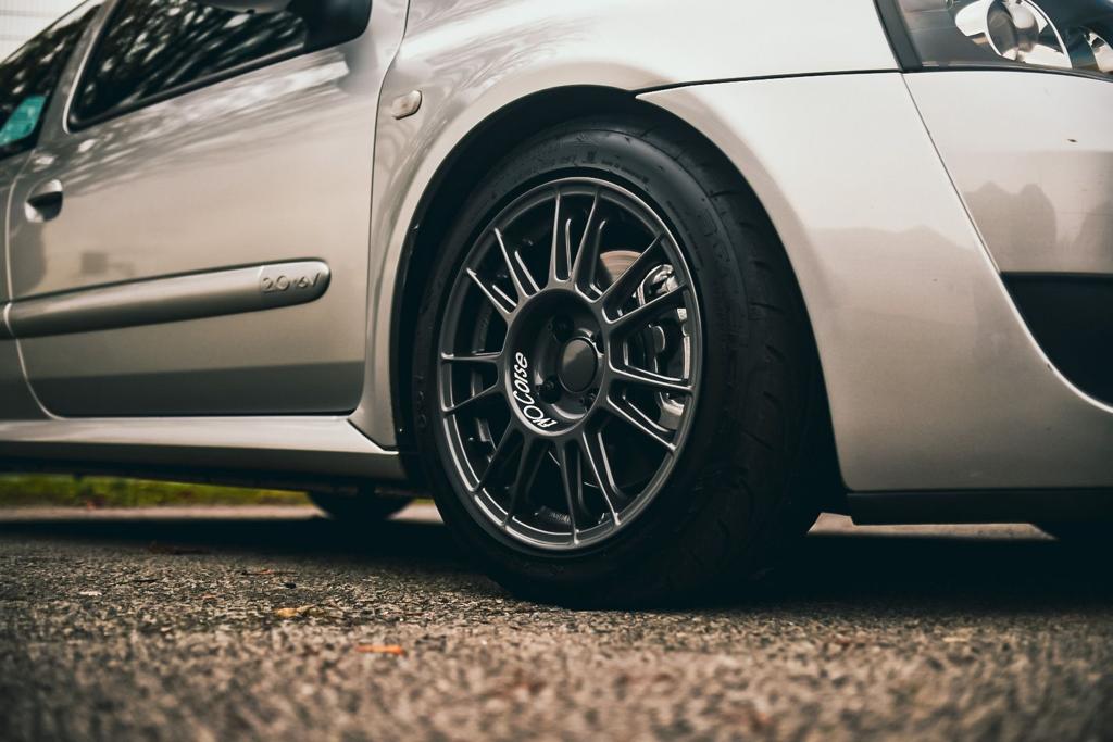

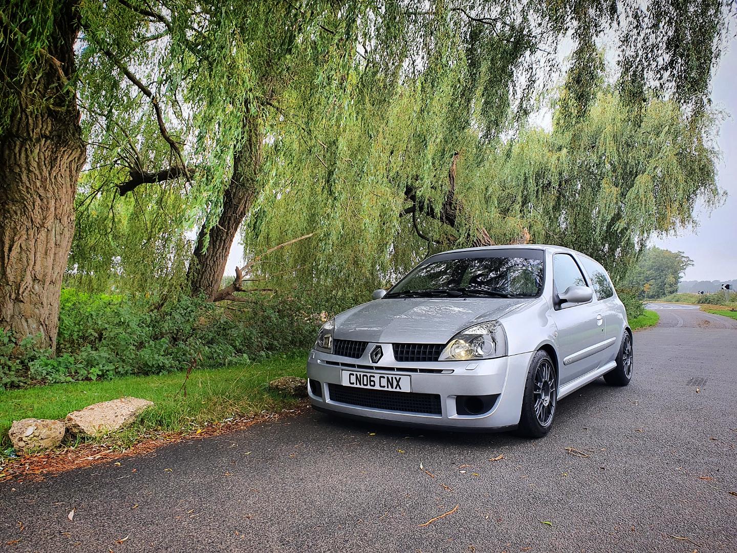

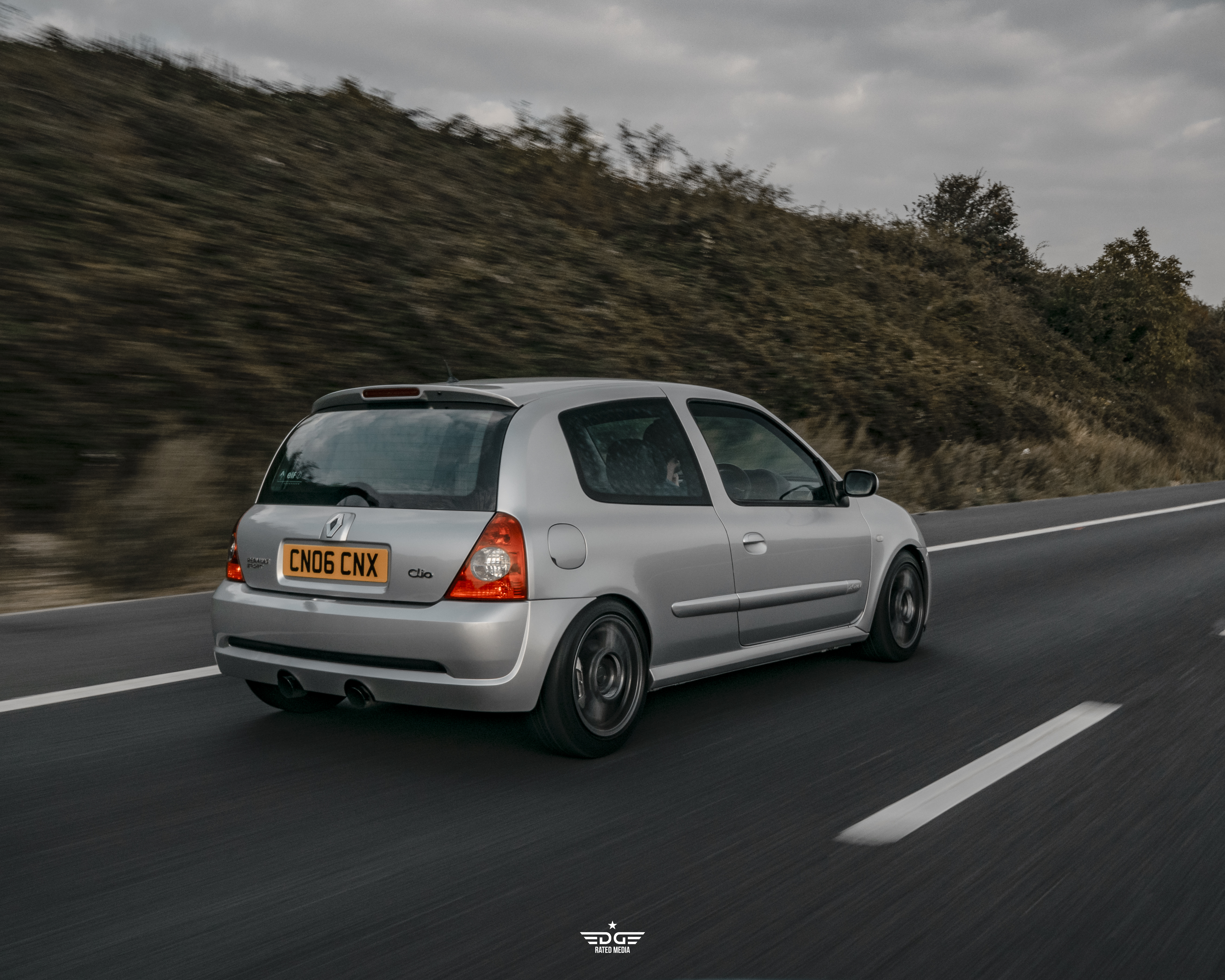

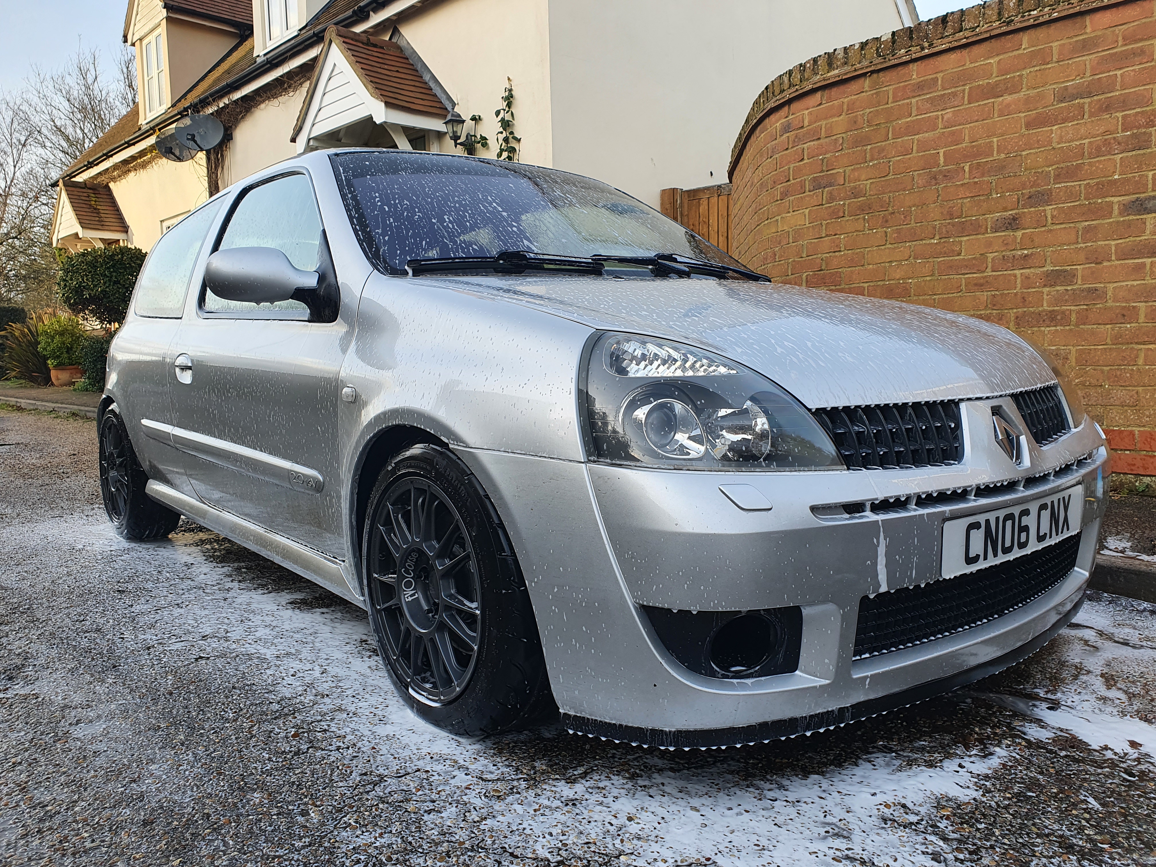

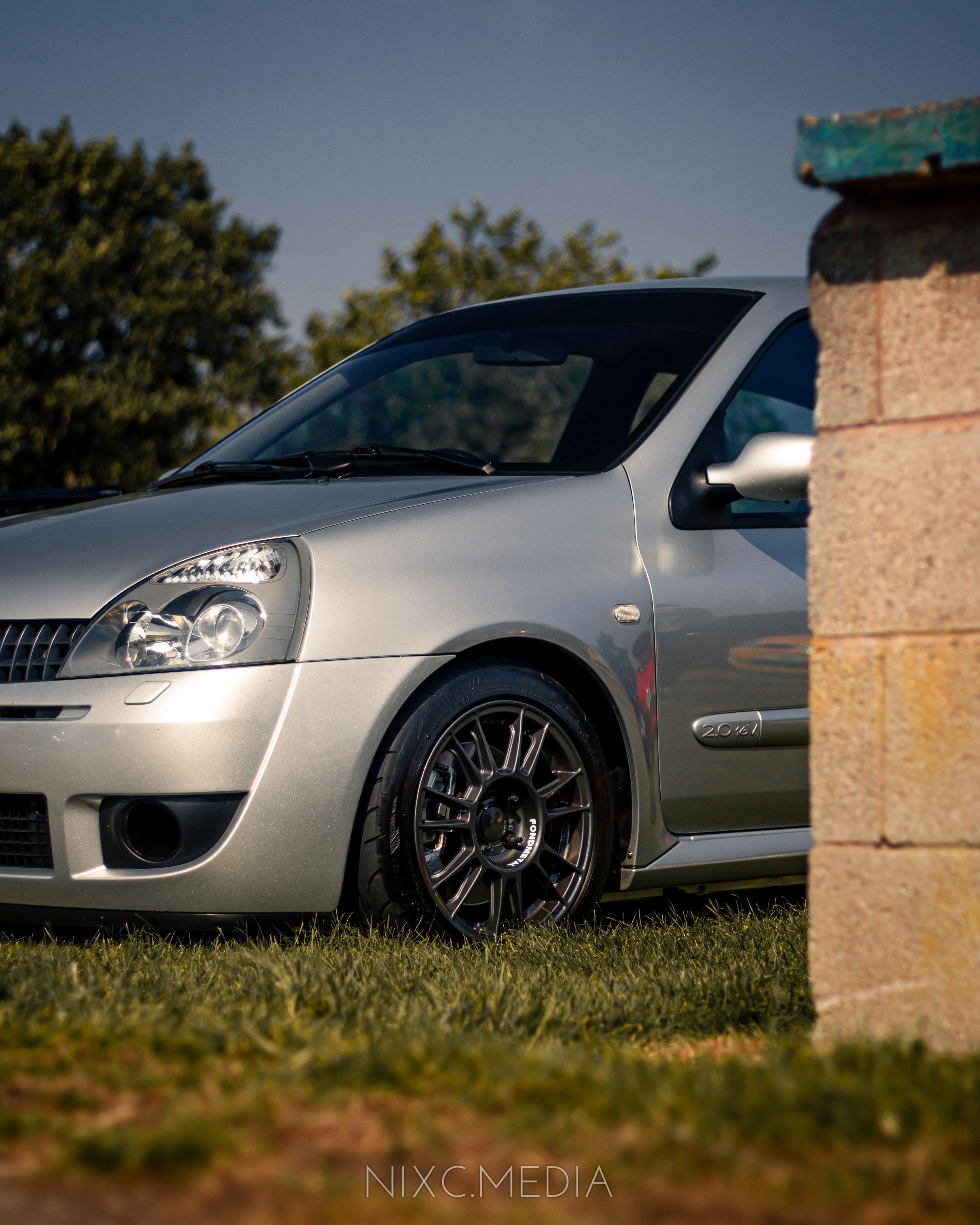

I like how clean the silver on silver looks, new wheels looks more aggressive though!

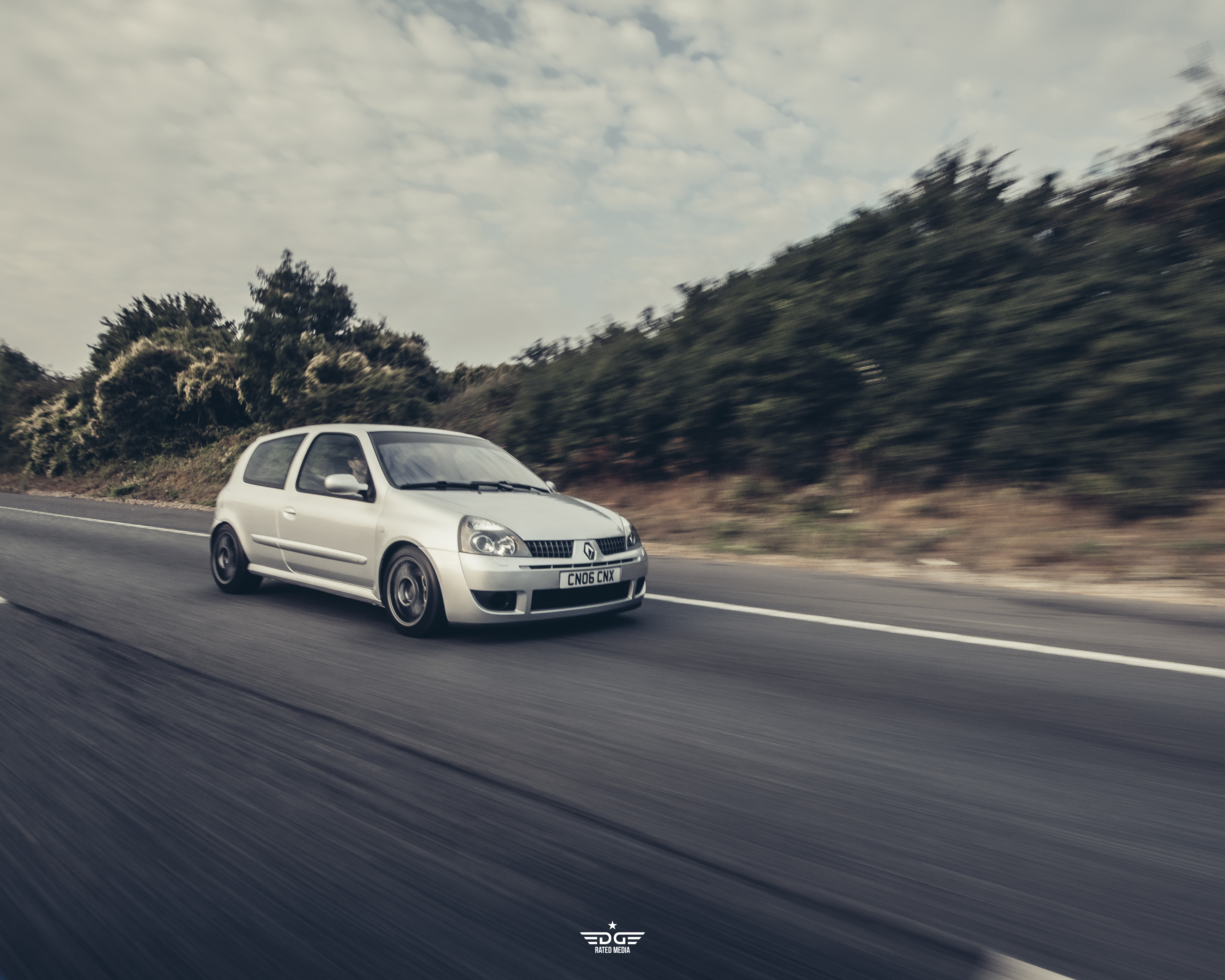

They look good in the rolling pictures as well.
I guess thats it,both sets of wheels give it a different look.Turinis fresh and clean while the Evo's give an aggressive look.

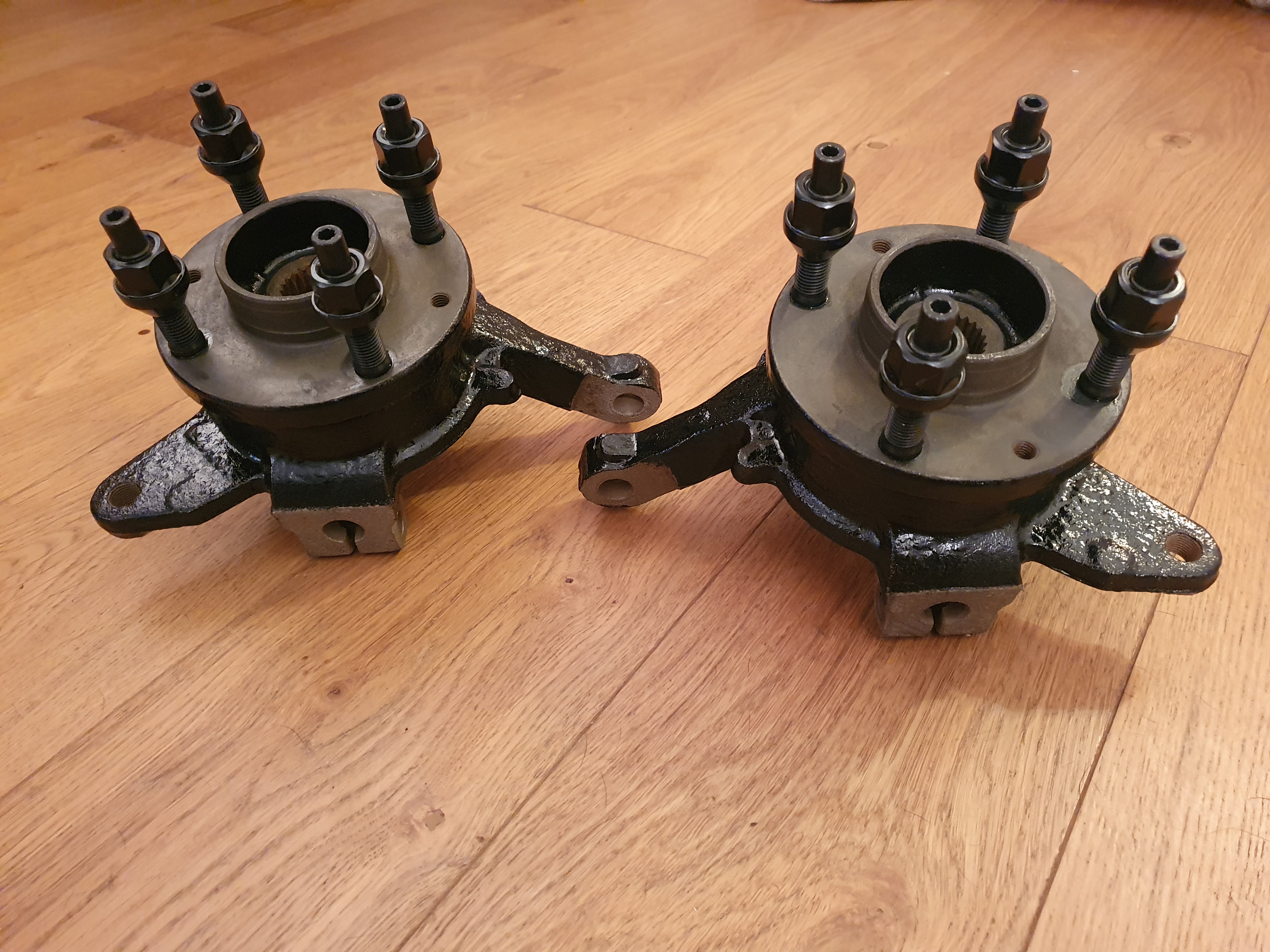

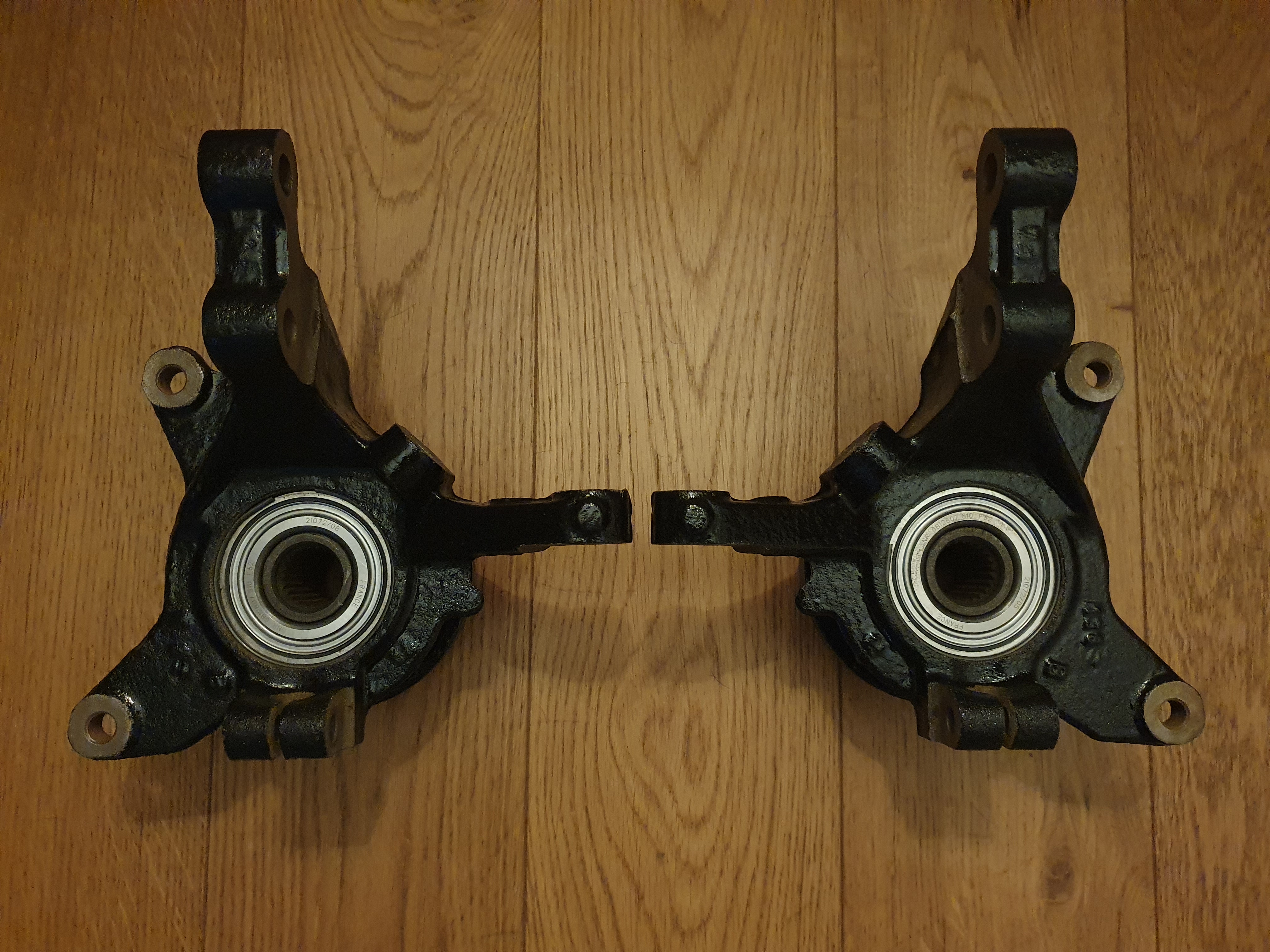

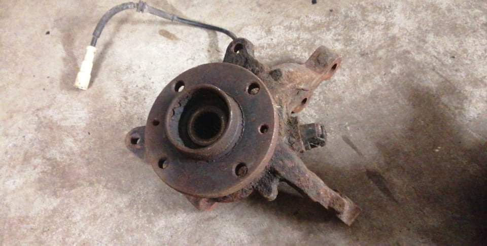

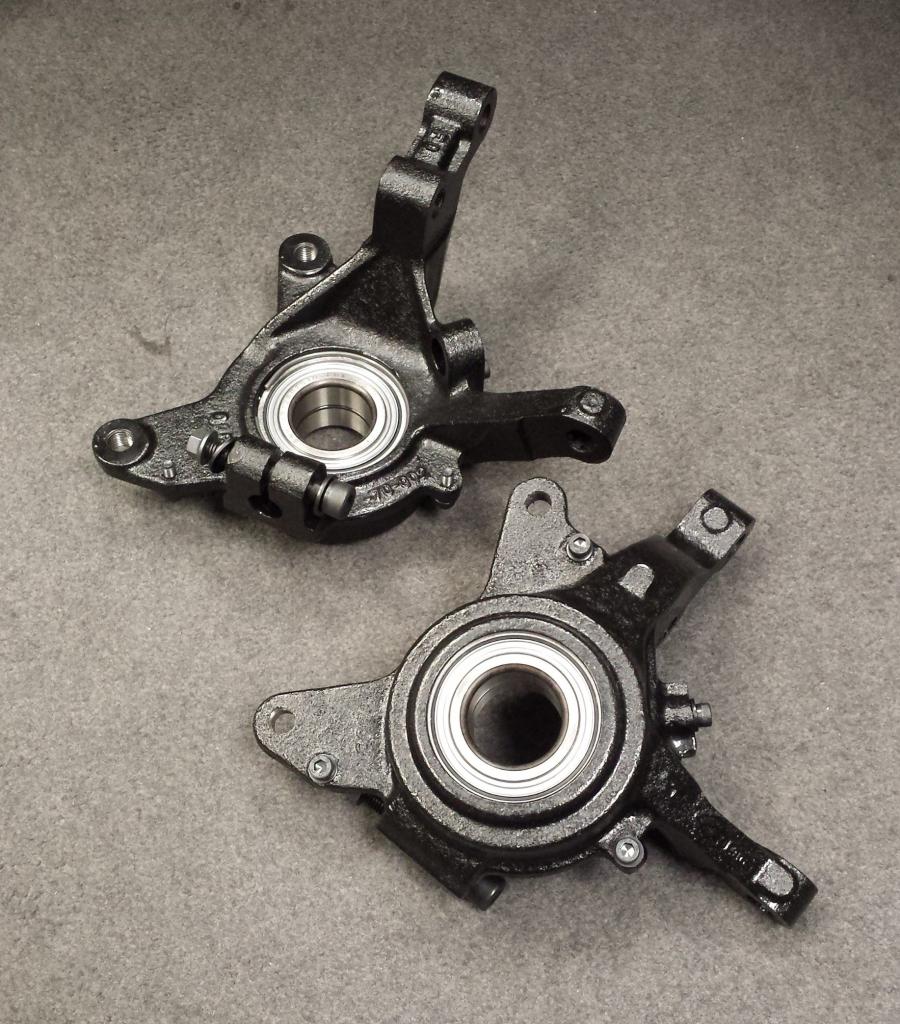

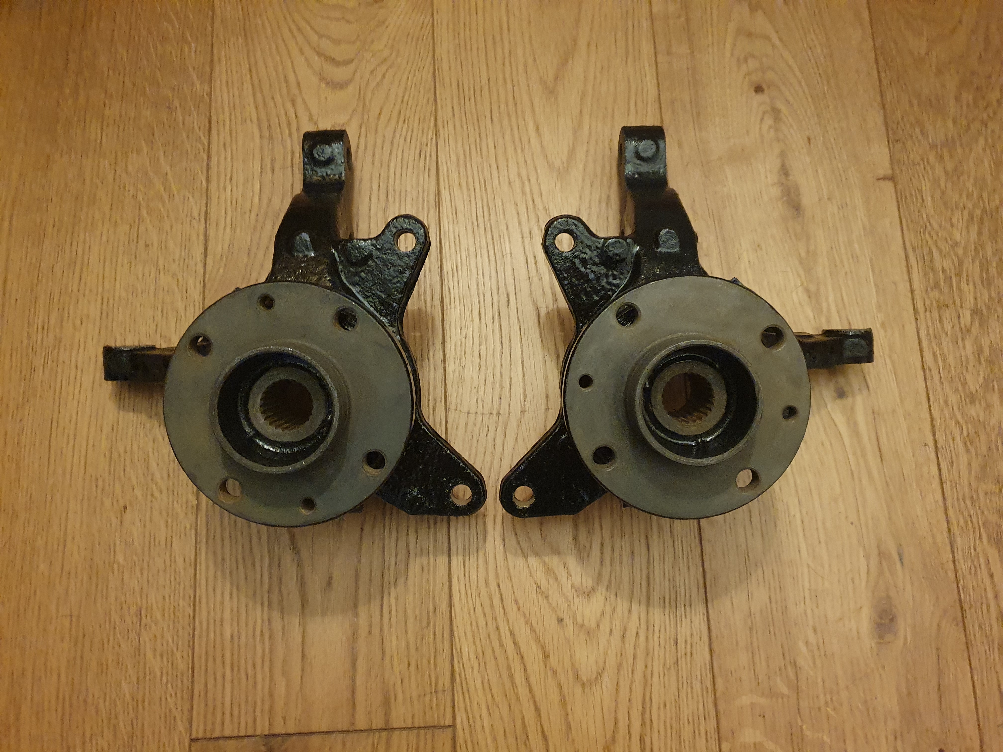

Next little project for the 182 is to refurb the front hubs.I managed to get hold of a 2nd hand pair of front hubs that i plan to clean up,new bearings and possibly new abs sensors also.
Plan is to give them a go over with a wire brush & wheel,then soak in some Bilt Hamber Deox to remove most of the crap & rust,then Mark will give them a shot blast at his work.Once done i will get Alex to fit the new bearings,i will fit the sensors myself then give them a nice coat of black smooth hammerite.I hope they turn out just as good as @Tomotek did.
Will also give all the Geo kit a good clean and re coat in ACF50 while its all being taken off to put the other hubs on.
Inspiration

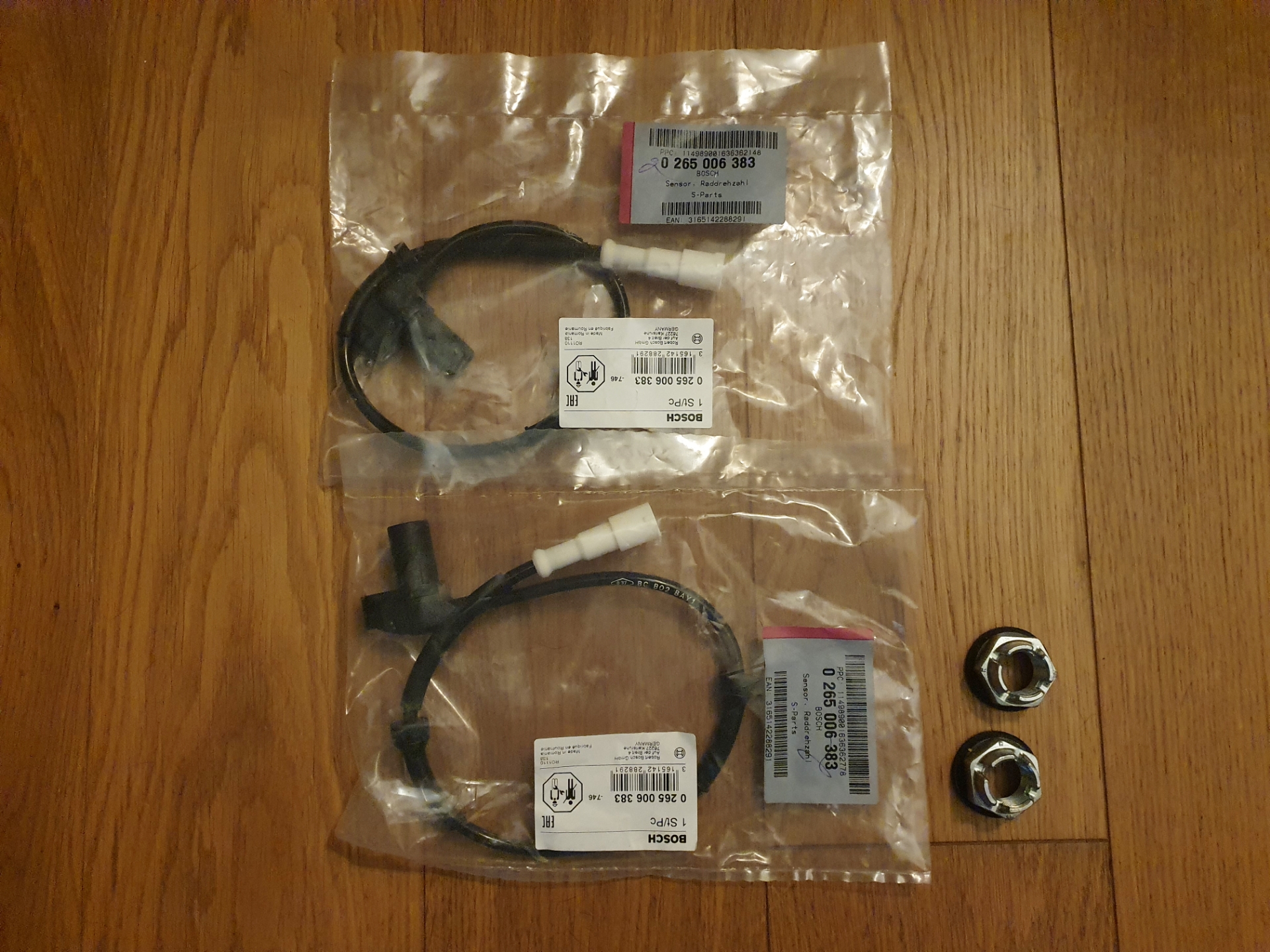

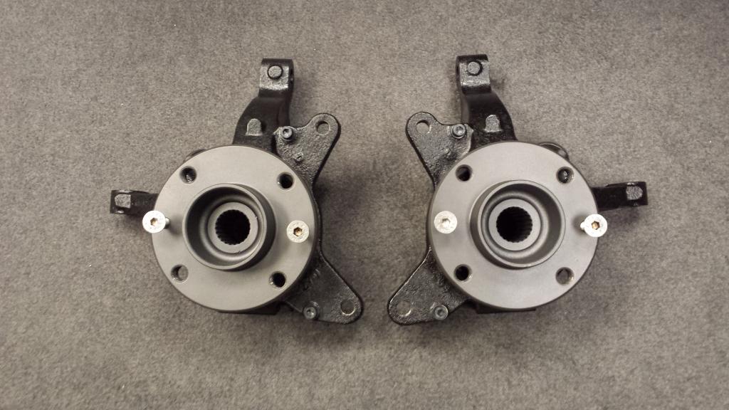

Hubs are all ready now to be swapped over next weekend.New SNR bearings fitted,along with new sensors as i know i would of never got the other ones out in one piece and also its nice to have new bits to replace old.
Iam happy with how they have turned out,i was going to have them zinc coated but after talking to a few others i decided with painting as will be tuffer durable.
