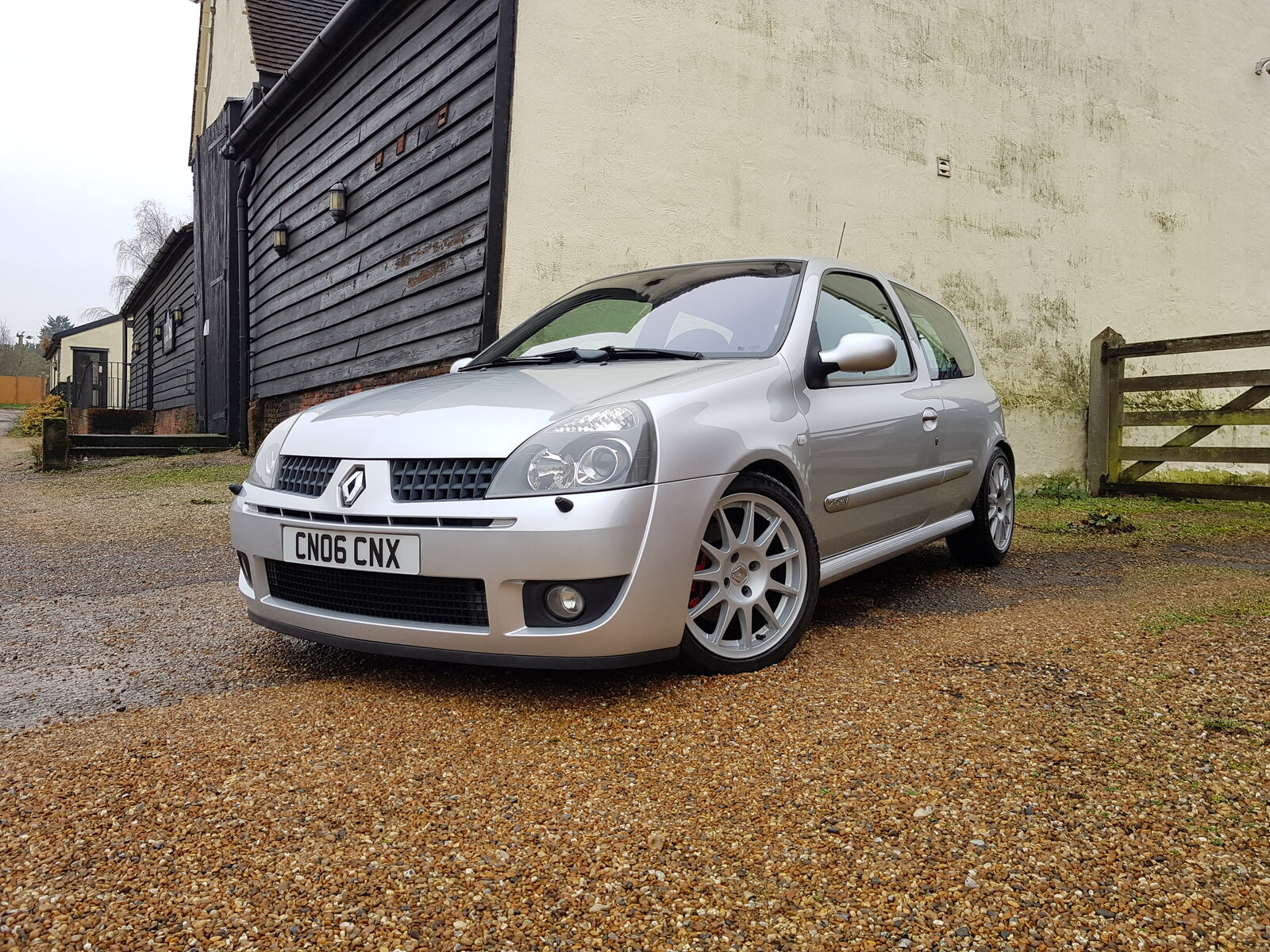

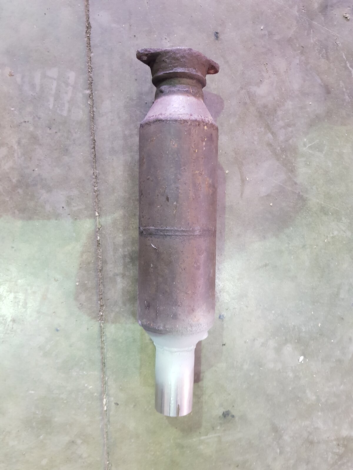

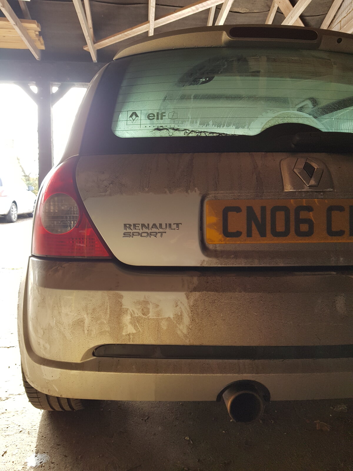

Little update,fitted a Decat a couple of weeks ago and sounds great now.Quiet just potting about then a Nice rasp when giving it some s**t but not over the top for a nice daily.

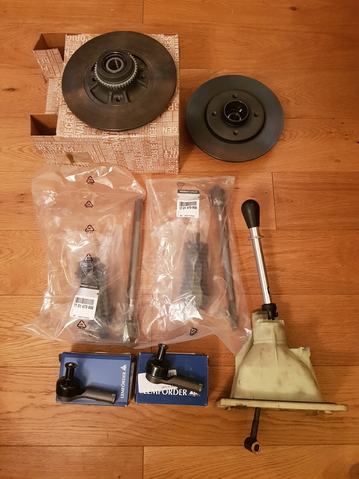

Got a small load of bits building up ready to fit over the Christmas break.
New Rear discs
New Tie Rods
New Track Rod ends
BMS shifter
Also swapping over the wishbones from the Cup as there only 2 years old,just going to change the lower ball joints on those,along with Braided Brake hoses front & rear and front caliper,as the ones on the Cup have been rebuilt with New pistons,sliders & seals.

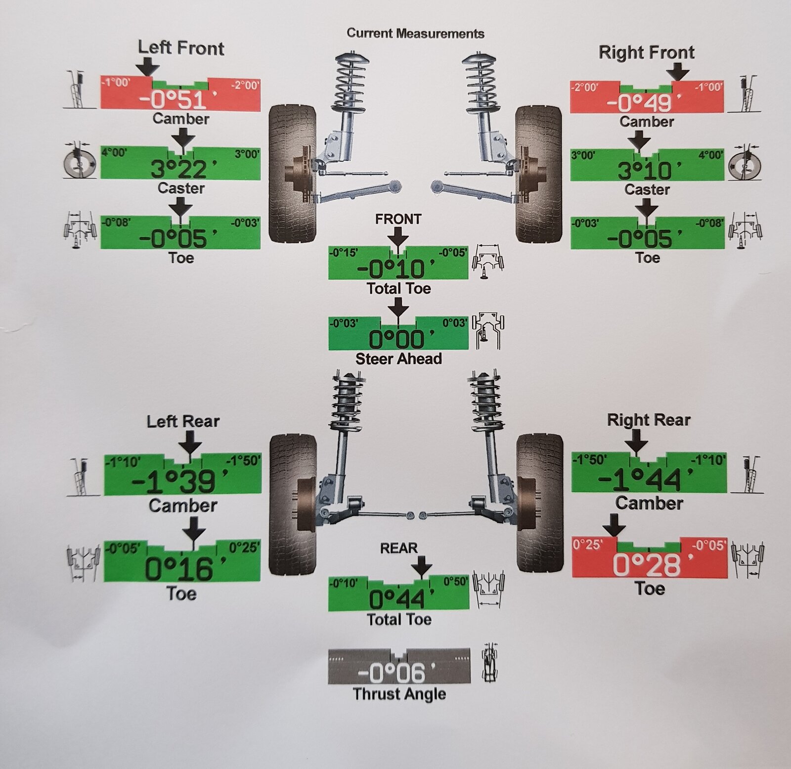

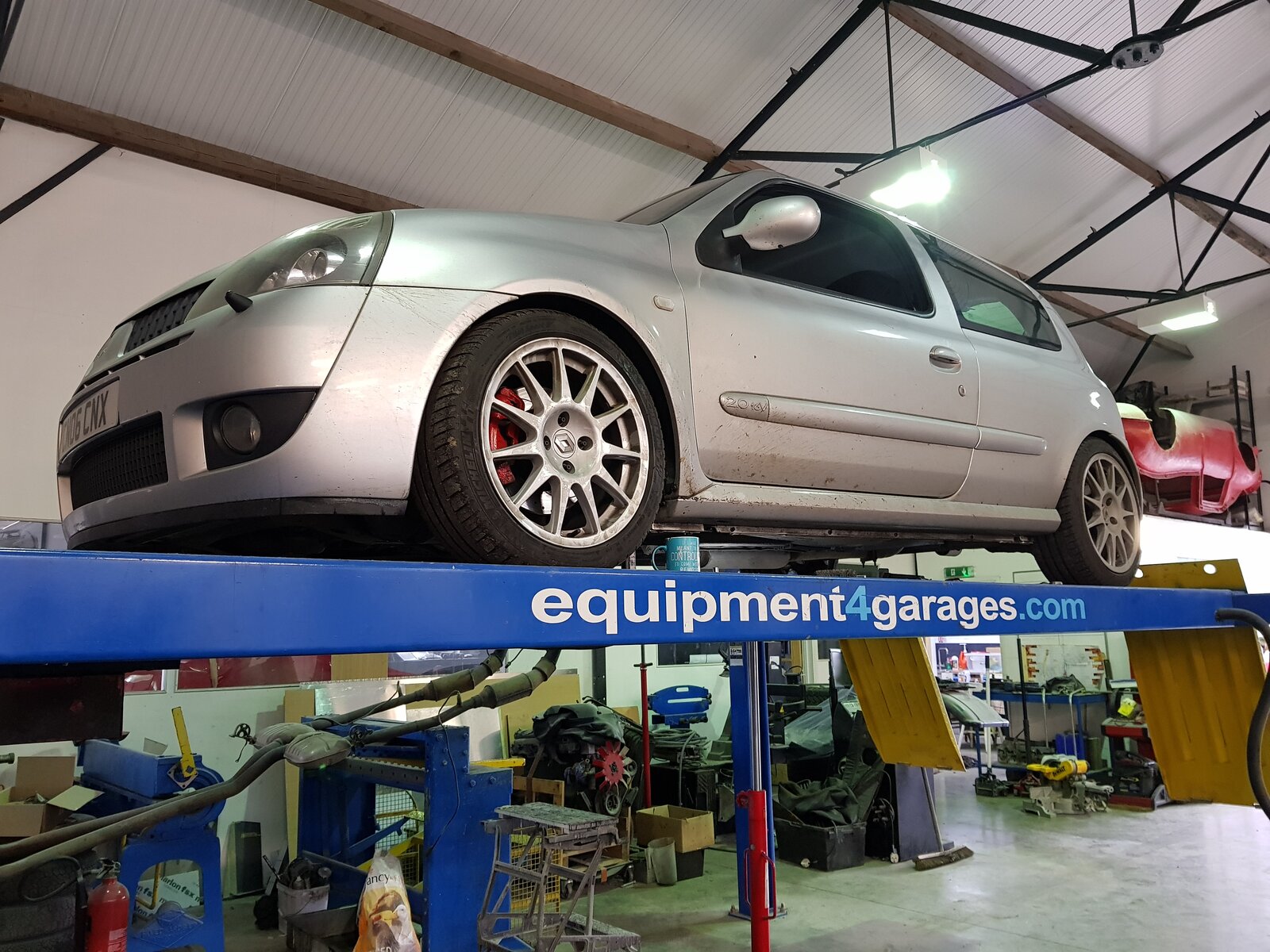

Christmas update,over the Christmas break i have managed to get a few jobs done.
-New Gen Rear Discs
-Wishbones
-Lower Ball Joints
-New Gen Tie Rods
-New Track Rod ends
-BMS Shifter

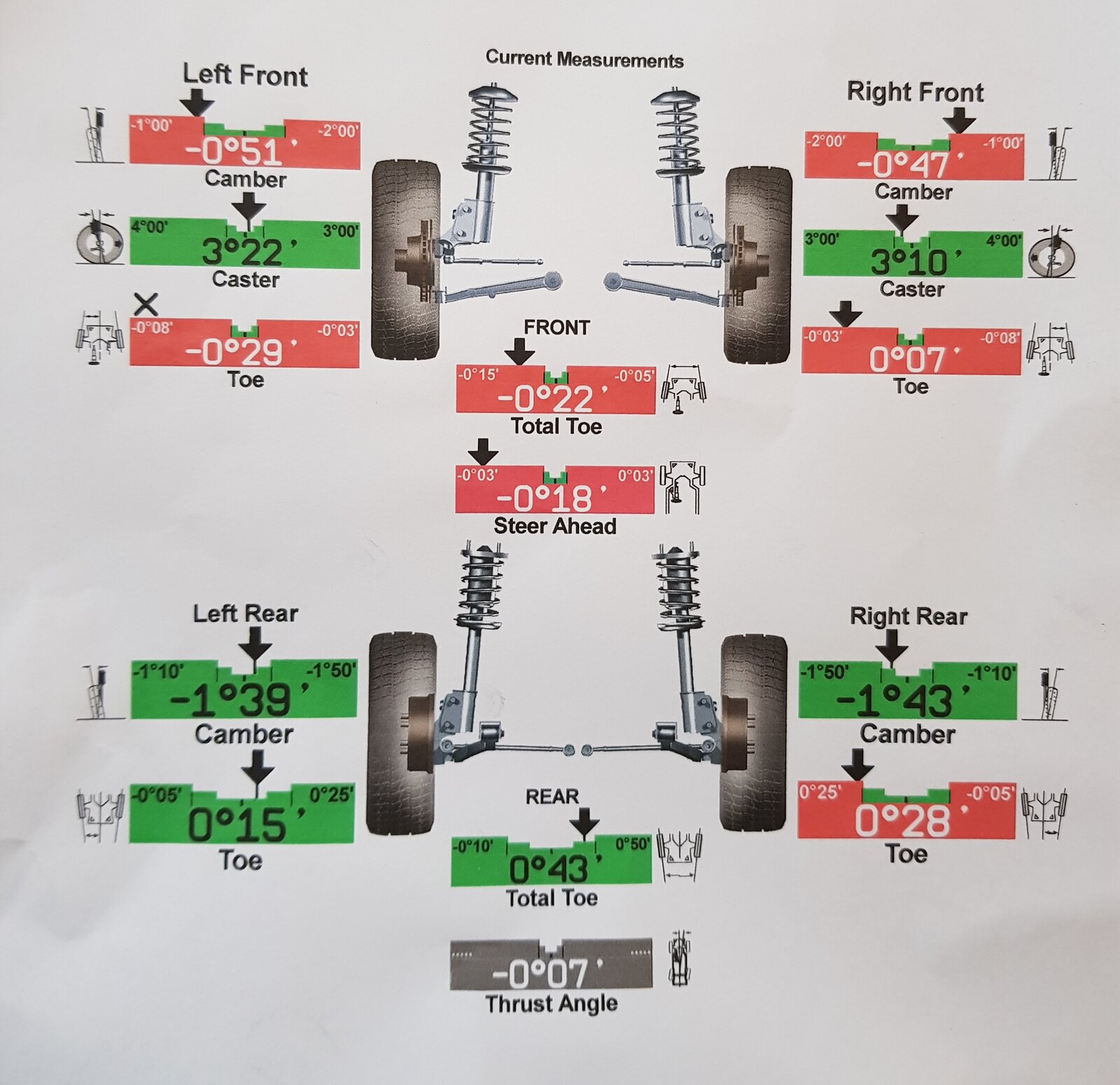

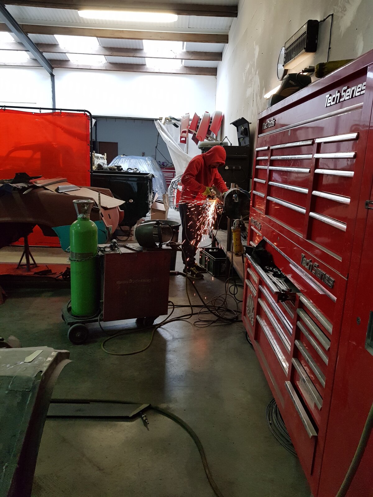

-Decat & OE Cat mod (sleeve fitment) Thanks to @Dr Jekyll welding skills
-Wheel Alignment
Got to say drives so good now after all this work is now done.Love the BMS shifter great mod & well worth doing i say.

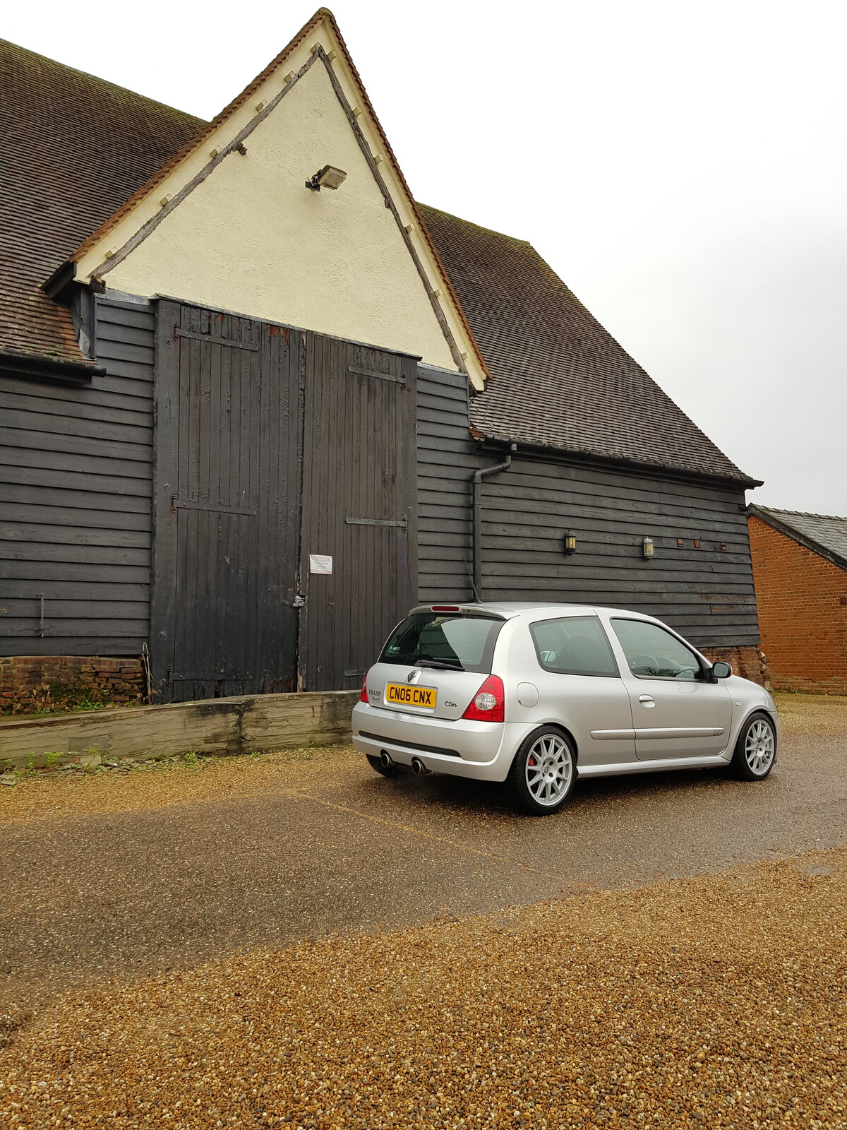

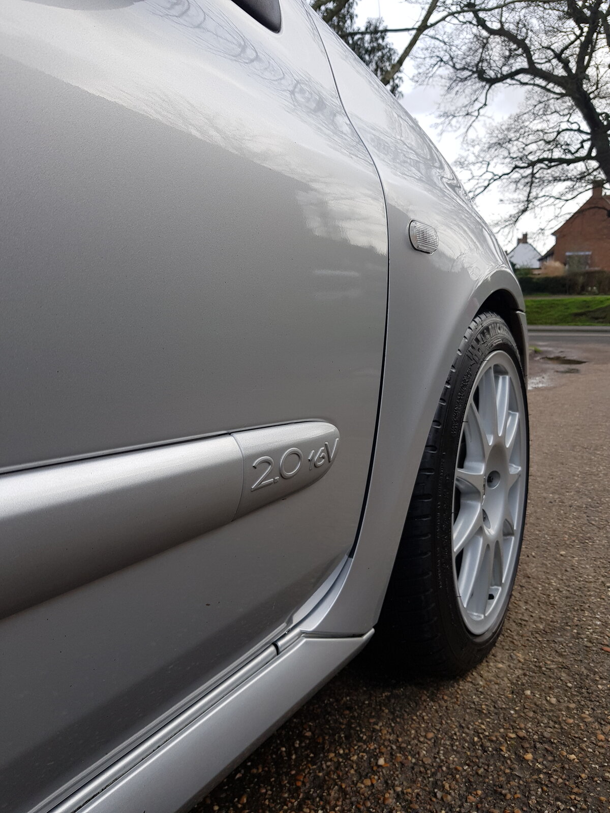

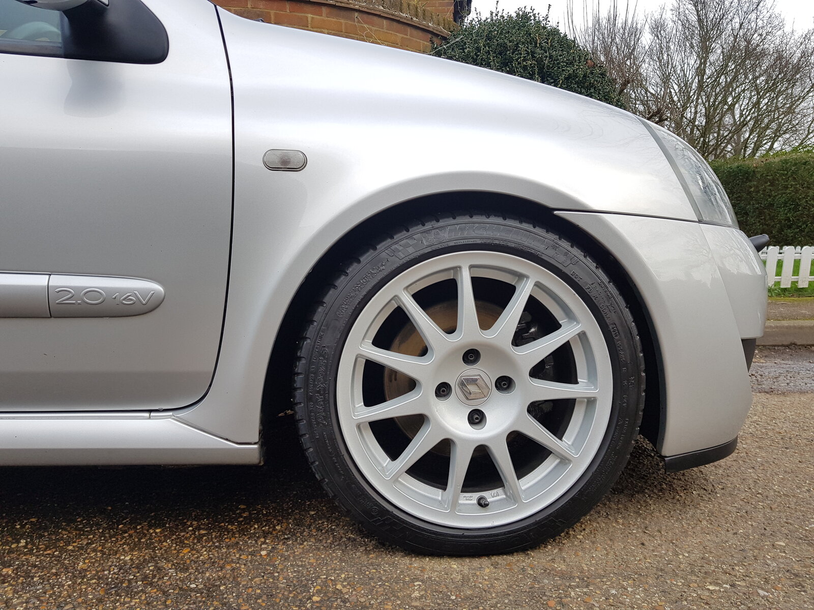

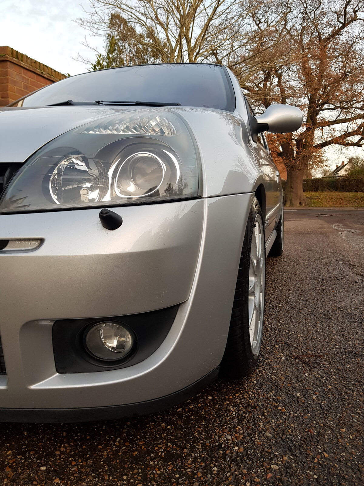

Just a few photos of bits & from the Wash today.

Your clios always look so good and clean looking. Good progress there. Where Do you get the alignment done?
MrBlonde
Thanks Very much mate👍🏻
I go to a Place in Witham called Tyre Smart,used them a couple of times now and is a decent smart set up of a garage.Also they use the Hunters set up

I have always found aftermarket exhaust systems sound much nicer on the 182. I think partly down to the rear box layout and the lack of spare wheel well. The RB 182 I owned sounded lovely. I have never managed to replicate this on any 172 I have owned. I have definitely owned my fair share of both in various stages of modification!
Think your 182 looks lovely. Every time I look at pictures with the number plate in the 06 registration makes me look again.
MrBlonde
Thanks very much mate👍🏻
I agree,i changed the exhaust on the cup twice & still wasnt perfect.
I also changed the exhaust on the 182 twice as it did have a non res ktec system which was to much for me & didnt sound right,now i have the Janspeed with centre box plus the decat & is perfect now.Nice sound just driving about normally then giving it some stick with the decat has a nice rasp to it without it sounding like a fart.

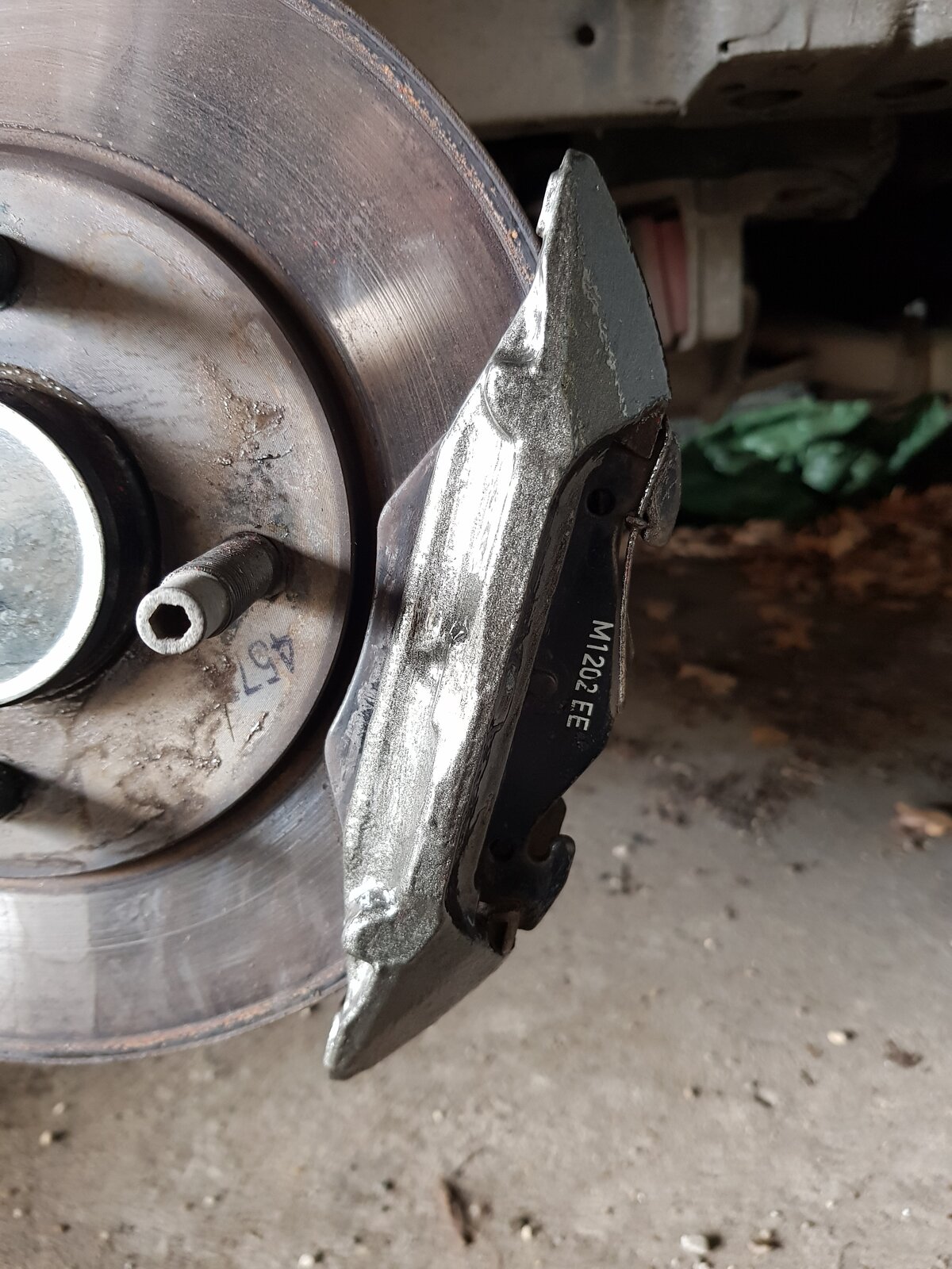

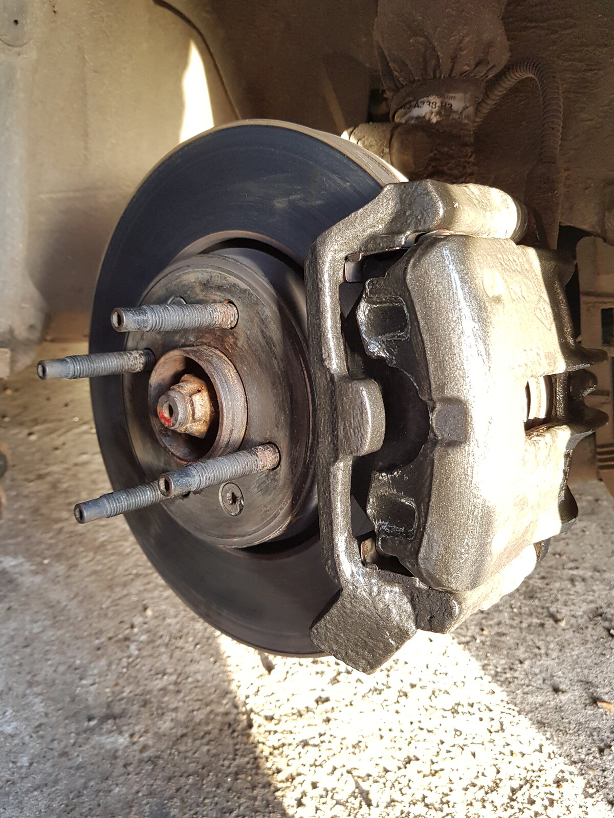

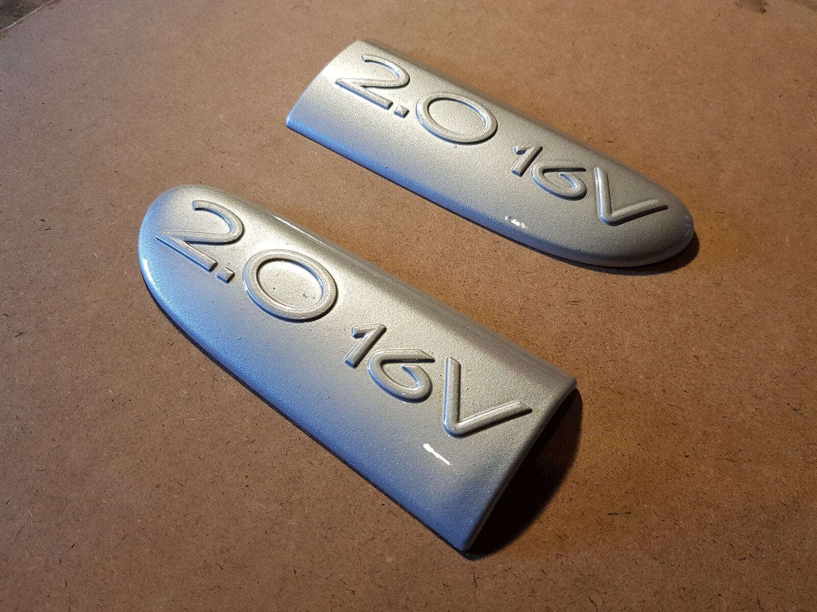

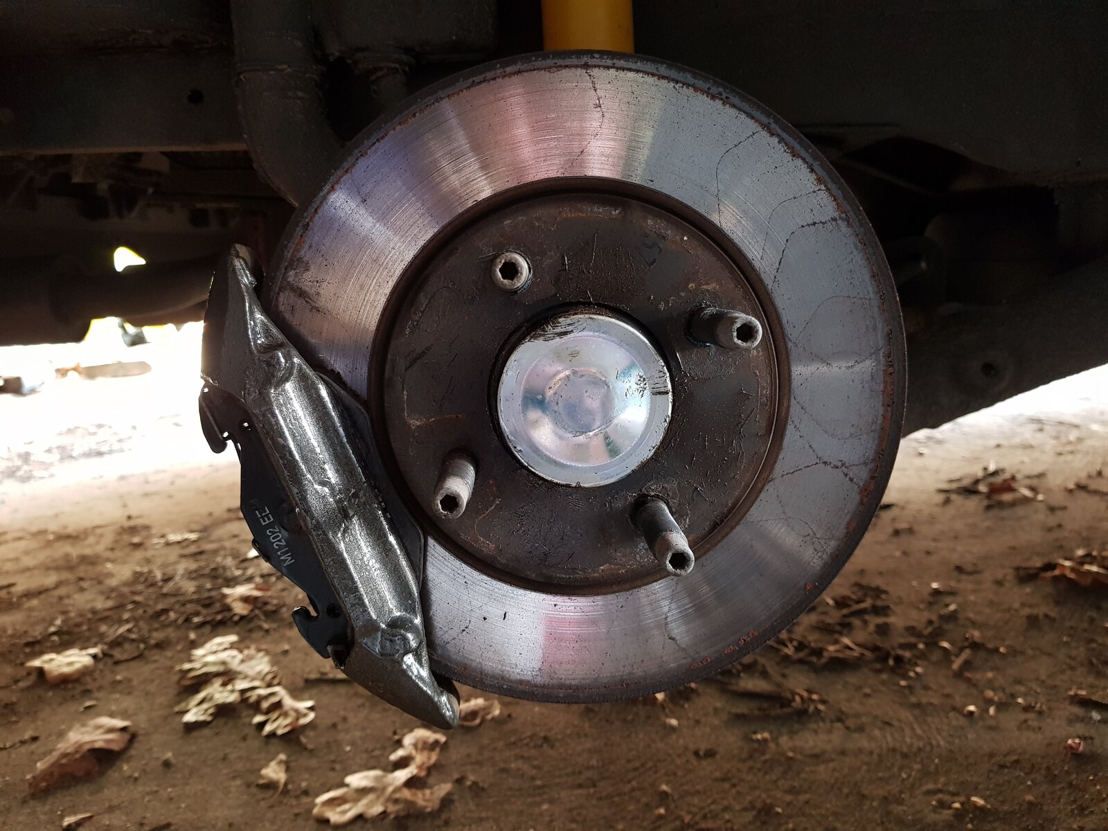

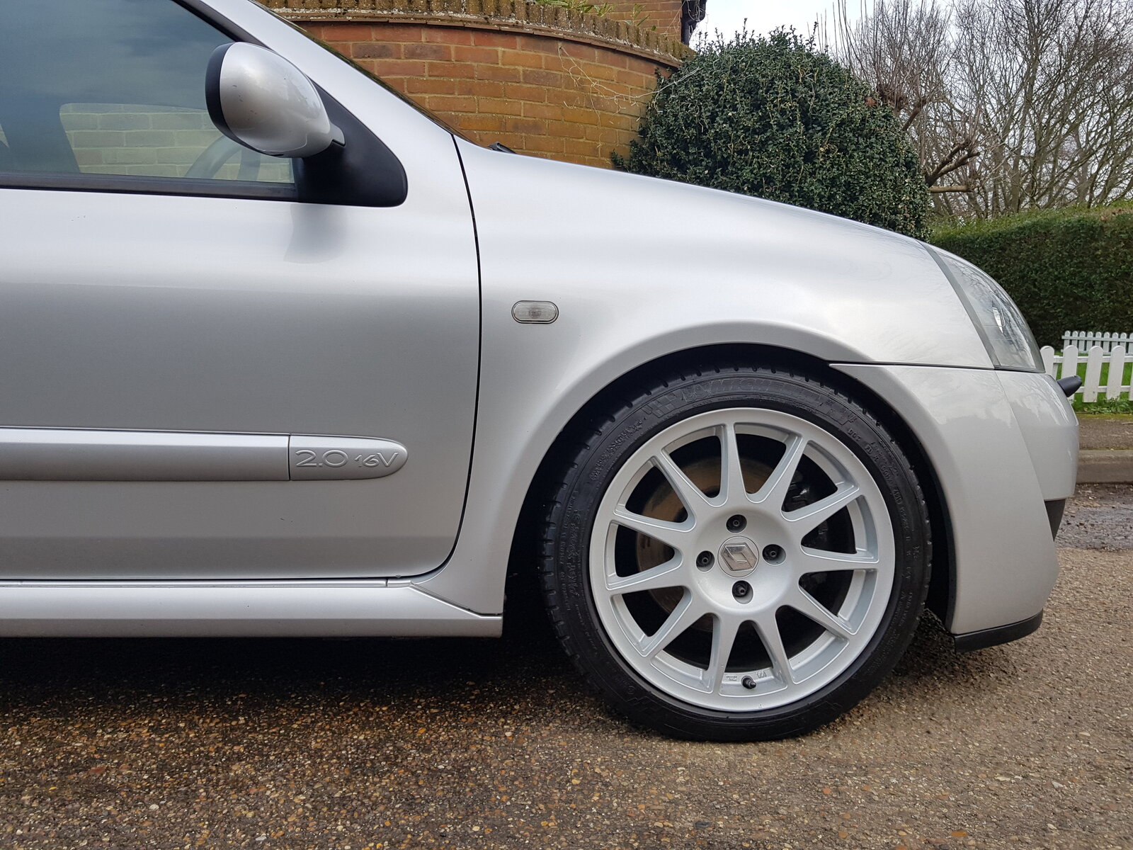

Managed to get a few little bits done this weekend,first off was new front wheel bearing nothing to interesting.
But i also painted the calipers as i couldnt stand the painted red calipers any longer,along with fitting the 197 style rear RenaultSport badge as i think this is the best rear badge,simple but modern tidy.Also gave the bullets a freshen up with a lick of paint to tidy things up.Will get some better photos up tomorrow once i have fitted back the bump strips and a wash.

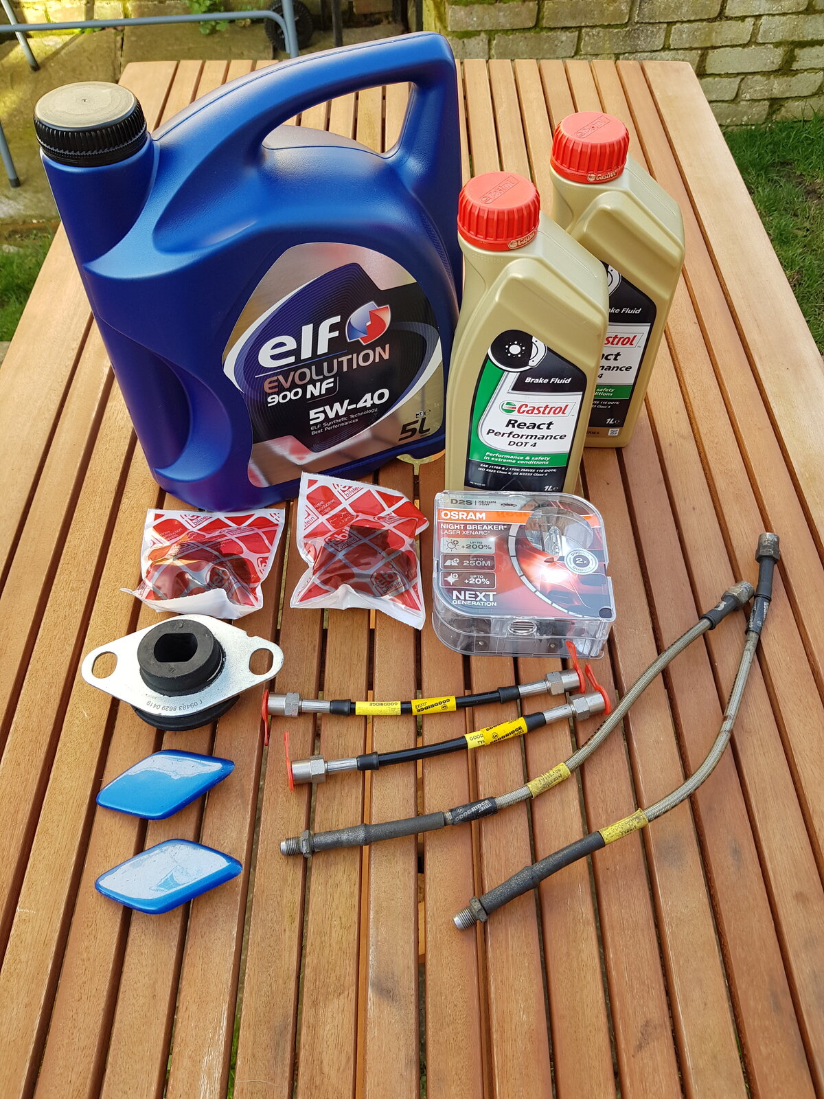

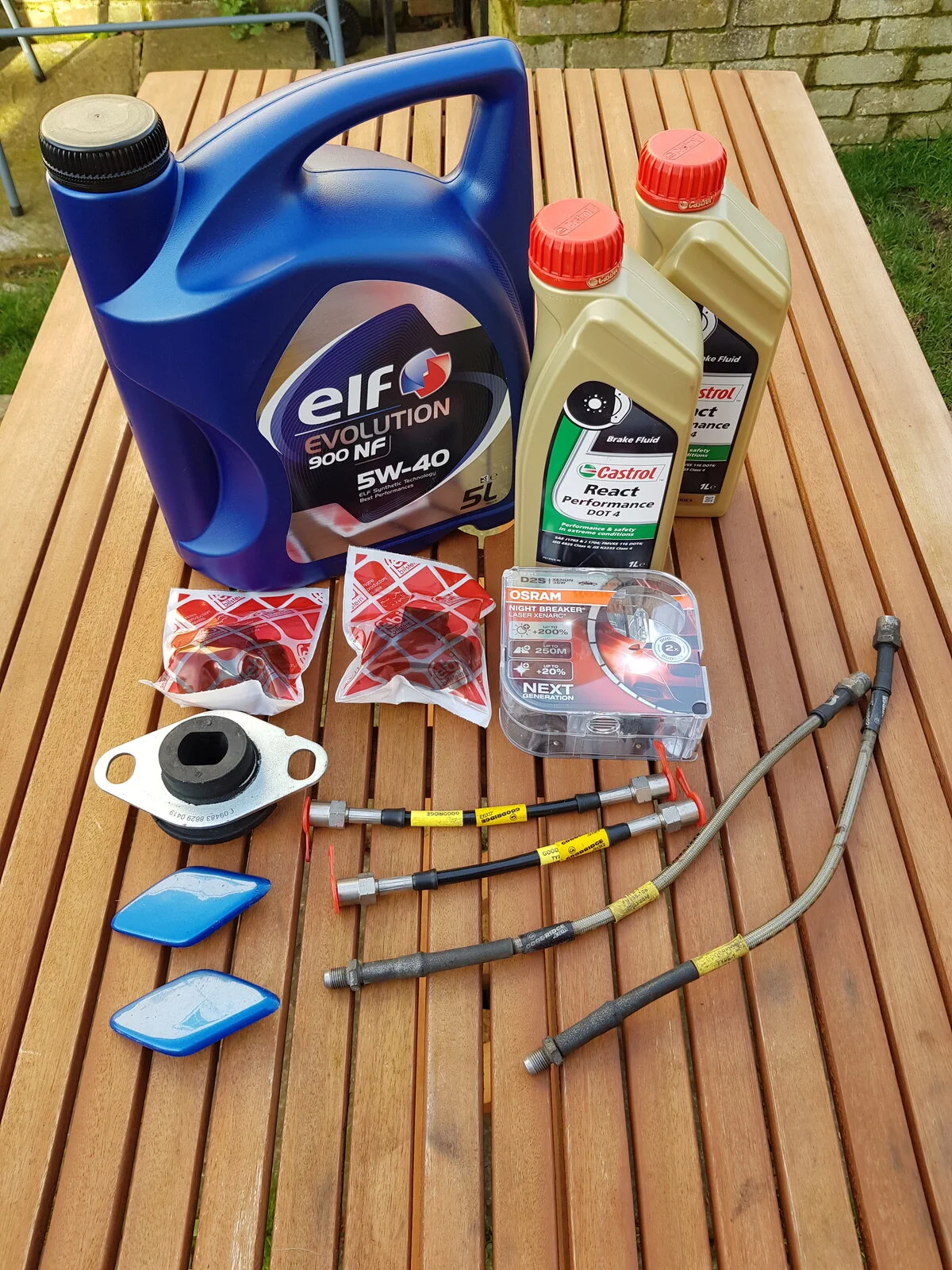

-Last ELF oil change plus oe filter.
-Febi Outer ARB bushes
-Headlight Washer Blanks
-Febi Gearbox Mount
-Goodridge Braided Brake Hoses
-Castrol brake fluid Flush/Bleed
-Osram Nightbreaker Headlight Bulbs

Look over Febi sway bar bushes in 6 month, mines simply crack in almost half an year.
Engine mounts from Febi are good.

Best place for them goodridge hoses is the bin mate
I'd rather fit washer hose than them bags of shite
Interesting, one friend does use them on e megane and they failed. I have in Romania a friend who has all the assembly line and make for me custom ones, they hold up fine. Maybe he is more careful...
I Changed My Name
Not all gingers stink of piss. But I do.
For the Clio they're manufactured too short so they foul on the shocker
Then theres the fact that the fittings are absolute garbage and dont seal properly
Radugns
  Clio 172 ph2
Well you are right, because at max turn, the hit the damper and wear down the seal. Now I have them for 225 calipers and are fine, a little longer due to banjo connector. I forgot about the last ones.
