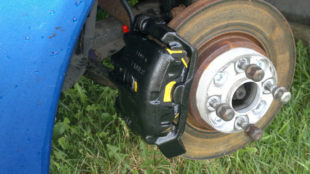

Yes, he's out there now fixing the 1st mechanics mistake - somehow the rear brake pipe nut wouldn't screw in the caliper - caliper off and an oh bugger moment...Got a tap from Dave my garage mate and all hopefully will be fine and the internal thread will be OK - only flattened the first thread so nothing too bad...
Big Tut form Dad...LoL.
Bigg Red made a good job of the refurb.
Wish I didn't have to had them back so soon as would've gone for their polymer coating, heat oil rust resistant. The normal black paint is already coming off the rear with all the messing about yesterday.

Brakes all sorted, though the arm on the compensator valve is a bit stiff (may have been the problem all along) so it's either up or down. Gave it loads of WD40 and movement and left it up, now the car off the jacks I'll see where it has ended up, ran out of light outside so will see what it's like tomorrow.
Down is least effort to the rears on the compensator, up is max. It may lock up if up... If you put your hand on it when someone presses the brake you should feel it move down as the piston takes some of the pressure away from the rears.
There should be a spring that goes into a hole in the chassis and on to the arm of the compensator to keep it in the up position. It makes sure it returns back to that position then all the time. As mark123 is saying, it should move downwards with the brakes applied to reduce the pressure to the rear brakes.
Mine is held fully closed and the braking effort to the rears is excellent. Doesn't lock out either, but you can hear the tyres just starting to come close at times. With sticky track tyres I doubt it will be much of a issue though tbh.

Cheers Mark....I'll check out the movement later, even when it was down didn't notice any braking problems at Mallory. There is a spring there may be a bit old and tired. The arm was V stiff at first.
Camera looks good, didn't give it a thought that it'll be embedded so doesn't need to be as good.
Closed means most effort to the rears, arm up?
Can it be replaced with another bias valve, Triton has been mentioned on here? If so job for over winter.
Yes that's it mate. Closed = full effort to the rear brakes.
You could replace it, but i would've thought you'd be better off replacing it with a new Renault one tbh.
Probably the better option....sent renparts a PM to see if they've a used one.
