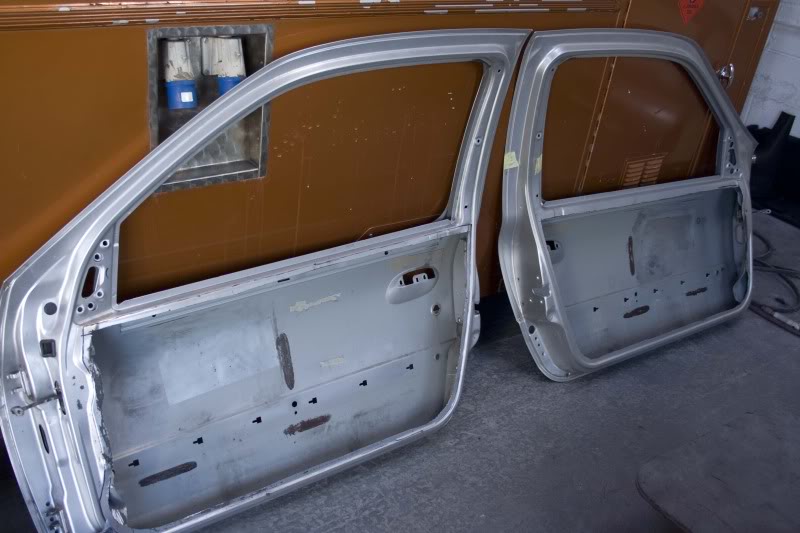

Hi Mark, found pic's here post 617, can you remember how they came out?

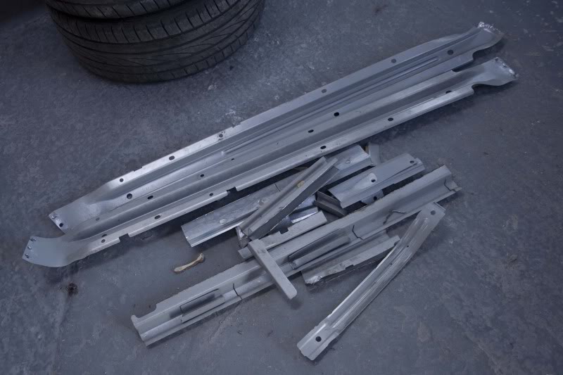

they are spot welded, drill them out with a spot weld drill bit, they come out pretty easy, dependent where your bottom hinge is in relation to the spot weld though, on one of my doors i could get to the spot welds, on the other a hinge was in the way and i had to use a bit of persuasion.
as for not removing them... the cage is there for protection,
quite alot can come out
and can be lightened quite a bit

My reasoning behind having the door skins empty (apart from weight saving) is that in a side impact my cage takes the hit and I didnt want any bits of metal in the door twanging out and jabbing me in the thigh. If it's just a flat skin that is unlikely to happen.

Just remember to leave a lip for mounting your door cards!
what he said, you can just about see a permanent marker line in these pics that outlines where the door card will sit...

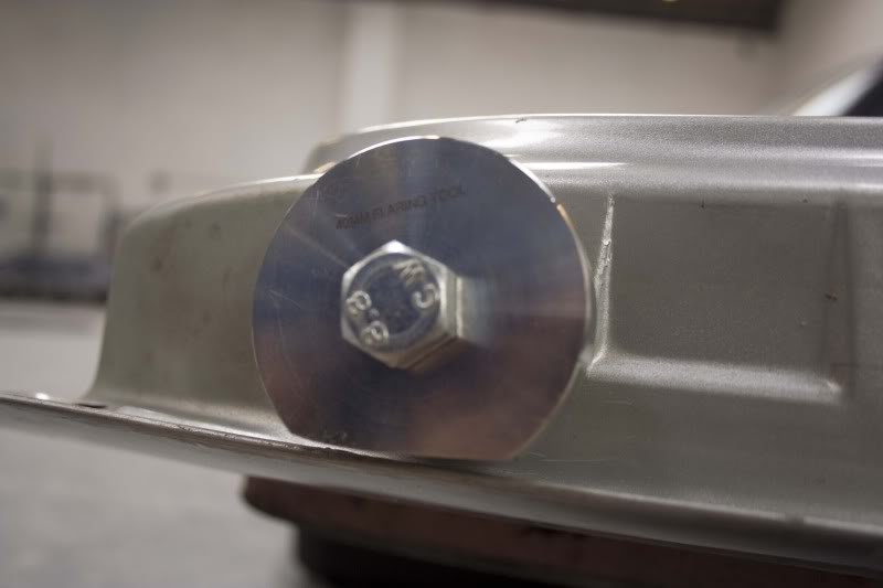

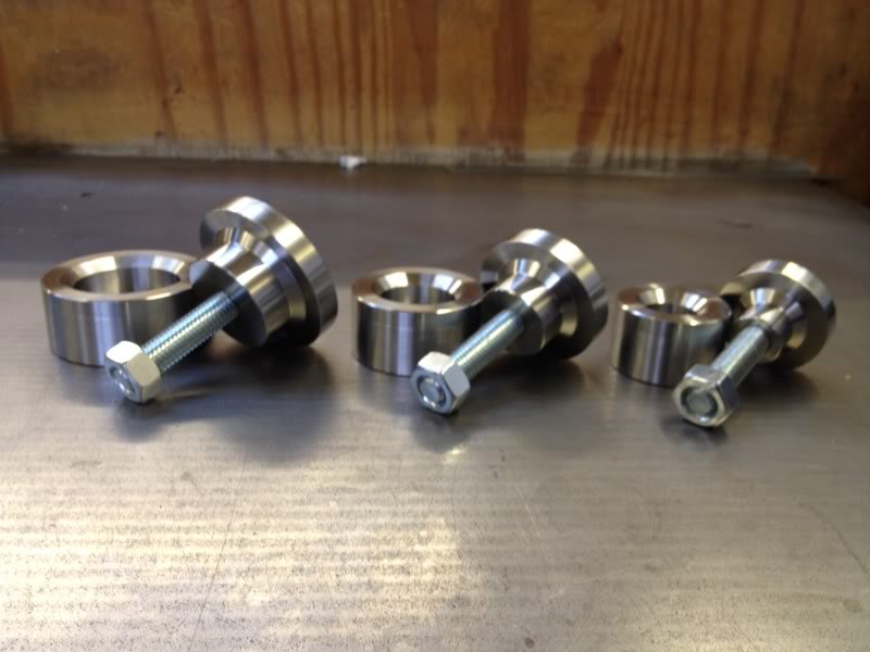

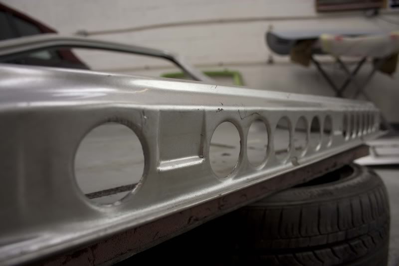

I've a bit more to come out - I left the widow slides in etc. What size hole cutter did you use, take it it's s spanner\socket job?
Ah, already cut most of the door out back in Feb and have lots of lip...- just looking at what's left to remove. The 18kg quoted above was for the door stripped\cut..
Some good reasoning....hmmm did forget about the cage being there.
i think the whole was 40mm, drill out with hole saw then use a swagger to create the lip and strengthen the panel again, (see swagger below, as you say spanner and socket job)
Easy...thanks...
