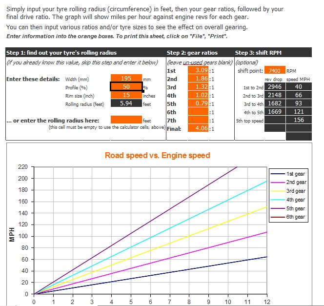

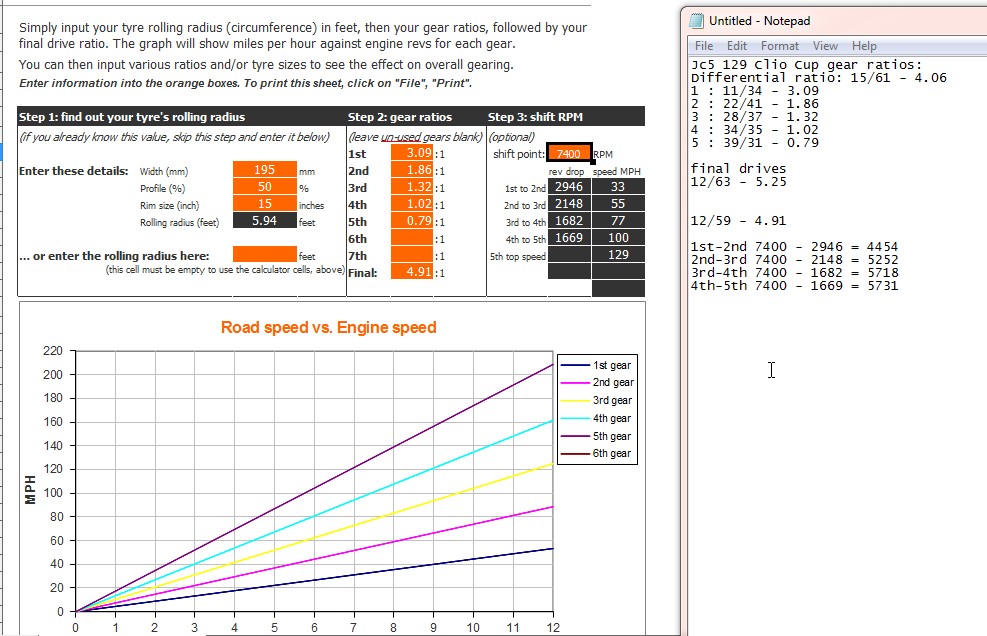

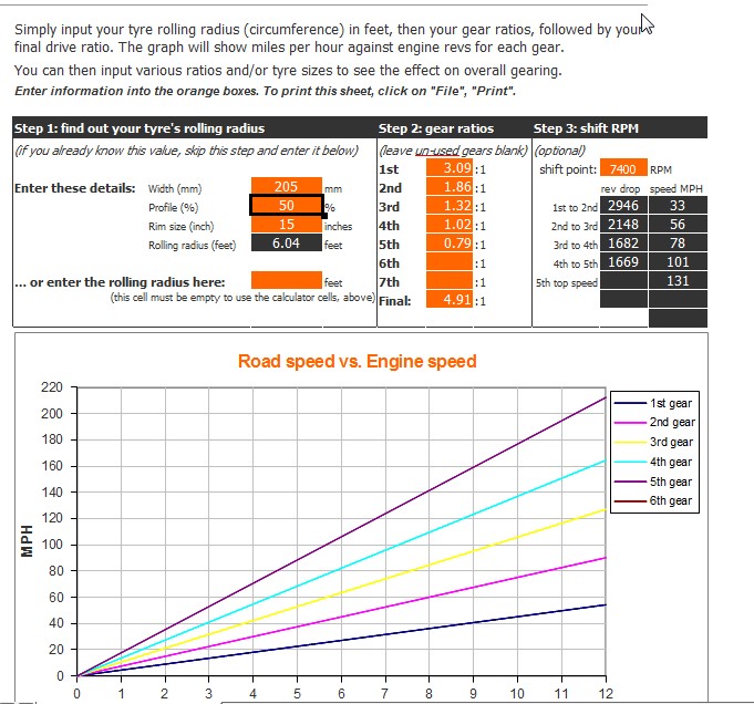

Been messing with some final drive figures - is it as simple as this?
Got the JC5 figures from the forum. The final drive figure from the Bacci web site
Put into an excel form from gearbox man - and this is what I got...
with 205mm tyre width
and with the normal final drive 4.06 in and 195 tyre width
