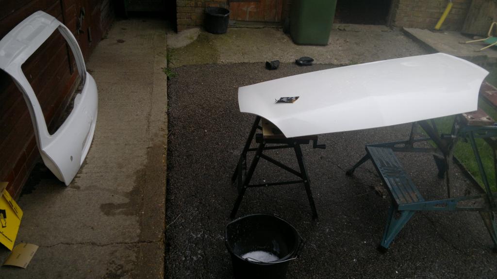

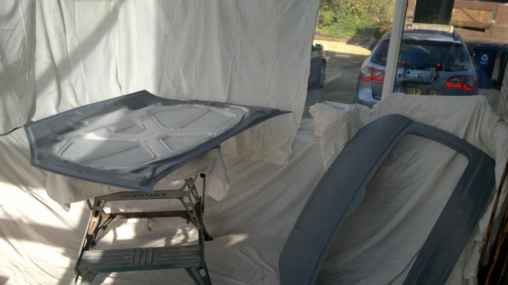

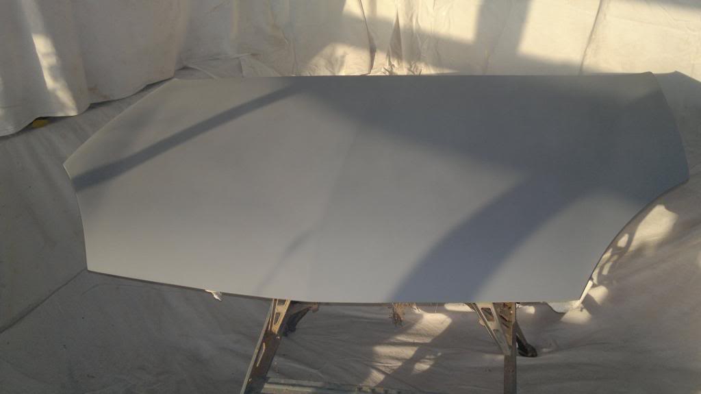

Had a couple of deliveries last week, rear brake calipers returned from Bigg Red and my new fiberglass bonnet and boot, unpacked and they are as good as expected - light, bonnet 4.8-5kg and boot with no polycarb window 4kg and almost ready to fit, some holes to drill and that's it. Oh and a paint.

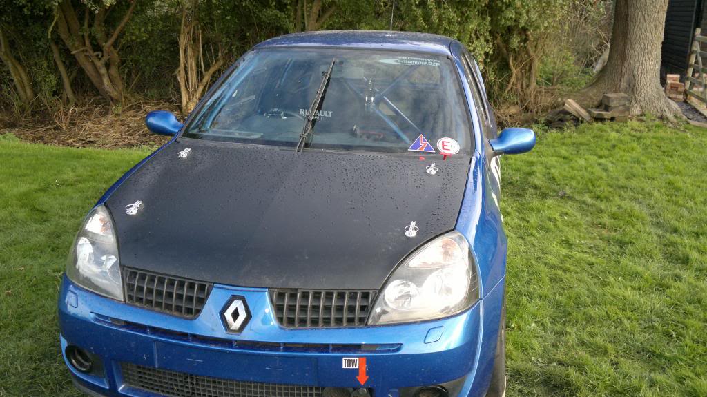

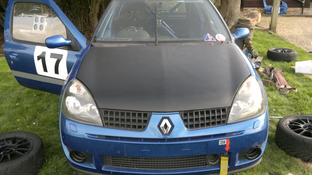

Also started removing the bonnet and boot - Bonnet was easy, though I cut a bit of the inside wings off to get at the bonnet hinge bolts - pikey, but after the faf with the calipers wasn't in the mood to remove the bolts screws\allowing me to move the wing 1cm to get at 2 bolts. Bonnet weighed in at 13kg with hinges\bolts attached - 9kg saved there. Just waiting for the bonnet pins to arrive, using four pins as not going to put the Aerocatches back on, will drill, spray, fit and that's all done.

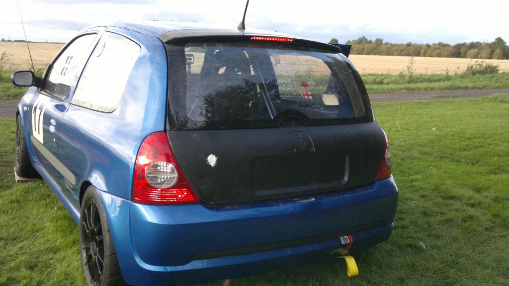

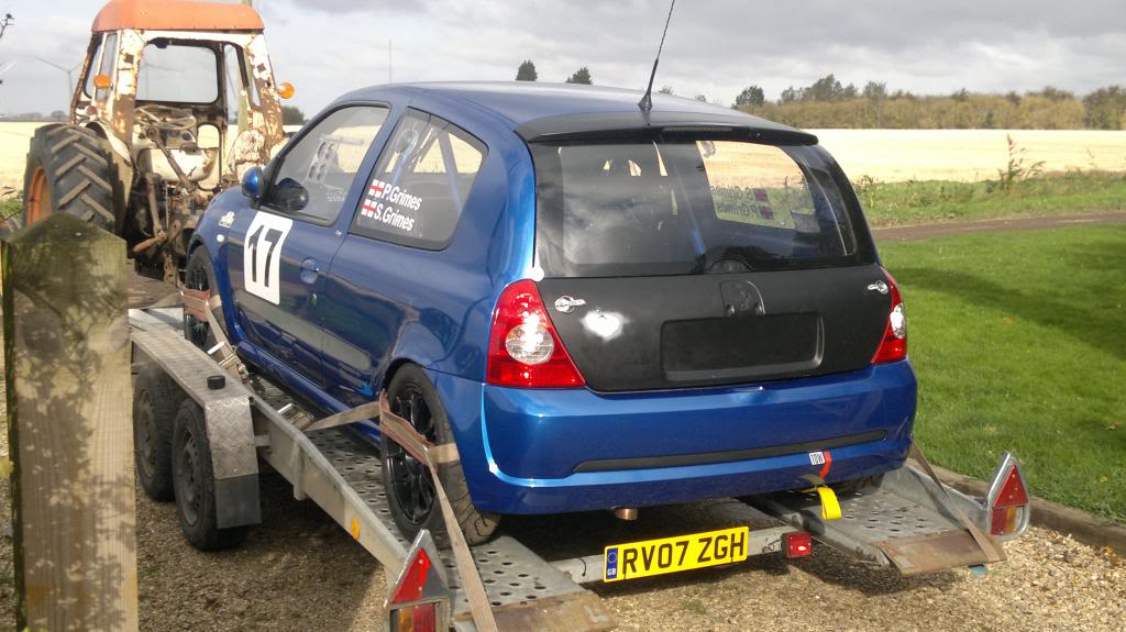

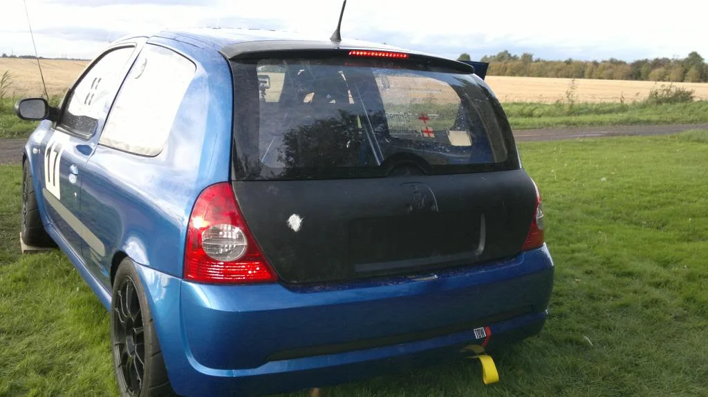

The boot wasn't so easy - couldn't get the rear polycarb off - tried for ages to get a hole and then cut the sealant - the rear polycarb has only been on since March and thought it'd be easy...going to get the bloke back that fitted it to remove and re fit. The sealant would've cost me £10 and so for an extra £10 I'll get it removed and refitted. Now that's easy!!
Fitting the fibreglass boot as I see it I have to cut two access holes for the hinges (so can get the nuts on) and then drill the holes for the hinge bolts, attach hinges and then fit back to the car. Hope it's as easy as it sounds. Going to attach a length of cord, one length to each side so when open the wind won't blow it over the top onto the roof.....and a prop as I'll not be replacing the boot gas struts. Not had the boot door off yet so no weight.
