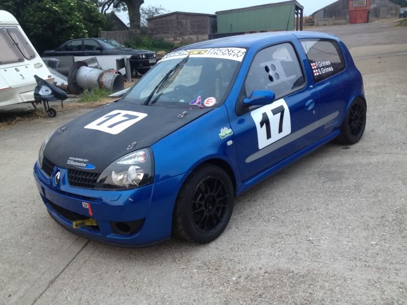

Toastfrenzy's Tin Top, some say...........

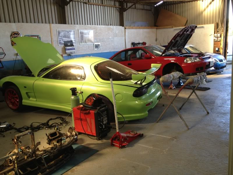

spent the majority of saturday passing moo tools so saw a lot of this coming together, really nice work. Seems like its coming on even more yesterday
however, the other end of the workshop is better looking...

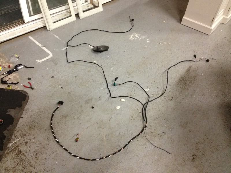

Right been finishing the looms off ready to transport over to Dan for him to fit the engine

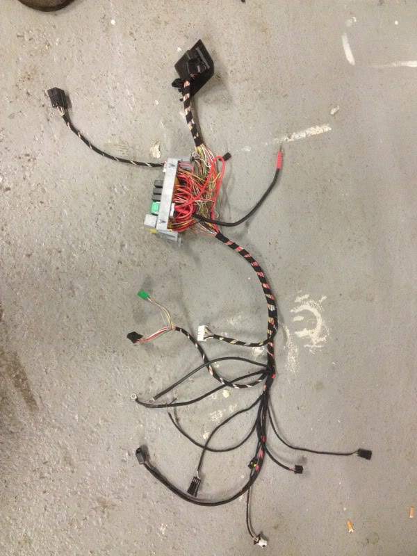

Dash loom all taped up
Tail end loom

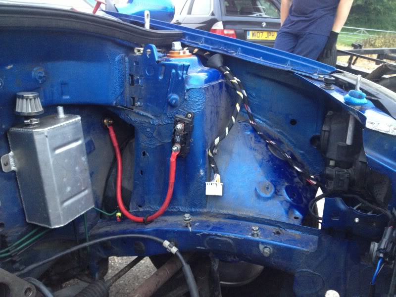

Battery through panel to safely get the battery feed safely into the engine bay

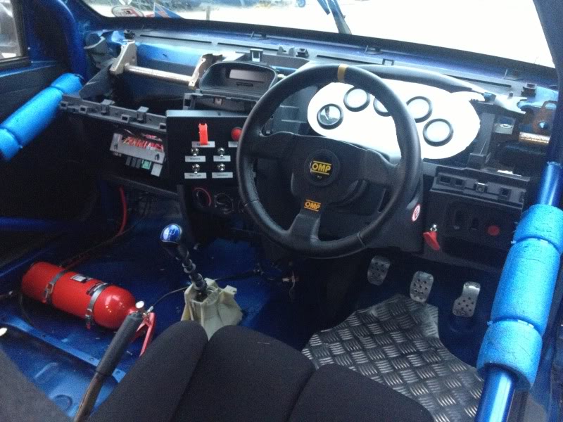

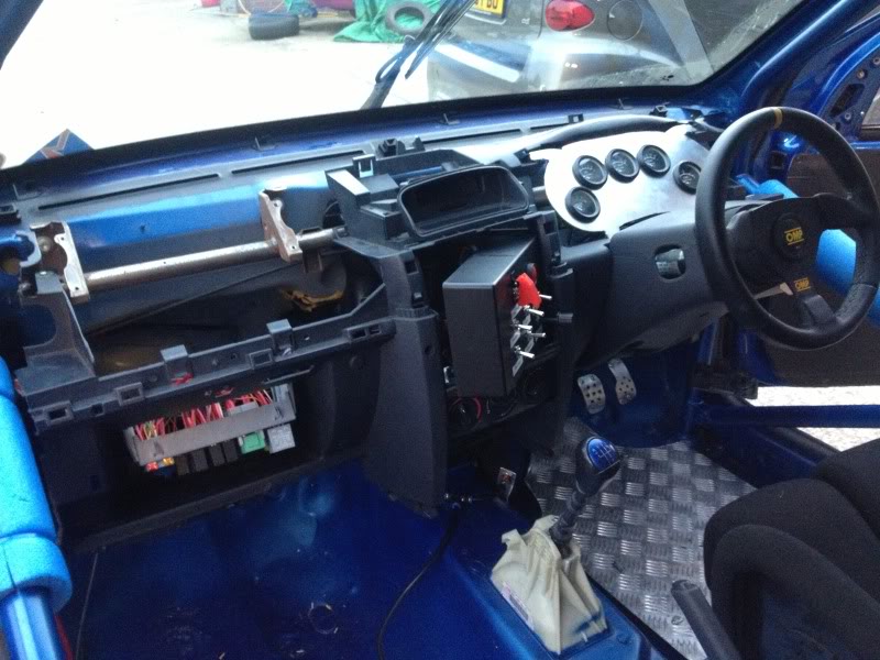

Dash mostly built up. I've left the top off as I had to find a wiring diagram for the rev counter and shift light so I can put a plug on them (the dash loom already has a plug connection in it for the rev counters)

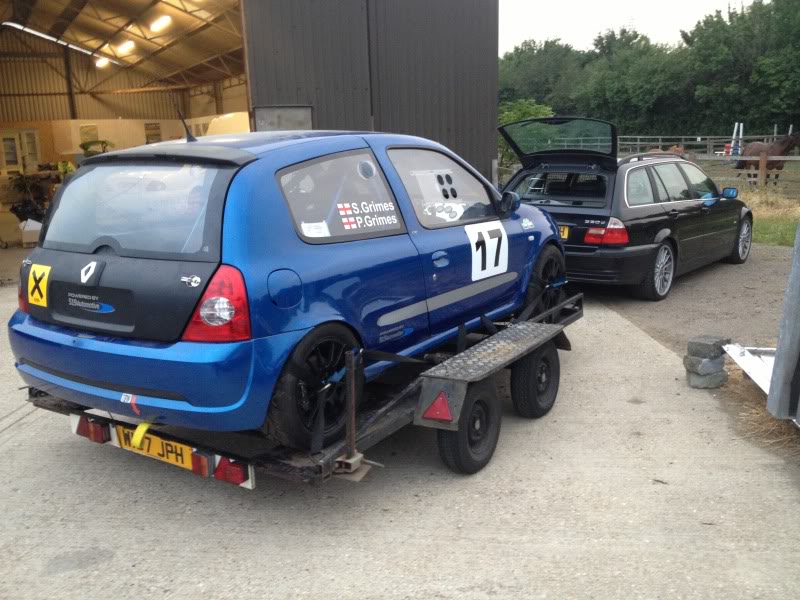

Ready to go

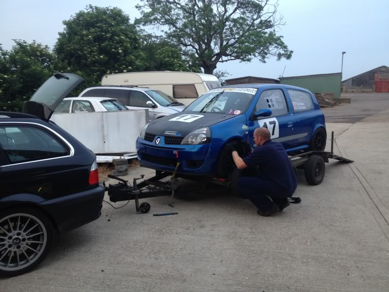

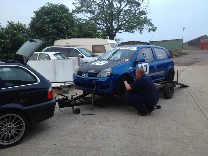

Loading on the trailer
Electric power steering made this so much easier
Off on its way to Dan!
2 pin plug connection has been fitted into the front end loom and comes out in the n/s inner arch, fused in the fusebox ready for the transponder
The power steering box needs mounting to the bulkhead on the o/s of the steering colunm and would probably be best if Dan gives the car a once over

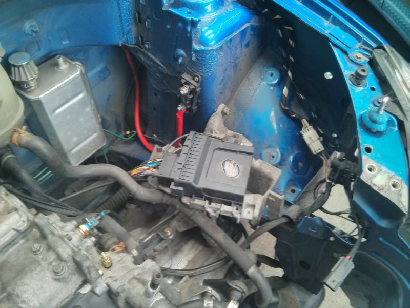

Looking good guys :) Interesting how differently you have done the loom compared to Rhys', whats the main reasons for the changes? Budget or client spec?
Whats the white connector for? Engine loom? Does it have any form of weather seal as I can't say i've seen connectors like those with any? Just worried if its for such critical functions with no protection
very different car, there's a LOT more functions than Rhys's which was also a more "showy" assembly. The work thats gone in to replicating some of the functions that the UCH used to control has been extensive.
White plug is an OE one, so it will be fine. It's for connecting ECU loom to body loom (gauge sensor feeds etc) Exactly the same fuction it performed on a stock car. Stop over thinking ;)
Unless I'm mistaken, isn't that white plug usually located in the engine bay relay/fuse box? If so I'd say its hardly weather proof at all tbh. It's protected from the elements to some extent by the fuse/relay box. Or am I mistaking it? Either way I'm sure it'll be fine in a race car.
Engine loom, binned off the Neptune connector for costs, this was mine already. Yes it did use to live in the black engine bay fuse box, it's more exposed now as it's outside of the fuse box but should be fine.

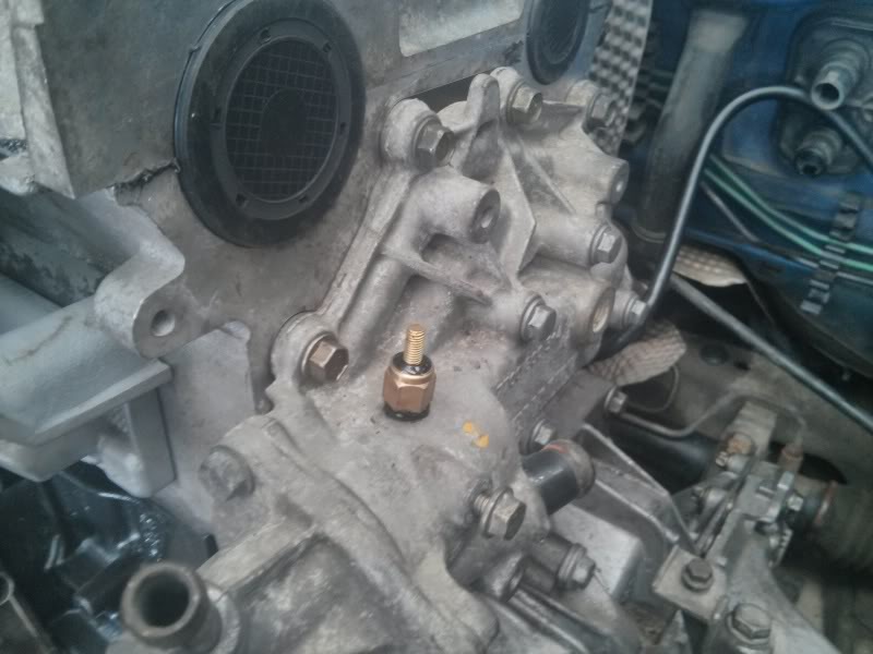

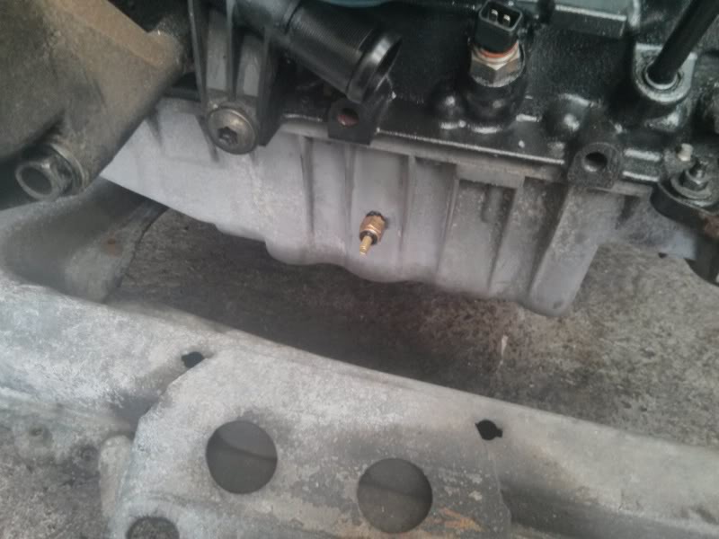

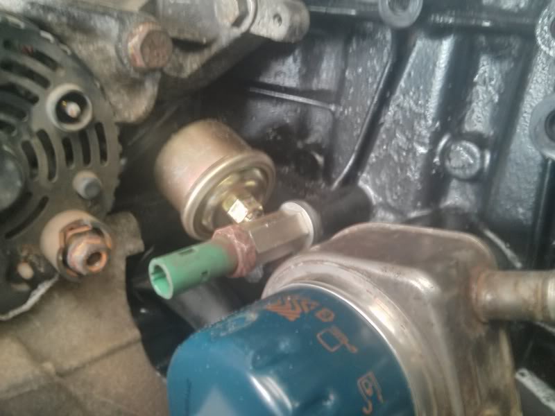

temp sensors fitted for gauges
Had to use a T-piece due to the extra size of the modine heat exchanger rather than screwing the sensor straight into the block.

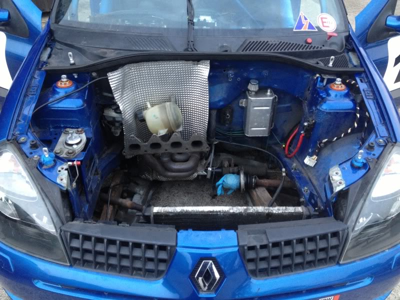

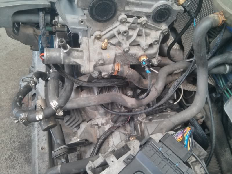

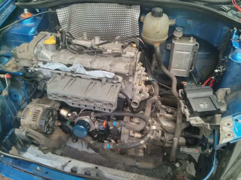

Engine loom all built and in place.
Thanks Dan, thinking maybe I should've cleaned up the bay a bit more and painted a few other parts (not that I painted the block). Had plenty of time too.

well the blocks painted, and the head etc has all been acid cleaned. just not blinged up. It's all actually pretty clean (apart form a few bits needing a wipe over), just the hoses make it look worse. I even had the header tank sat with bleach in it overnight to get some of the scum out. I've a few bits of paint to splash around yet though, don't worry

The dash bottom and top along with central switch box and EPAS ecu are now all fastened and secure (about 6 little jobs to complete)
Rear loom all back inside of the rear left and right quarter panels, out the way and P clipped where required
Checked all the functions, EPAS - (this is a good mod, £80 well spent!) cut off switches, power to gauge panel\gauges work (those that don't need a running engine)
Gave it all a good look over when back on the ramps - nothing amiss, ah except a heat shield
All that's left now;
Fit driveshafts
Engine oil
Gearbox oil - still at Beaniespoort HQ, who are now in Turkey (at £70 a fill I put in a container & left with car)
Coolant
Air box - still at Beaniespoort HQ, who are now in Turkey
Fit inlet sensor
Fit connector to ? (forgotten which one )
Fit transponder - will do at later date, still not got one yet
And Map!
