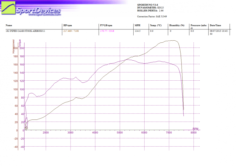

Emailed Pete a graph. I'll post once I know he's seen it. Few bits to sort like cold start and a little flat spot low down, but it's brilliant basically :D

looks like I forgot to check the weather station was turned on, and I forgot to change the file name too LOL, but it was warm as hell so compensations would have made result marginally higher. I'm very chuffed with that

217
it's very high compression (scary high) all forged and balanced, 422s one piece valves and catcams valve springs, reworked standard inlet with ph1 cable throttle, and Canems ECU (and a few other bits here and there)
Basically just throw this lot in a block, and hope ;)

Thanks :D I'm just really pleased with the torque spread, the lack of itbs sometimes pushes the peak right up the revs with wild cams. I had 215/165 in mind that if be happy with, done similar spec before on single throttle but not for a few years now.

Cracking result Dan glad I've waited, looking forward to seeing how your 1st run goes in this Pete, I just need to start saving now.

We've learnt a lot from you Tony, now We'll be able to learn more as able to keep up - on the straights at least.
Awesome results! Hopefully it will be hassle free racing from here on out :)
Seen the last of the limp mode issues for sure, the rest, well that's racing...
217 and no bodies? Impressive!
Quite like the numbers myself too, but I suspect the driving will be quick!
All thanks to Dan for the engine! I just provided the means.

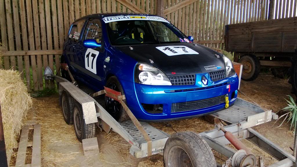

Did a fair bit to the Cup this weekend, set up the intercom and aux power to the central X area of the ROP, had to use a few tie wraps mind. Completely cleaned it inside - load of oil, wires, crap form all the work. Fitted the pax sub frame, seat and harness.
Jacked up the trailer blocked it up on wood blocks to get underneath gave it all a once over, again.
All that's left this weekend is wheels (and swap race wheels over to track rubber, nearly worn out A048's) off, brake etc check, may bleed through some newer brake fluid, oil change and that's about it. Hopefully.....
After the steering column change to EPAS having to get the geo re done as didn't line up the splines all that well, steers straight but no amount of adjusting the steering wheel on the column will bring it all central. Nevermind.

Spent the day yesterday getting the Cup ready for Cadwell on Wednesday, found that with the heat exchanger the oil temp and the water temp both stayed at 75 degrees. Always wondered what effect it had, be good to see where the temps are on track.
Can't wait to see what the 170 lb\ft feels like.....worth every penny no doubt!
Quick pic, all clean and ready to go.....
