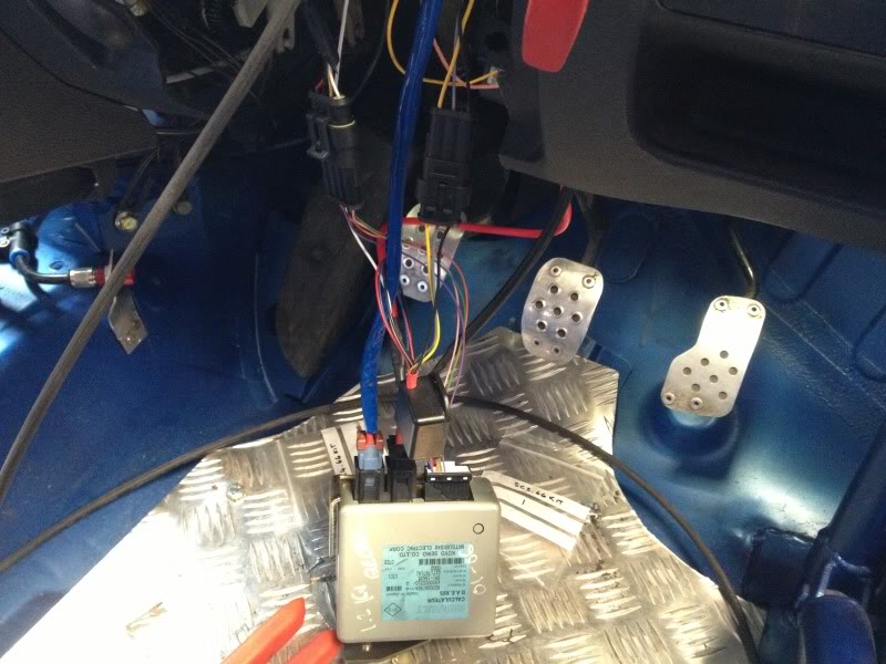

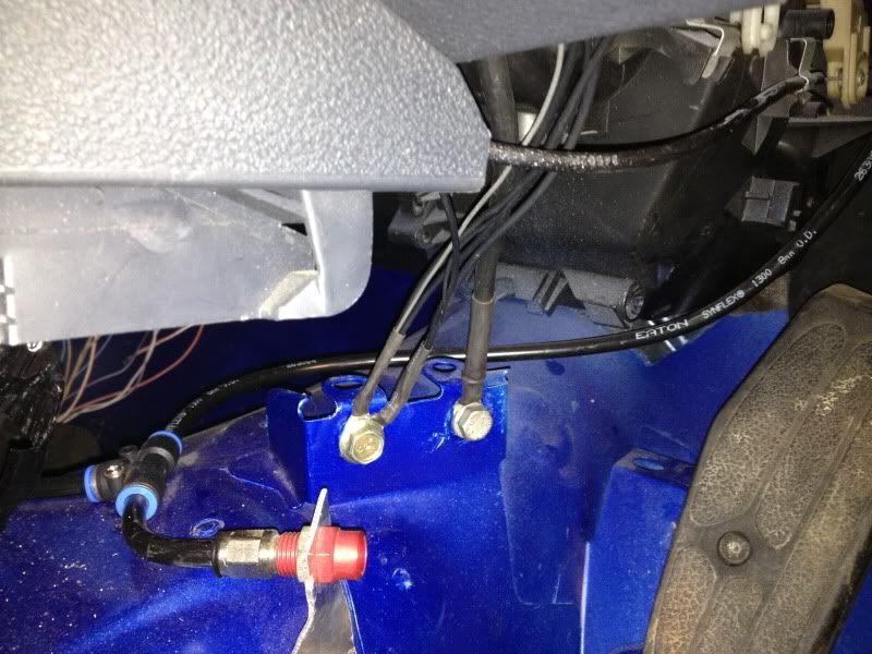

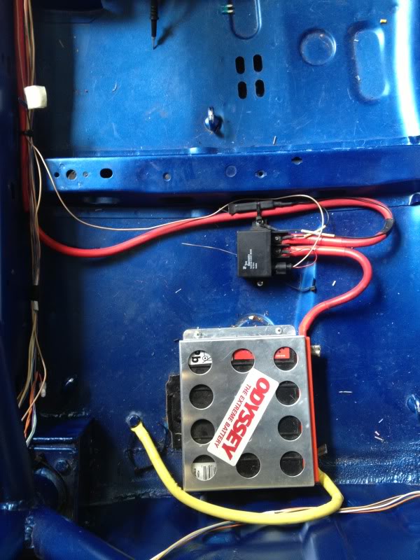

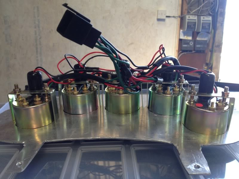

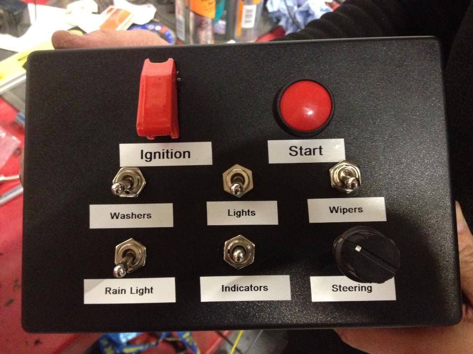

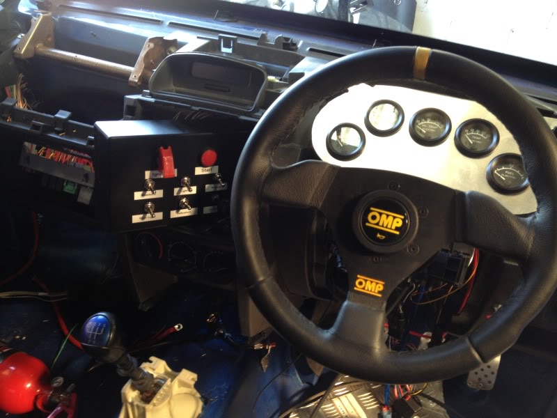

Hi there, sorry for the lack of correspondence about the loom, but I've been working everyday till late into the night to get this done, so haven't had time to get to the laptop to update. But after a day down the workshop today I decided it was a good time to post an update on your thread.

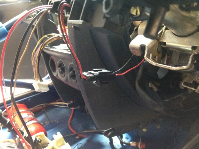

The main things on this loom build to achieve was to remove the UCH completely, incorperate all the functions of the car into one place so there are no standalone looms, relays or fuses for systems like power steering, battery kill etc and ease of maintainence, so the loom must disconnect easily from every component.

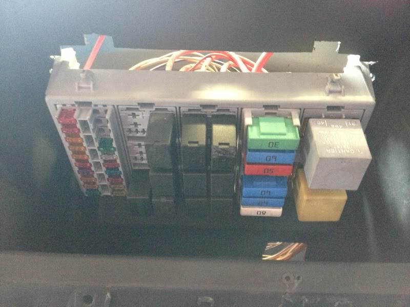

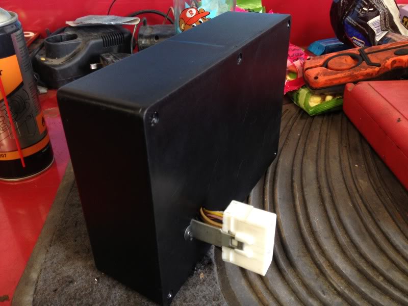

The fuse and relay box is complete which completely removes the UCH along with all the original fuseboxes
The plug connection on the back of the switch panel so its easily removable, also a decent immobilizer if removed. We were weighing up a serial port style connector, but after some concerns about amp draw capability of the connector decided to go for this

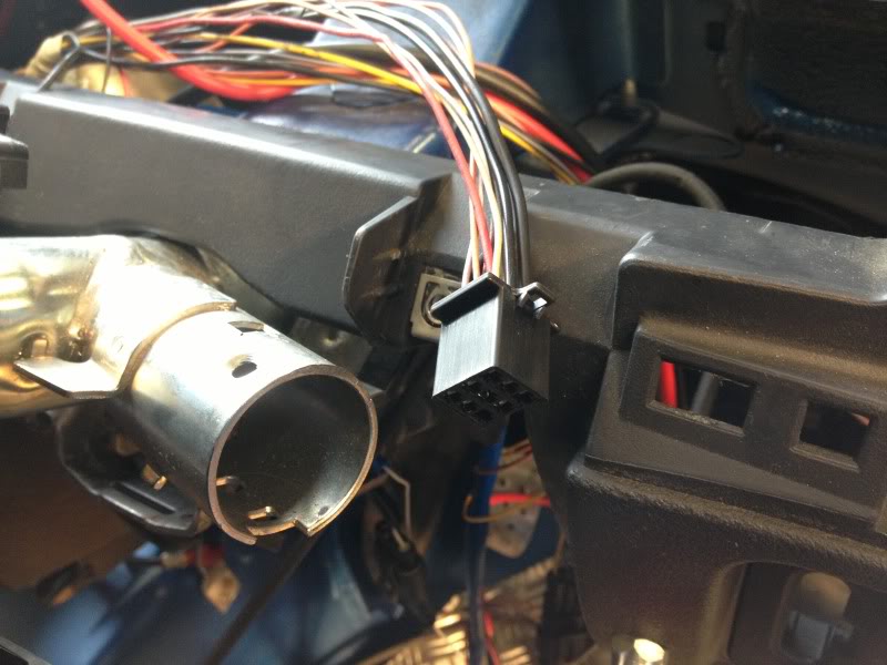

The plug connection on the dash loom (the loom isn't finished yet still needs final finishing and taping but you get the idea)

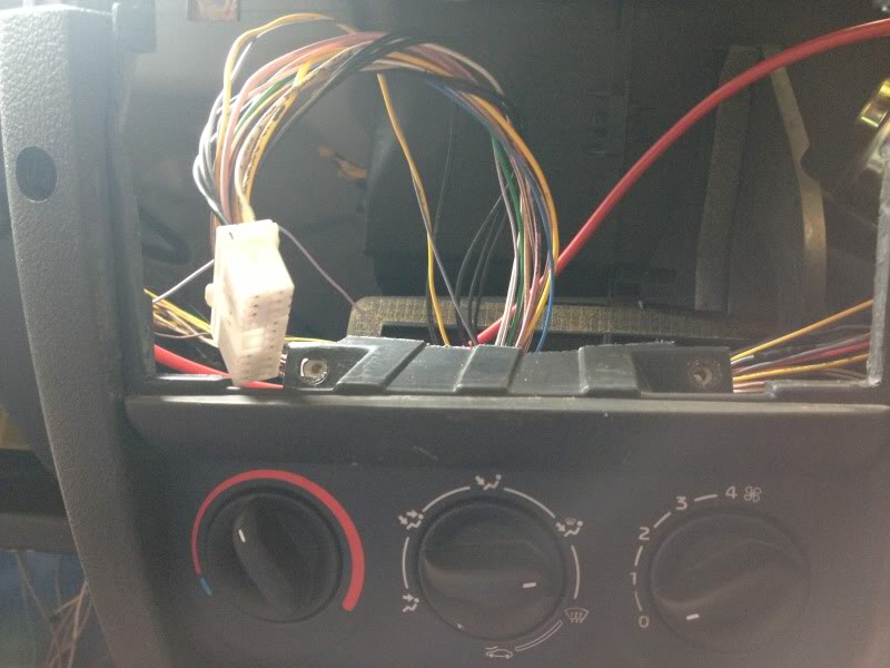

The dials have been wired into one plug, once again for ease of removal
Plug connection for spiral contact to run headlight flash on horn button
The battery kill relay has been incorperated into the loom
The power steering has been wired up into the loom and easily disconnected (the box will be mounted properly soon)

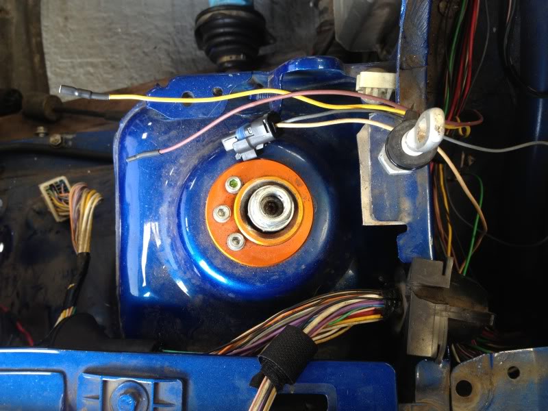

The washer pump has been wired up so its not reversable anymore as we only have front washers, note the black wire for an earth, also battery kill switch buttons now incorerated into loom

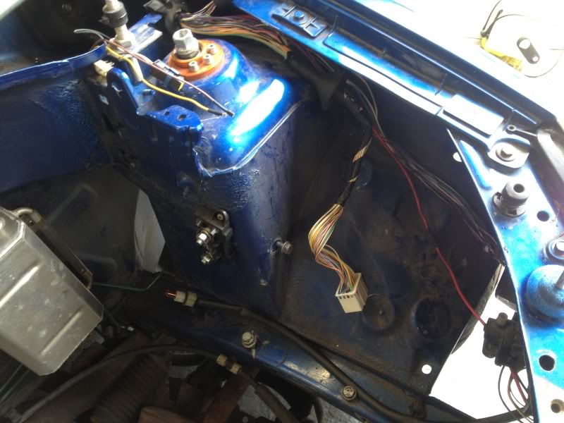

Inner wing wiring with fuseboxes removed
