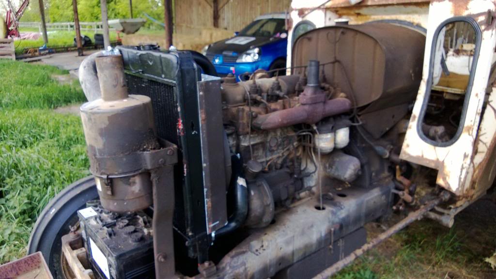

Fixed the tractor yesterday afternoon, rad popped, new one arrived while I was away, need a rad cap as the old one disintegrated, original from 1960's.
Had to fix before I could get the Cup down the track on the trailer - can't get a car up to the barn.

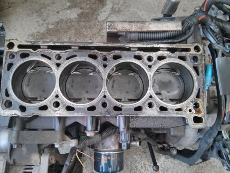

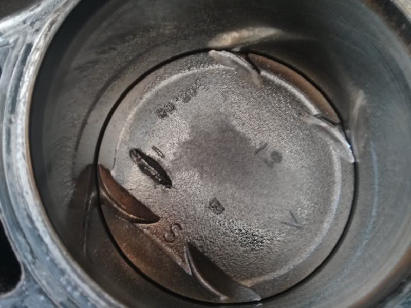

pulled the head off the short lived hero engine. 8 bent valves......and a secret history revealed
looks like it's dropped a valve head and someone has fixed it, but left one piston that had a BIG dent in it. Would explain why it leaked so much from the rocker cover when it was in Adams ph1 anyway. no mention in the "full service history"
looks like it's dropped a valve head and someone has fixed it, but left one piston that had a BIG dent in it. Would explain why it leaked so much from the rocker cover when it was in Adams ph1 anyway,

How come only one side touched (exhaust side)?
Because only one valve went, its not that the cam timing has slipped, the mark is in slightly the wrong place, looks like like the valve stuck in the guide and the contact happened while it was a lot further open, hence the damage is towards the middle of the piston more rather than at the cutout like if the timing had just slipped slightly.
Another option is the valve fell in half and jammed there, but unless it stopped the engine dead (ie happened when the car wasnt in gear) then there would be mutliple marks in my experience.
On just one valve out of the 8? lol
I dont think you have thought that one through enough :)
The dropped valve is an old issue, can see the exhaust valves have made nice shinny areas on all the pistons...I did that.
  182/RS2/ Turbo/Mk1
The dropped valve an old issue, can see the exhaust valves have made nice shinny areas on the pistons...I did that.
Apologies, didnt realise you were chatting about two different things at once :)

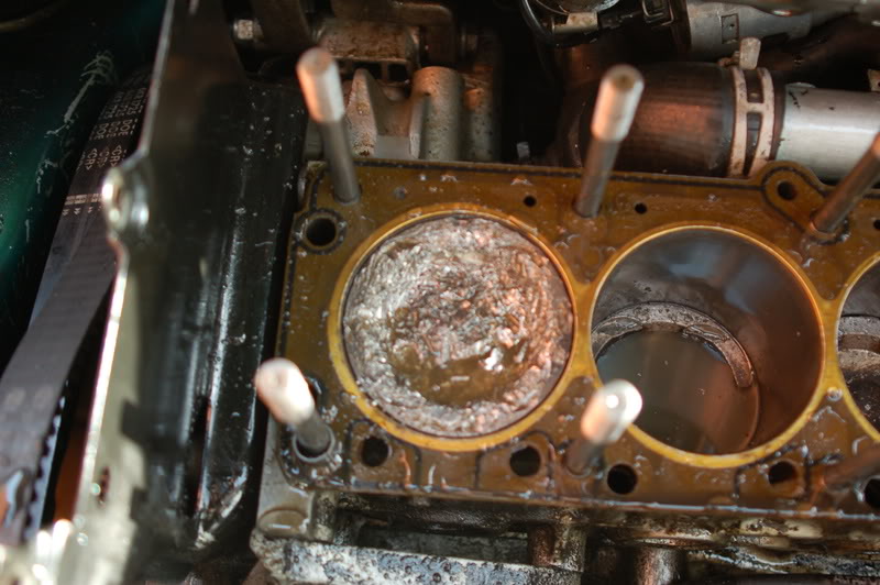

At least it didnt drop at high rpm like this one I pulled apart:
Must have hit a good few hundred times, lol

yes the dropped valve is an old issue, all 8 exhaust valves have contacted when Pete saw it off, no wonder the rocker cover had quite a big leak when the engine was fitted in Adamm's old ph1 as previous owner's in the past had quite clearly chucked a new head on and slapped it back together
