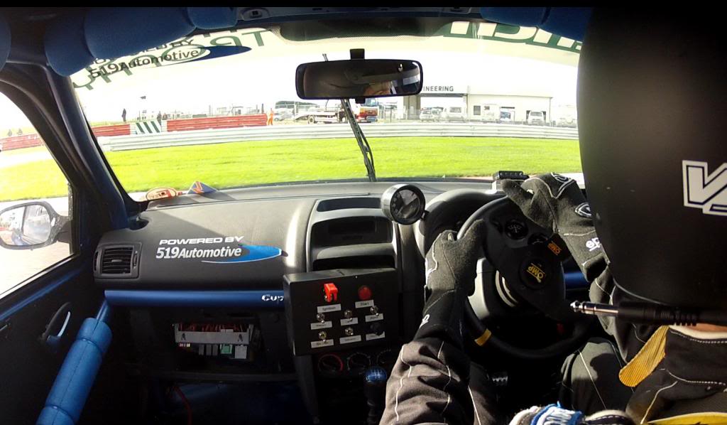

Ah got the start of the race at least, though shouldn't be pointing at the Scrutineering bay going round Copse;

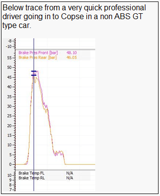

Brakes were fine, I was hard on the brakes at first - so avoiding any lock ups as the wheel speed\traction can cope and eased off near to the corner\apex. This does involve a later braking point and faith in your equipment, I was braking between the 50 and 100mtr points for Brooklands the first turn after the Wellington straight (from 3 figure speeds). For my 4 wheels off's at Copse I was braking at the right point but not hard enough and then not using a bit of power to pull me round (due to not braking enough and thinking oh dear!). Find the other way, light application first to progressively harder causes lockups as when you want to slow more the wheel speed is low\traction is low so a lock up will ensue.
I've seen a really good braking effort graph of a driver going into Copse - I'll try and find it.
Found it;
That said I could do with more practice as the feel is totally different from a car with floating disks and AP calipers - I didn't experience any fade or oh sh1t running out of stopping power (but I think I may be not far off requiring something different).
