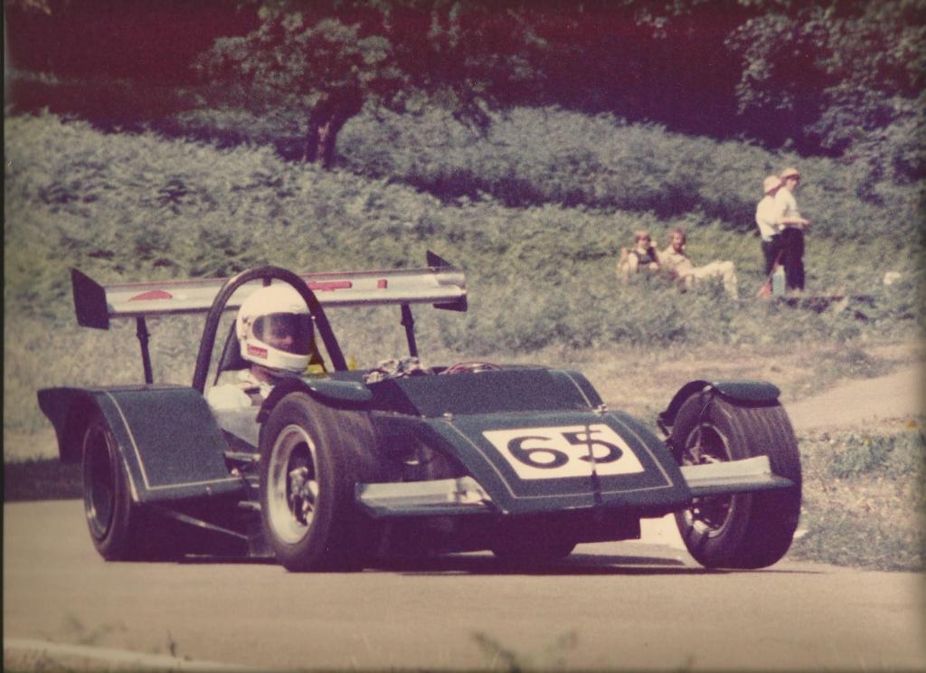

Ah Mallocks..........happy memories of the original Gitspeed:

Not sure which Mk it was, was one of my old man's hillclimb cars, BDA'd iirc.
