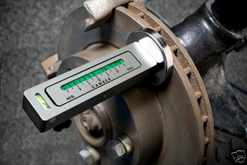

Here's what I'm thinking to make camber changes easier - remove the need to have to fit the wheel and check after adjusting the strut bolts.

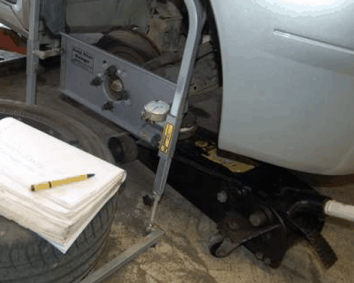

I saw this on ebay (looking at the overall picture not the gauge, had one sold it on, not that good)

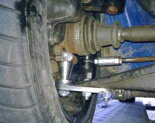

then saw the method to adjust bump steer with shims,

And then with a digital magnetic camber gauge on the disc away we go.
