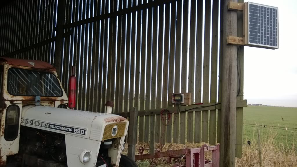

Anyway, here's the 40 watt solar panel and battery conditioner all fitted and working (took a fair bit longer to set up etc than I thought it would).
Tractor has fired up first time whenever I've tried it since fitting solar panel - so that's money well spent. Will see how it fairs over the next few weeks as it's getting below 0 degrees at night now.

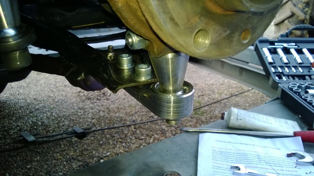

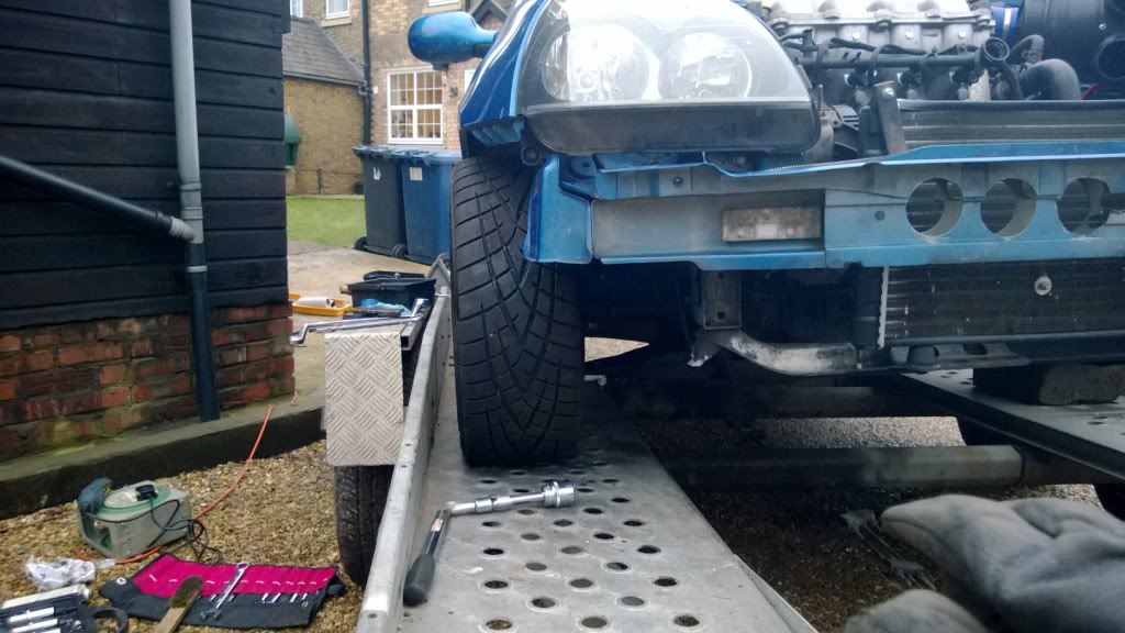

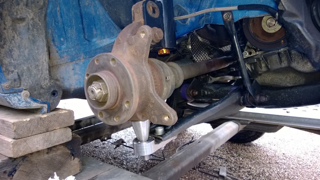

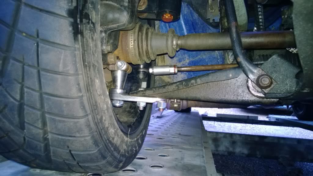

Spent the afternoon fitting my new hubs today - didn't go to plan and only managed to finish one side - made lots of mistakes and was rushing to beat the ever impending darkness.
My first panic and mistake this is viewed from the top - can you work it out? Tony sorted me out.
Then unsure about the track rod, no Allen key the right size to get the eye off the hub and didn't know if I could turn the track rod round and round about 30 times to get it screwed into the eye. Tony said I could so I did.
Then had a panic with the wheel bearings - fitted hub and brake disc and hub nut - should there be that much play?? Txt to James and Tony, wrong torque setting - 170 not enough. My torque wrench only goes to 200nm and no play felt when at 200 so when it's at 280 should be more than fine.

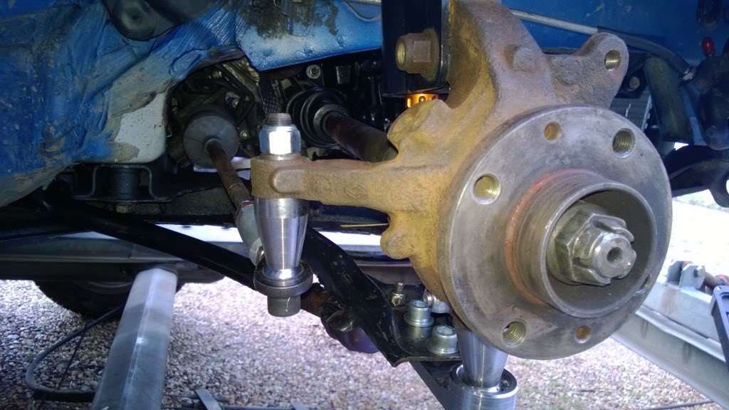

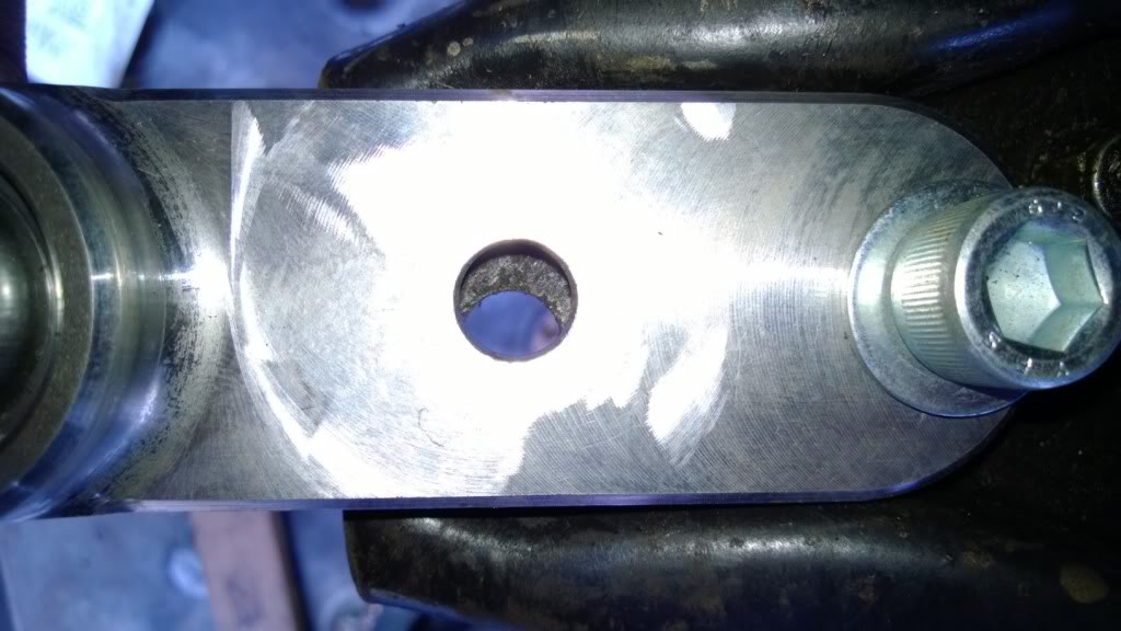

I did carry out a slight modification whilst fitting the kit - elongated the outer wishbone hole moving the rose joint forward by 4-5mm, gaining more castor in doing so. Guess I should move the inner hole back to even things up as hub would now possibly be at the wrong angle and inboard a bit? Maybe over thinking it.
Took me a while to work out to undo the ARB end bolts so I could bend the wish bones down to get the hub in the wishbone rose joint.
Liking the way it's all horizontal!! Took the suspension strut off, cleaned springs and strut and re fitted to the same height as it was last year. Now I've more castor I may just have to raise it a bit more if the front of the wheel arch rubs when front wheels are under load whilst turning.
This is with no camber set and 25mm spacers, hoping 1.5 degrees should be all I need. Ran with 2.5 degrees camber before so will try 1.5 as a starting point.
What way should the suspension to hub bolts go, nut to front or back of strut?
Many thanks again to James and Tony as without their help I wouldn't have even got this far!!!

Pete - bin off the 25mm spacers and replace them with either 10 or 15mm spacers at a push. The 25mm ones will ruin your scrub radius and you won't get the full benefit of the hubs. Remember the new bottom ball joint holders push the wheel out 5mm over standard and the cup is already widetrack from the factory.
  182/RS2/ Turbo/Mk1
I'd say that was even better than horizontal as the line is from the centre of the inner bushes to the centre of the uniball and the bushes sit a lot higher relative to the bottom of the wishbone.
looks great at that height, the wishbone the shaft and the track rod all almost parallel just HAS to work well.
NorthloopCup
Cheers Mark, will do. I've a pair of 15mm's, that I took off the rear, in my box of bits. Will get them on this weekend.
It does all look "correct" and sort of gives off a "I'm going to work well" air of confidence as well thought out and manufactured mods\parts do.
I'm trying out some 50mm corrector pins in mine soon. Just the steering arm correction to do, but I'm tempted to leave it at the current ride height and just use the pins to gain more RC correction.
