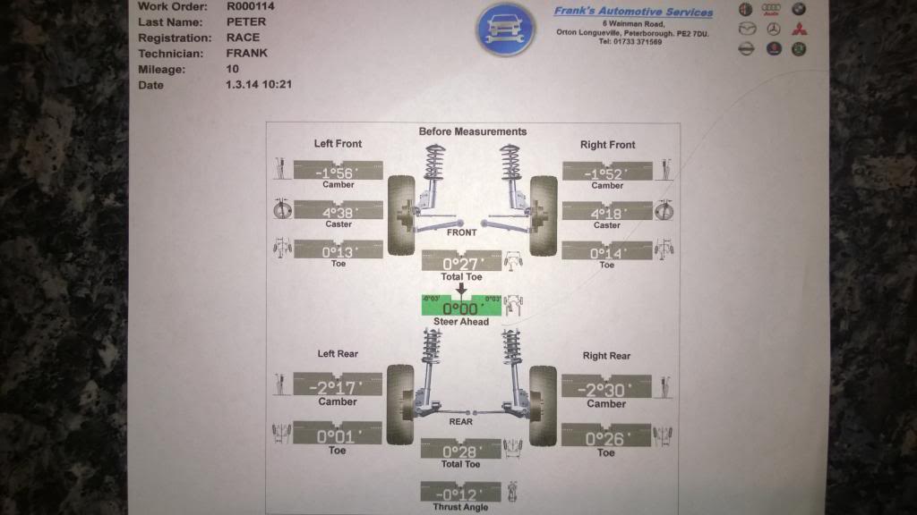

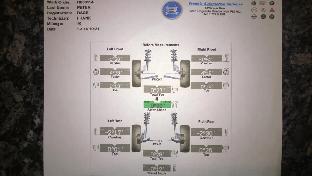

Got the Cup on a Hunter alignment machine today - mates friend now has one in his garage in Peterborough.
Wanted to see what the rear was up too, as wasn't too sure. I will have to add 1 degree more of -ve front camber though.

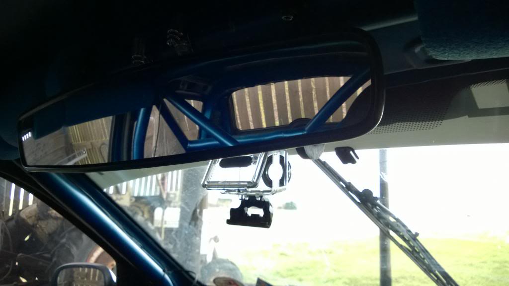

Fitted the new mirror earlier, job and a half. Had to dremel the brackets to open out the corners a bit to get the brackets round that bar. Lucky I was expecting this as read a few reviews saying as such. I must admit the view out the rear now is worth the effort.
Dropped the Cup off at the same garage, who originally set up the geo, last night to get the toe in and camber sorted. I'm sure I wouldn't have asked for toe in, or 1.5 -ve. See what they say tonight when I pick it up.

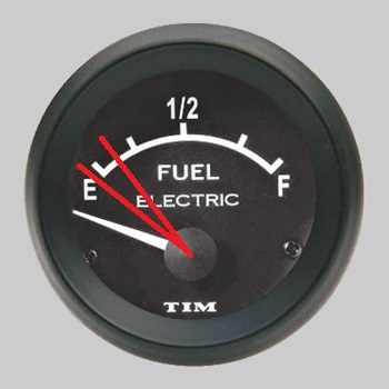

Had to drop the car down to Dan's this week and when I dropped it off he offered to probe my tank connections and I now have an empty tank - well until I put 10 ltrs back in, noted the fuel gauge's needle position and then added another 10 ltrs. Another job off the list.
My 10 ltr divisions......nice!

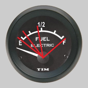

Calibrated the fuel gauge some more;
Definitely a top half goes quicker than the bottom half gauge\car....10 ltrs, 20 ltrs, 30 ltrs and 40 ltr red lines.

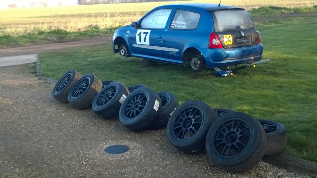

Yes, the last of my A048's. R1R, Dunlop and then Yokohama's. Will spend 90% of tomorrow on the A048's then Dunlop's. On Friday I'll remove the A048's and put on 4 Dunlop's ready for Rockingham on Saturday.
Lets hope you get enough outings this year to wear them all out Pete
Got to say, as long as we're trouble free when we do get out that'll be fine. Last year wasn't the best for us.
