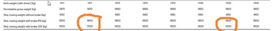

This is a really hard subject to explain but I'll give it a go....
So with your tow vehicle I would be extremely surprised if a seat leon can tow 1600kg???? You defo need to double check that! Small modern hatchback are usually around 1000kg maximum tow weight some dont even do that!
But the guys are right it's the MAM maximum authorised mass that you NEED to get right.
A Leon's MAM will be around 1800/2000kg fully loaded. So 4 adults, full tank of fuel and a boot full of crap.
That mean you need the trailer and the object on the trailer to be below 1500kg or you will breach the 3500kg limit without a full B+E trailer licence which allows you to have a train weight upto 7500kg.
But.... that stamp on the tow vehicles vin plate and the stamp on the trailer must also not exceed 3500kg aswell.
So ideally your trailer needs to weigh 500kg or less, be able to carry 1000kg payload for a combined weight of 1500kg and be stamped up with a MAM of 1500kg which is your full payload and trailer weight combined.
Your tow vehicle needs to be able to tow 1500kg or more and have a MAM on the vin of a maximum of 2000kg.
The kerb weight of a Leon will be 1400/1500kg maybe which is a complete car with a full tank of fuel.
So legally you can add 500kg of weight into the vehicle like yourself, spare wheels, tools, extra fuel. But if you put any of that weight on to your trailer you would be over weight and illegally towing.
I hope that all made sense?
I only know this as i was in the same position as yourself and did alot of research. To make your life easier regarding your total train weight just do the trailer test and the you are good for 7.5tons.

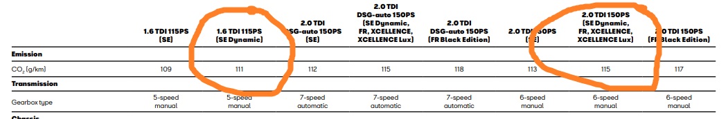

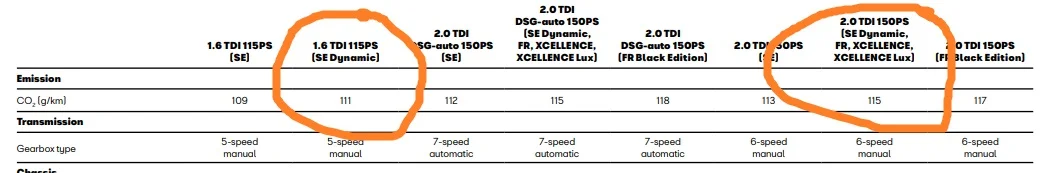

Seat provide the following figures for the 1.6 and 2.0 diesel Leons;
Which implies that it would be possible. Just.
But as @1985michael182 says, the question is how far to actually believe these numbers in the real world.
