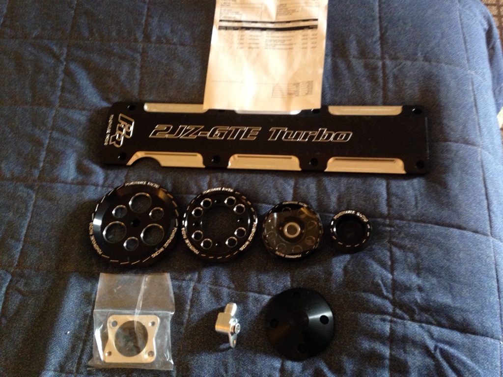

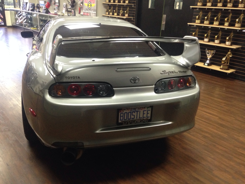

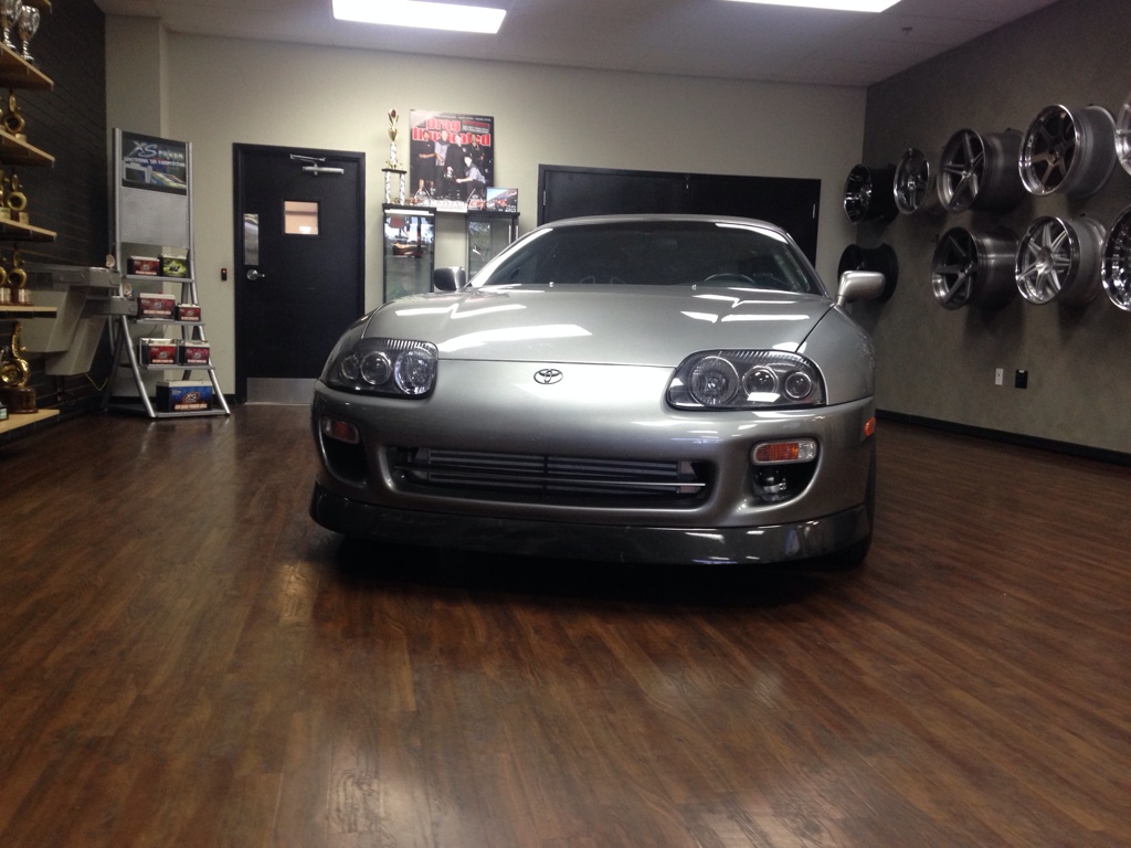

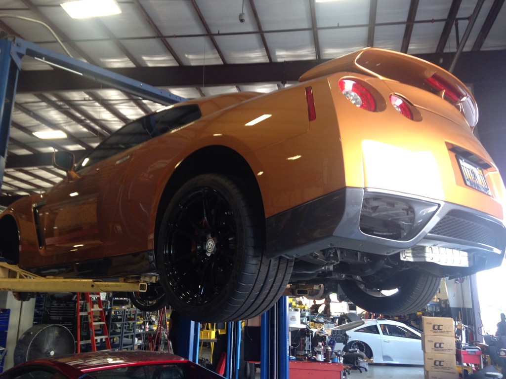

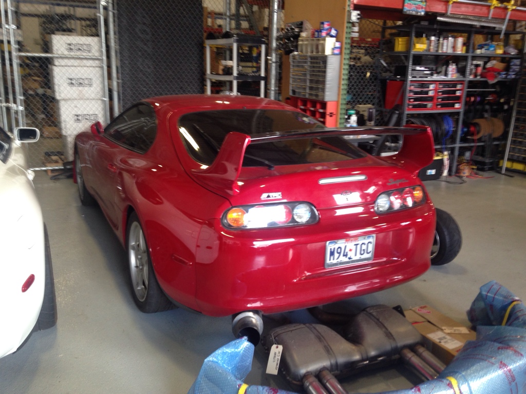

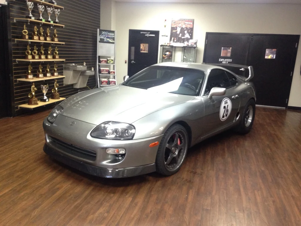

Went to Florida again recently to pick up some more engine parts for my Dad from Titan Motorsport as it's a lot cheaper to get them out there than over here.
Picked up an 4 piece pulley set, aluminium spark plug cover amongst other things

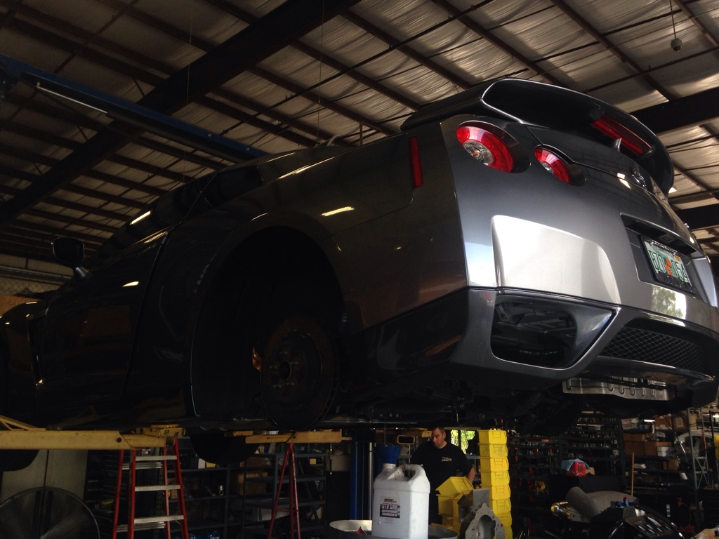

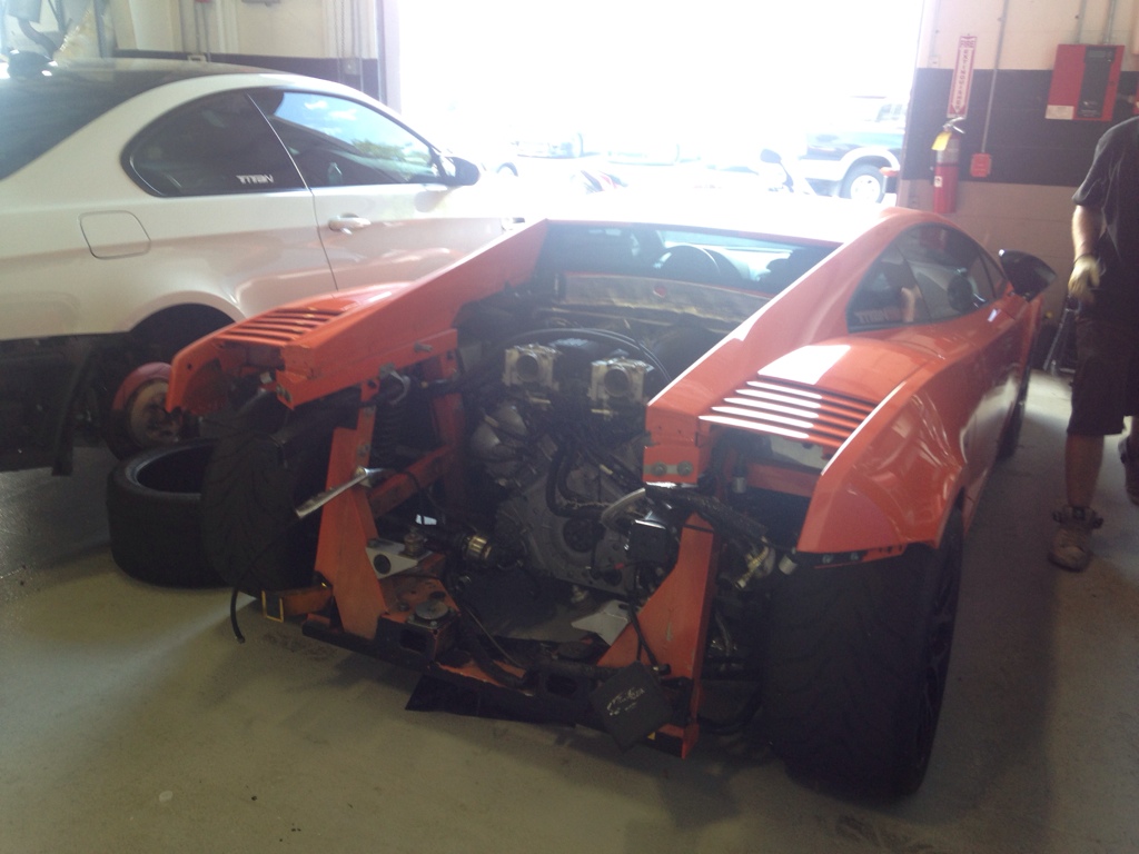

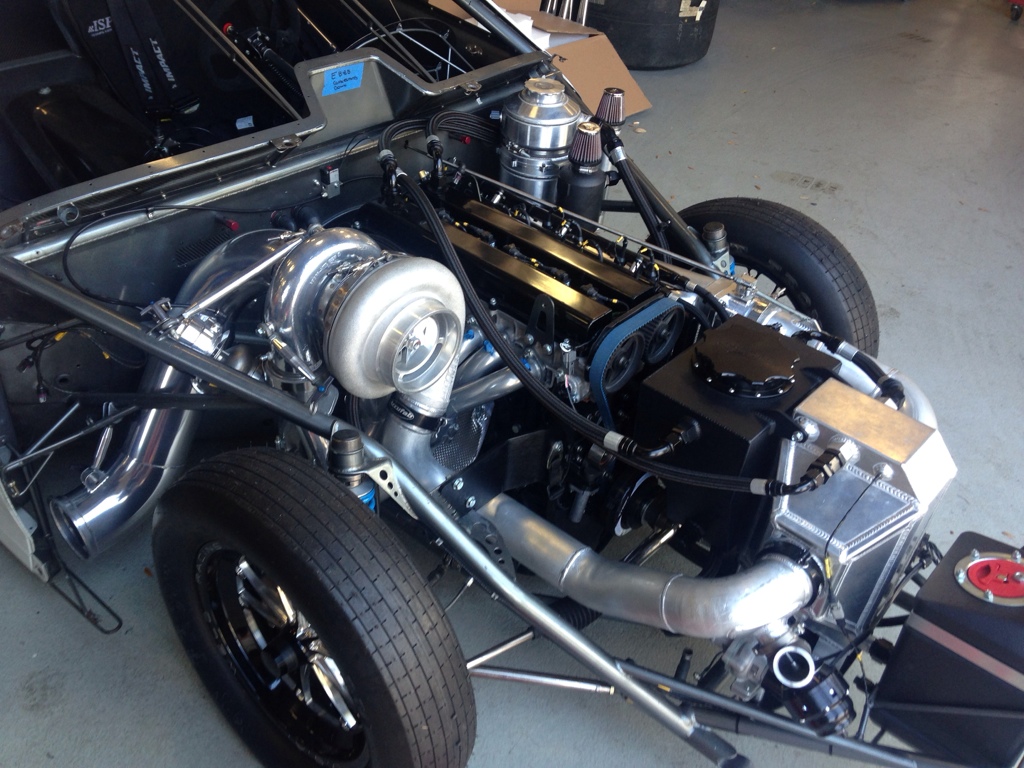

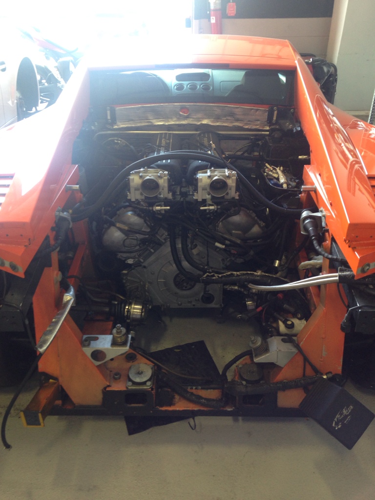

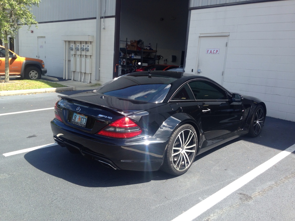

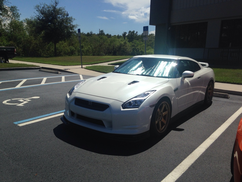

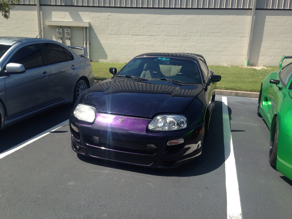

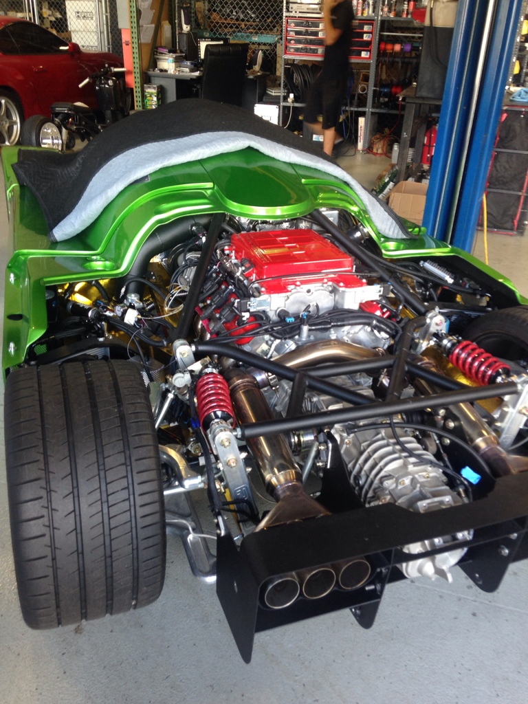

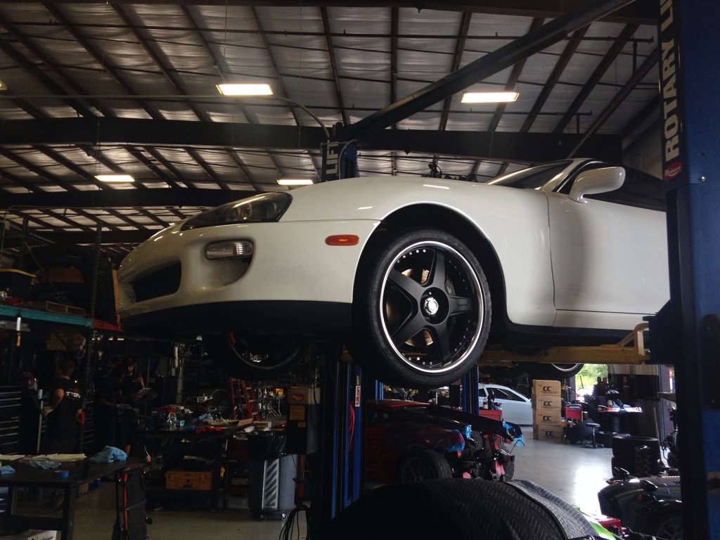

Also whilst I was there I was offered the chance of a tour of the garage so couldn't turn that down, here are the photos!

That place looks f**king amazing. That white GTR :eek:
Awesome looking place & workshop.
Thanks guys! Was an awesome place!

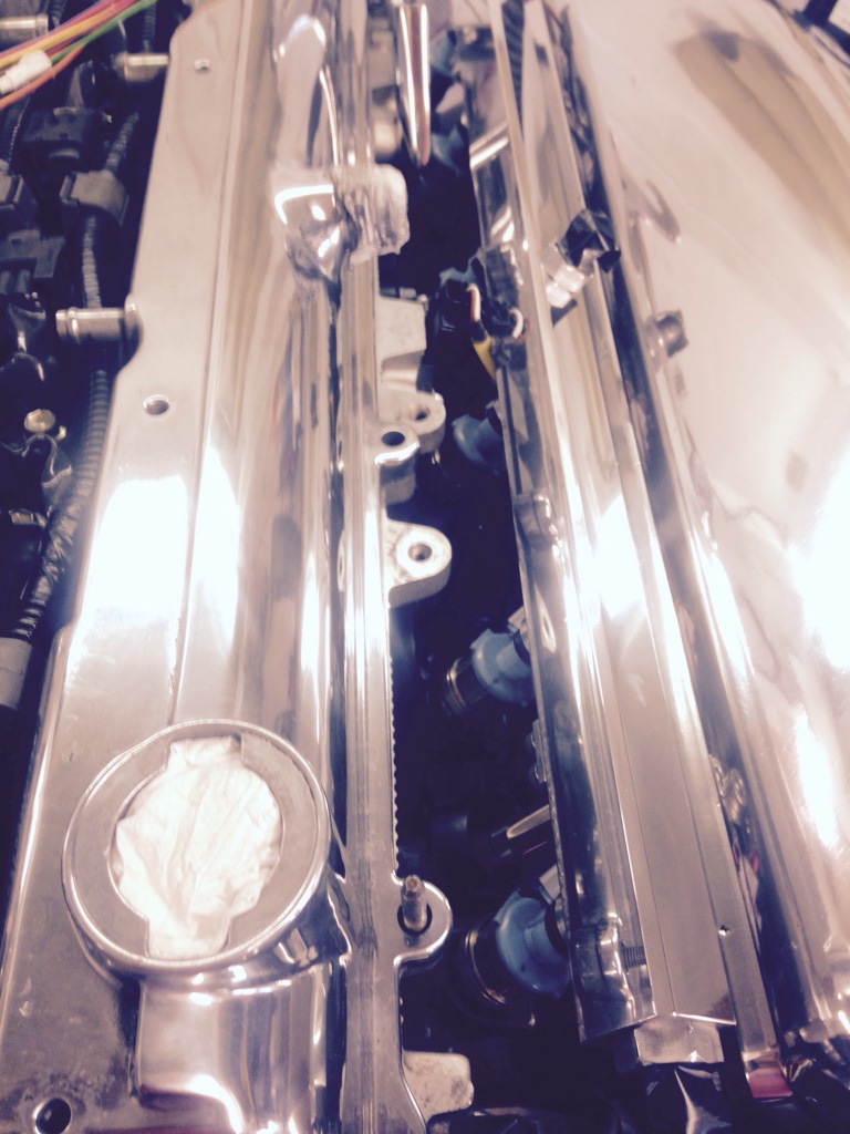

The turbo housings/turbo pipes/cam covers & intake manifold have just finished being mirror polished and we are working on the waste gates/oil return and pick up/plumbing of the turbo system at the moment making sure nothing catches on anything,

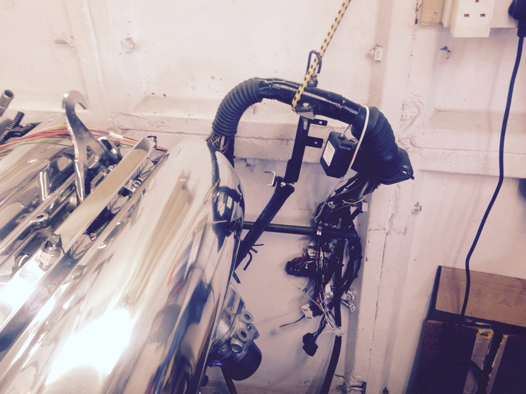

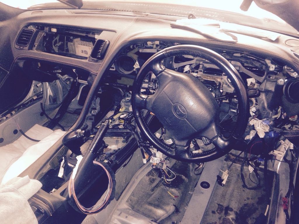

Due to the car being 20 years old he decided to buy brand new wire and plugs from the states (as you can't buy a new complete loom from toyota anymore) to make a whole new engine loom as the old one looked abit tatty and the plastic plugs could have broke at any time.
So the engine loom is pretty much complete and finished now and ready to be fitted to the engine and then we can connect the Syvecs s6 ecu to it as well.
Once it is we'll dropping the engine into the car.

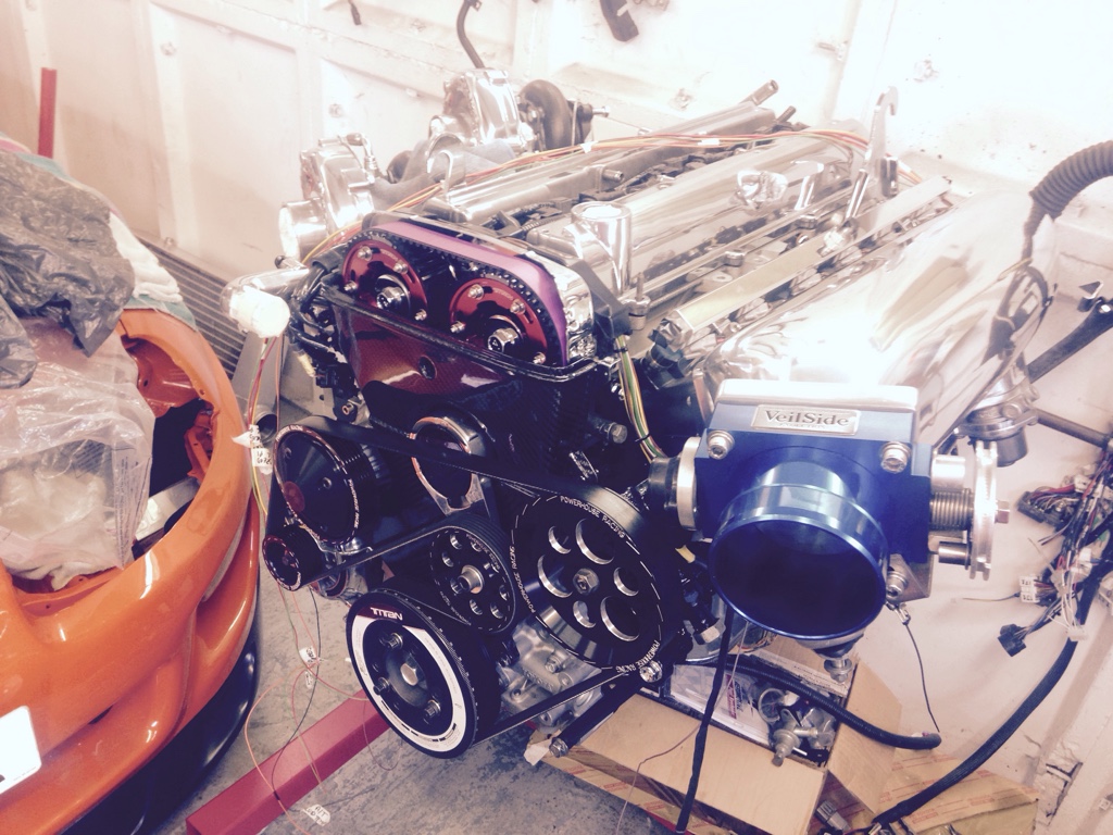

The Wiring Loom is fully complete now and all plugs and wires are connected to the Syvecs ECU , it is now just a case of connecting the loom to the car/engine.
The Intercooler and Twin Kenlowe fans are fitted too:
The Vielside inlet plenum is also now fitted with the throttle body:
This week will consist of fitting the fuel rail/injectors, and the wiring loom to the car/engine.

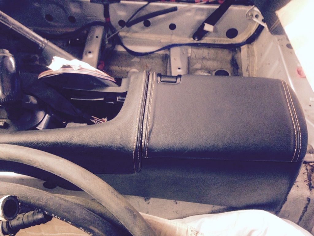

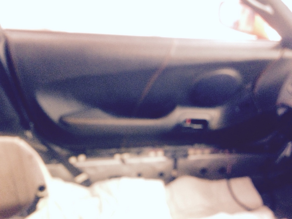

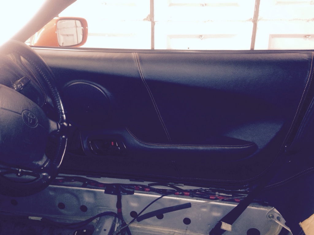

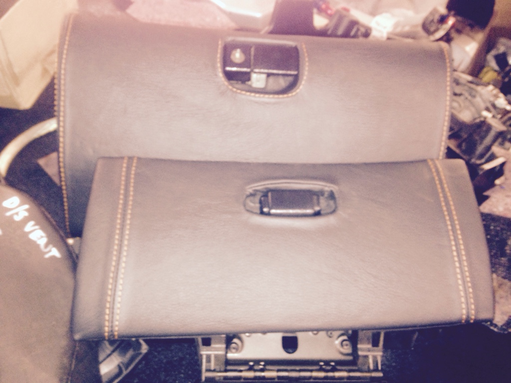

Few more bits done to the car recently - my dad found a company that makes real leather covers for most of the interior panels, the standard ones are just a grey plastic - very 90's.
Once the covers arrive you have to use fabric glue and stick them to the current panels.
Here are the photos they aren't the greatest; the new covers are real leather with orange stitching;
Passenger door card:
Drivers door card;
Dashboard;
Glove boxes;
Centre arm rests;
Rear doorcards;

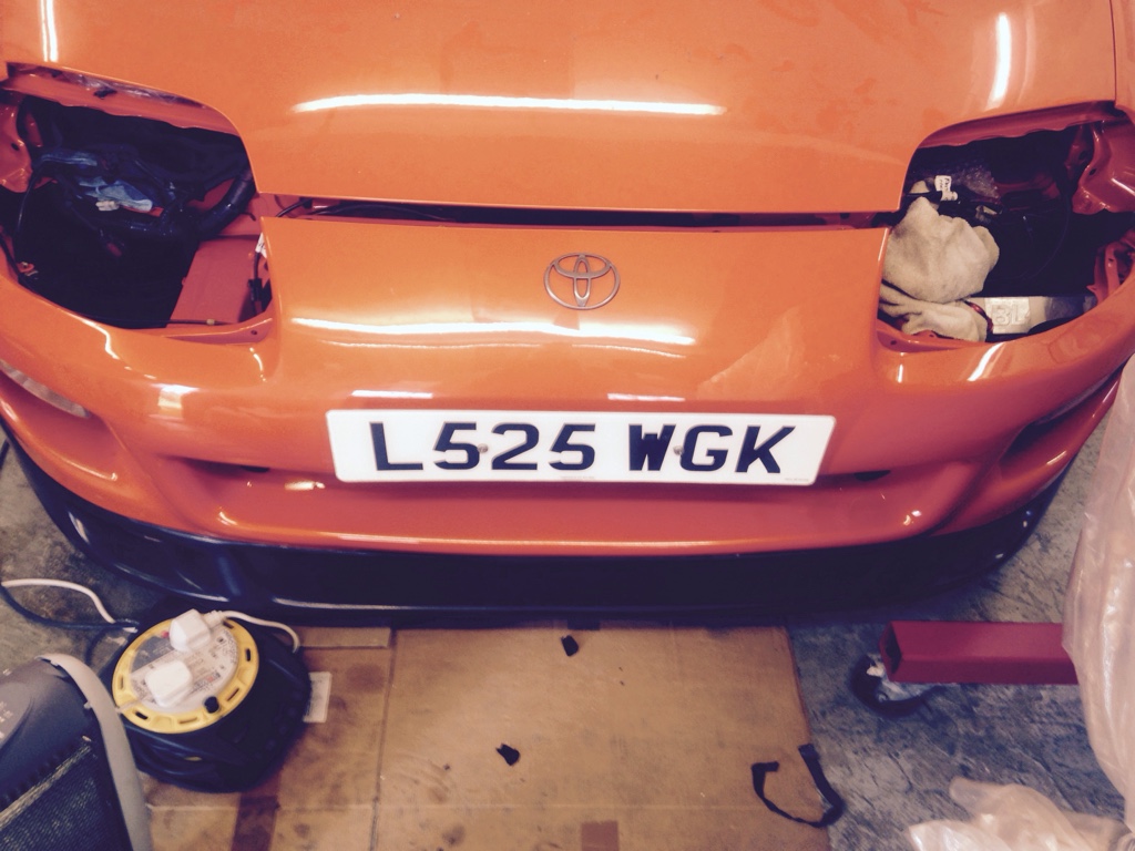

Number plate and holder fitted;

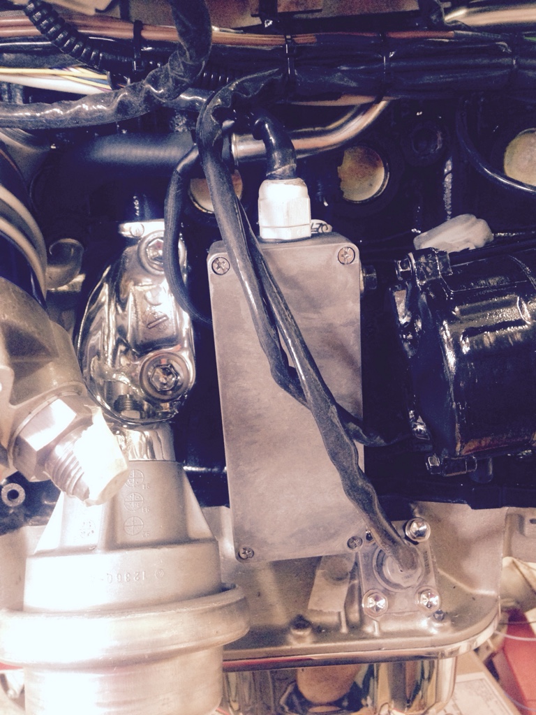

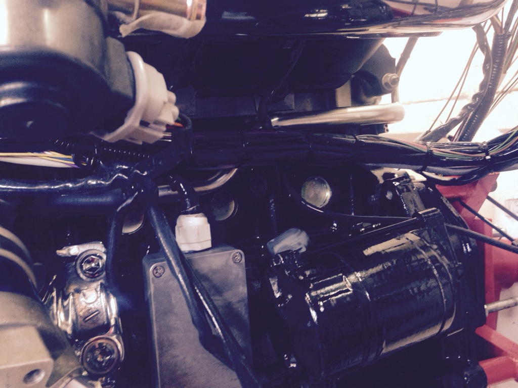

The engine loom is now being fitted to the engine and routing it around the engine to find the best possible place for all the wiring, this photo is holding the loom
In the correct place similar to where it enters the inside of the car through the bulkhead;
Injectors and fuel rail fitted and injector wiring extended too;
Resister pack for the injectors with fuses inside fitted to the block;
Loom running under the intake manifold;

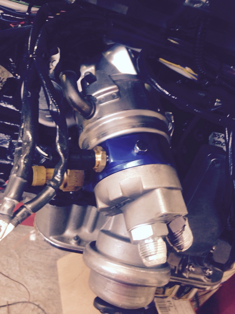

Oil cooler sandwich plate and adaptor plate fitted;

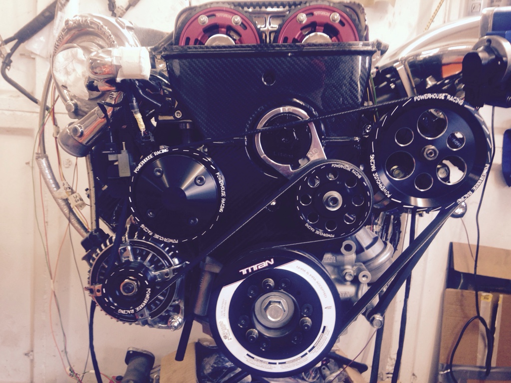

All engine pulleys fitted, waterpump, power steering pump etc along with carbon fibre timing belt covers;

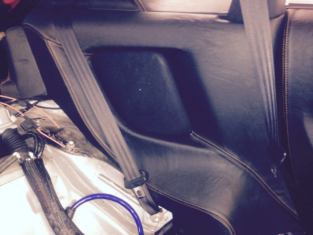

Bought some new black carpet and cut this too shape as it is the boot carpet covering the spare wheel, fuse box, battery and abs pump which are all located behind the rear seat now so the carpet is fitted and hides it all.

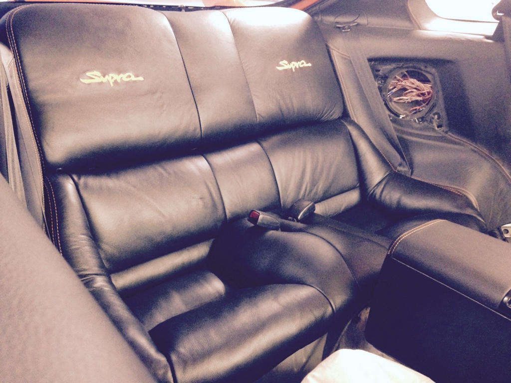

The new retrimmed rear seats have been fitted;

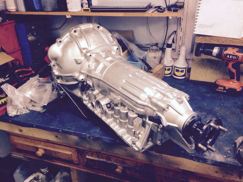

The gearbox has been cleaned/degrased and painted in aluminium paint:
