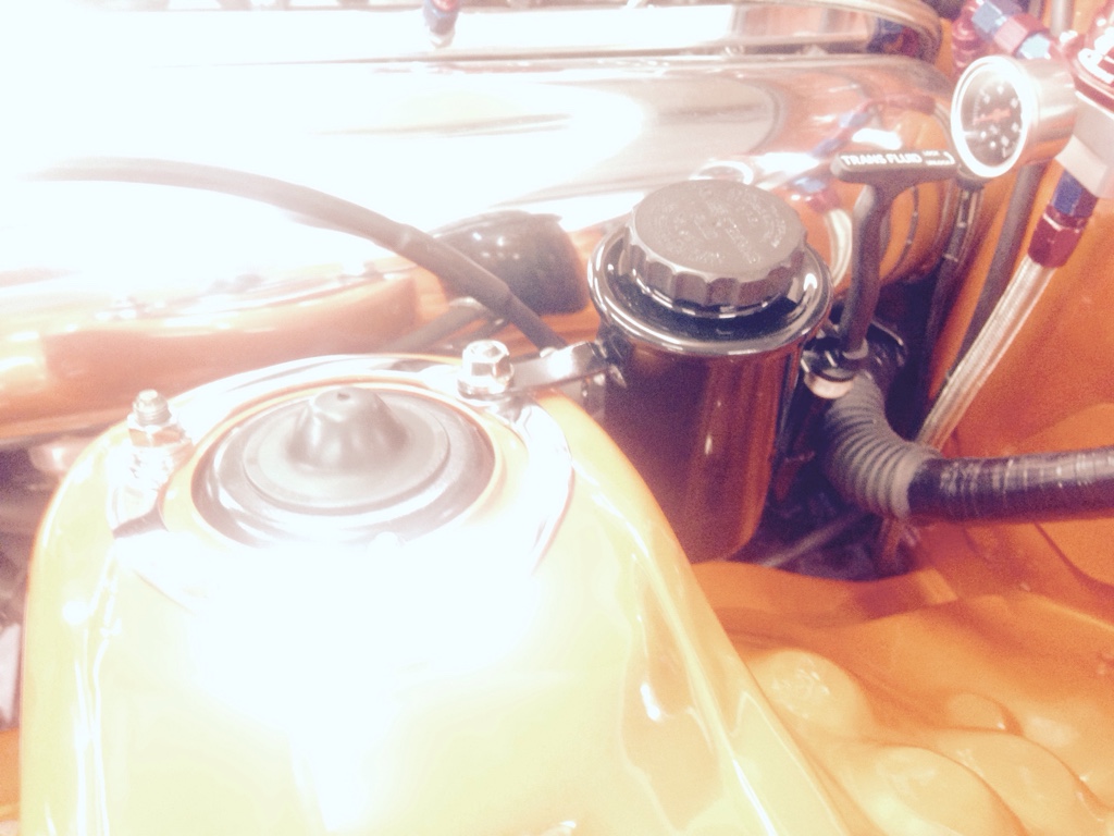

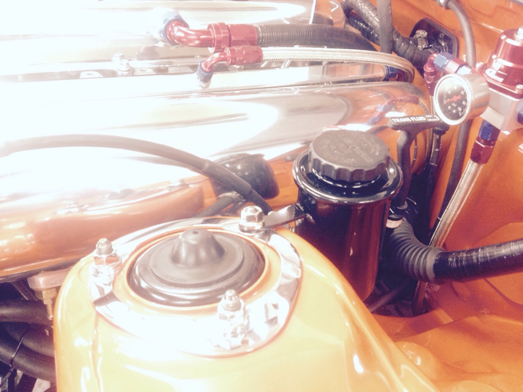

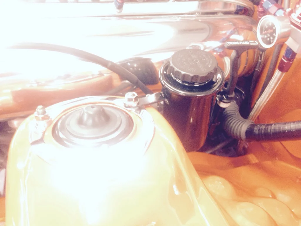

Power Steering reservoir has been relocated to the suspension turret and painted gloss black, along with the lines running to the pump and also power steering cooler that has been installed to keep fluid temps down;

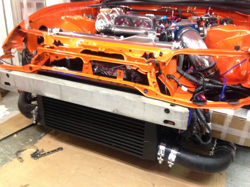

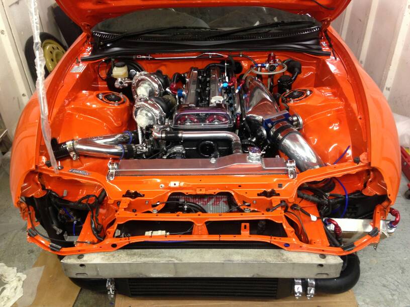

Also the intercooler pipe work has been mocked and test fitted;

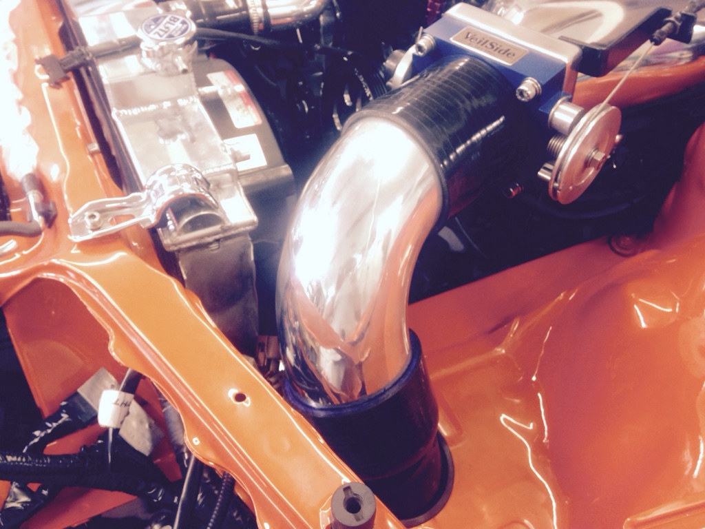

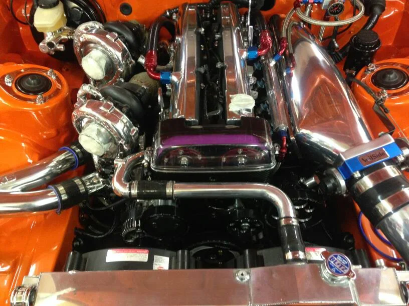

Polished inlet pipe to throttle body;

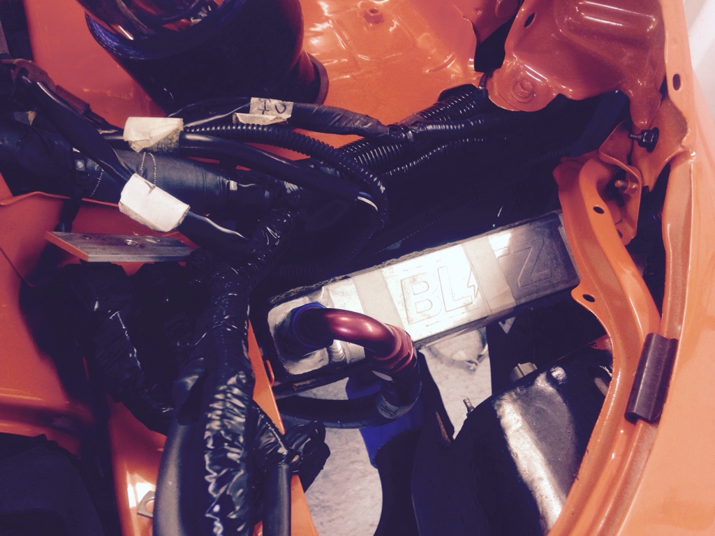

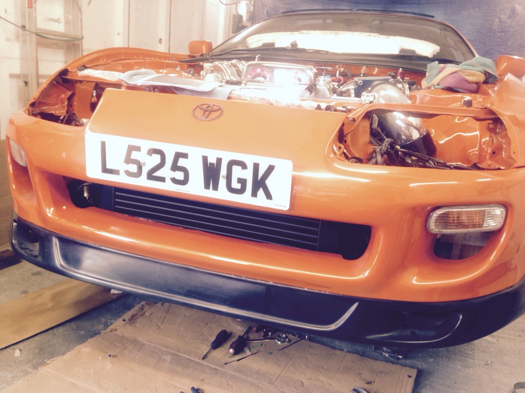

Oil cooler has also been fitted in the passenger side of the bumper under the headlight, was a pain in the ass, as not much room due to the intercooler pipe running underneath;

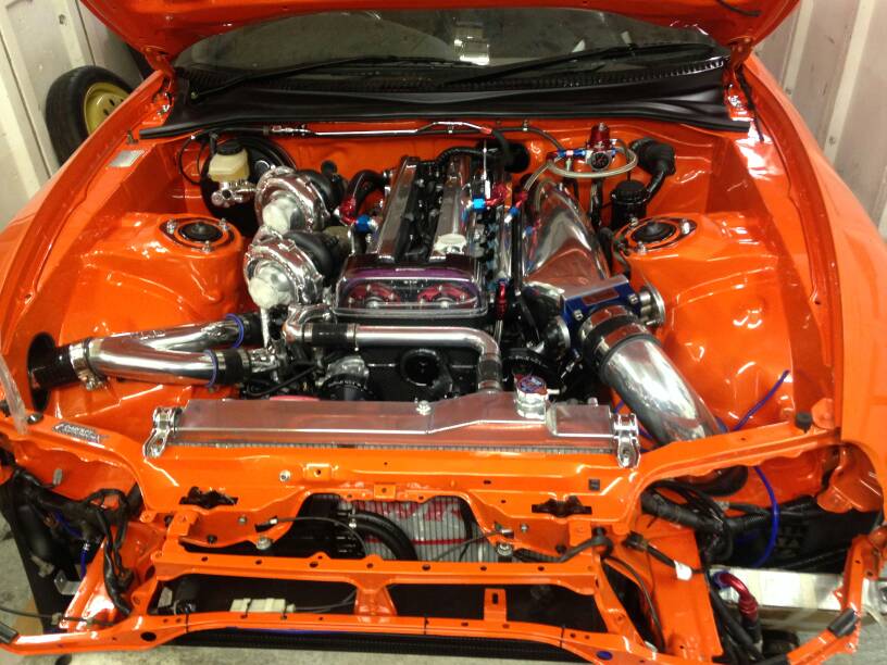

Few photos of the car at the moment,
Bumper has been taken off and bonnet put on so that it can be taken for the exhaust to get done this coming Monday.
Everything engine wise is done, all plumbed in, just needs oil, coolant and power steering fluid and a base map after the exhaust has been done then it can be started.

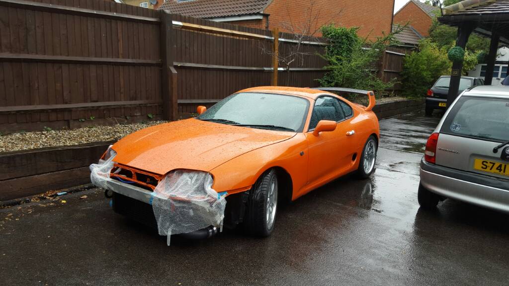

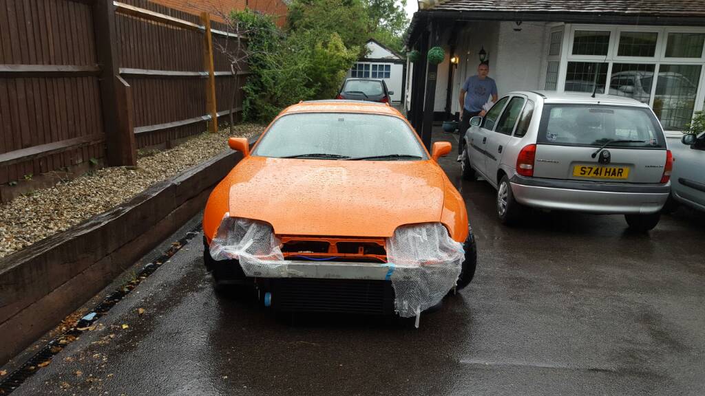

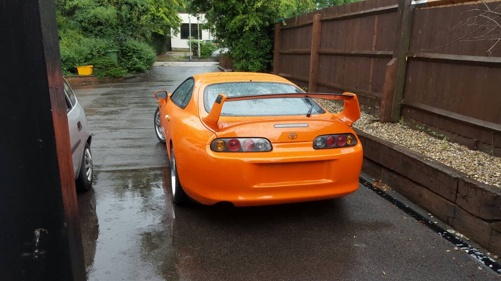

Cars now waiting to be transported the exhaust place to be done, the transporting company were suppose to be here at 9am but have forgotton it was booked in, so were waiting like plebs now till they have someone free and its pissing down.
However me and dad managed to push the car out the garage right up the end of the drive for the first time in over a year.

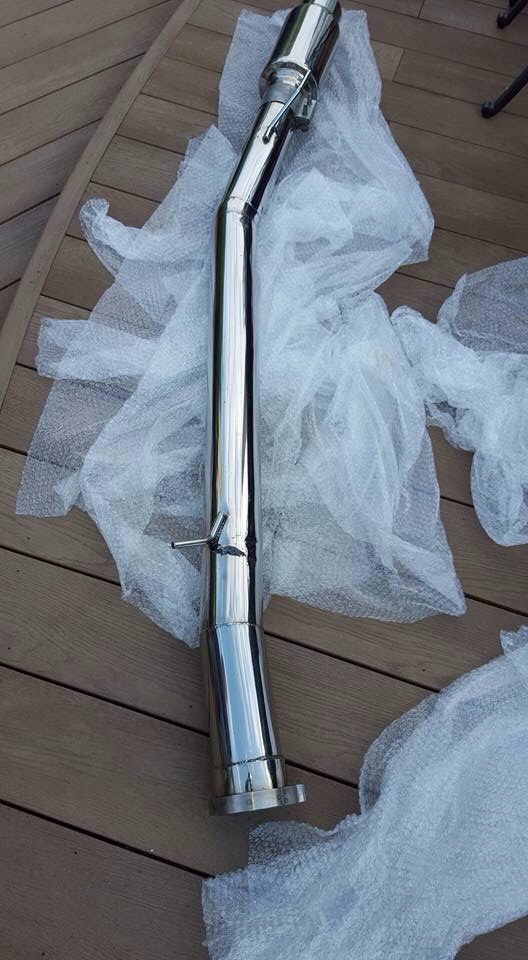

We had made for the car a new 4inch Y piece downpipe from the turbos along with a 4inch decat pipe from the Y piece which mated up to the Boostlogic Exhaust we already had and they fitted it all for us.
The work looks really good and they have done a very good job with it and the space they had to work within.
