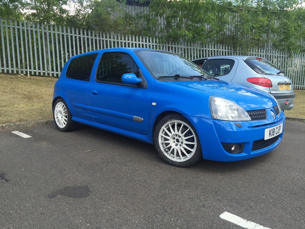

Currently share a Clio 182 Cup with my co-driver Steve that we use exclusively for trackdays. Bought about 6 months ago we've built it up at home into something we're now pretty happy with.

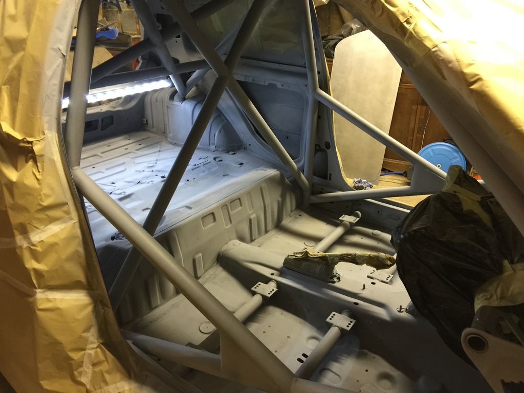

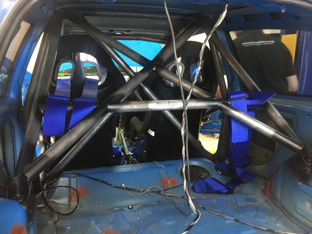

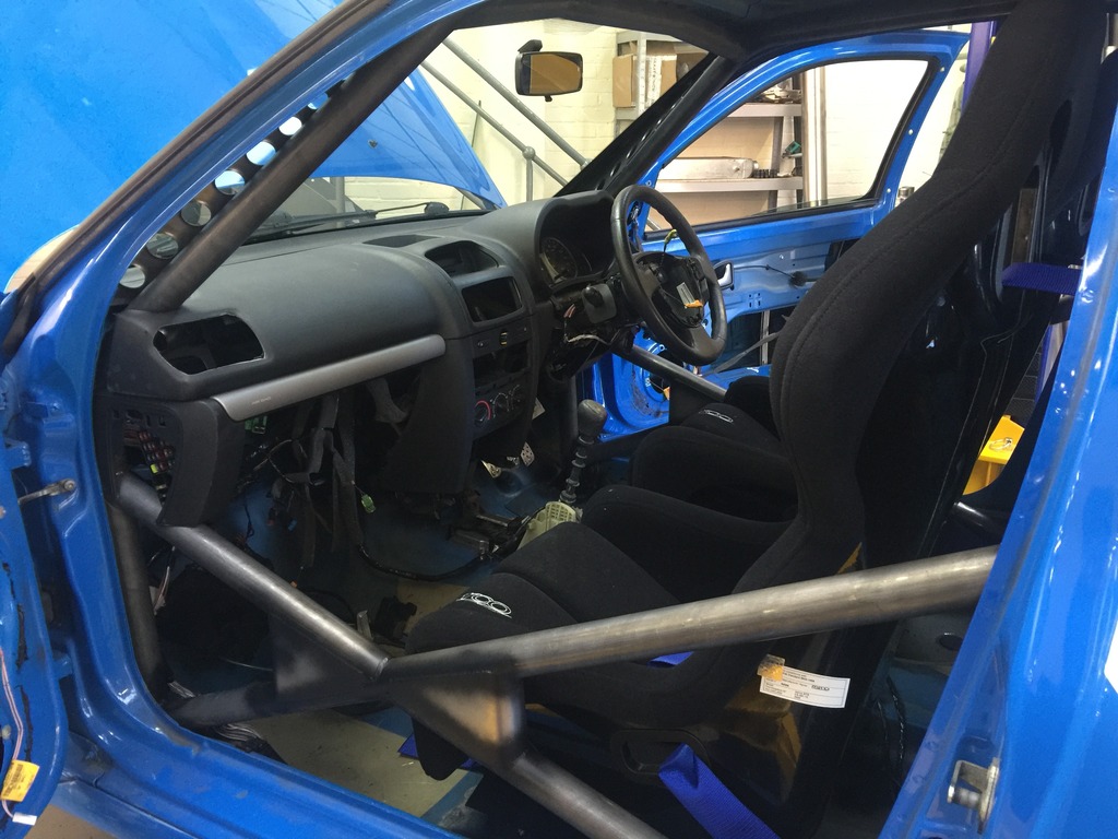

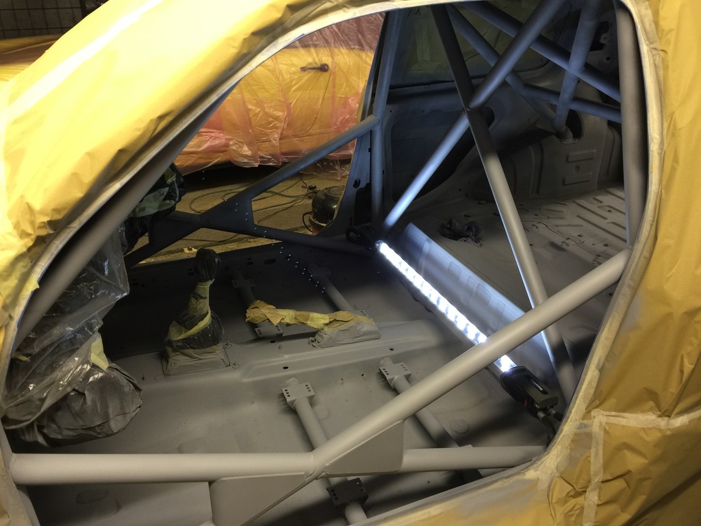

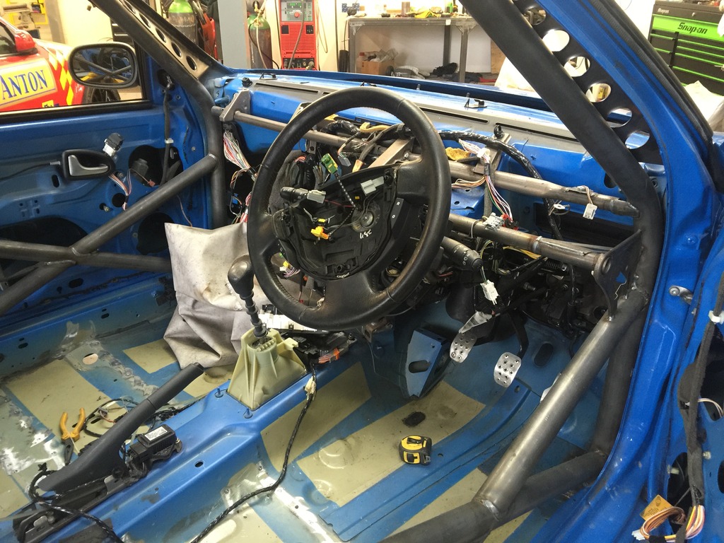

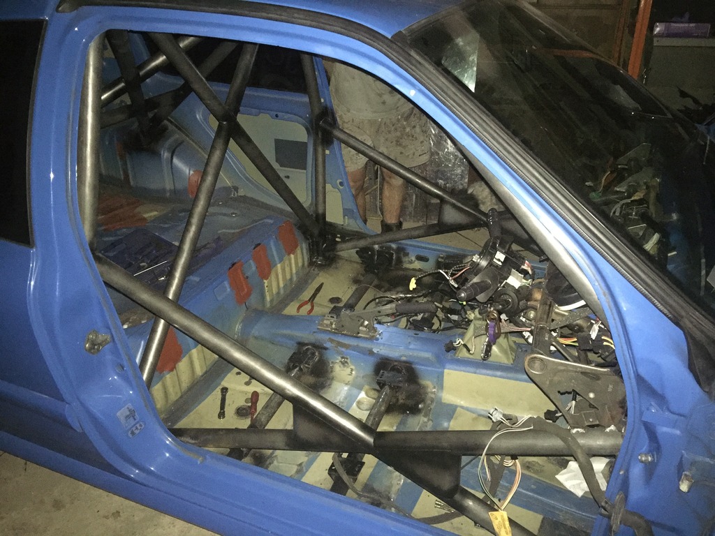

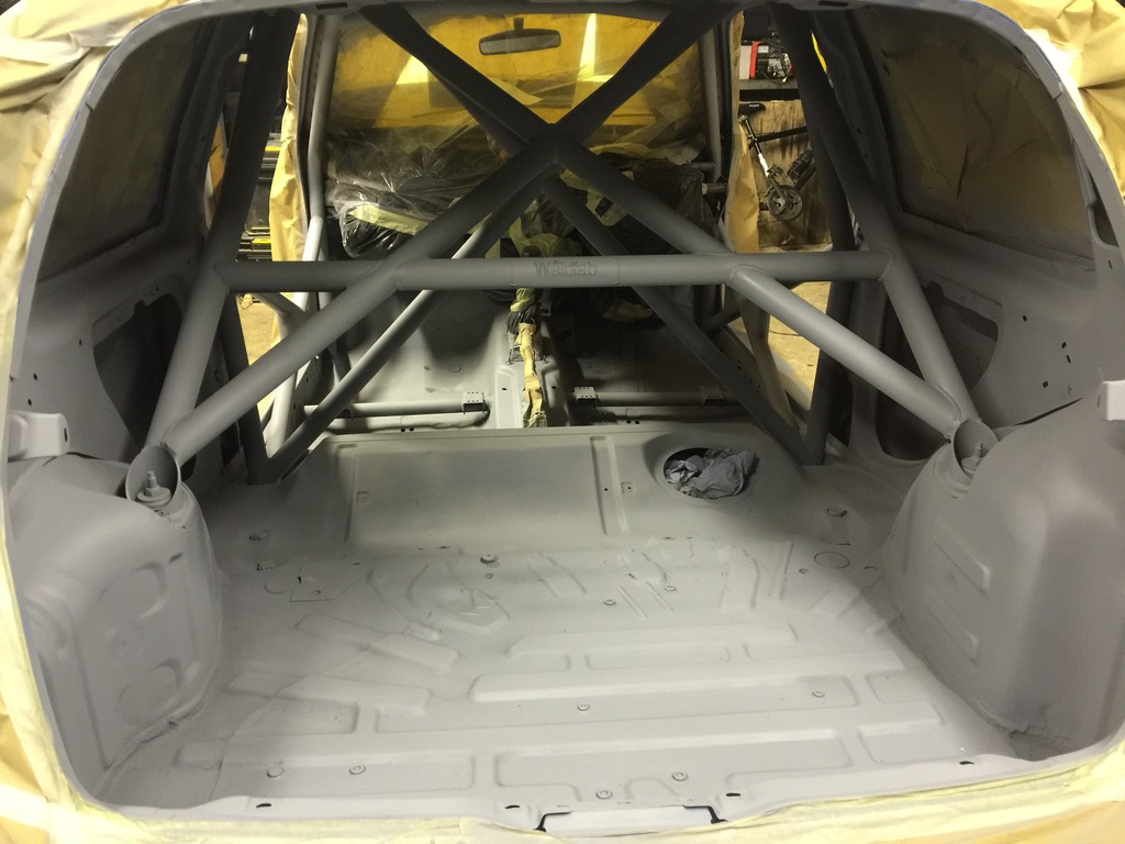

Cage complete:
Seats in for trial fitting:

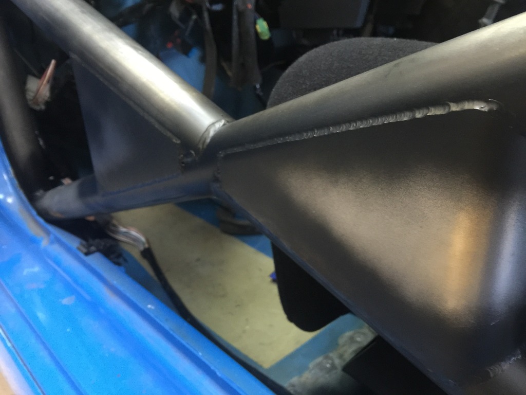

Incredible welding on the door braces:

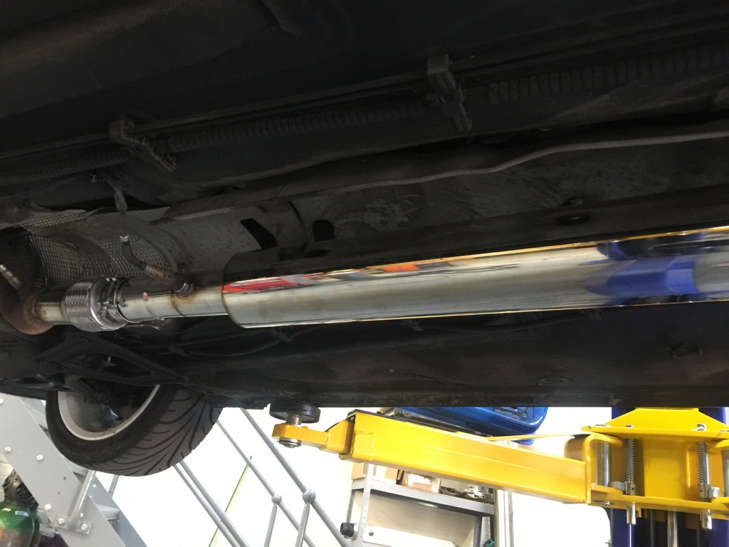

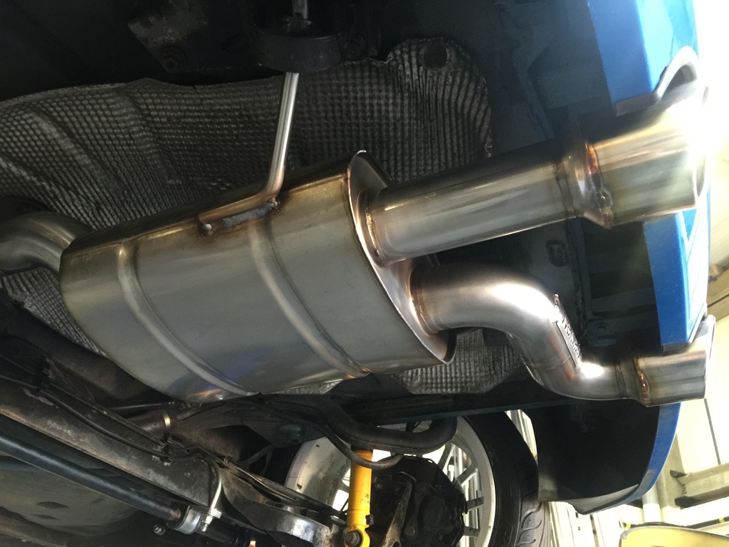

JC Weldfab full decatted system:

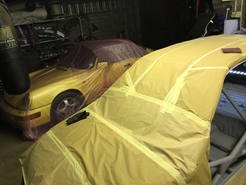

Back home ready for spraying. So much work to do!

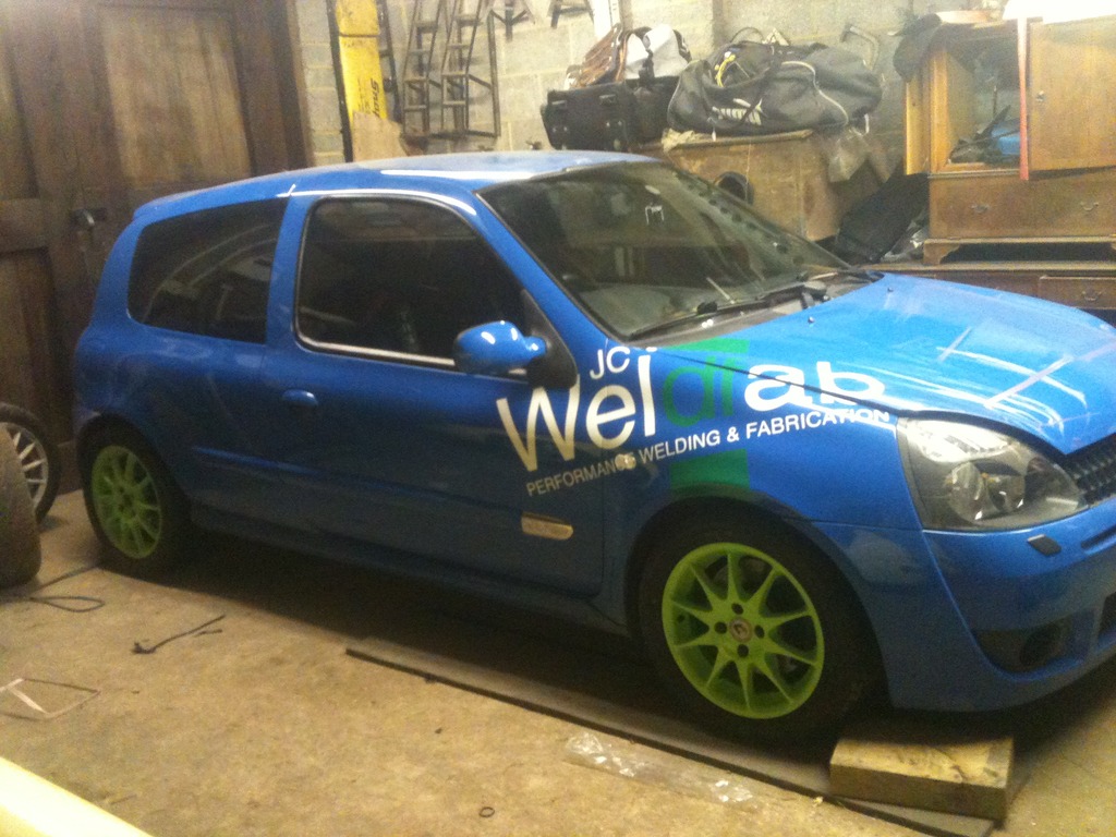

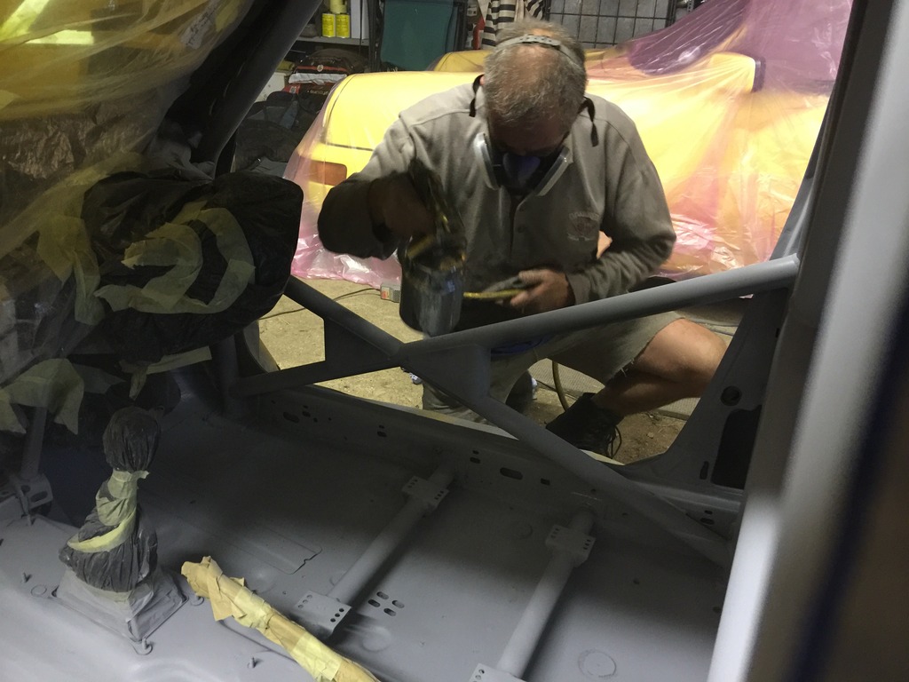

Finished paint (Inside is in matt black):

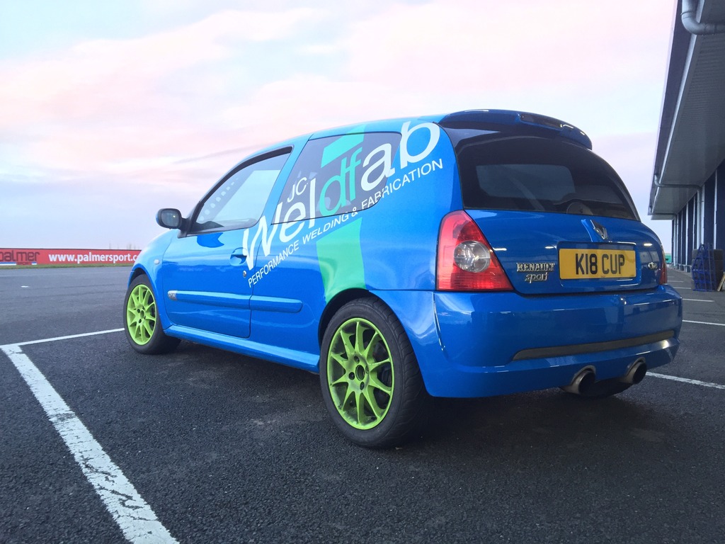

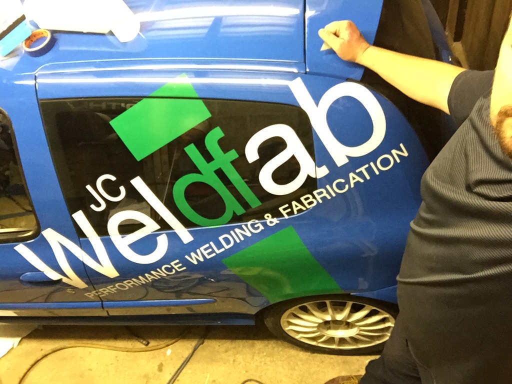

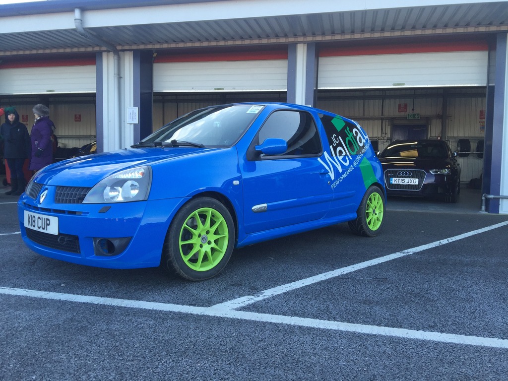

We're sponsored in part by JC Weldfab so it's time for stickers (I make my own):
And then, time to get her out and enjoy it:

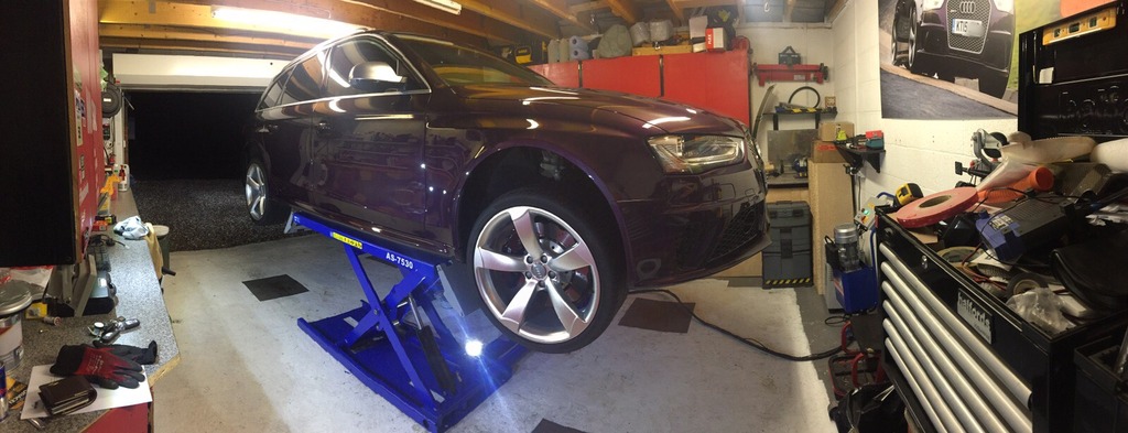

My RS4 sulking about being in the garage:

Clio 182 Cup with 85k miles in Racing Blue.
Fully stripped interior (inc all sound deadening, misc wiring etc).
Buckets & 6 point harnesses mounted to welded seat rails.
Porsche steering wheel on custom boss (Steve was insistent on this being a requirement!)
Sparco intercom for Peltor helmets.
JC Weldfab full weld in multipoint cage, inc door bar braces and windscreen gussets.
Custom made door cards, relocated switches, custom door pulls etc.

JC Weldfab decatted full exhaust system.

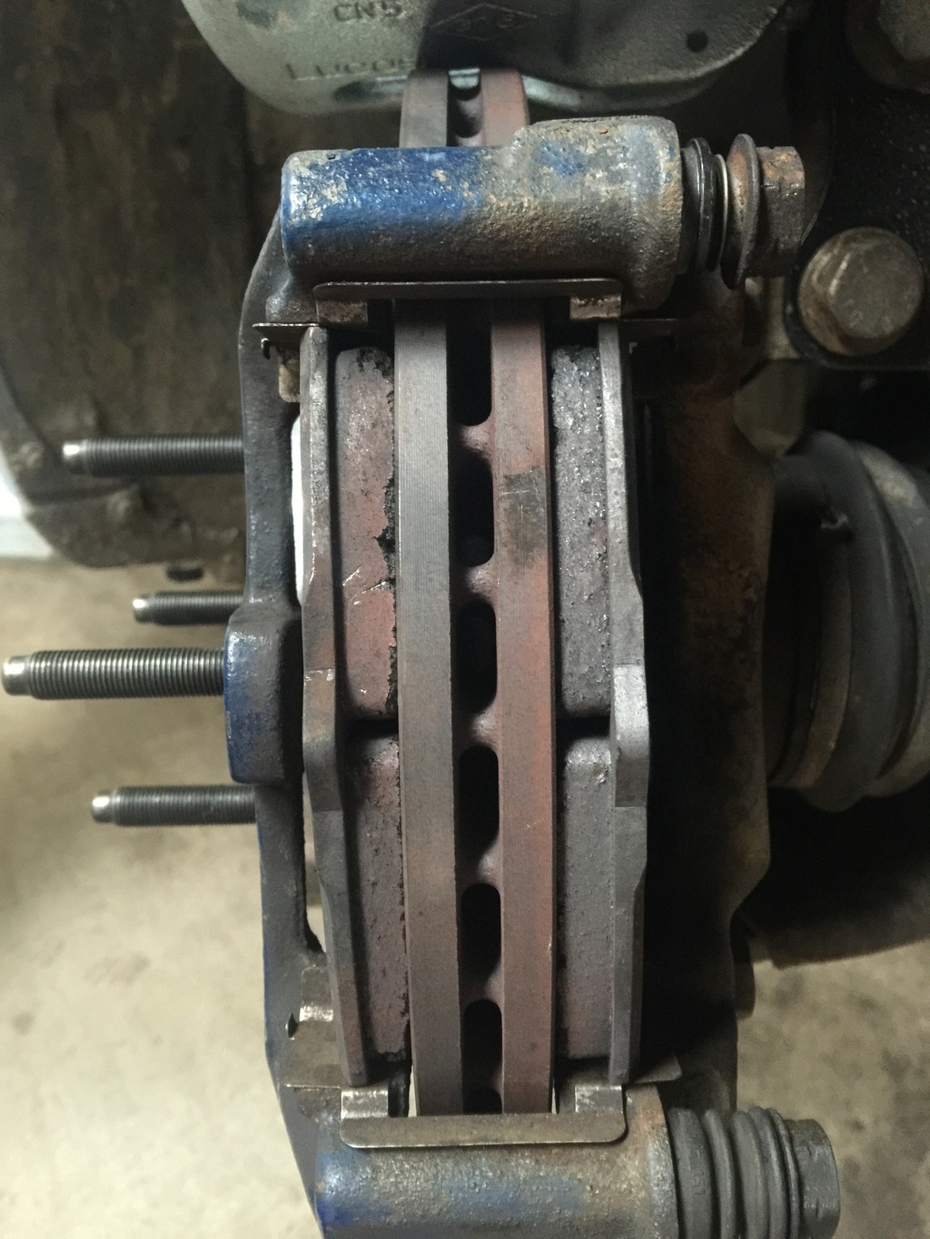

So... Brakes were an issue on the last track day - we got a long pedal, not spongy just long. Seems we've got a combination of issues.
First up was a stuck calliper slider and a ruined set of RC6 pads!:
- so we've ordered some willwood 295's with CL6 pads (my pad of choice).

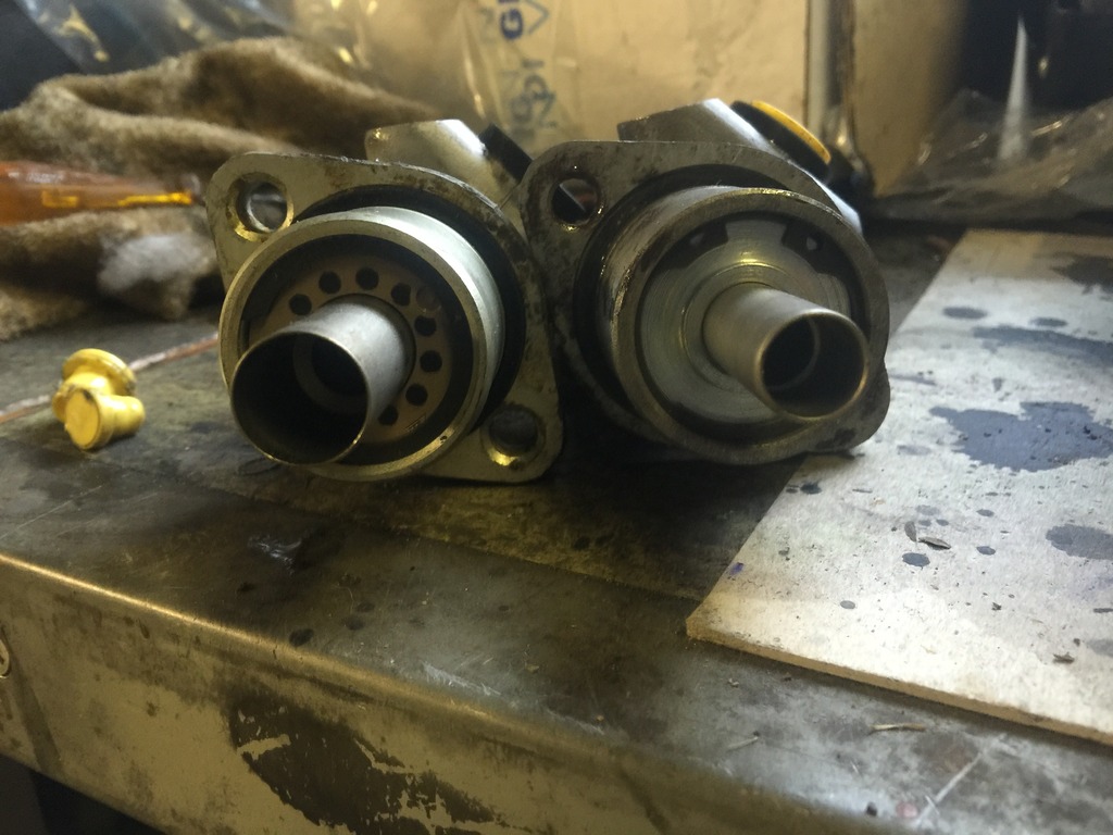

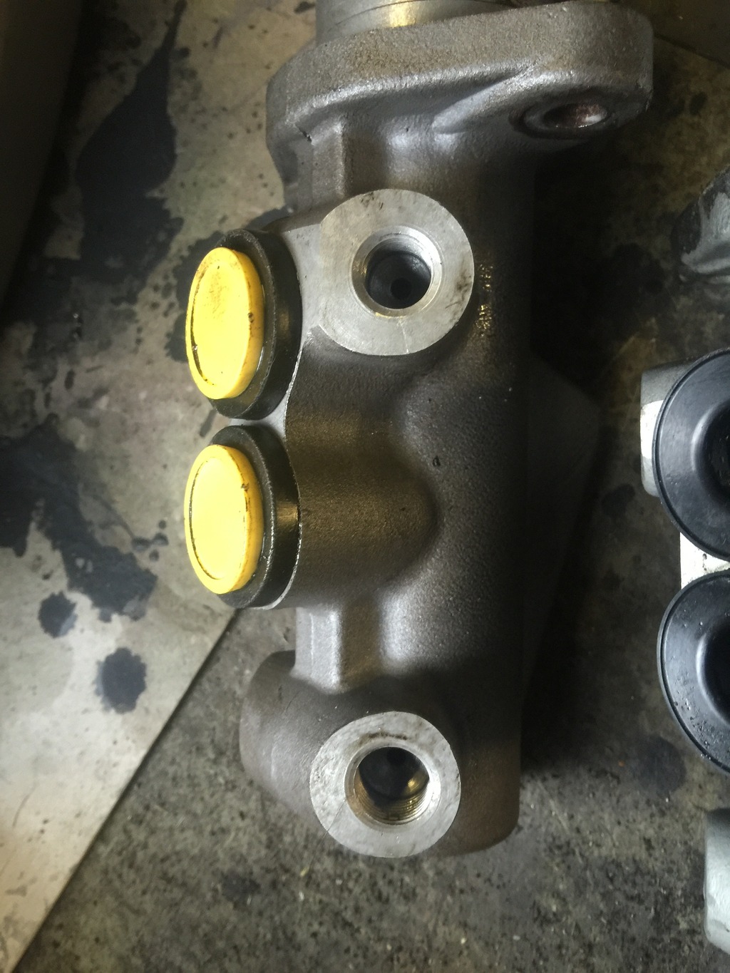

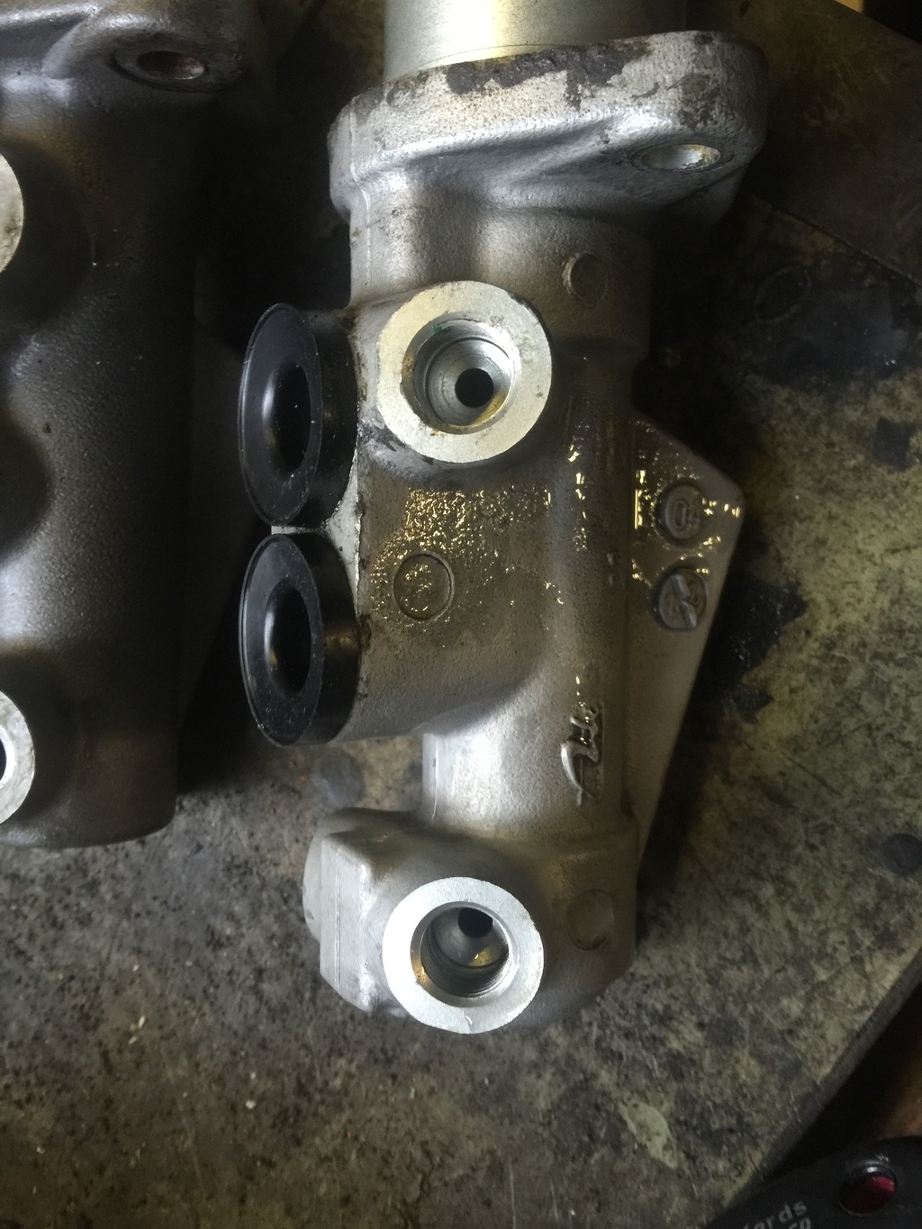

Also in the process of replacing the master cylinder although it's proved to be a pain (as we've a cup car and apparently this means we have an unusual post sized MS. 2x M12 rather than 1xM10 and 1xM12... 😧) Shopping round tomorrow for one as the usual sources (GSF/ECP etc) only have the one we don't want.
Standard:
Ours:
Both (ours on left - much larger shaft size):

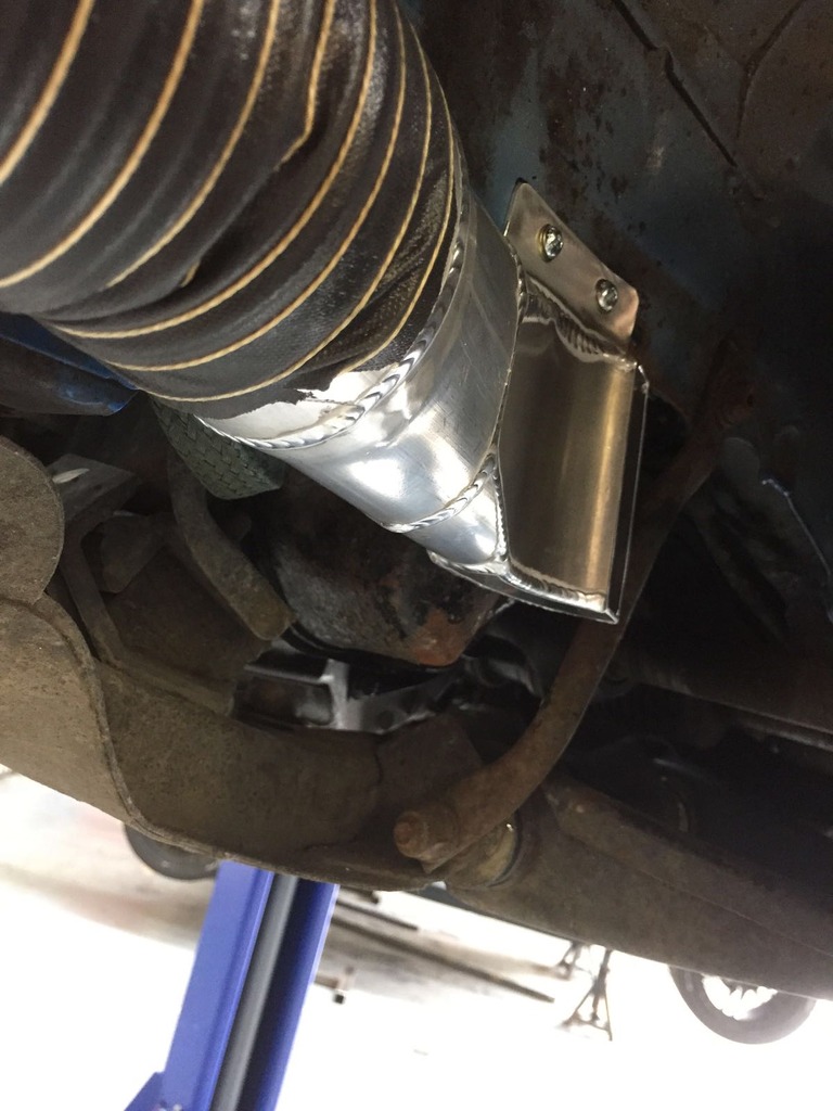

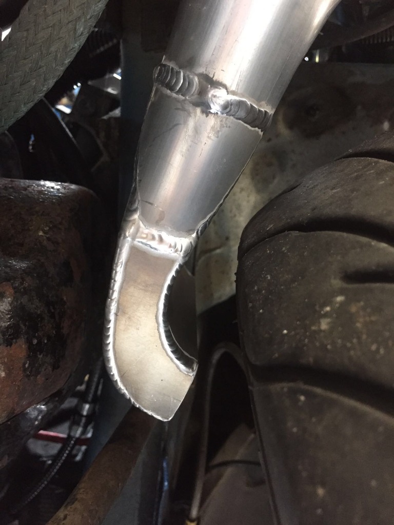

Anyway - talking of brakes, we're fitting some new ducting. None of this deflector malarkey:
These are made by JC Weldfab. If anyone is interested in some, do let me know and I can get a price worked out.

Love the air deflectors.
