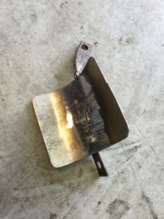

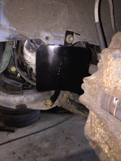

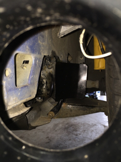

With the pads I would recommend cooling ... It's cheap to do and I've had no probs since installing a simple deflector and £5 duct off ebay tiger sealed in the fog light surround.
imprezaworks
  Mk5 Golf GTI :)
That looks pretty good. Have you a link to the parts, assuming you needed to make the holes for it to fit? I'm running ducts, seem to help the brakes a lot
