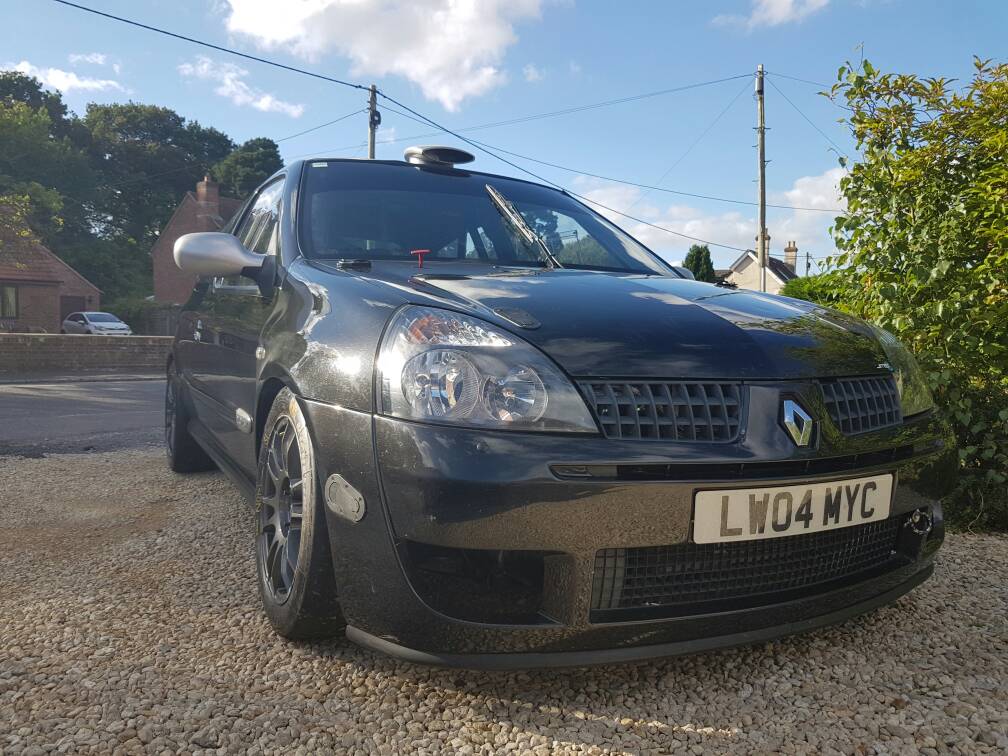

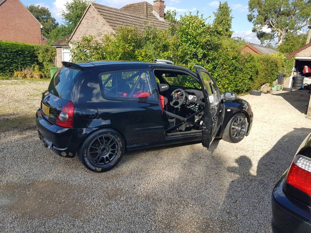

Well I think im all set for Saturday... maybe a swap of the headlights for blanks, but then load her up on the trailer friday night ready foe an earlyish start. Boom

Looks bloody lovely mate
