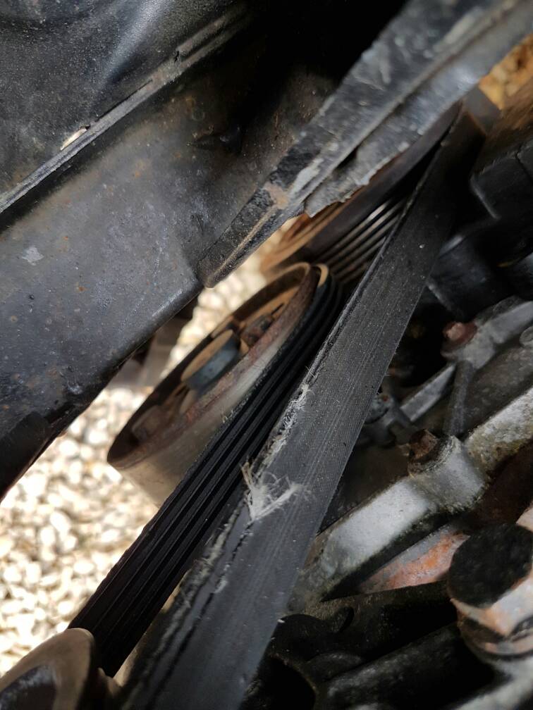

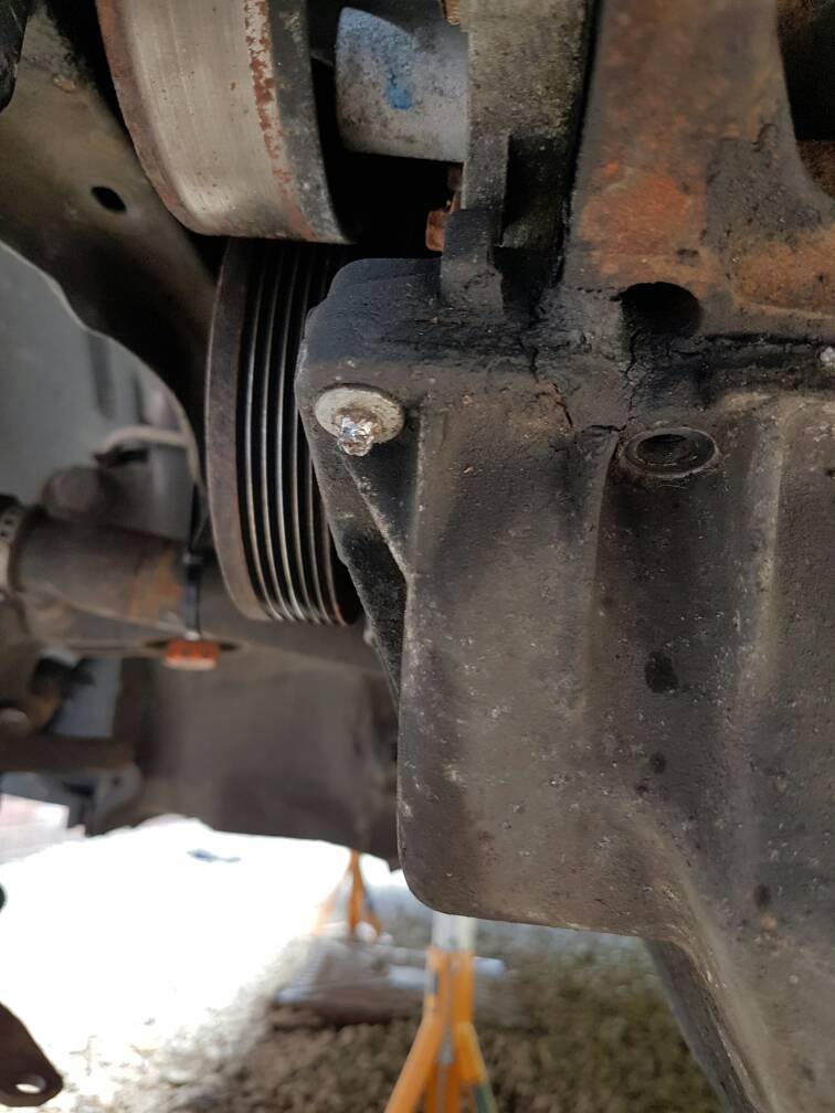

Turns out the aux belt totaly disintegrated, must of been catching on the crank pulley outer edge...
Properly fucked so a new 4pk belt ordered so it can run in the middle rather than the edge.
Snapped an injector, it was quite loose before and I think the impact must pushed it over the edge..
And in addition to the sump, bent the subframe, where it mounts to the chassis on the front, bolt tore cleanly through the hole! Brutal!!

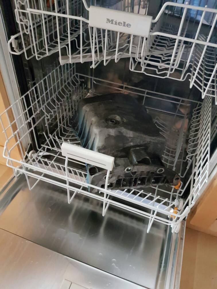

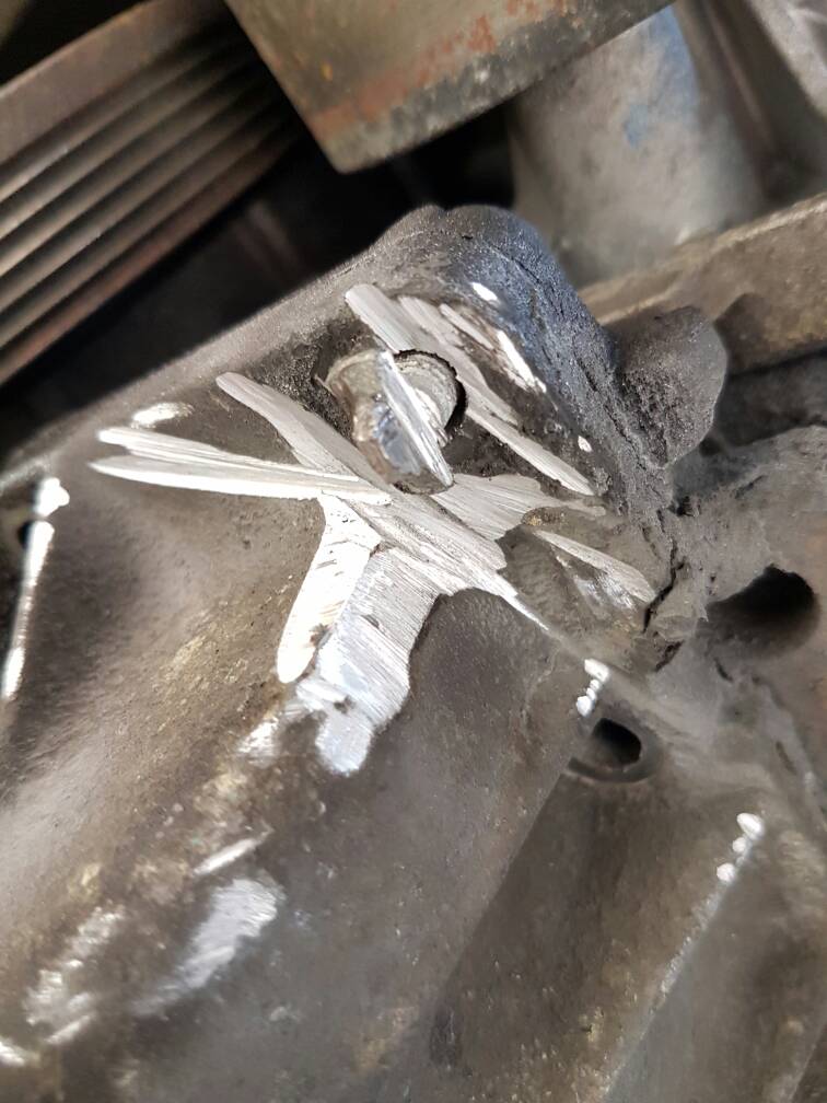

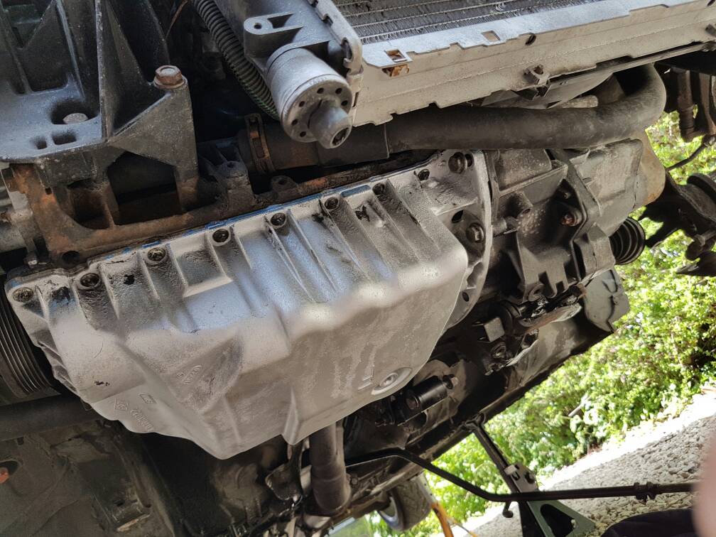

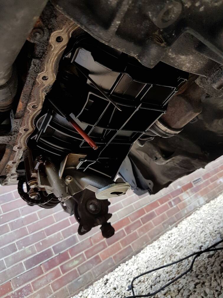

So yeah this morning i set about removing the sump to find this...
Proper s**t, so I did this...
Which thankfully worked as can see above!
Got the new sump cleaned up and a quick spray of silver paint..
Winning!

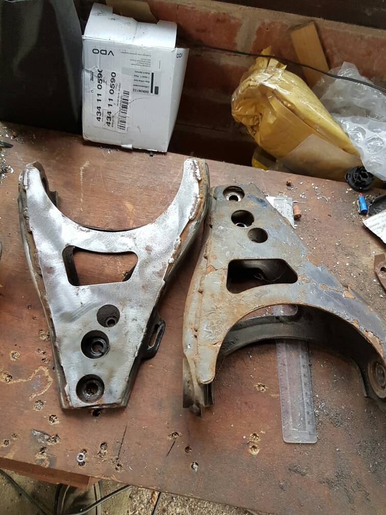

Also started cleaning up removed parts
Gonna send new subframe off to be shot blasted as its a mess! And then give a coat of hammerite.

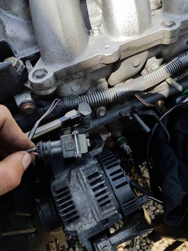

In addition to that, started putting the fuel lines inside the car, but didnt get round to doing the return pipe as I didnt order enough pipe!

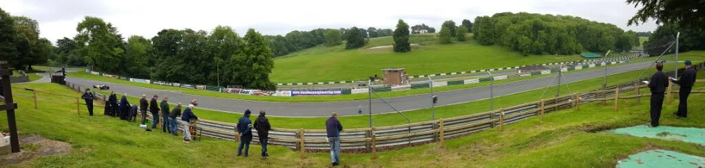

It was my first time on track at combe and I really liked the track! Defintely going to get a full day booked there asap!

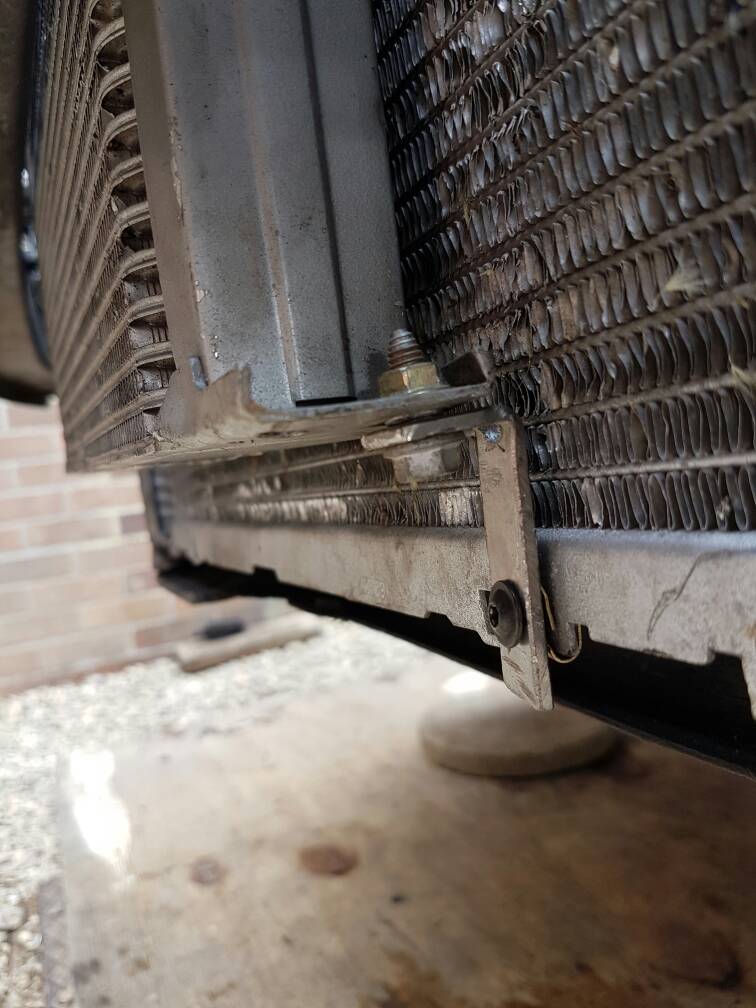

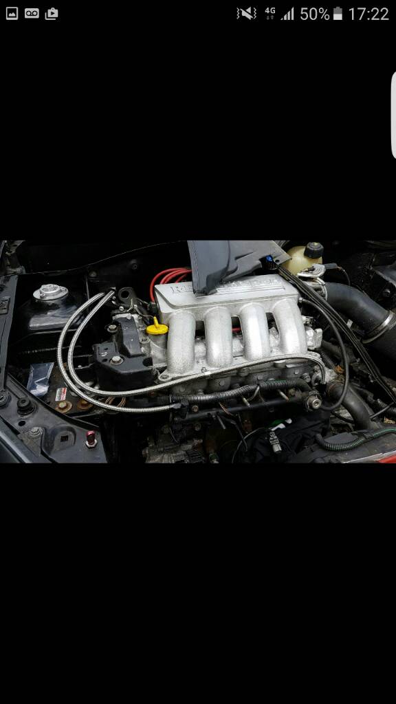

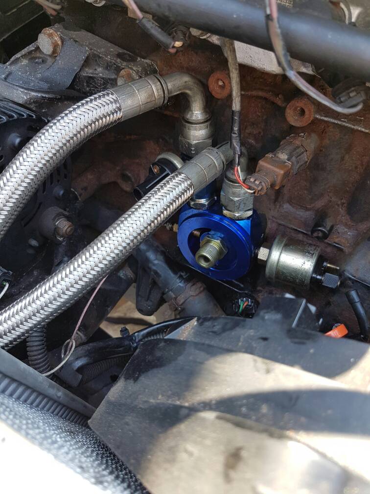

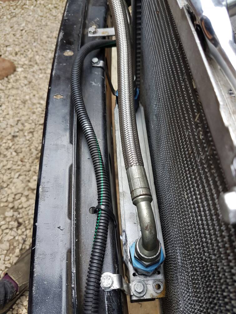

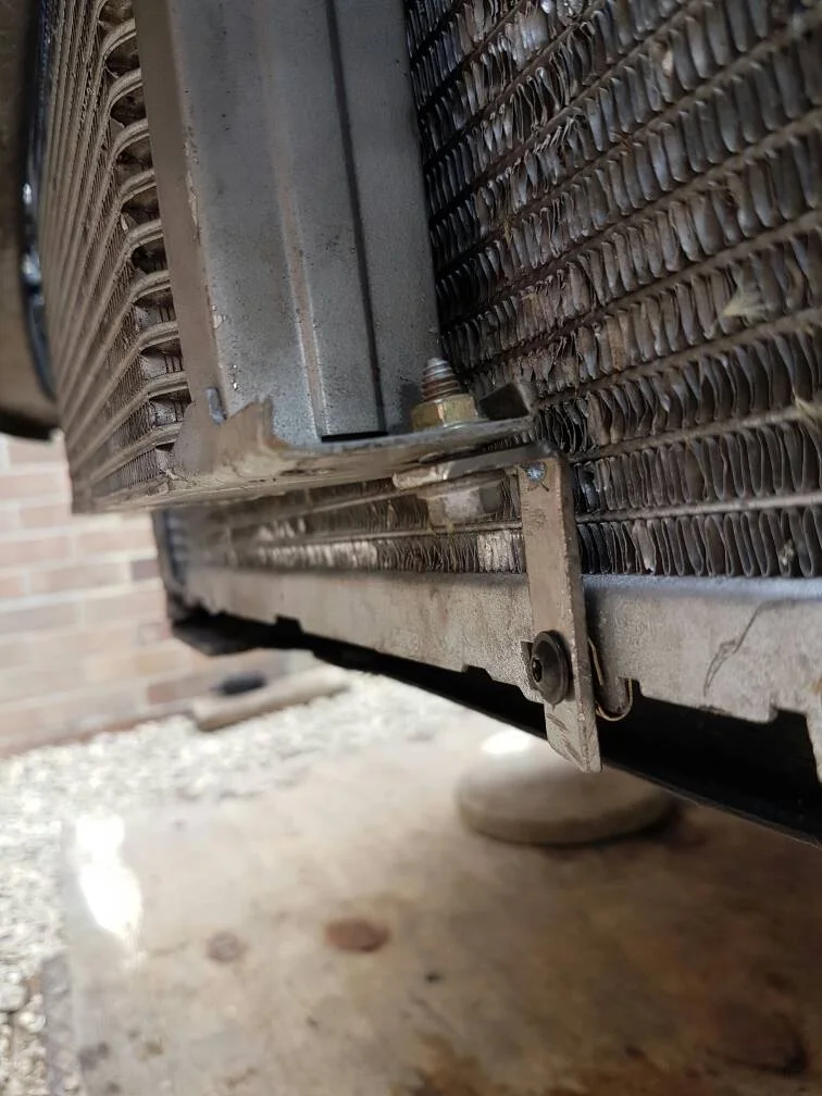

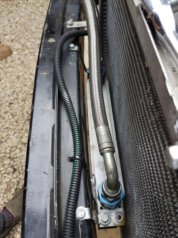

Sunday/Monday morning saw a spanner check of the car and fitting an oil cooler.
Fitting went well, hoses are a bit long but the end are swaged so cant be changed, so itll be reet.

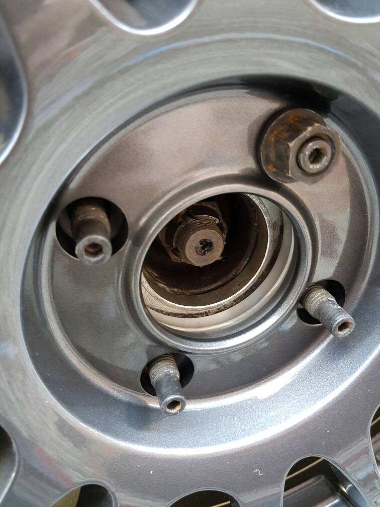

Problems with the new wheels though... bought tuner nuts which also dont fit due to the size of my threads, so im gonna take the wheels to a machine shop and get the holes widend.

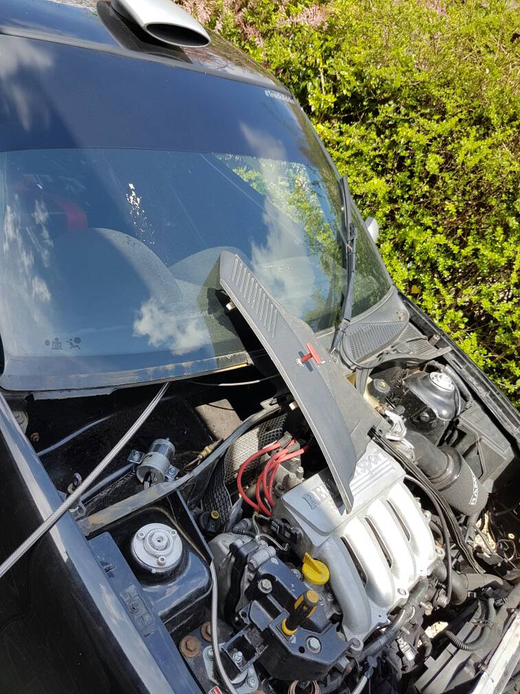

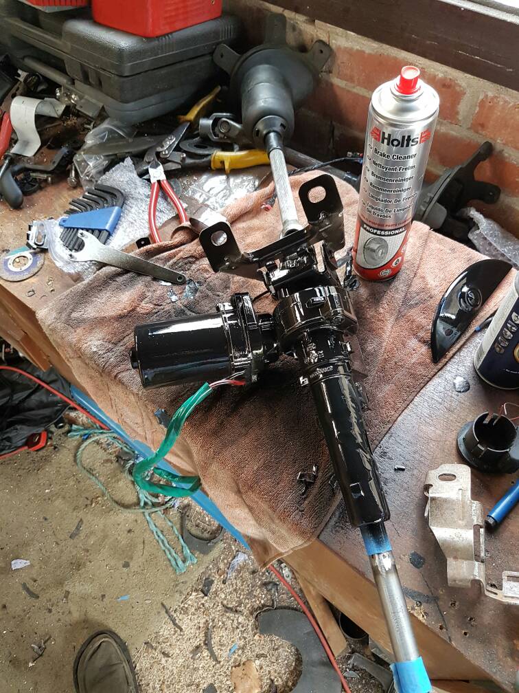

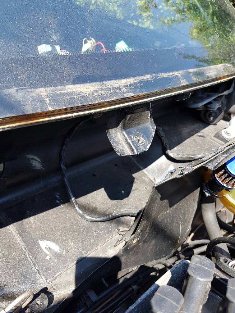

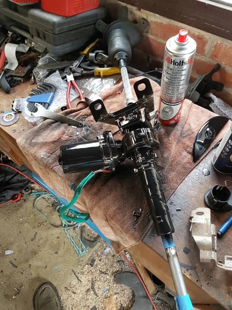

Another thing ive been working on is the fitting of a citroen ax single wiper motor.
So it started off like this, little bit scary and there is enough space to do it with a 4.5" angle grinder... just
Then I started making a loom for it. Trying to start gettinf a bit more ocd with this build, after the 1st gen build theres stuff i want to improve and work on, and take more time doing it rather than rushing it back together.

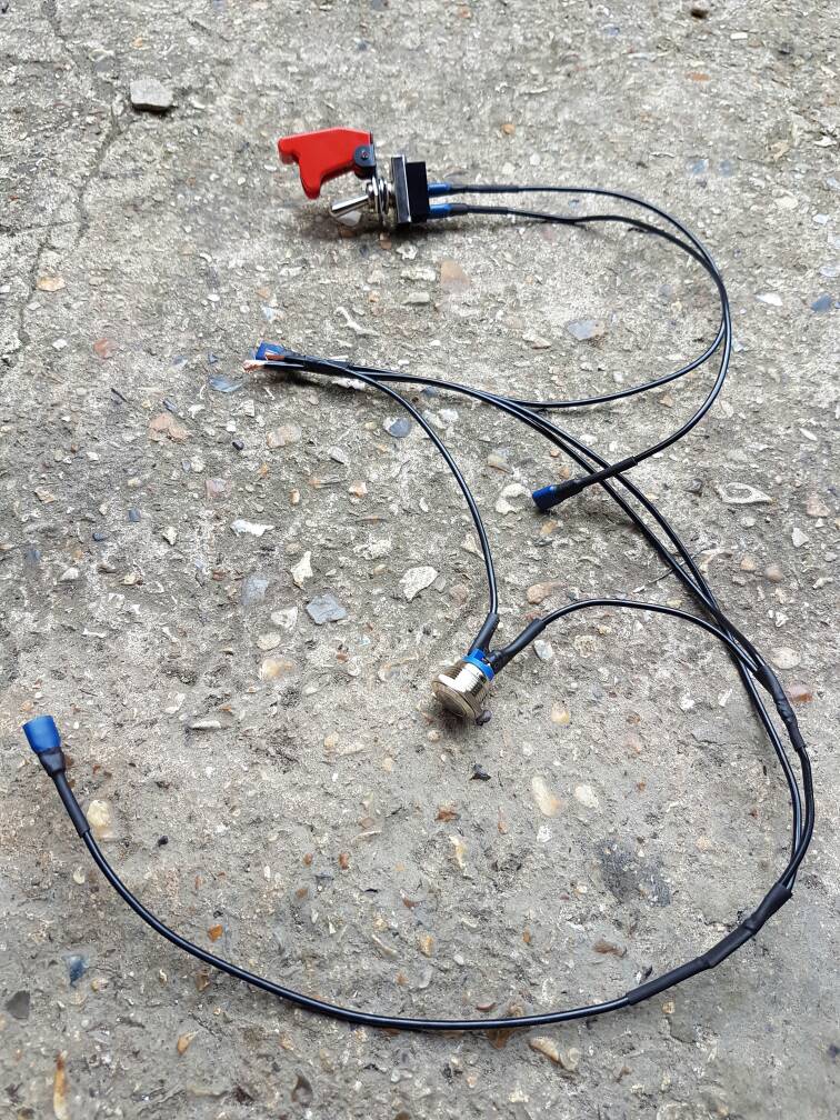

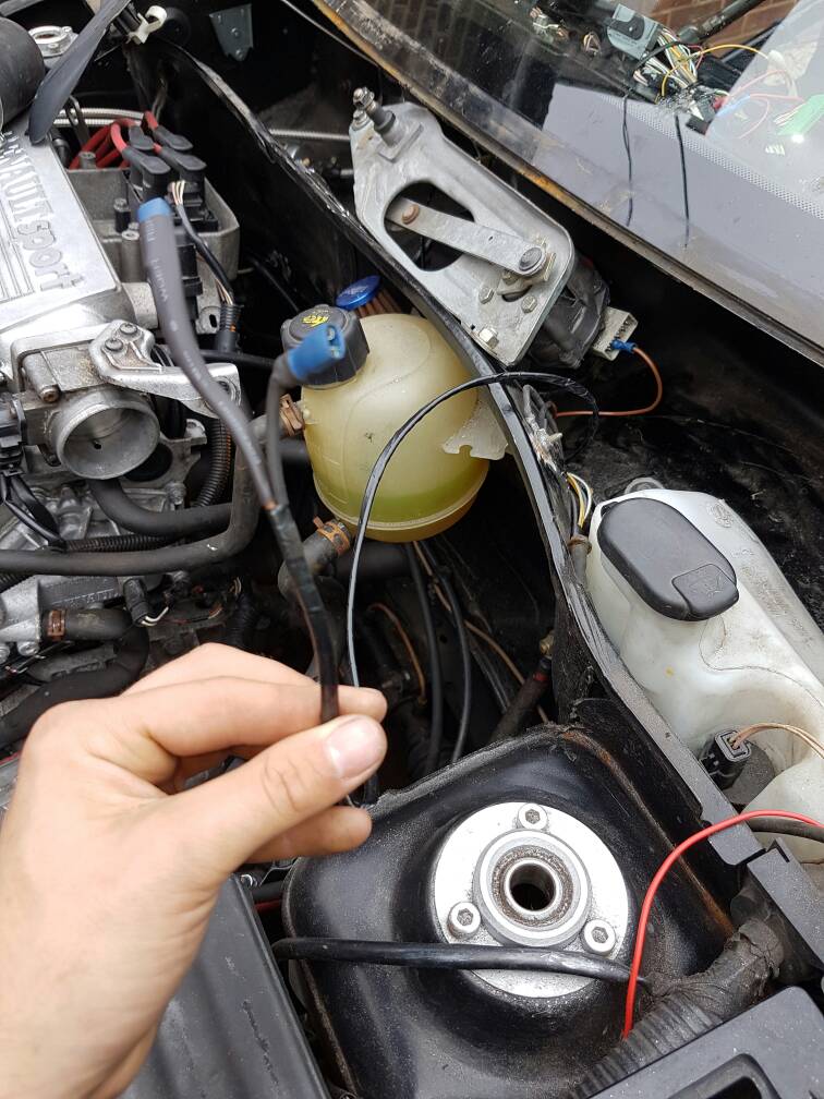

Had a bit of spare time to make a mate a plug and play ignition and push start button for his track car.
Nothing crazy, he just wants to get rid of the key so it makes sense.

In regards to the keyless loom, how do you overcome the key chip situation? Always assumed you'd need a custom loom and eco etc.
Nice work mate!
Theres a couple of ways, on a ph1 ecu like i have you can have the imboliser decoded, thus removing it.
On a ph2 you can just tape the key inside the decoder ring and hide it behind dash, then jobs a gooden :)

I had the same problem mate. Took my studs out in the end lol
was wondering what you were talking about!
but yeh its very annoying, I cant really remove studs as I'm running spacers - think I'm just going to get wheels machined

Yeah I was well annoyed lol. You tried taper nuts? Your studs look a lot shorter than mine I couldn't get taper nuts to fit for s**t lol
No dont really wanna go for them, as theyll reduce the contact of the taper and I dont run spigot rings eiter so would escalatw it furthur.
Gonna get wheels machined, I'll let you know a price I get :)

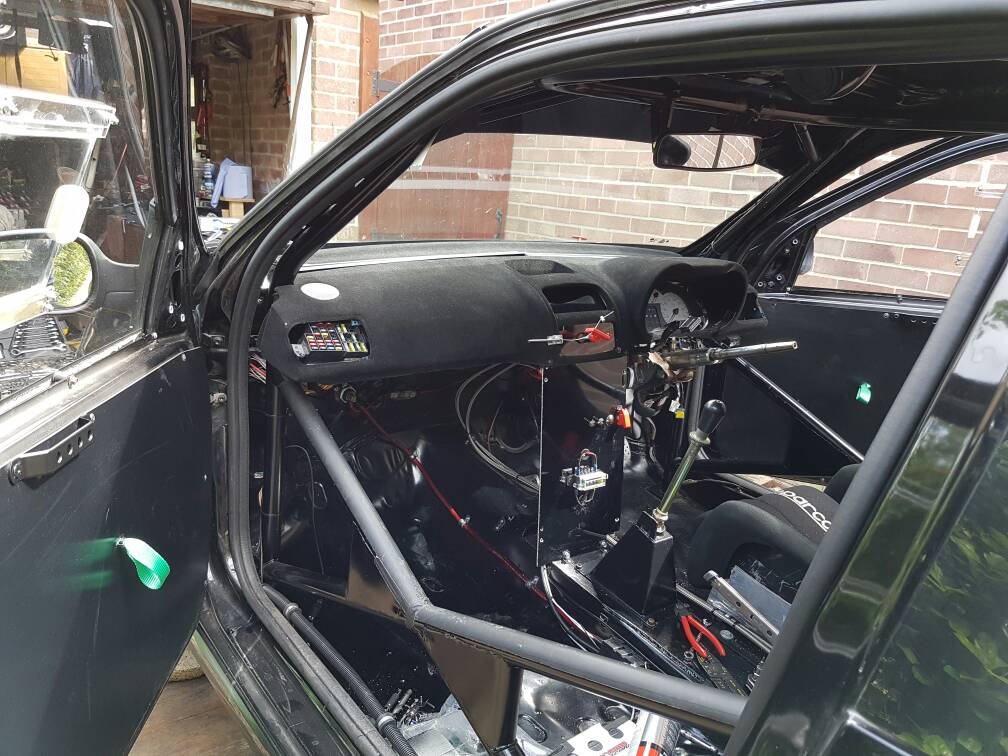

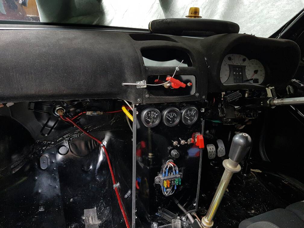

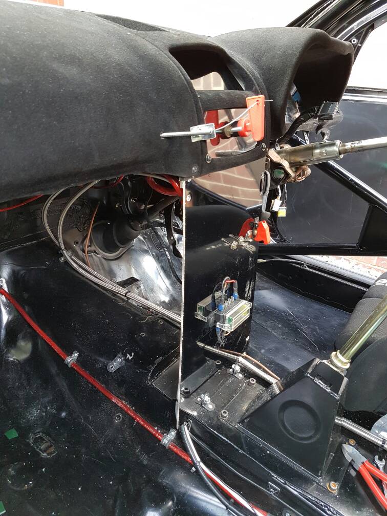

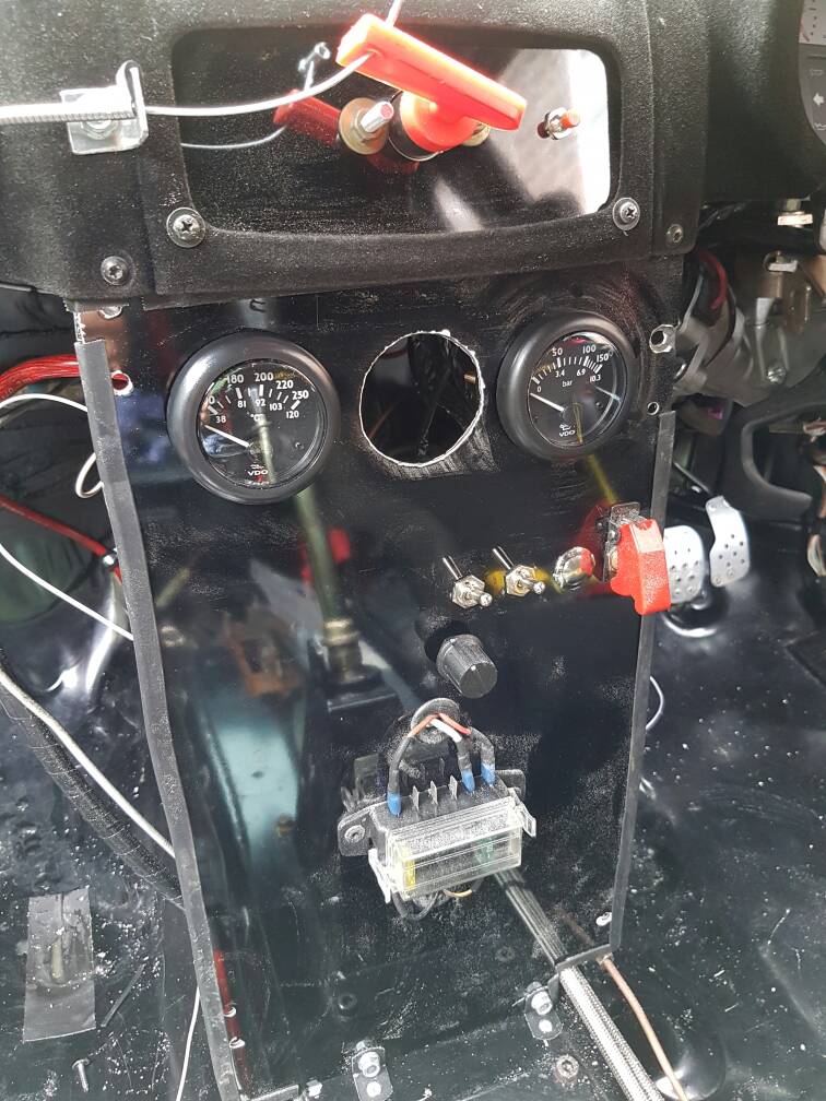

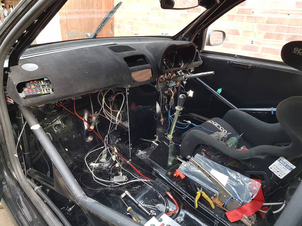

Hating how I did my dash the first time round I decided i would put some effort in to get it how i want it...
So sourced a ph2 flocked dash for a bargain, and got to work.
Bought some alumnium composite for the centre console bit and went from there.
The composite I got was pretty brittle and not really what I expected as id thought it would bend like alloy sheet... but hey ho got there in the end
Pictures from the start on friday, but unfortunately couldnt finish due to working up at silverstone for british GT running one of the g40s in gt5 class.
And the finished item, its amazing what a weekend away can do to the appearence of your car...
Im kidding, one of our audi r8 lms cars we run in gt3, its gorgeous.
Anyway the finished article, all be it missing guages for volt, oil temp/pressure and a few more on off on switches for lights and horn.
Pretty happy with it, theres still a few little tweaks but much happier with the way it looks now.

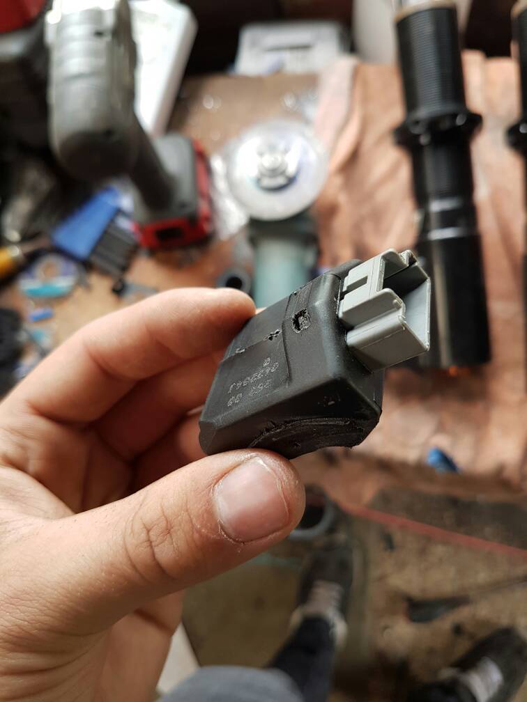

So turns out removing the decoder ring compeltely messes them up, removed it to cut the casing down, then repalced it tried to start nout, bought a new one and one spare and all was fine.
Cut that one down, and then again wouldnt start, start yeah now using the spare but doible checked removing them from the casing f***s them up. Just so you know...

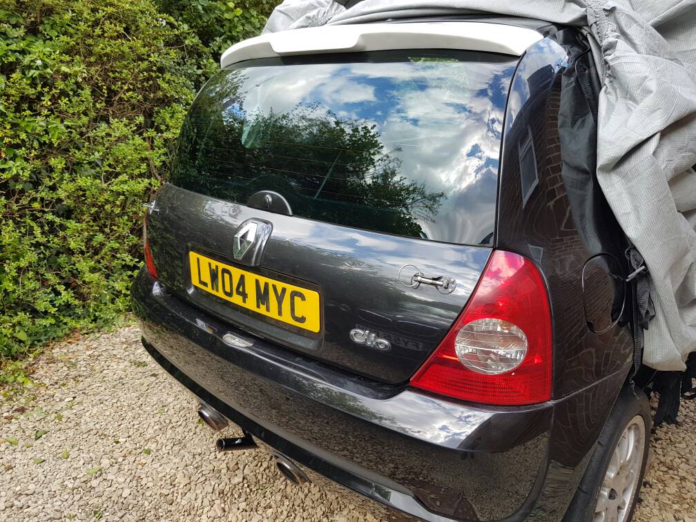

Welll the car staying 100% the effort of breaking it or selling it was to much to fund a new project, especially as it was on 3 trackdays old. So its staying untill futhur notice, and the fact that I f**king love driving/working on it.

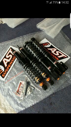

Anyway, been waiting on these for a while but theyre finally ready to collect next week.
Very excited indeed! I decided im not even going to bother attempting to get asts 5300s, so a new set of 5200s will do, which I should be picking up end of this week.
Just gotta fit them, string and corner weight the car before a OPL at Castle combe 6th August canne wait.
Sent from my SM-G935F using Tapatalk

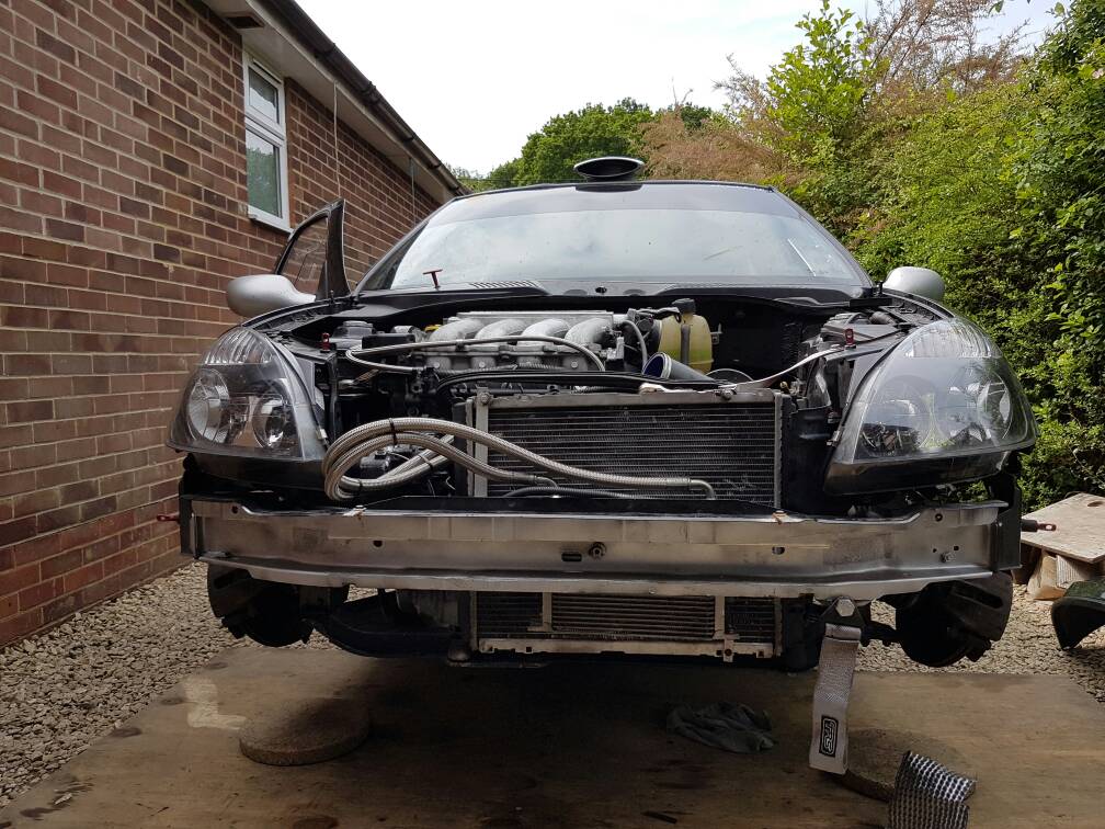

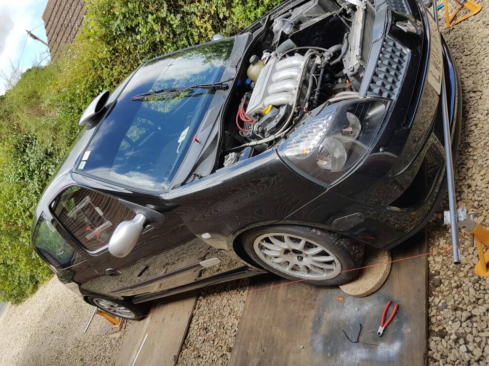

Updates:

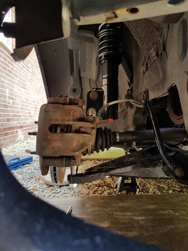

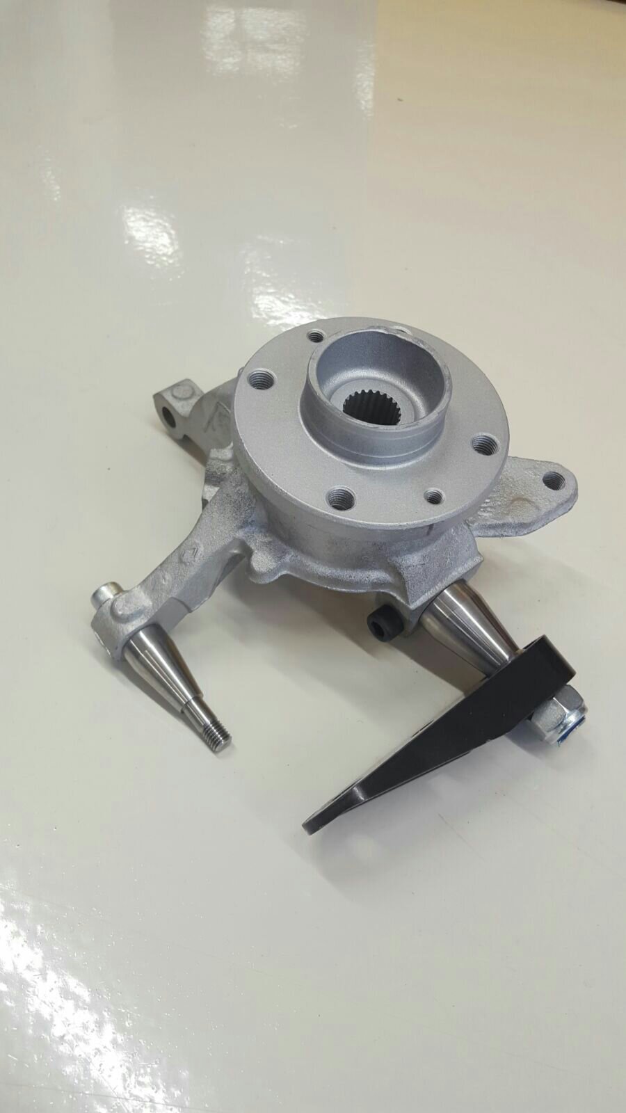

New 5100s are on, along with my roll centre correction hubs, had a little road test on them earlier and christ the turn in is epic and a notcieable stable/higher cornering speed.
Sent it through a quick alignment check, as there was 7mm toe out and 4mm toe in on the wheels so was very wonky, now down to a respectable 1mm toe out.
I didnt spend to much time getting it perfect as it will be getting corner weighted next week so will re adjust the toe to 2mm after its been up and down on the scales.
First time I've strung my own car before and what a faff, although will be made easier next time by a flat floor and more accurate of course.

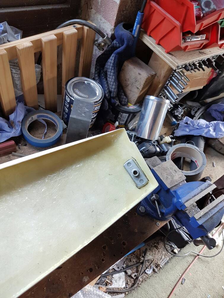

Fitted my composite cup spoiler kept it removable as will be going for a plastic rear screen shortly.
It is also now wrapped black, but I did an awful job of it im not going to take a picture of it haha so I reckon ill spray it black as thats easier to do!

Is the ball joint on the RC hubs a newer version? Looks different from what I can remember Kelv's looking like.
Cheers dawg
Yeah these arnt marks kit, so yeah theres a few differences [emoji6]
