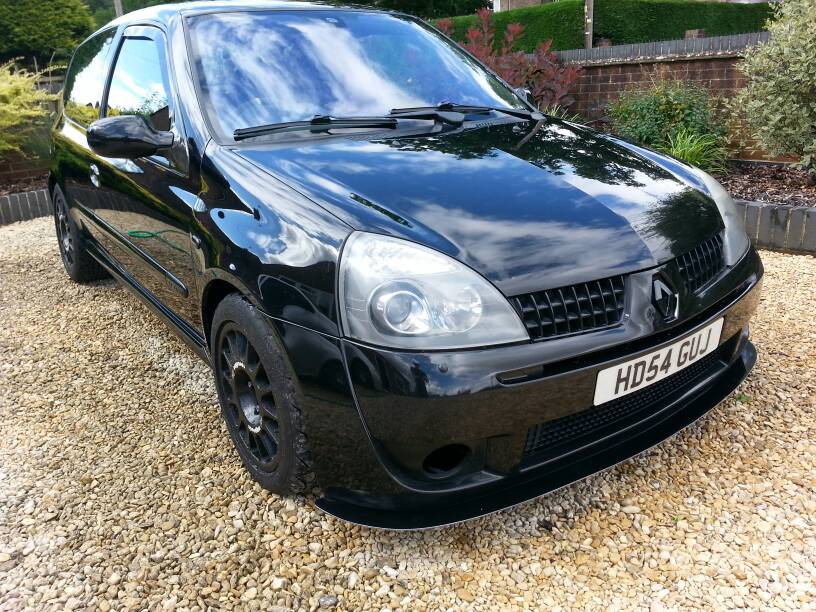

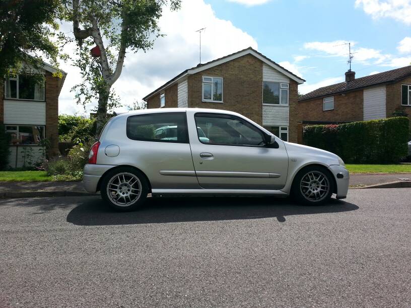

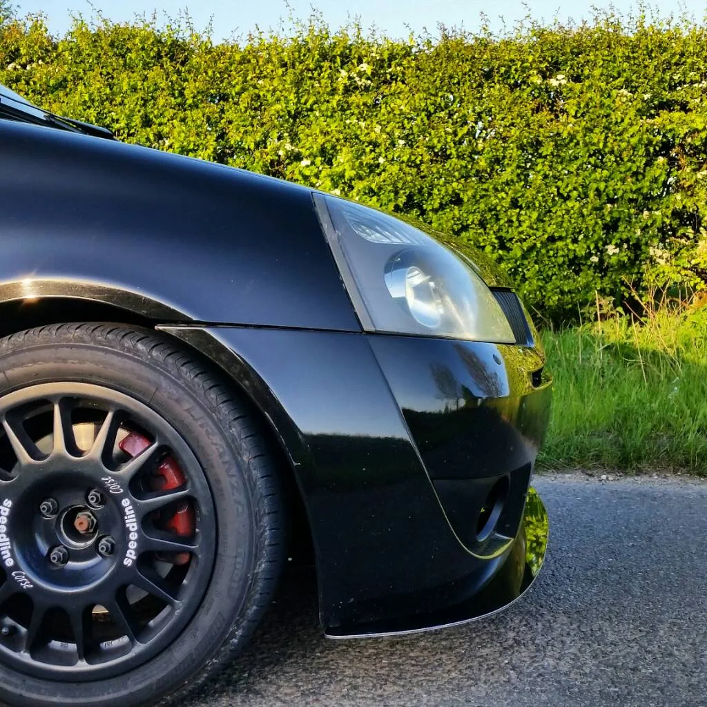

So recent events have forced me to part with my 182 (which can be seen below) lots of money has been poured into it as you can all understand, and is currently up for sale.

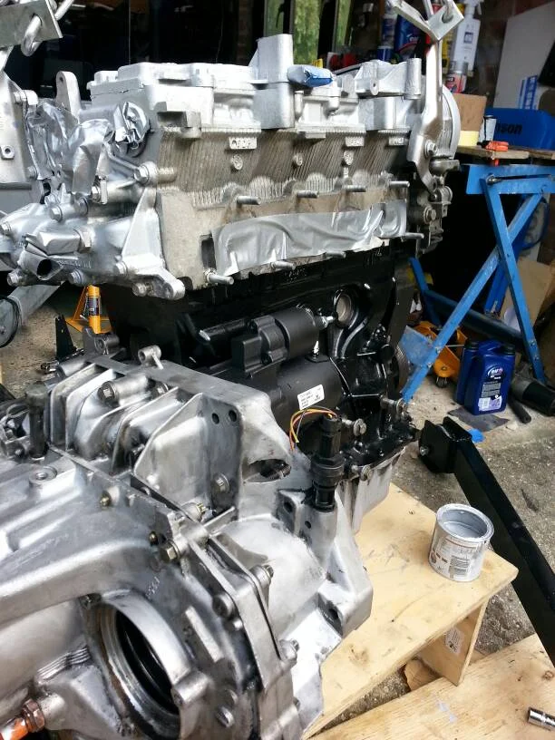

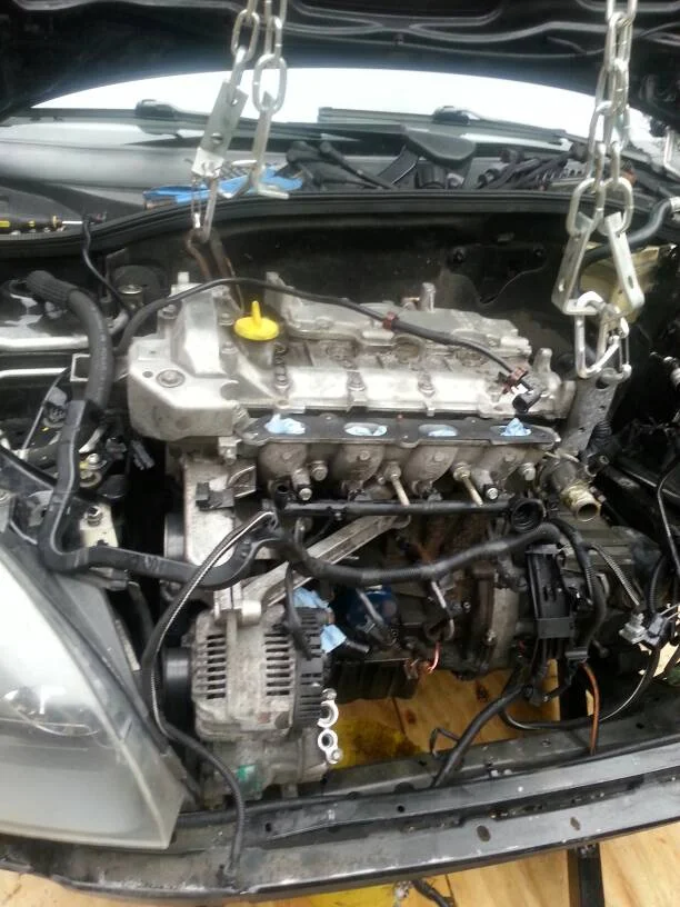

It recently underwent a bit of surgery due to a crunching 3rd gear and a dodgy starter motor, so I decided to remove the engine as a hole, as before the sale it would give me a good oportunity to clean it up - my thought process behind this was last time i removed a 182 box it was by dropping the subframe on my back on a gravel drive - it was unpleasant!

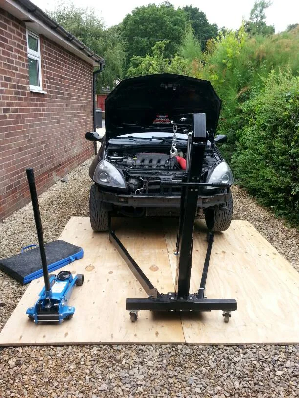

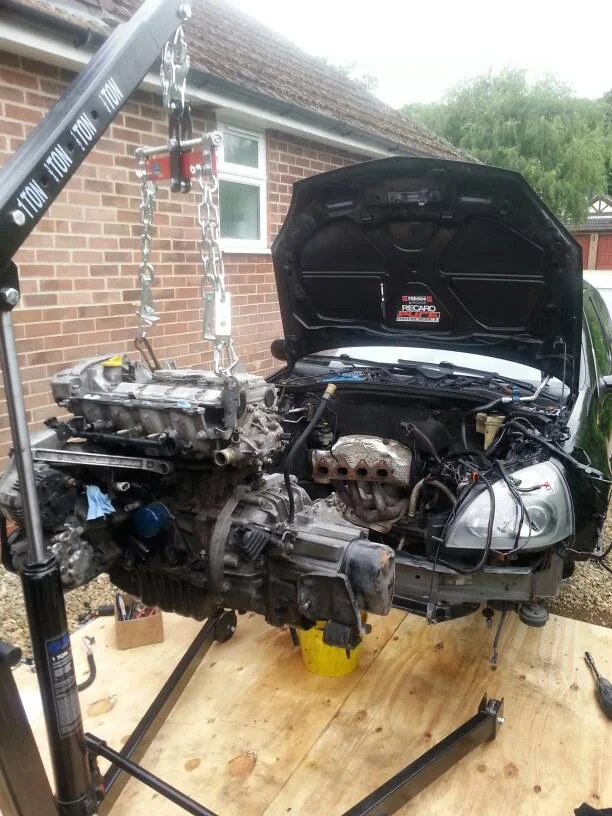

So I began sourcing stuff I needed, I borrowed an engine crane from a @CUB off here, who was very helpful providing that, and when I say stuff that was all I needed really.. haha but yep top man he is!
Here's how she started.
A during showing state off engine etc

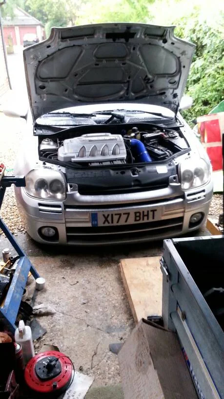

So it was a big learning curve and it was the first time I removed an engine, but it came out without any issues which I was pleased about.
and there she is back in and all cleaned up with no issues, apart from the live wire of the starter motor was touching the trigger wire... when I connected the battery I thought I had managed to hotwire my car as it started turning over...

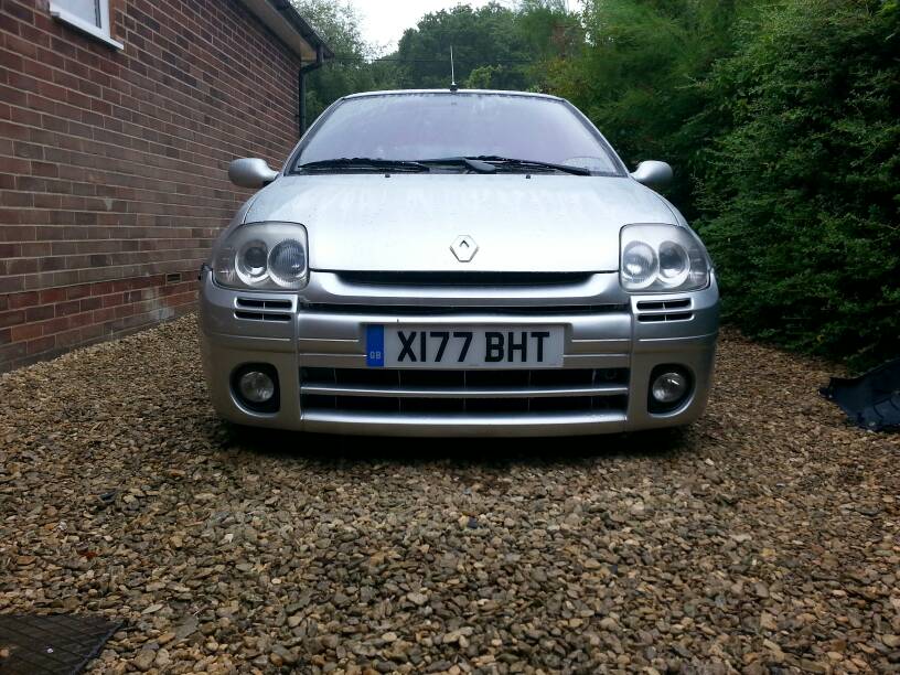

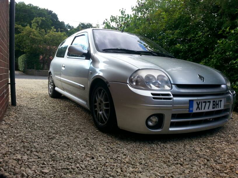

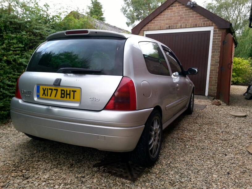

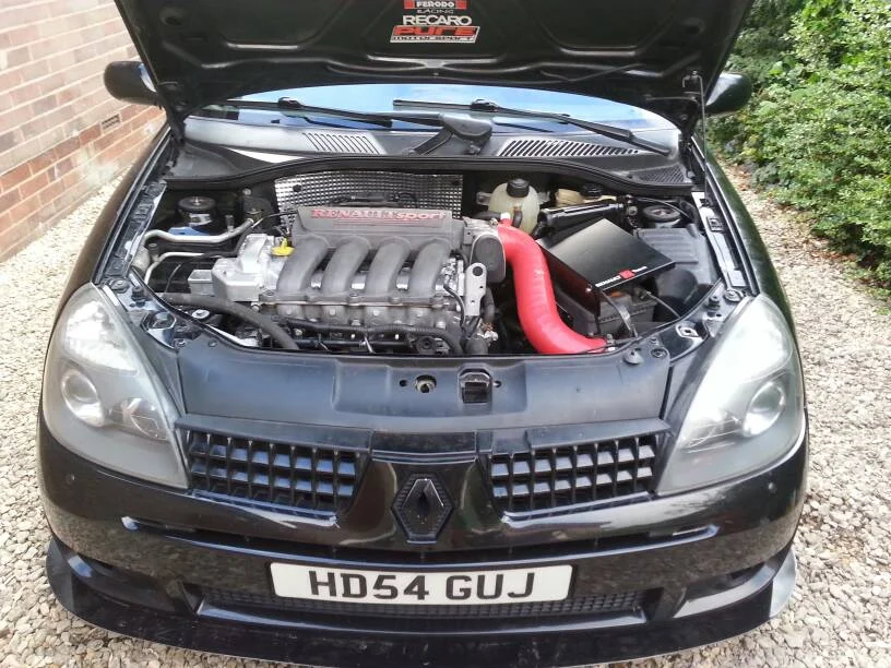

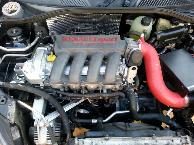

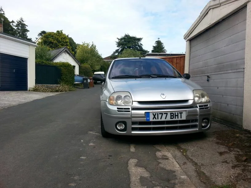

In addition to this I have bought myself a run in 132k phase 1 - I've always wanted one and now is probably the right time to, the title suggests this will be tracked, and further down the line when a daily is sourced - it certainly will be.
I bought it very much standard, it hasn't been looked the roof looks like someone's had a dance on it, but hey its cheap and the front end is cool af.
Picked her up from Devon
First thing I did was change the rear lights to ph2, but not I'm very much regretting it since I picked up a cup spoiler... :( (for £25 bargaaaaain)
following that, i restored the headlights using the usual method
It was raining, and garage space is minimal...
2nd update was to replace the drivers side door, which the guy had supplied - turns out a Ph2 door will fit in a 197
also put some ph2 bump strips along with colour coded door handles... which is a Ph2 mod I do stand by! haha

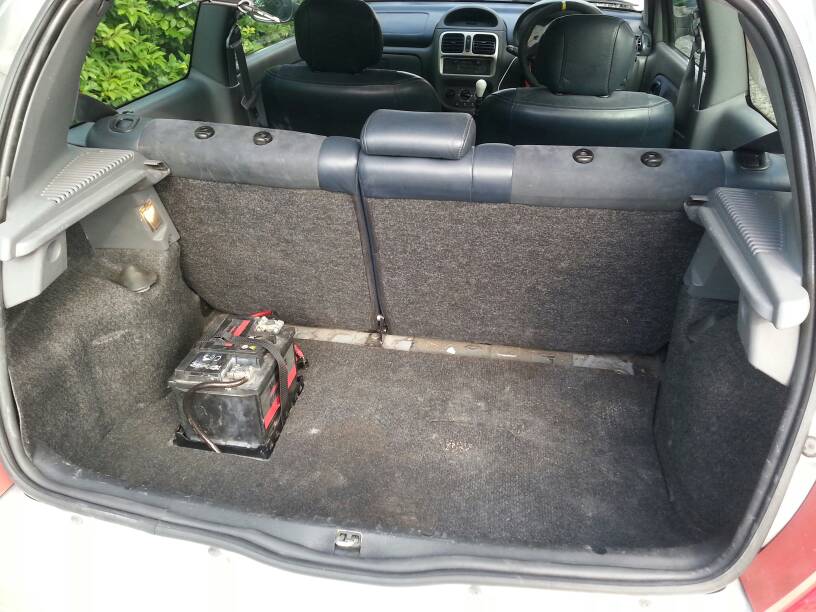

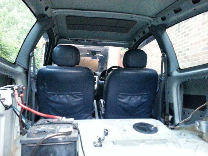

So I'm currently in process of relocating the battery to the boot just waiting on a cage for the battery.

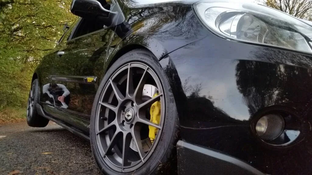

This was a few months back but managed to get the misses out on track with me haha (she's not being serious with that pose btw)
since the 182 is popular ill throw in some photos i have to hand.

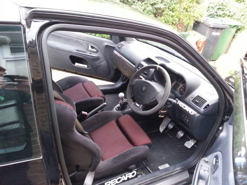

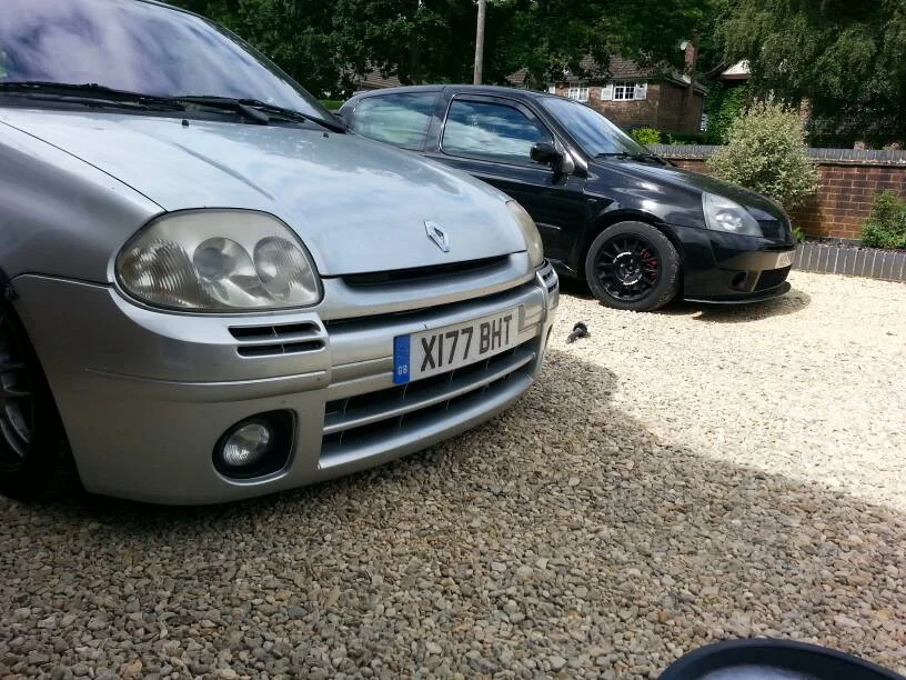

so its a sad day, the 182 has been sold - Craig (he is on here somewhere) picked it up today!
in other news the ph1

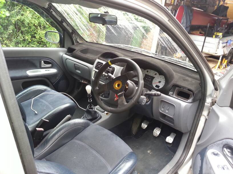

-the battery has been relocated, starter feels a little more sluggish than it used to..

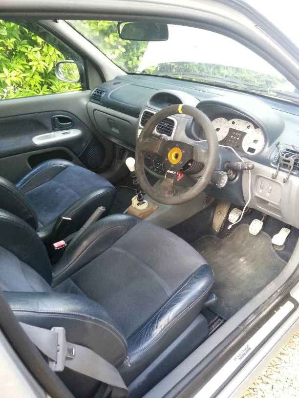

- update on the steering wheel
- and here's how it sits now, going 15mm slip on spacers all round so I can keep my stud and nuts

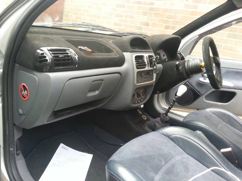

So a few updates have taken place

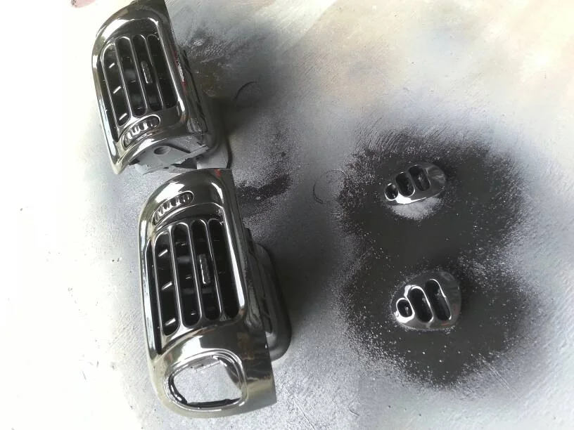

- Flocked ph1 dash
vents are currently drying after being Sprayed black...
Flocked steering cowling, A pillars and centre console are in the post.

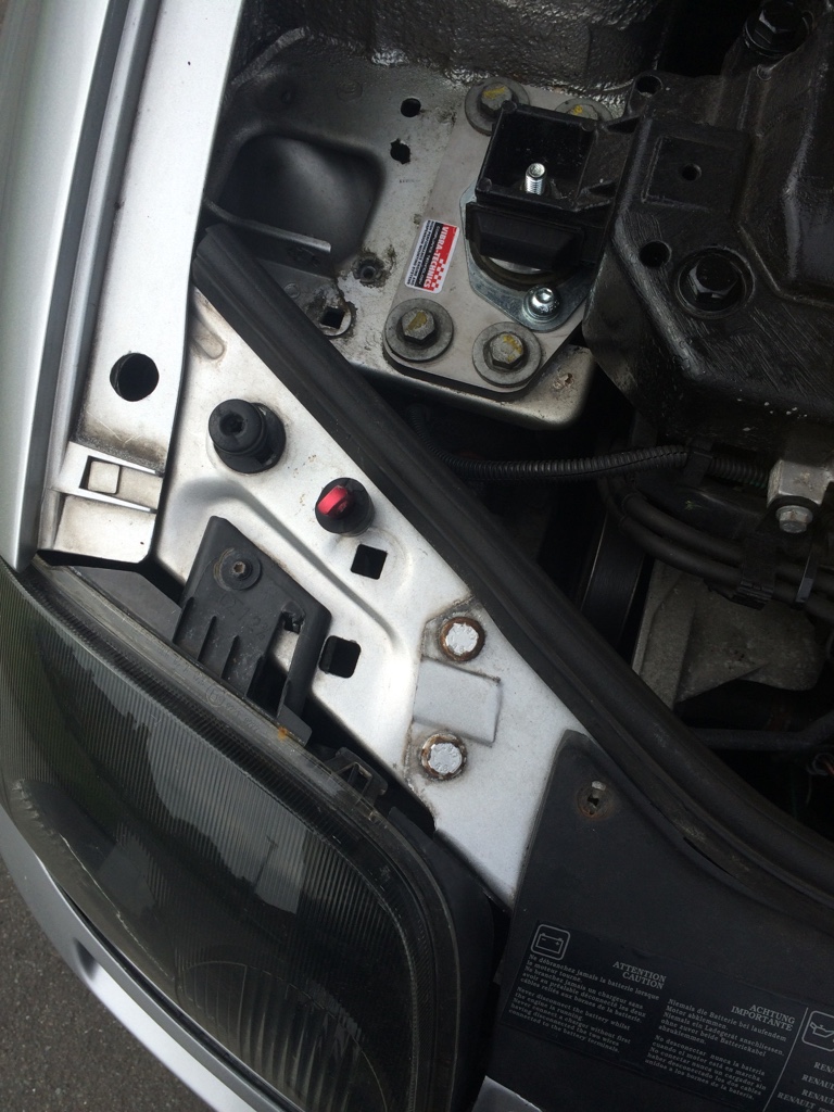

plus aerocatches for the bonnet and bumper instead of the w**k rubber bands things - although when I remove them it will leave a few holes - meh

Dash looks good.

so dash is complete: upper, centre console, steering cowling and a pillars - my misses is a true hero she made me and about 10 other people custom suade gearstick gaitors.
(the top isn't zip tied yet so looks a bit untidy)

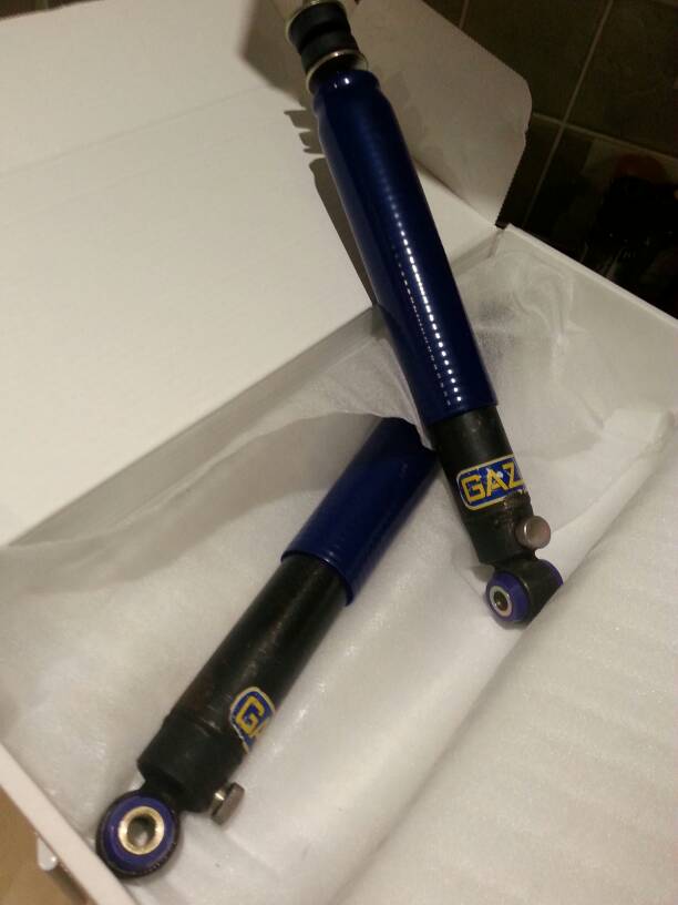

also just had the rears come back from GAZ for a full refurb with a new set of springs, although kinda regretting as want to change to rear coilovers for more height adjustability and cheaper springs for a mixture of setups for different conditions/tracks

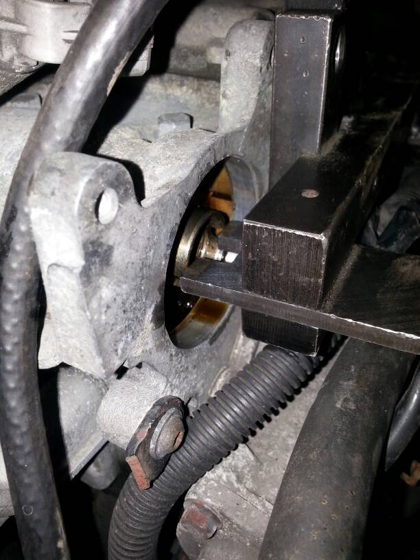

When I first drove the ph1 before buying I knew it was under powered and I guessed the timing was out - got I back home and put it on clip to do some diagnostics - the manifold pressure was pretty low which either pointed at timing or piston rings haha - luckilyyy
So this was all sorted and it runs better than ever.

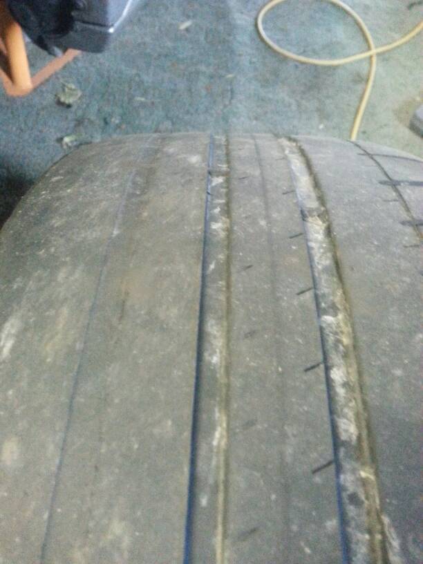

Alignment has been set up haven't got a photo of the read outs - but 10 mins toe out, 2 degrees camber front and 2 rear.
These were the previous budgets which have been replaced with NS2R's

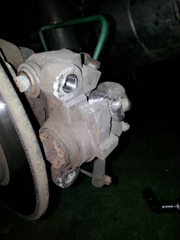

while fitting the rear camber shims the thread in the calliper decided it hated being in there - so helicoiled it up and went on my way - love the kit

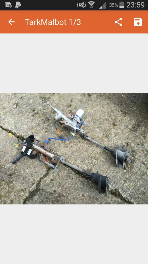

EPAS system has just been purchased from @TarkMalbot on here, he's a good chap and his project thread is full of birds (chickens)

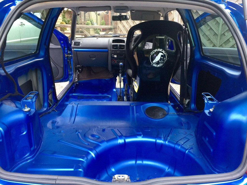

Well, onto the last update. I have just bought a very cheap DCI fora daily/run around - this means it's time for the ph1 to go fully striped.
There gonna be no holding back, most of the loom is going, all unnecessary brackets are going etc etc
Interior is going to be painted in por-15 grey with a white 6 point bolt in cage.

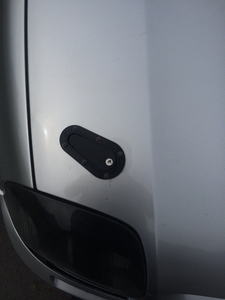

Oh are you Jason? hello - i haven't installed them yet, just cut out the skin off the bonnet - but I'm using the hole i said and I'm tilting the aerocatch parallel to the lights

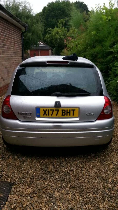

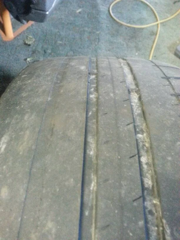

yep £450 needs two rear tyres - i had to get over the fact it really isn't a looker but hey ho!
Ahh ok - will look good holiday the same , others have done it like that and is ok I suppose.

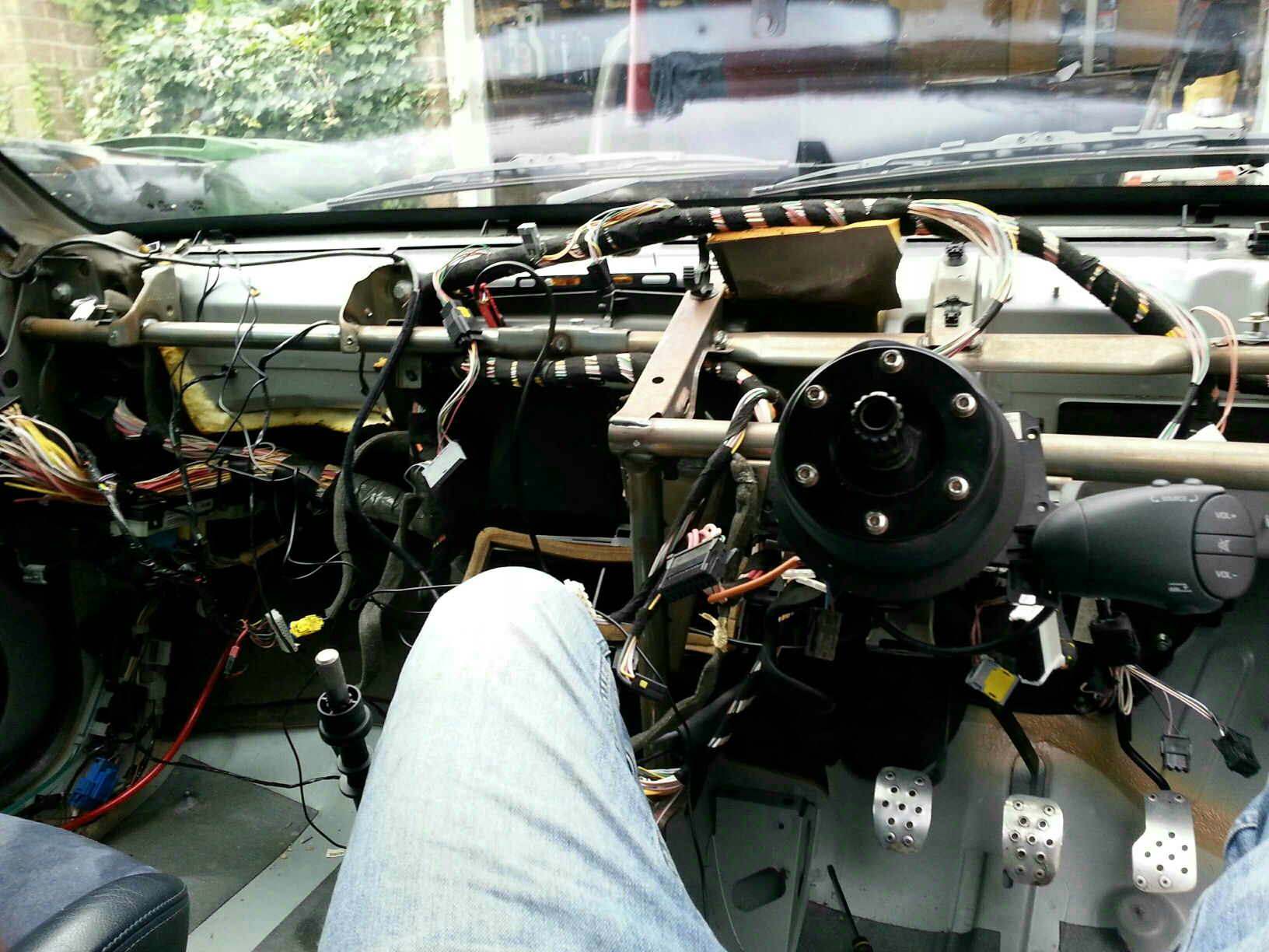

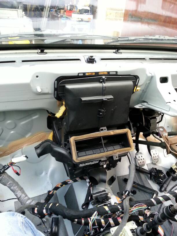

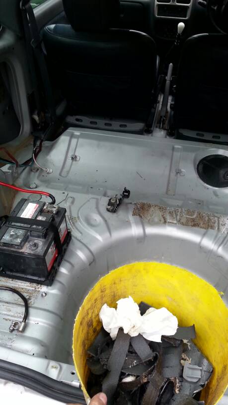

While awaiting for parts to arrive I can't do much apart from remove s**t - plastics, carpets, headlining etc etc
tomorrow's plans are to start with the sound deadening [emoji30] and to finish of removing and rerouting the wiring loom.

How are you going about removing the sound deadening? Like those stuck on bits "randomly" placed around the car? I would like to remove mine before I paint the interior. Also what coulour interior you going?

and heat bud - haven't got round to removing the glue yet as I don't really know what's best to get rid - had a go with bug & tar remover it worked just took ages..
So easy to remove the tar though - heat and the scraper just glides through...

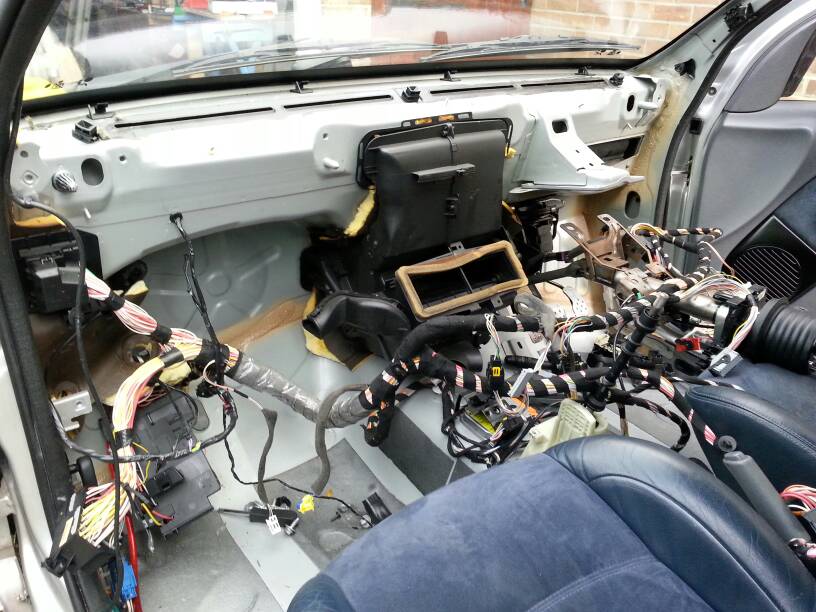

This is where I am sat currently - deciding what to get rid of/where do I chop the loom
to anyone - is it just a case of unwrapping the loom, locating say the airbag wires and chopping them closest to the bit in the passenger side footwell?
You don't hang around in getting that dash out! Was the lower dash easy to do? I want to remove mine and make it black / flock it, top dash seems easy to remove.
I will acquire a heat gun then! Have you tried alcohol? Or if you are painting the interior just sand it off??
lower dash is alright, bit of a basterd! loads of things you got undo/unclip - then you pull it off and find you've got more to undo etc etc

yep I'm painting it but I'm brush painting it! and unsure about prep work - but i'll get to that!
metal cage is out!
now I'm kinda unsure what do with this also and how to remove the brown sound deadening s**t behind it!
What's really good is that I've removed all this today - and not gonna be working on it again for about 10days, let's see how good my memory is...
but yeah if anyone could share some light on above and removing redundant wires in the loom that would be great: unsure whether to keep the wires for the window motor as I'm pretty sure I want to go down the polycarb route - maybe ill just remove motor but keep the loom.
cheers
I will remove mine then. What are you doing to replace the dash? A simple driver's c**k pit/binicle only??
If you are hand painting then and sand the glue off, just go over it with a finer grade?
I would personally leave the wires in, have to weigh up the weigtht saving and potentially cocking it right up
Don't brush paint man, will look horrid. Get some satin grey and key it up with scotch pads. Around 4-5 cans should suffice. Mine came out fine but I am a painter lol.
Looks very good that!
this is the paint I will be using + same colour -apparently there's no brush marks...
but yeah I am umming and arring
