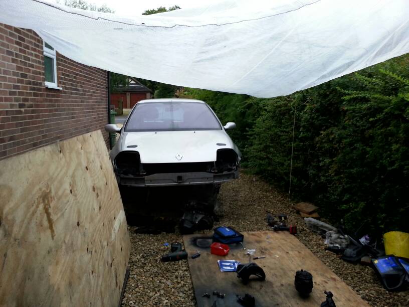

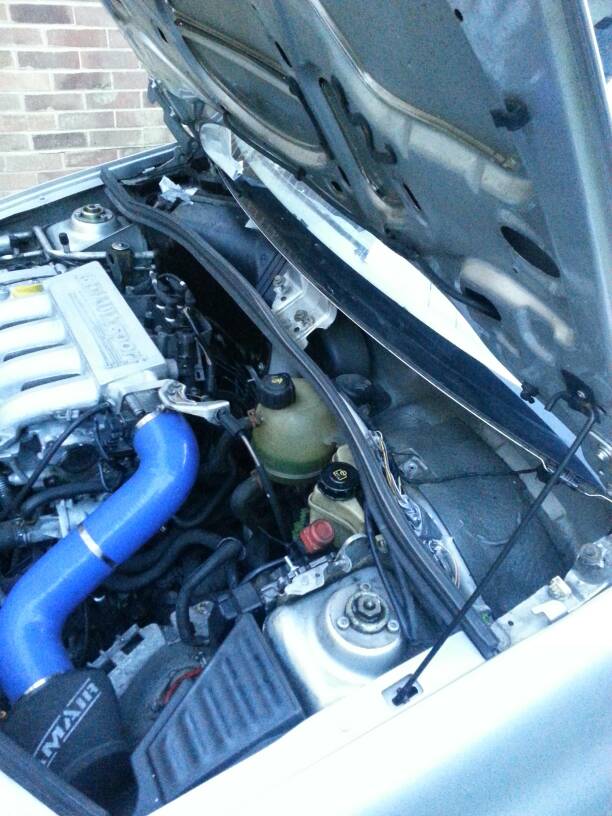

Removed wipers and scuttle panel, weirdly wipers were not that hard to get off at alll compared the the 182 I had! The rear one I ended up sawing off because cba and plugged with a spare 13mm halfords grommet.

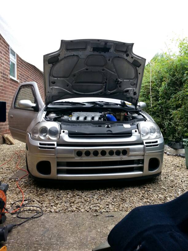

might of cut some holes in the bumper... holes in the crash bar will be going in shortly (didn't do any measuring so turned out quite straight...

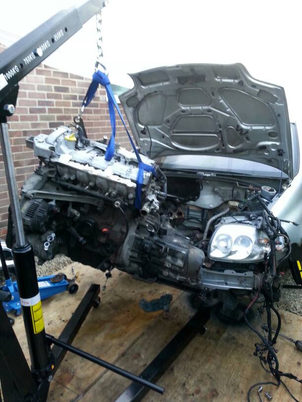

Engine out Saturday, the ph1 was a lot harder and took 1.30hours more than the 182 due to rusted bolts rounding and snapping etc

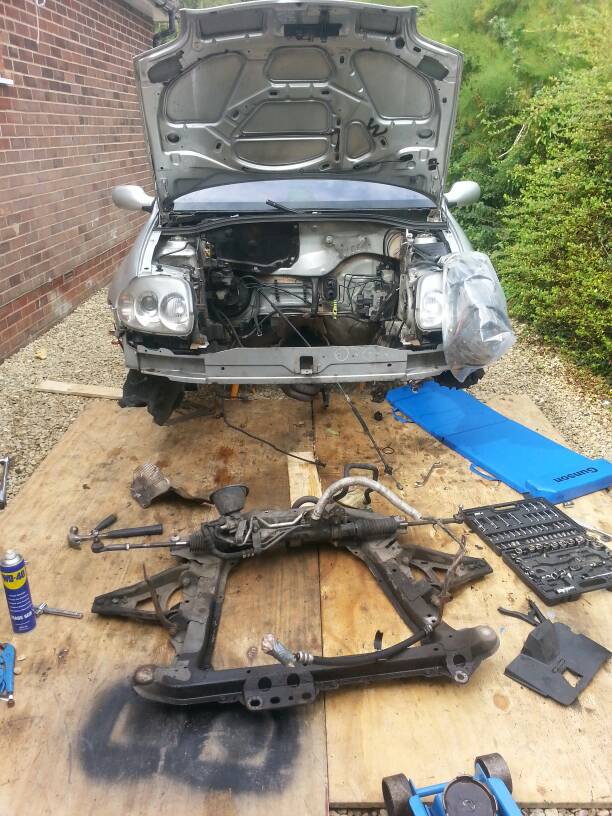

Today I removed the subframe, stripped the subframe of ARB as new black Powerflex bushes would be fitted when they arrive.
The subframe put up a fight also as they do with the front captive nuts spinning, so broke and remove them and put a socket/swan neck spanner to remain it captive

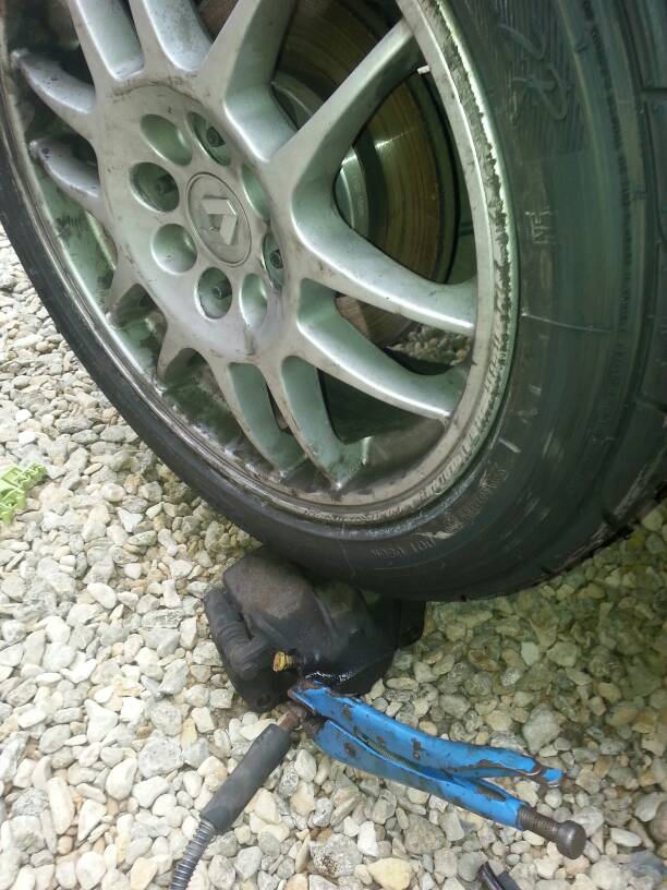

I also attempted and succeeded in fitting the cup abs delete (although system isn't bled yet)
this took longer than I expected, firstly I was going in blind never have done anything like thay before and secondly trying to get the master cylinder from the servo was a nightmare due to one the holes being very rusted. oh yeah and my ghetto vice which helped me remove a rounded brake line...

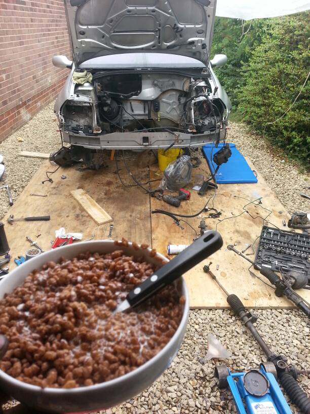

always time for a coco pops break in the middle.
Removing the abs pump has made such a difference, looks to be alot more space, along with the EPAS and battery relocation there will certainly be space for a snail...

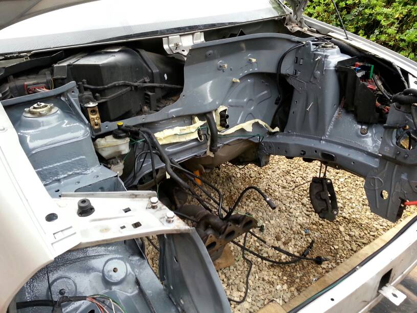

so today's updates are as follows:

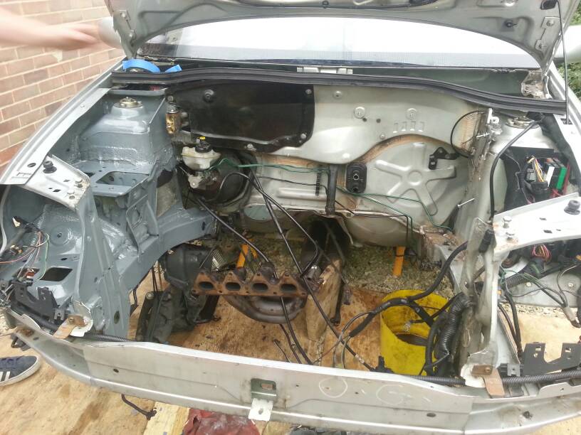

Managed to finish off the painting of the engine bay, it definitely passes the photo rule - it's not an amazing finish but it's a car for abusing etc etc
Removed all the unnecessary bits off the engine and stuff that I will be replacing: Pas pump, air con, water pump and alternator.

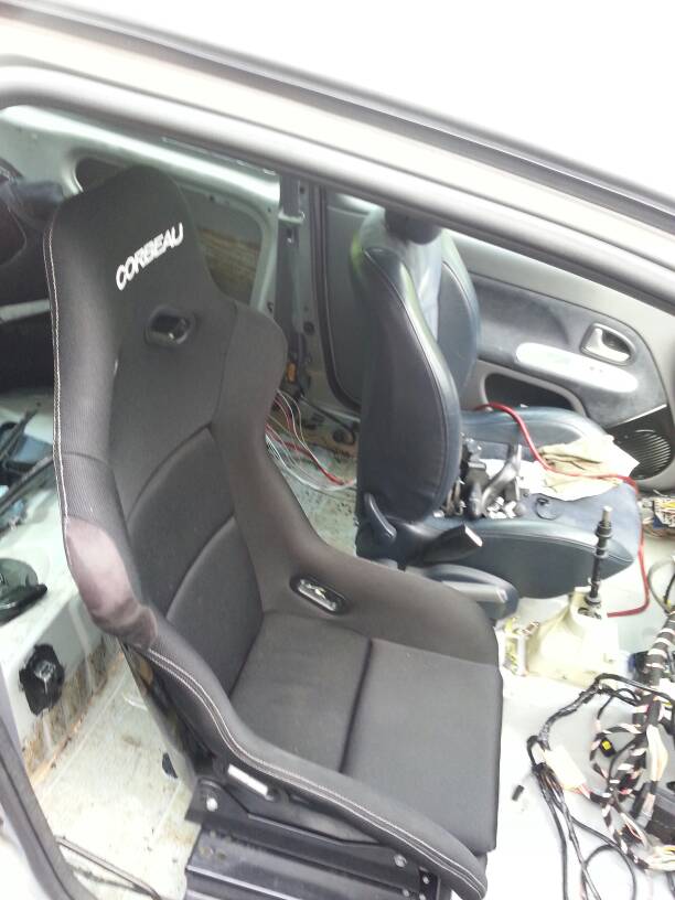

Received my drivers side bucket seat also, test fitted and aligned but unfortunately I won't be able to fit until I get my cage, as I need that to mount my harnesses, so standard seats back in

Forgot to add this onto the previous post - anyone who's fitted the cup brake lines to remove abs

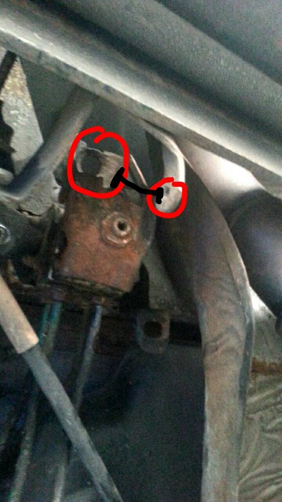

It this correct that it doesn't have the connecting rod from the bias valve to the rear beam?! quite unsure about this, so if anyone knows anyone who's done this please send them here!
NorthloopCup
No it doesn't connect up to the rear beam mate.
NorthloopCup
perfect thanks for the reply!

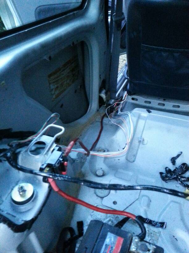

also youve done epas conversion haven't you? where/how did you get the 12v feed from and what cable did you use?!
Yeah one of the first mate. I took the feed from my bulkhead power connector as my battery is under the passenger seat. I can't remember the gauge of the wire now tbh it's been that long. From memory it was 6 or 8awg, but don't quote me on that
aye thought so - gotta be enough for 60 amps I think it said so 8awg should be an ough shouldn't it?!
and have you got a bulkhead through connector jobby is that what you mean? but wouldn't that mean the motor is permenantly on? or am I missing something
NorthloopCup
Without looking I couldn't be sure mate.
Yeah that's it mate. One of the longacre ones. Yeah your missing something mate. Lol! You need the eBay box of tricks to control when the motor gets the power fed through it to give the assistance.
perfect I've got on of those to go in. so ill take it from there aswell.
yeah more than likely haha, yep I've got all that :) so just need to source a suitable live cable to motor

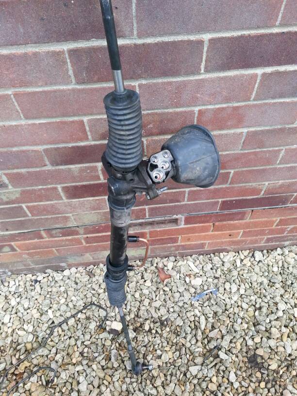

Rack has been looped, was a good job till I started to bend it into place...
also what do I do with top holes on the rack in this picture where the res lines used to go into?

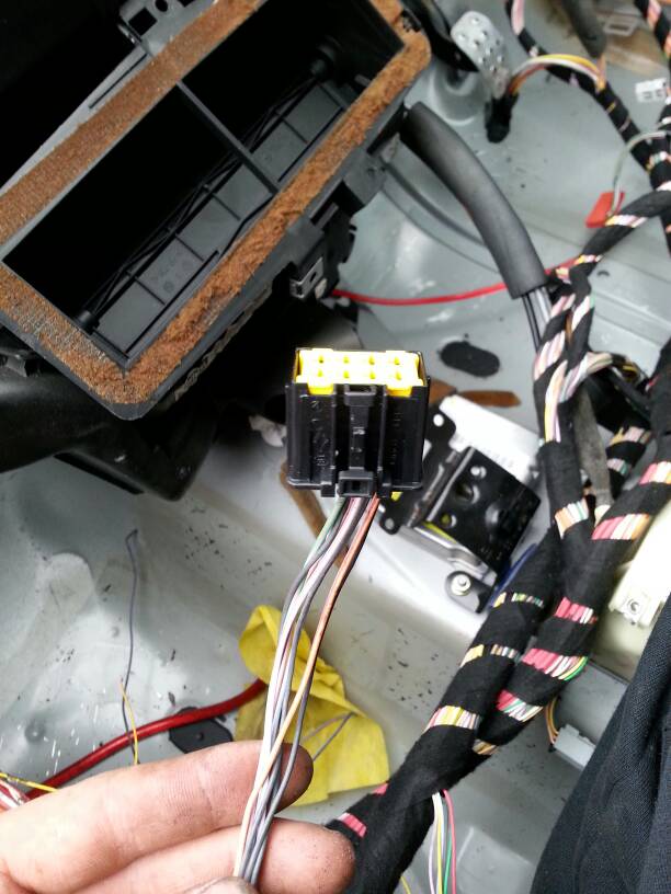

Removed all the airbag ecu and loom also, and I can't for the lift of me remember where this plug goes?

The 4 holes in the rack near where the column need to be blanked off, but tbh you could quite easily just fill them with silicone sealant. They are totally redundant once the fluid supply is taken away.
I've used some proper blanking plugs in mine, but silicone sealant is what I'd do if I was doing it again.
I haven't filled mine
#rebel
yeahh perfect, I did think they were pretty redundant! yep ill get some silkaflex in there! cheers bud!
