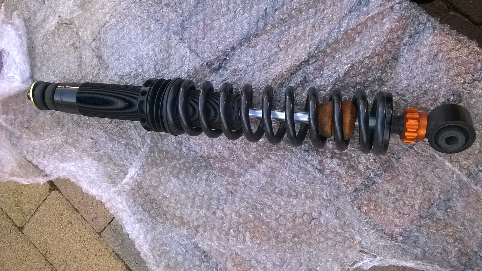

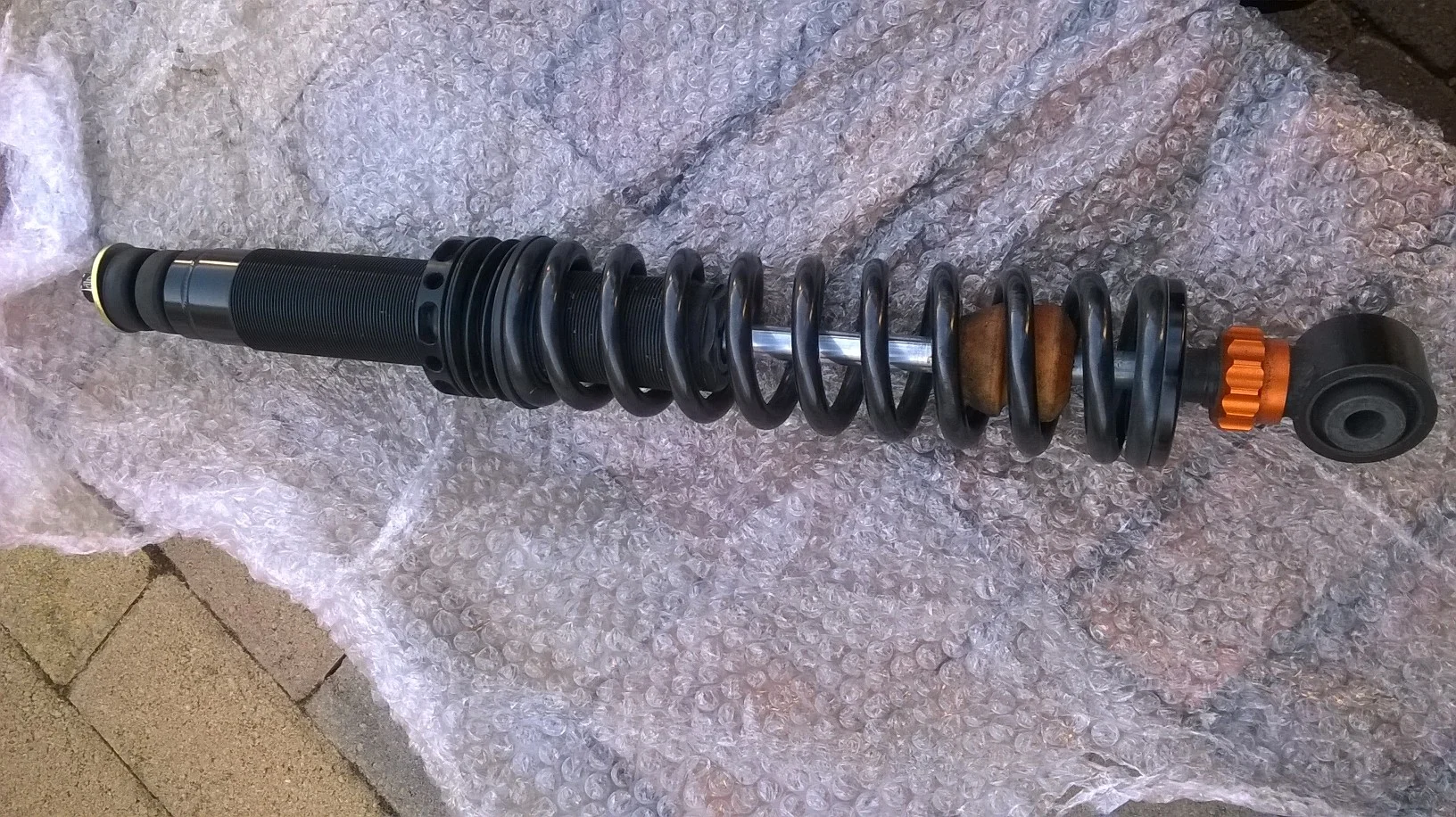

Some more shiny bits arrived today...... AST 4100's & bump steer kit.......... hope to get them fitted next week, off on holiday this week and whilst I would love to spend it working on the car, I have to keep the piece :fearscream:!

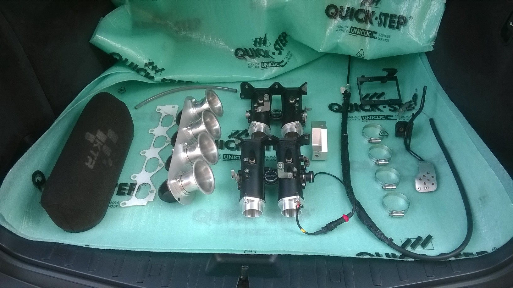

Pick up some more performance parts tomorrow :up:, will get the final Pieces of the performance puzzle soon and hopefully get a little more power into the Trophy :smile:

Well, more performance parts arrived today! trying to stagger the installation of everything to see the benefit of each!! f@ck*ing hard when its all just sitting there though waiting to go!
Cams are on route and should arrive next week................ hard bit is going to be holding off a month or two before getting this all installed !
Suspension shall be installed by the end of next week so that should be enough modification for the for the trackdays on the 16th & 24th May and into June. There's a little break for July and August at Knockhill so that may be the time for the ITB's, cams and mapping to happen! I'll keep you posted as the progress of install as it happens and hopefully of the positive response the car has to all of this :smile:
  Supercharged AG 200
Yeah they definitely transform the drive of the clios. You might need to up the spring rates though on the asts mate if your solely using it on track.
Yeah iv been considering that already. From description in Toms thread it looked like he had the best of both 400lb front and 285lb rear, ill give them a go and see how they go this year and upgrade through the winter.............. i'm hoping they will be an improvement on the Gaz as standard and then gauge it from there. Being fair to the Gaz ones though, they have held up really well and knockhill is quite demanding with all its ups and downs!
NorthloopCup
You'll probably find that you need to run a minimum of 400lb springs on the rear and 475-525's on the front. The gaz stuff has come on leaps and bounds now tbf, but they still ain't at the same level as asts or kw's imo. Nowhere near.

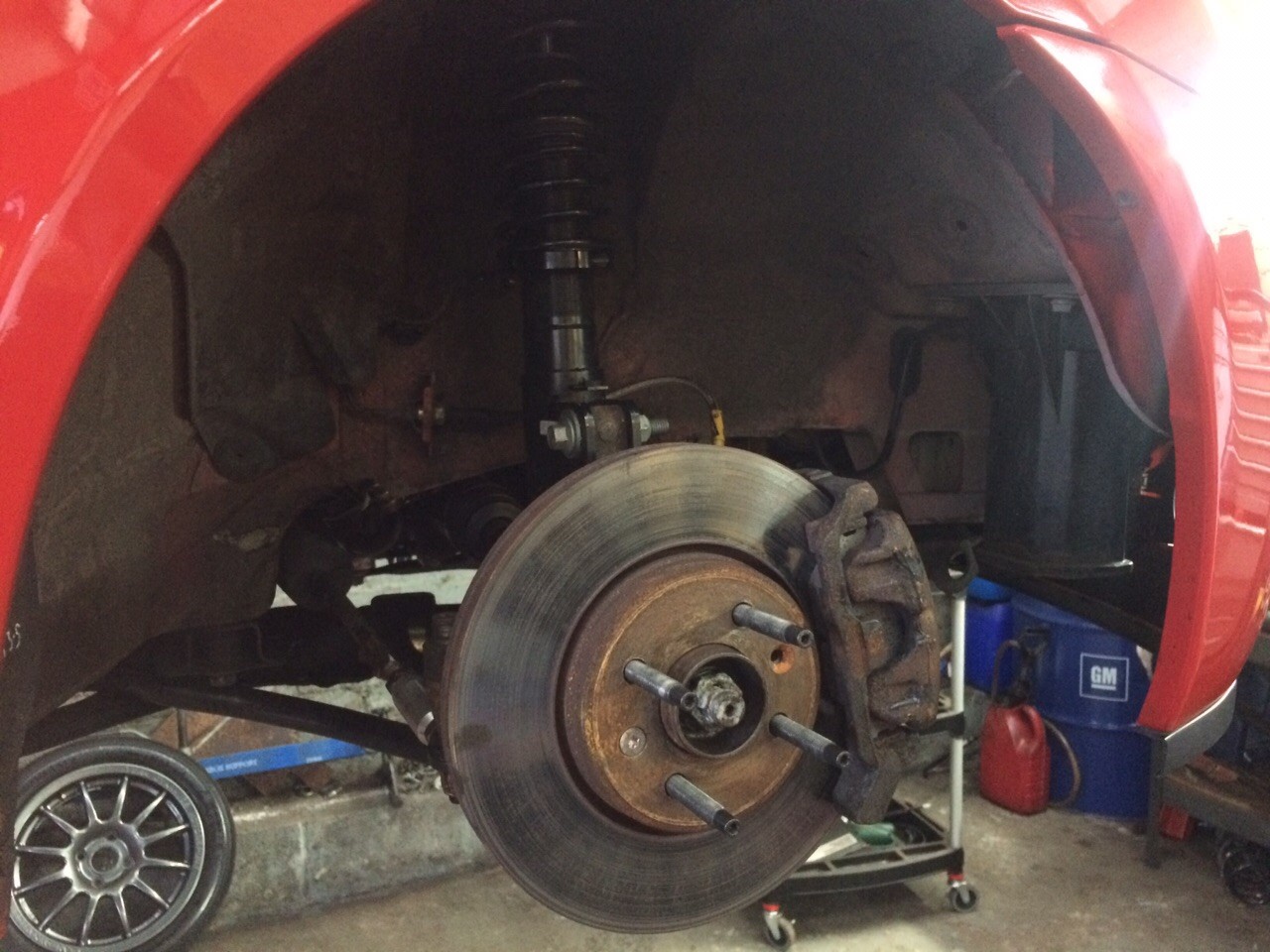

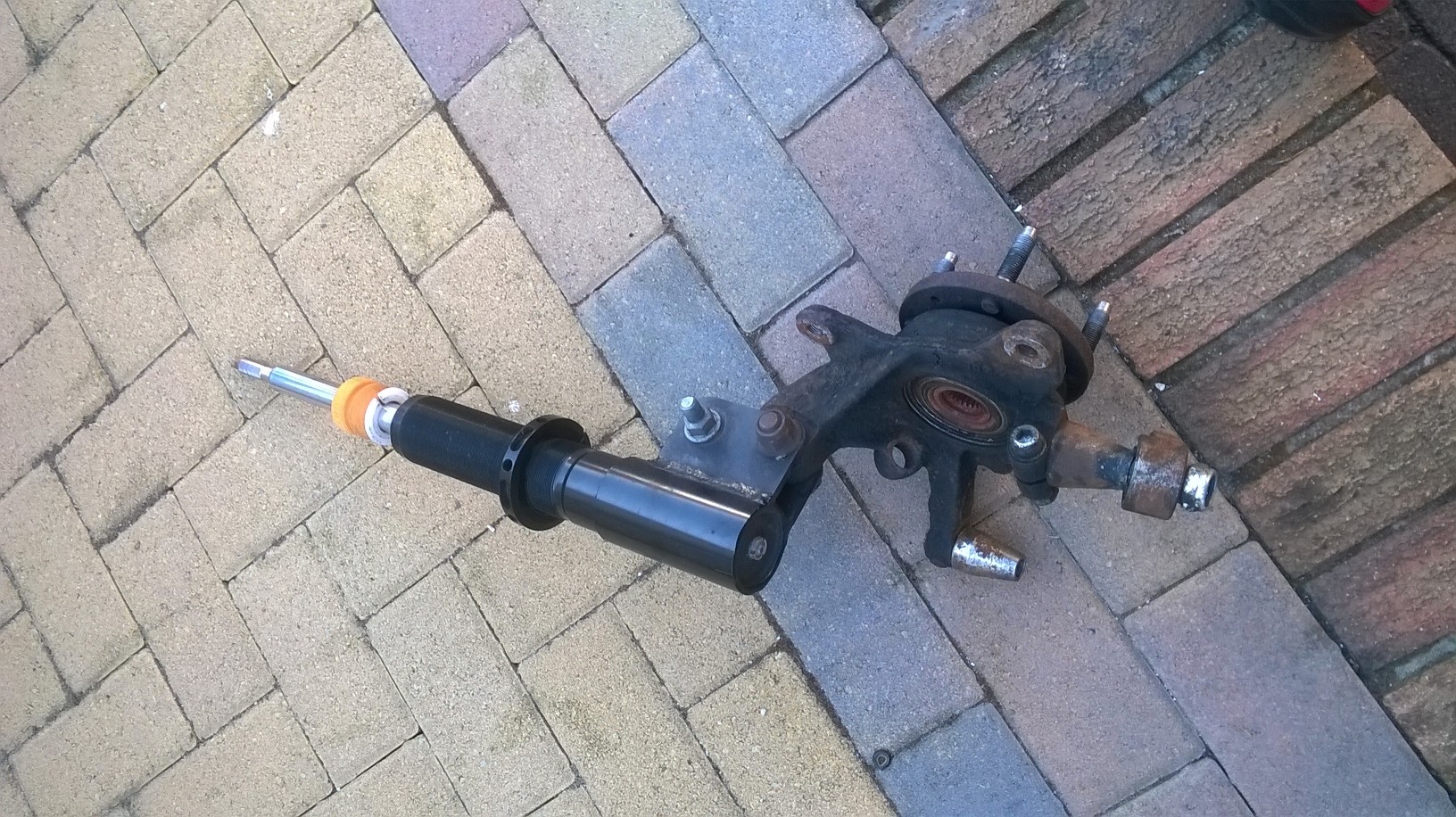

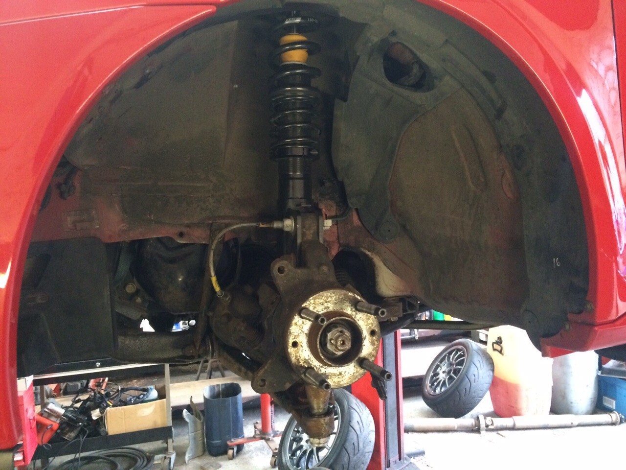

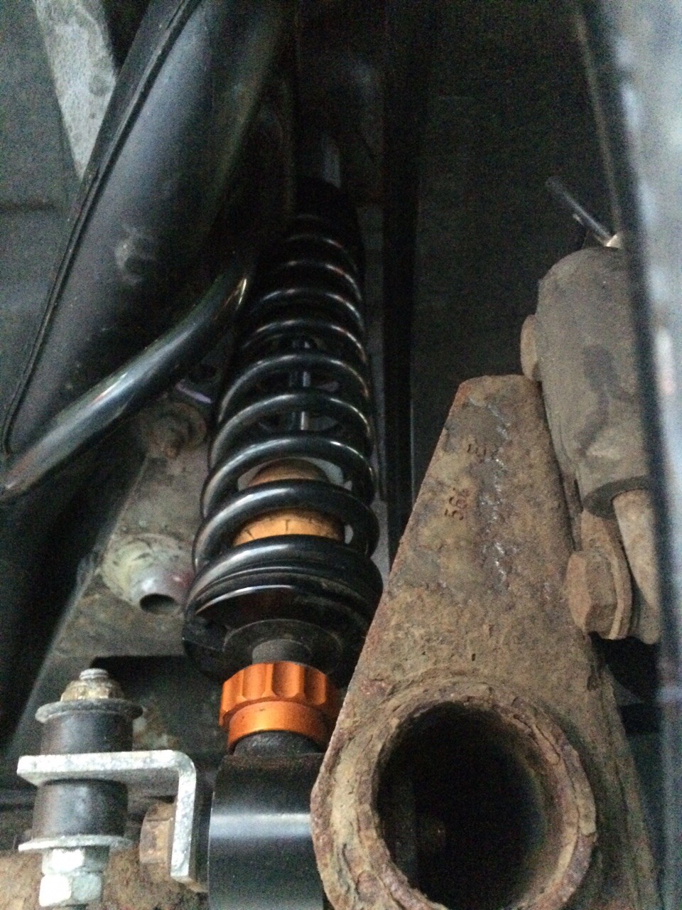

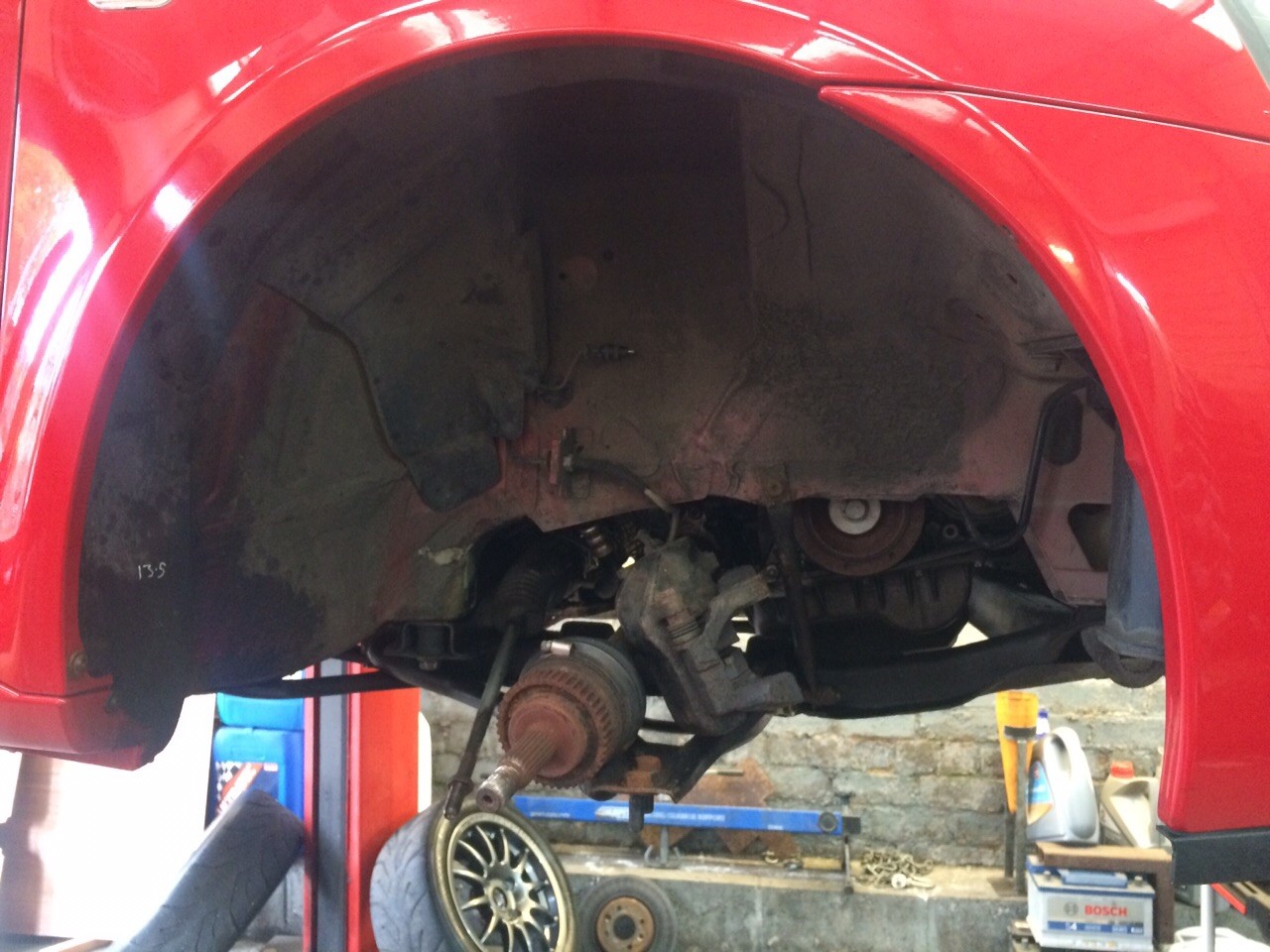

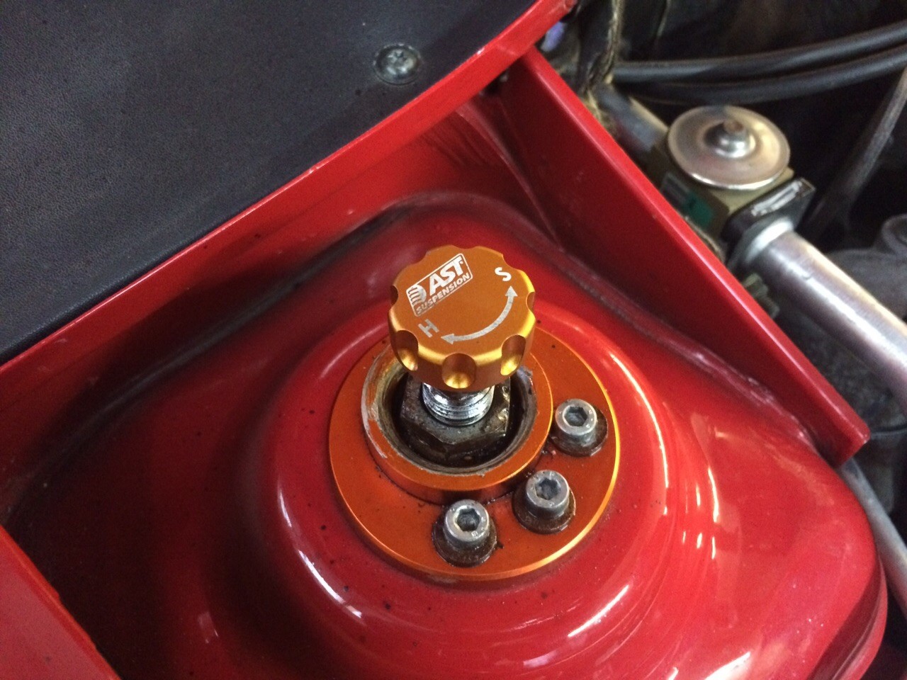

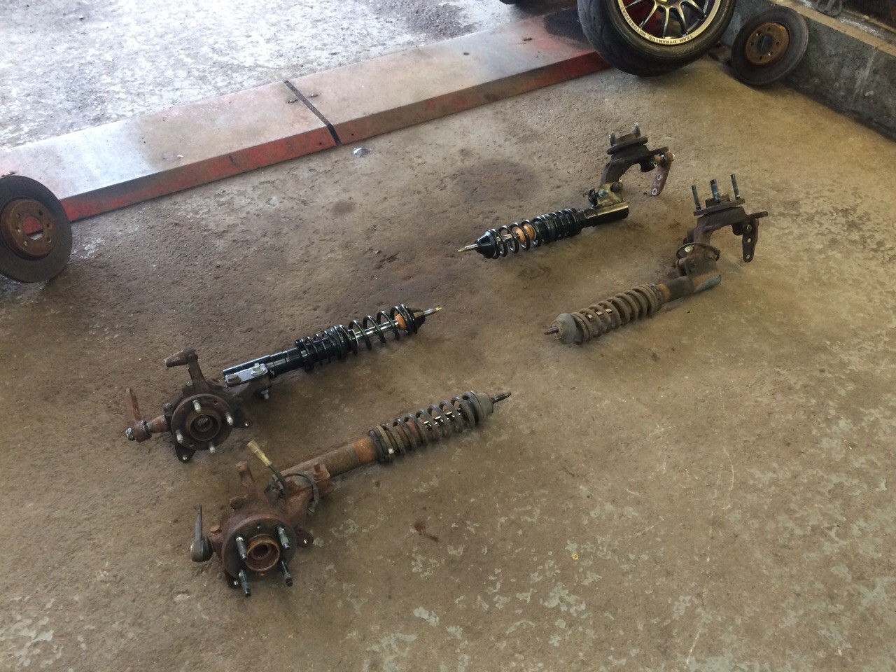

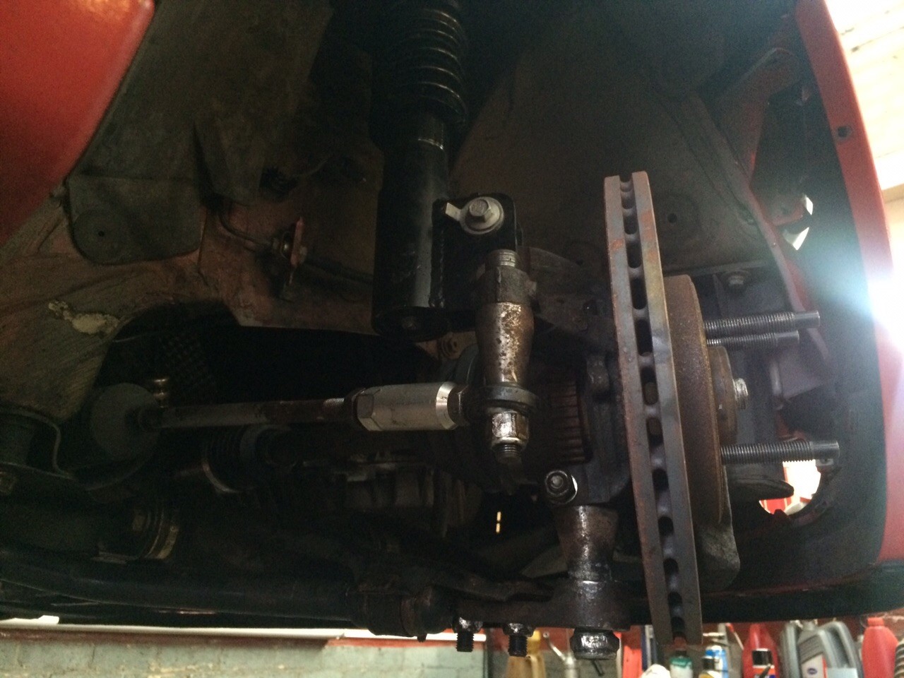

So a little more progress on the Clio front............. AST's & bump steer kit are finally fitted :tongueout:............ Haven't used it on track, but the 3 mile trip home was night n day. Hopefully the first outing at Knockhill will flag up a massive difference! sits a little lower than than the GAZ's were set and has a more aggressive stance, back has dropped quite a bit, but still nose down which suits me. It does feels great......... hoping to get it on track on the 24th, seemingly they have changed the SLS to the 23rd (sat) so the Sunday should be back to a bit more time on track than the last disaster!

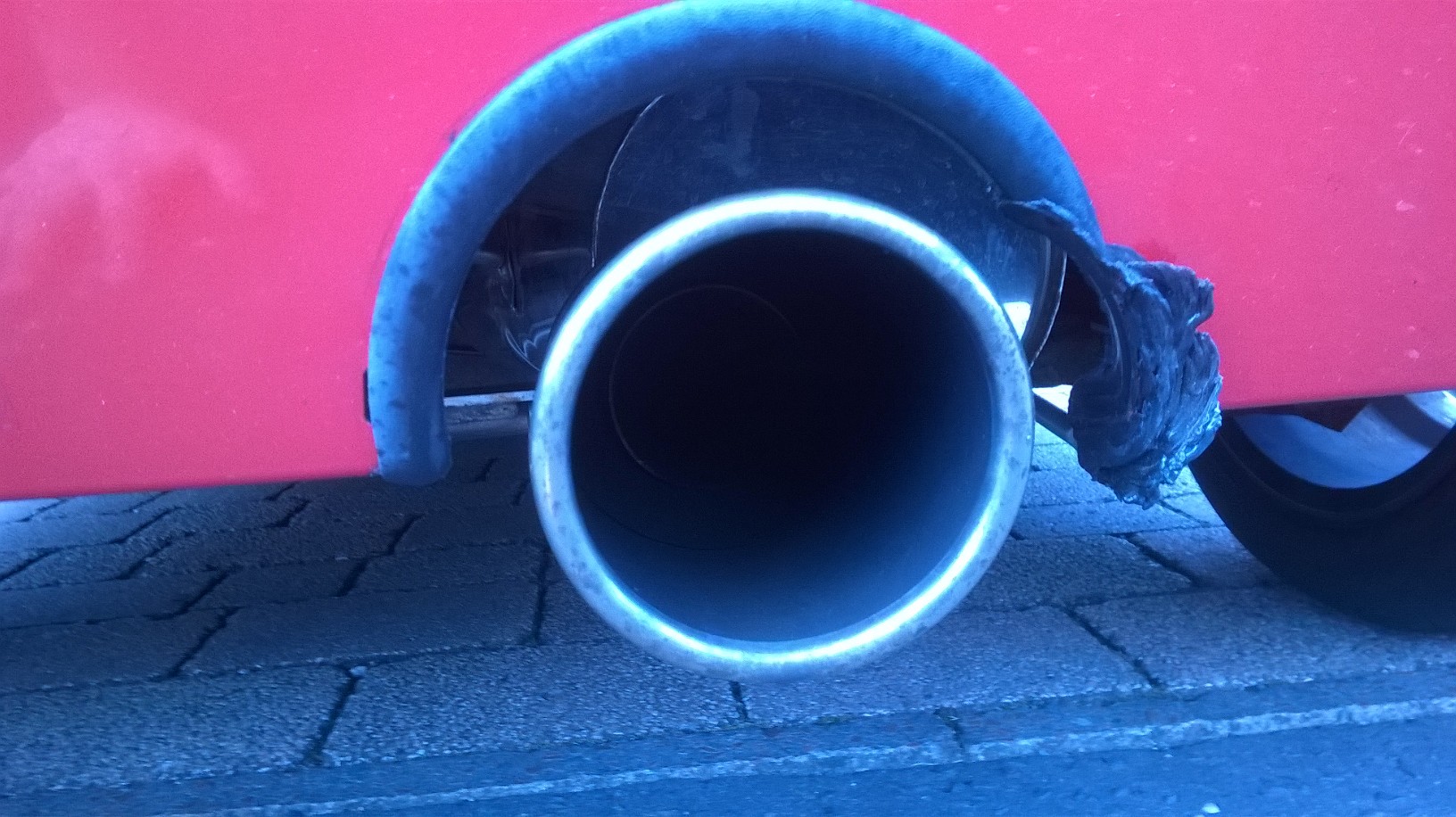

Next mod before the weekend will be getting the exhaust back into position, moved slightly after a rather adventurous line into Duffis the last time out and has ended up melting the exhaust trims!!

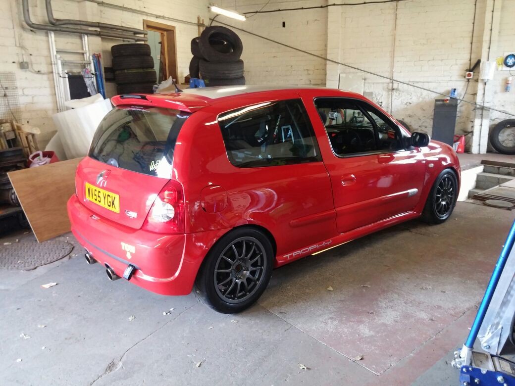

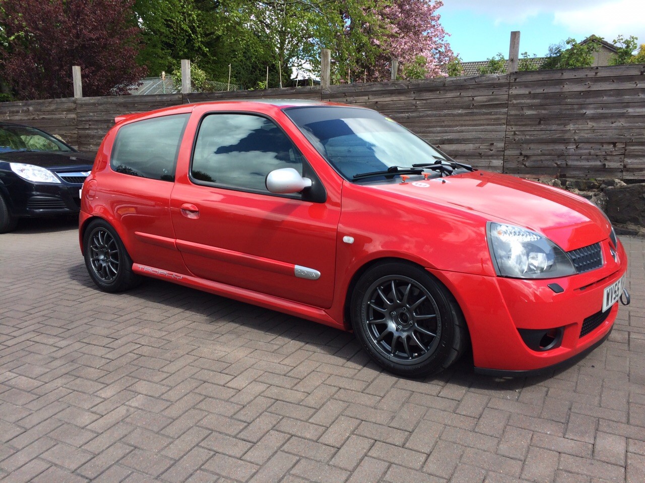

Well Mondays out was amazing. Car is transformed with the AST's and bump steer kit, felt solid all day and turned in every so easily, point and shoot!! can turn in a lot later now and does it with no effort what so ever! great modification @NorthloopCup :smile:. Yous were right though I need to upgrade the springs, even though it runs a lot flatter and feels properly planted i does crouch / roll a little under heavy load and due to Knockhills ups and downs it could do with uprating!

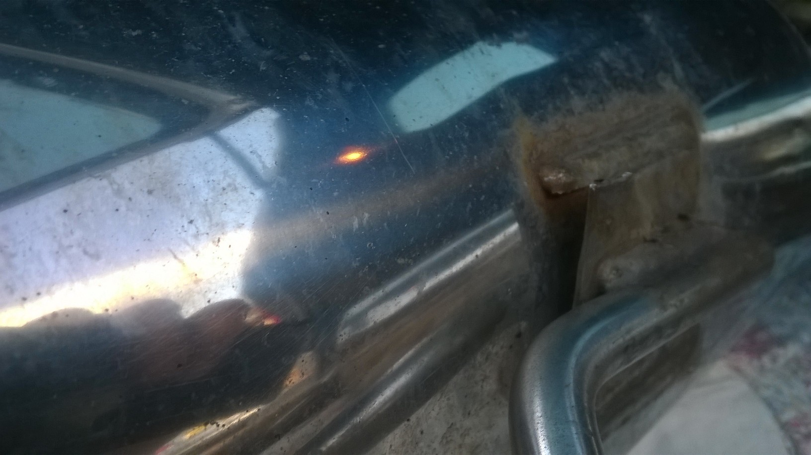

Only pad point to the day was a knocking that appeared mid after noon! baffled a little as you would swear it was a bush that was away on the front passengers side........, and as i have just replaced everything with black series and AST's are as good as new it will need some investigating ?!? Co Pilot for the day swore it was coming from behind her head but i wasn't convinced although after investigation at the rear and noting the LHS exhaust was hang down a little i found this!!!

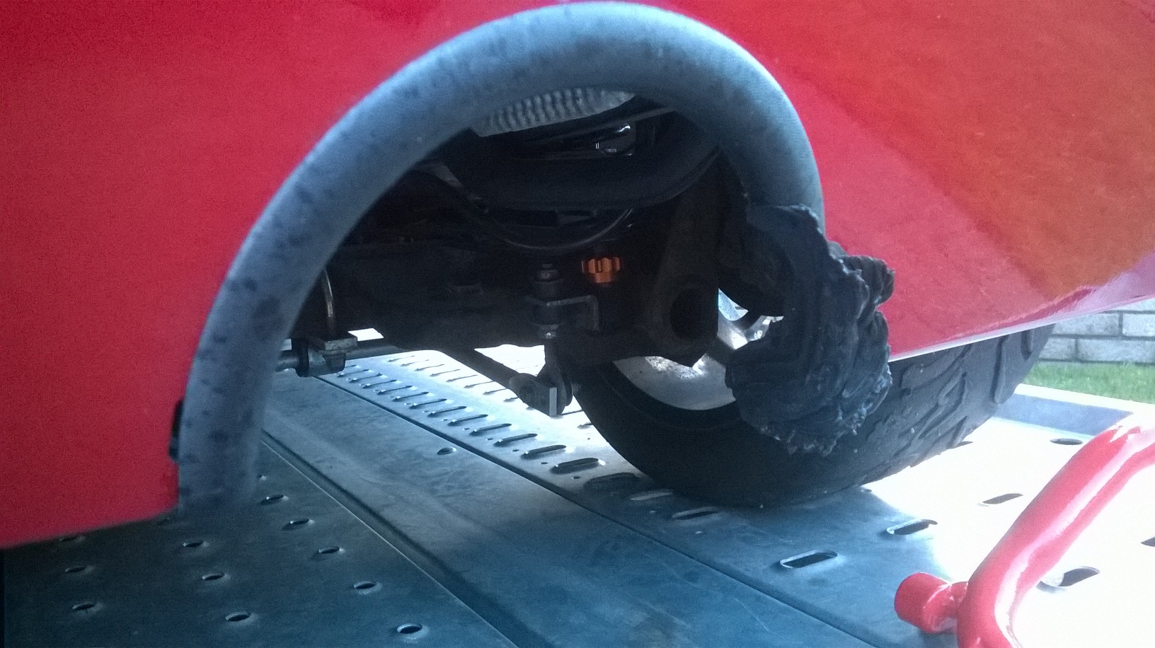

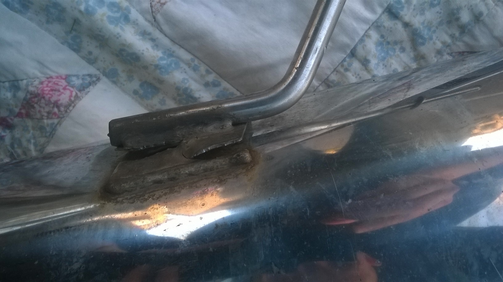

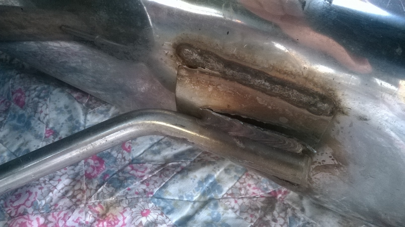

Exhaust back box plates splitting and pulling away....... these photos are after i shoved them back into place! is this typical scorpion quality or am i just paying the price of having solid rear exhaust mounts and very soft front rubbers???
Anyway exhaust off and away for welding / strengthening and after a refit and couple of trial runs hopefully all is well and the knock goes away!!
Anyone know of any uprated exhaust rubbers? The centre one is very week and the two rear ones for the drivers side rear box are pretty soft as well....

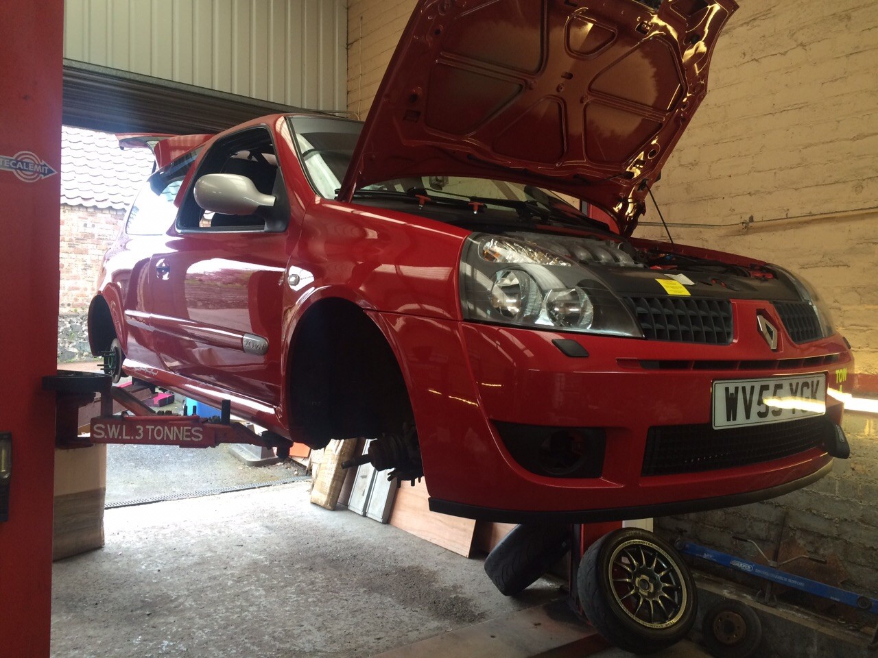

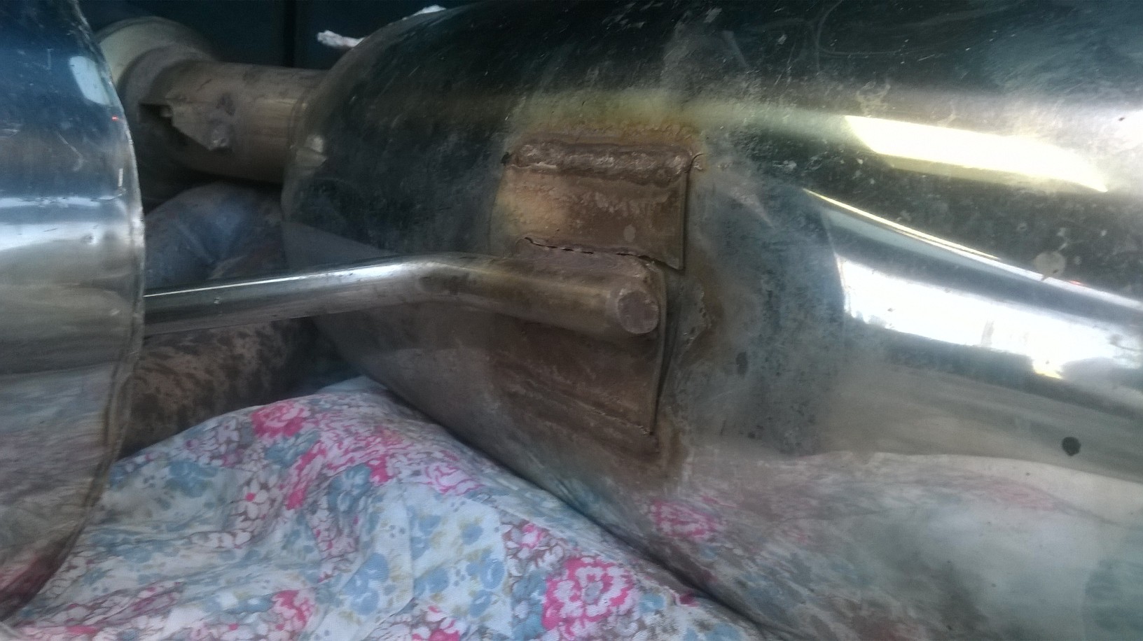

exhaust back up and fitted............. strengthening plates added as well so we'll see how long this lasts! thought about replacing the exhaust surrounds but a closer look at the drivers side one means that the bumper will need to be changed too........ Christ! must have been a little hot as it could only have touched it for minute 😞 track car after all, but just get a little pissed off at things like that!
  Ph2 172
Any pics of the strengthening plates?
I'm tired of replacing hangers on mine and was thinking about making some sort of triangulated brace to replace the centre hanger.
  Supercharged AG 200
Hi mate, the brackets were welded back into place and then a plate of similar size welded over the top to strengthen it up.... A little was lost in translation with the welder as I would have liked that plate longer and welded over more of the back box, I'll see how long this lasts but it may need to be a larger strap.......

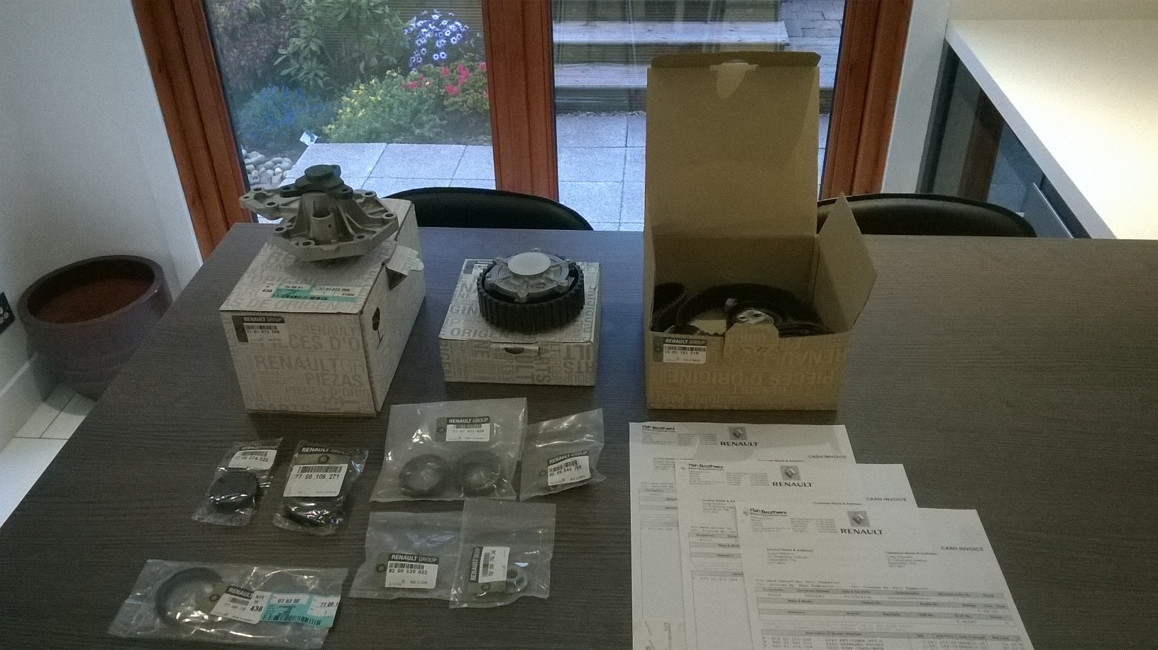

more parts arrived today,
Timing belt kit, dephaser & water pump, along with cam shaft and crank shaft seals, got a really good deal from Fish Brothers Renault.................... so cams, oil cooler, silicon hoses and a Scott Morgan alloy radiator & fan setup can get fitted next week (hopefully) with the ITB's & ECU following in a few months with Scott's matching alloy header tank........ Timing belt isn't that old that's on, but no point in taking a chance, so when its stripped everything replaced with new seems the right answer, hopefully with the crank shaft seal replacement will cure that annoying oil leak (previously thought to be sum gasket)
I'll keep you updated :smiley:
