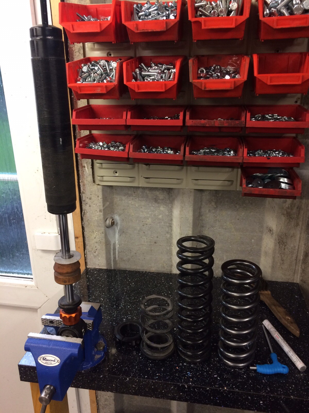

Well the spring delivery arrives................ 4 springs ordered and 2 nr new top nuts............and further disappointment when I open the box!! 2 springs only, no top nuts and sent to the billing address and not the delivery address.....

I feel your pain mate. The problem you will encounter is that the rear Ast springs are 1.9" id and also very long, so your kind of snookered for buying elsewhere. You can run the smaller eibach springs with a helper spring, but you need a spacer collar to add length to the spring. Make sense? I turned some up for mine out of nylon bar. Alternatively you could double 2 eibach springs up, but you need to run 2x 200lb springs to get the rate of 400lb. It also gets expensive buying 4 eibach springs!

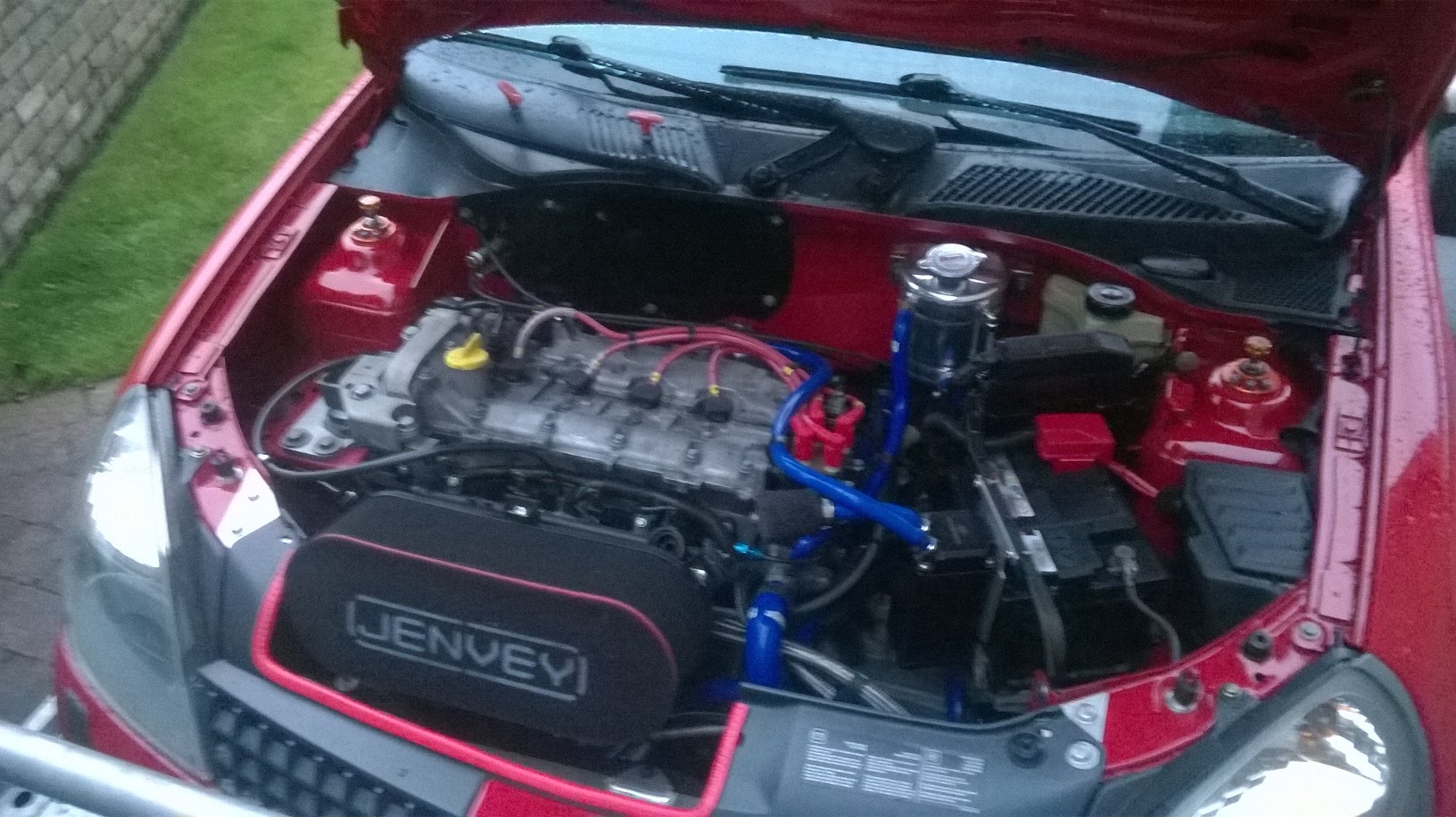

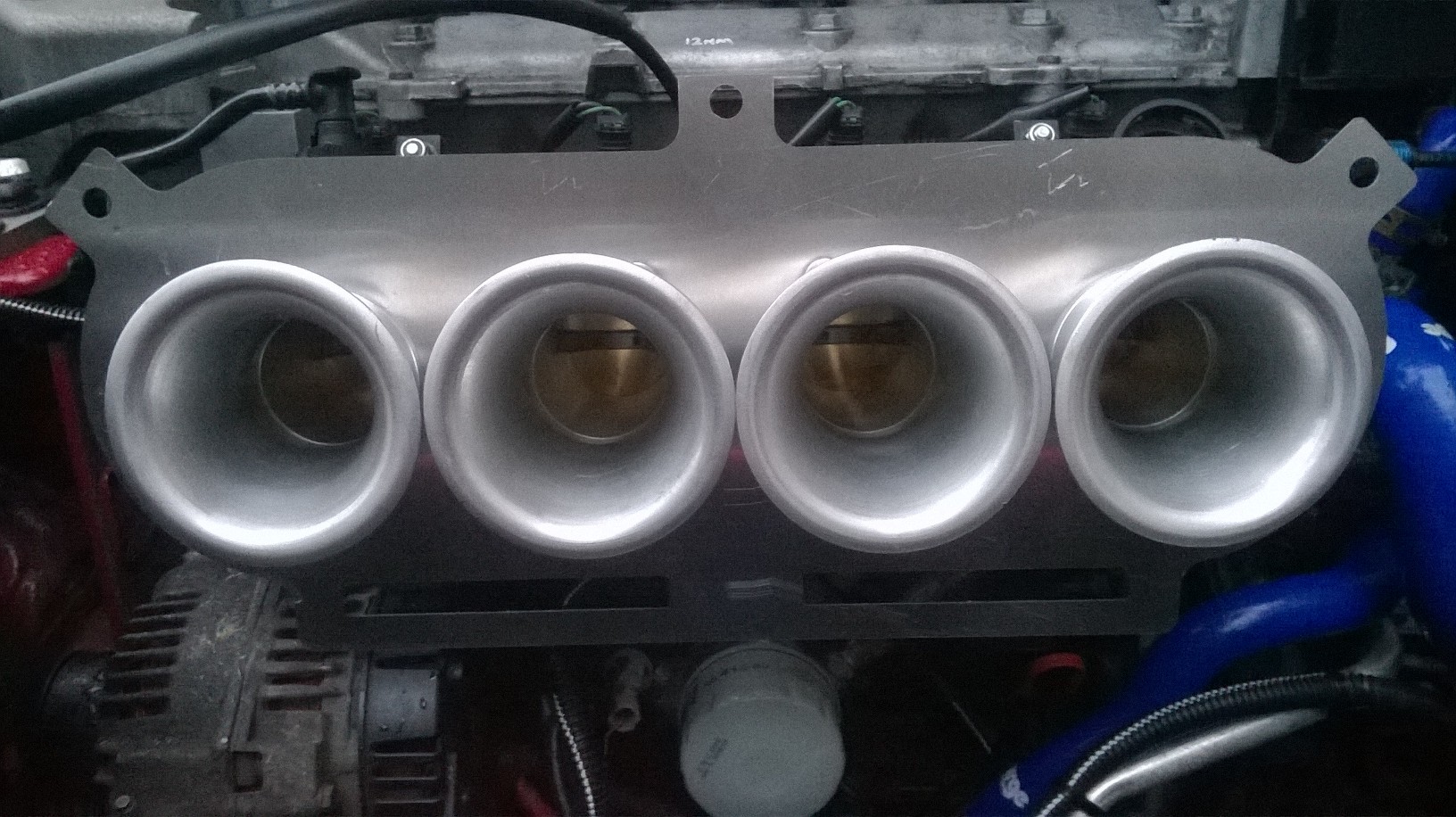

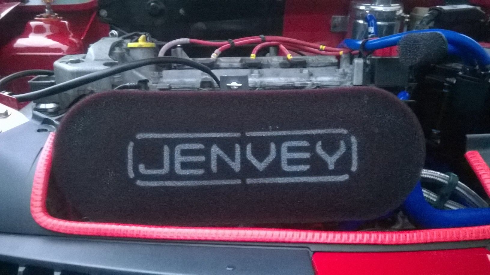

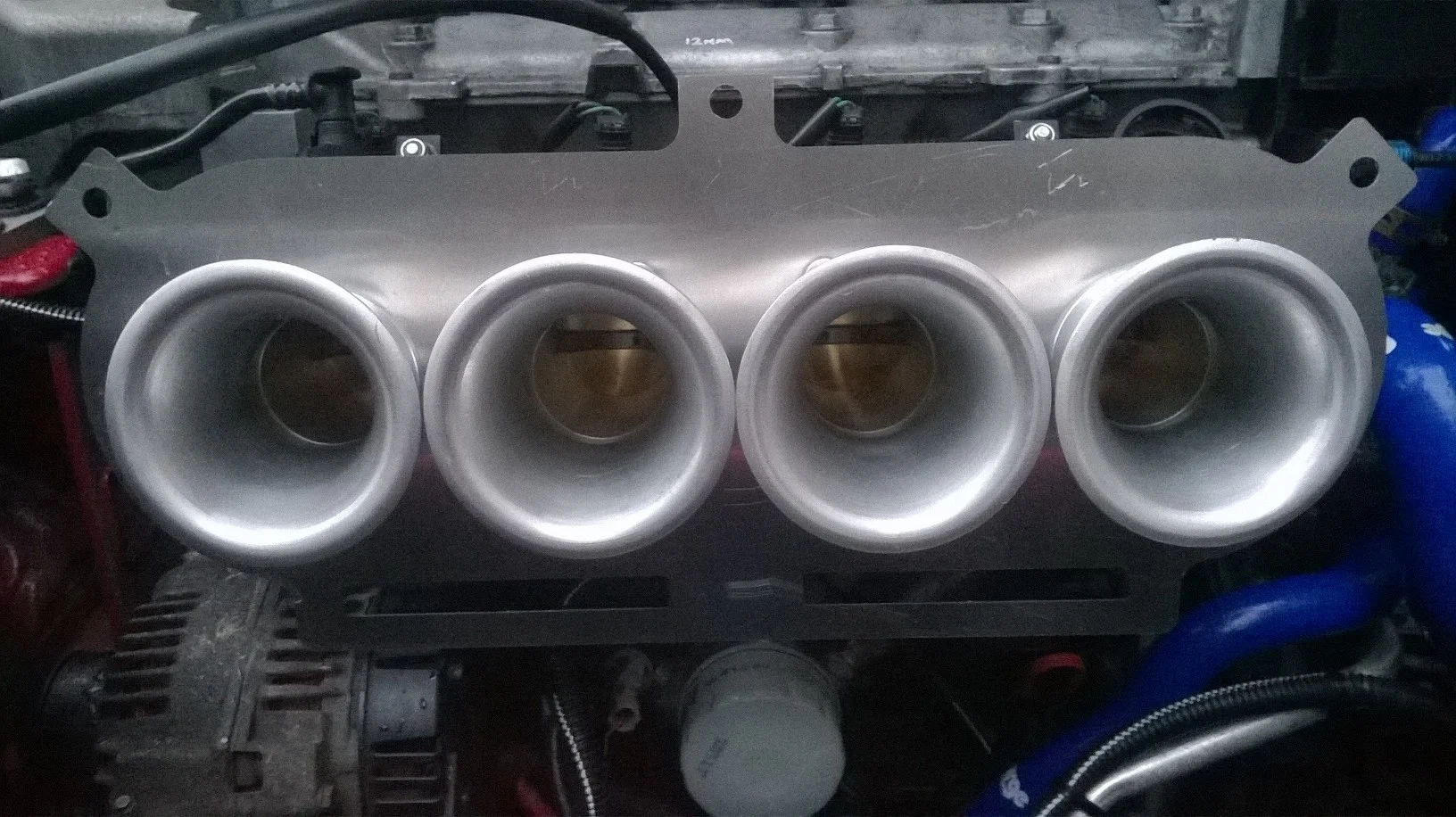

A little update tonight....
Jenvey revised backing plate arrived and the filter of death has been replaced!!
Big thanks to Nigel @ Jenvey for his help and prompt service on return from his Holiday :up:
Only other update is that the 2 front race spec springs have arrived too (about time) but the two illusive top nuts as still awaited..........!! not great but I have contacted Curtis so you never know?? oh and I have freed the front callipers off as much as possible, they will require an complete overhaul during the winter, dust caps / seals have went brittle with a year and a half of punishment, but certainly better than they were :smile:
Hopefully springs fitted next week and I can feel the benefit on the next track day on the 30th, but as its a sessions day I don't think we will be chasing times, it will just be good to see how different it drives when being pushed....... It will be quite a different car, engine mods completed, different suspension and I also have a set of 888's (well 5 actually) to use in lieu of the A048's ( I like the stiffness of the A048 side walls over 888's but a bargain was to be had so all good), so big change and hopefully a bit of fun listening to that ITB noise over standard.

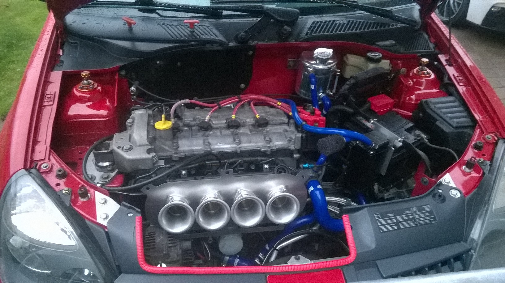

You doing the private night on the 3rd Craig? Engine bay is looking awesome! So clean and tidy for a track car lol.
Yeah I got hot the last spot mate, all paid for and rating to go.... Only problem is I'm working in Aberdeen that day so the car will be at knockhill waiting on me, I just hope the traffics good on the way down or I may be doing a half hour stint!

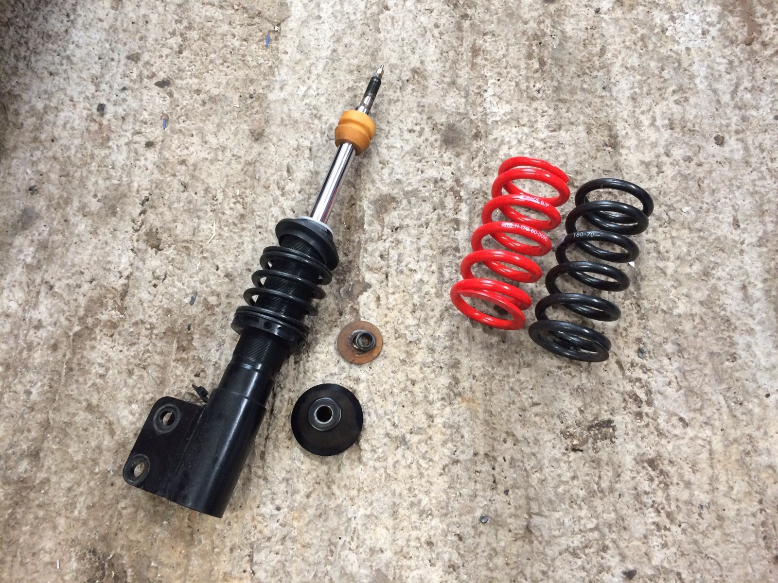

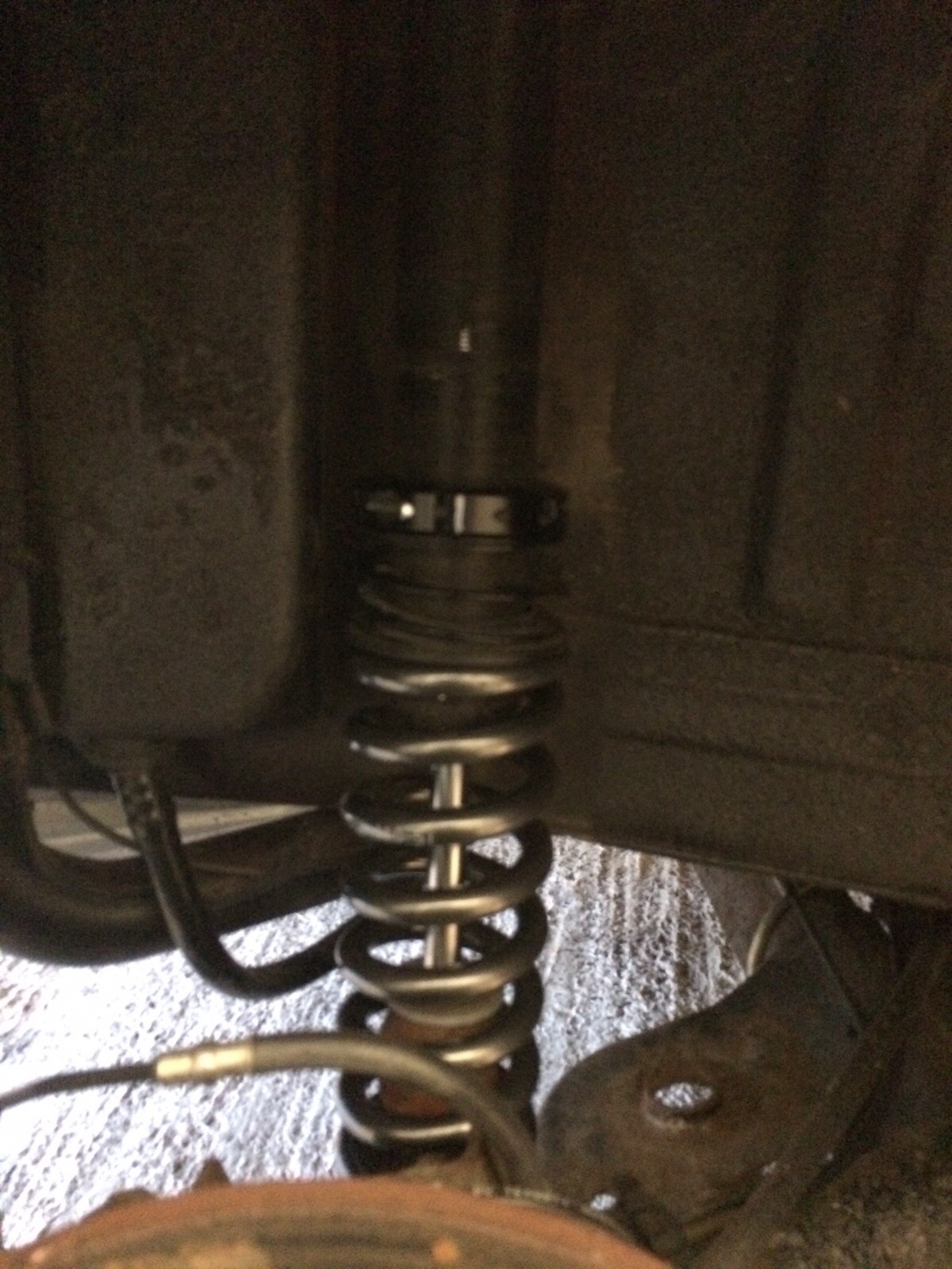

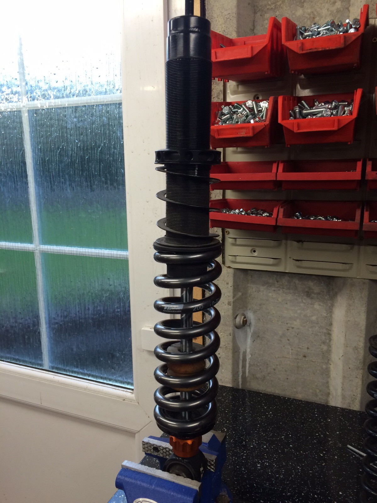

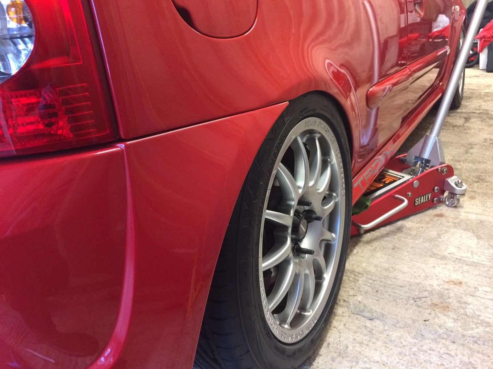

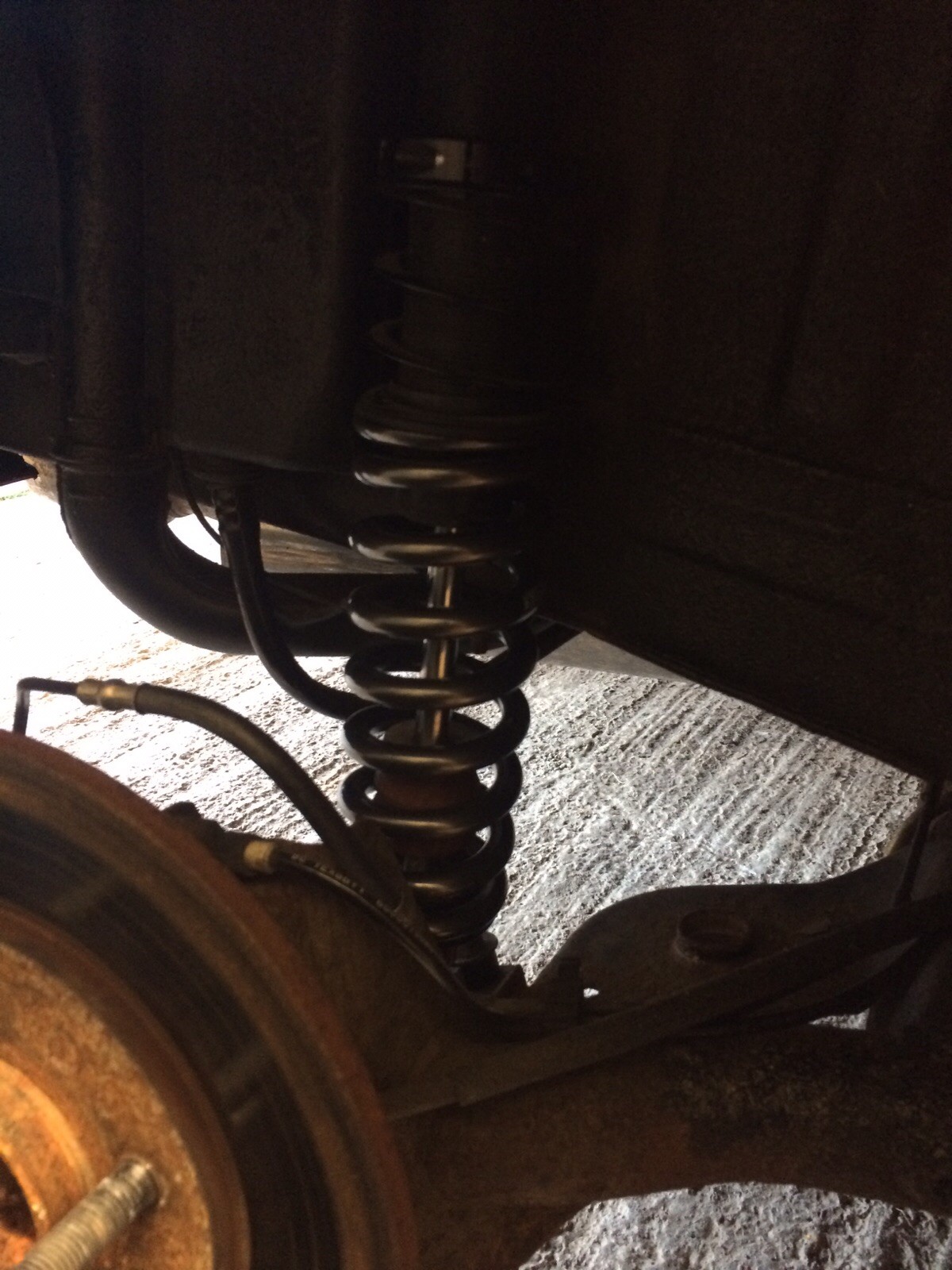

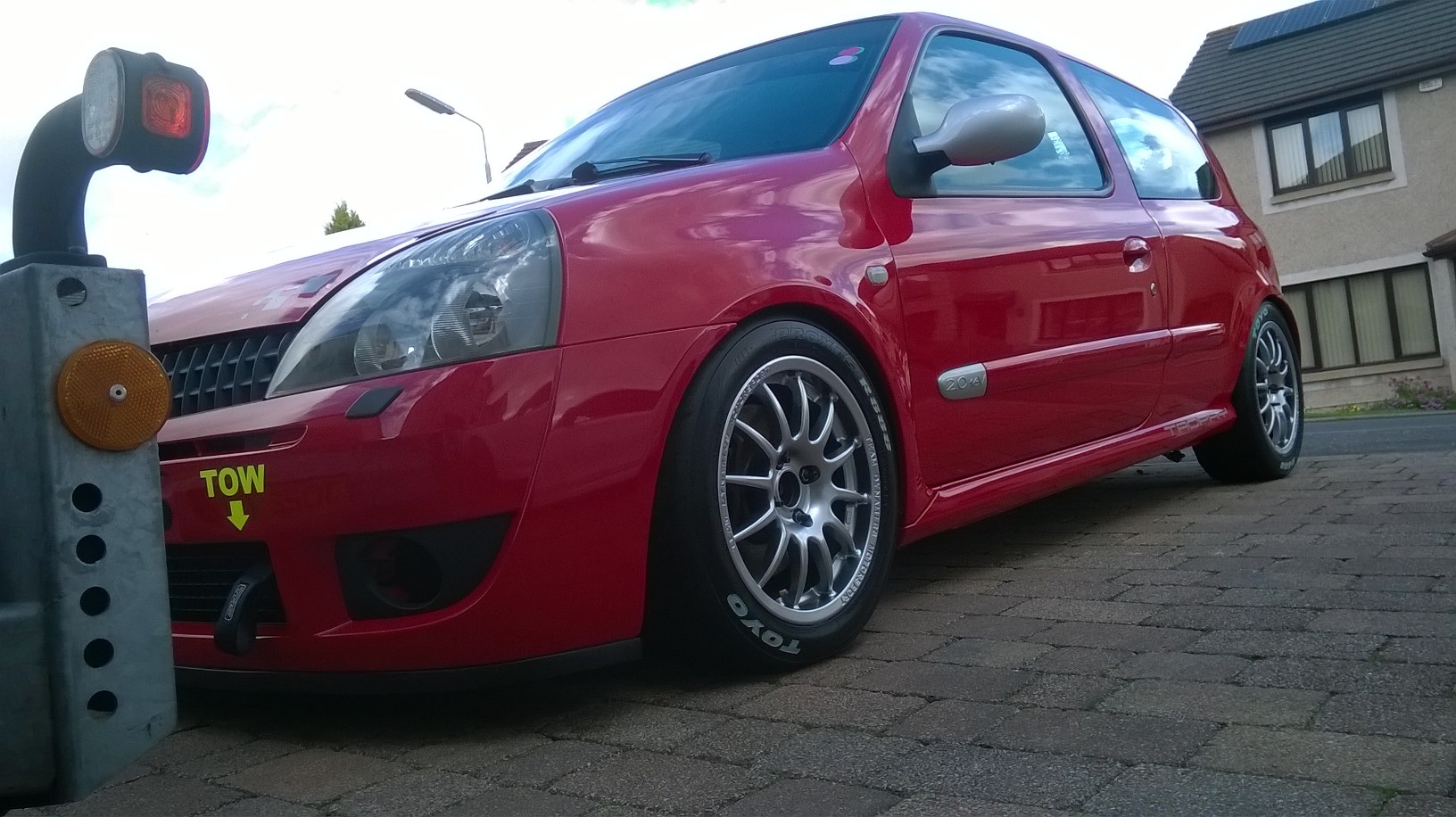

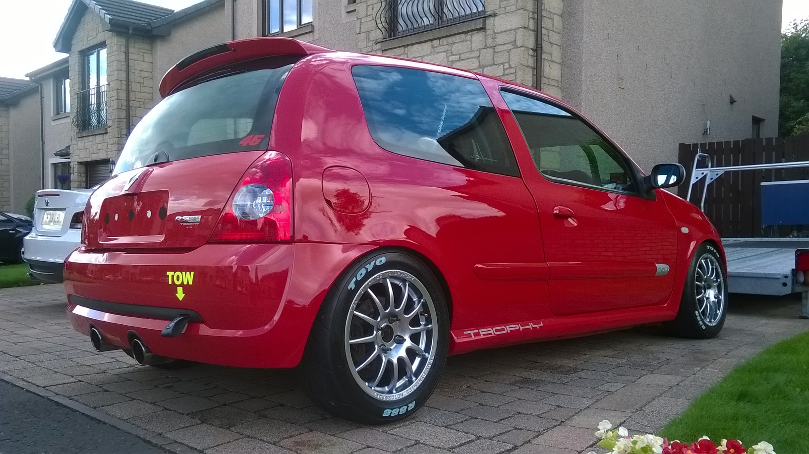

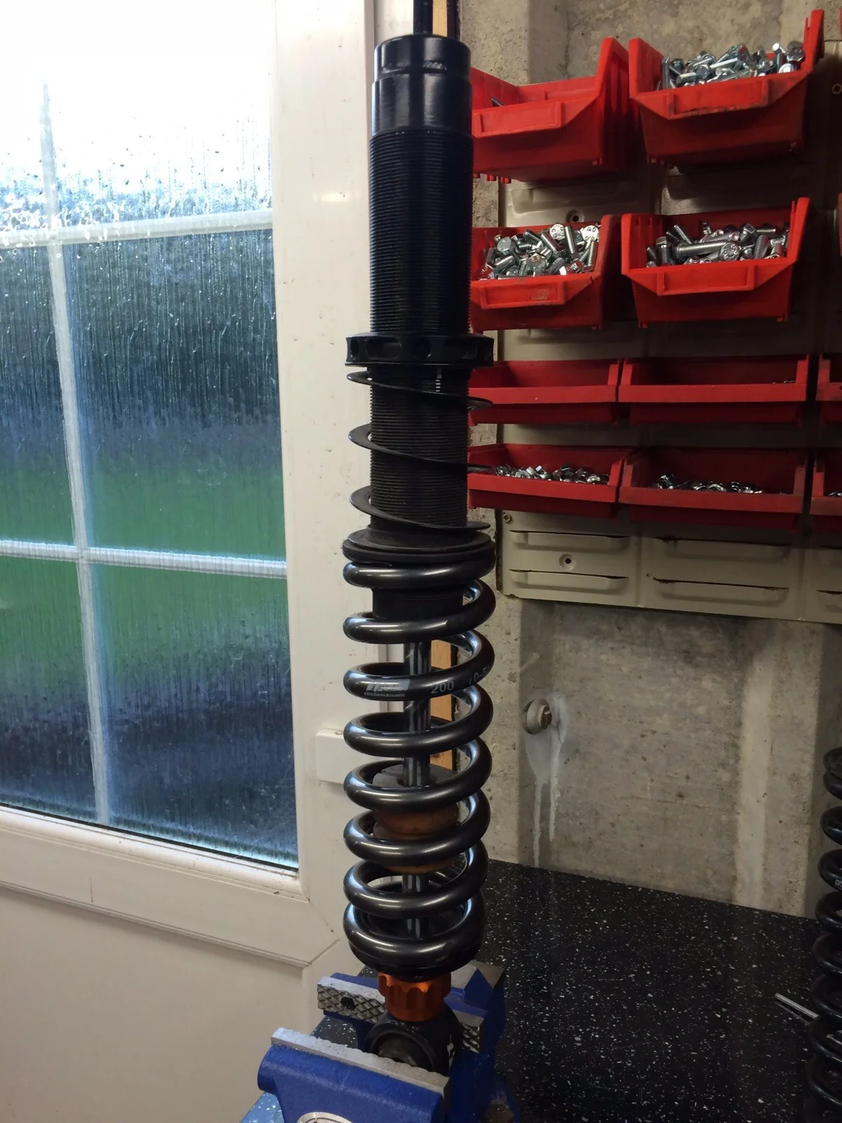

tonight's update........
New springs fitted, no new shiny top nuts though, surprise surprise!! not the end of the world and if they ever do arrive it will be an easy change over!
Usual picture happy update for you with a few added notes below... sorry to bore!!
Fronts 20Nm harder, and 10mm shorter so balances it self out no real adjustment required, sits marginally (if anything) higher but i did think it was a little too low anyway so minor adjustments may be required after Sunday's trial!
Rear - 60Nm harder and 50mm shorter.................. results in quite a drop on the car............ thought about leaving it low but actually handles nicely a little higher so it got raised again to how it sat before ............:tongueout:
Well that's it for tonight, will let you know the benefits on track on Sunday, if the weather stays dry of course!! about as hopeful of a dry day as i am of seeing the new top nuts from Curtis though!:smile:

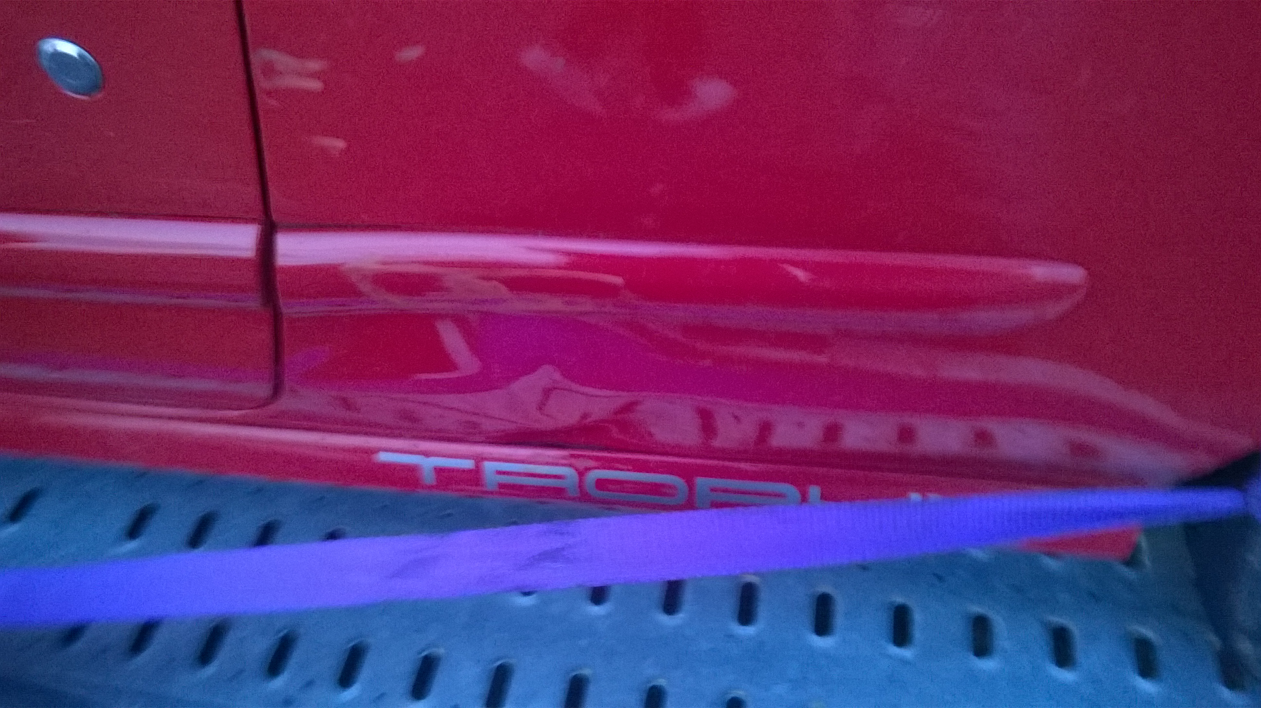

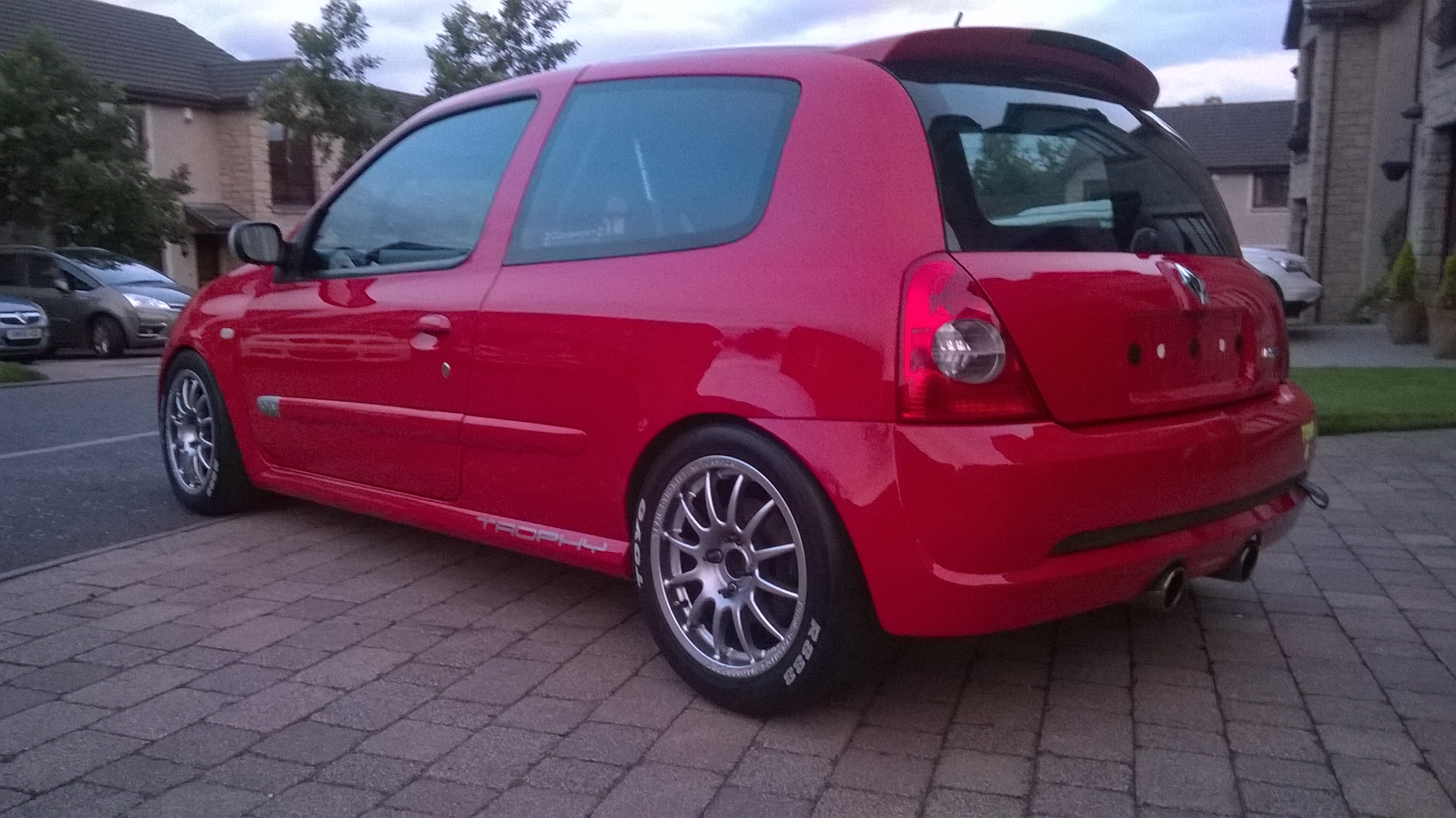

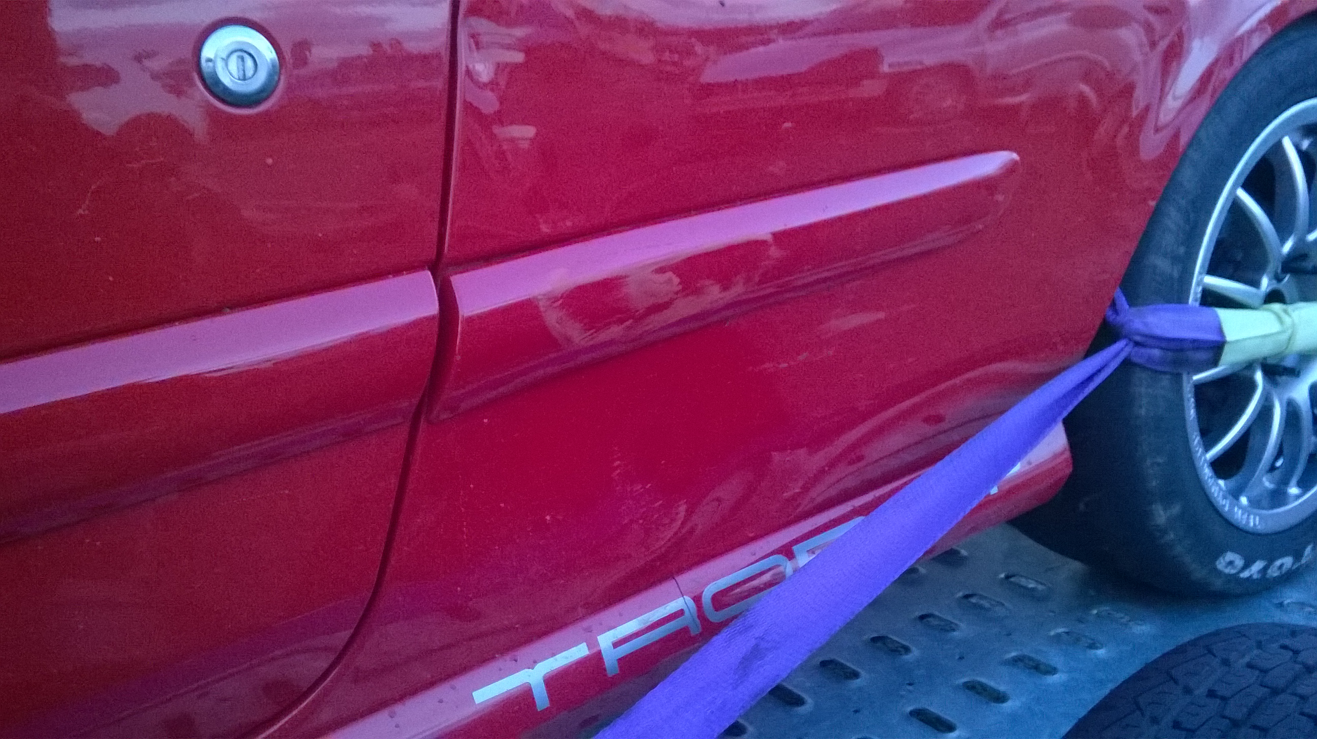

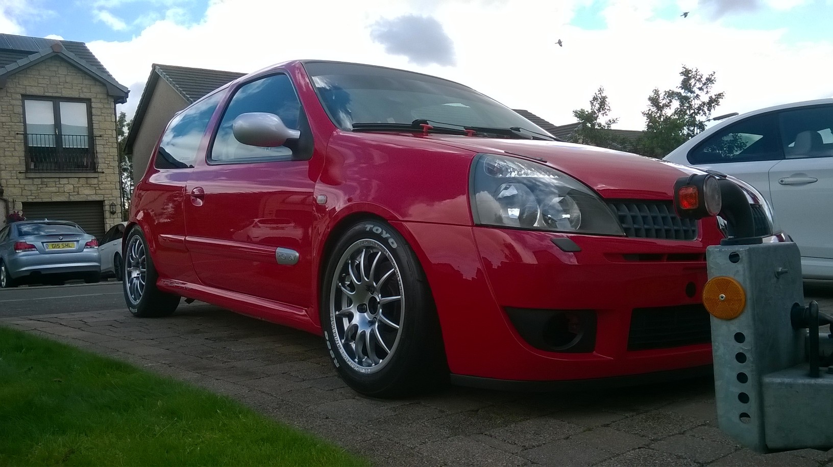

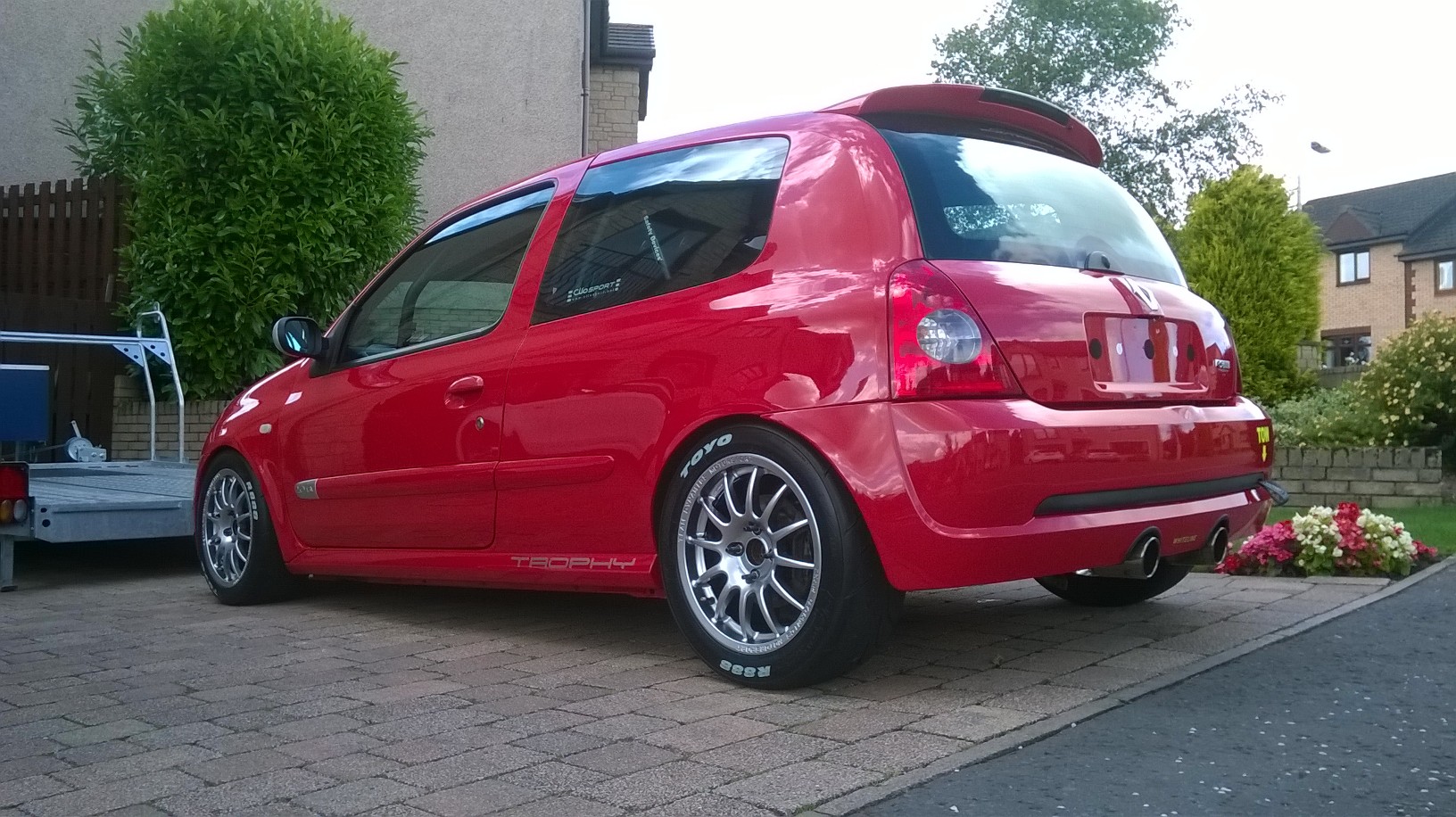

Well tonight's update following the track night at knockhill.... Just back and unloaded, photo below of she looked before I went up......
And below 2 photos of how that rear quarter looks after the track night...
Caught the gravel on the way into Butchers. Saved it, snapped back, saved that, ran out of track and went side ways over the cone..... Who would have thought a cone could do that much damage..... Never mind, it all be cheaper than the clutch to fix so she should be looking great again within the week.......
Plus point in in the 62's with a passenger and she sounds amazing !! :-)
