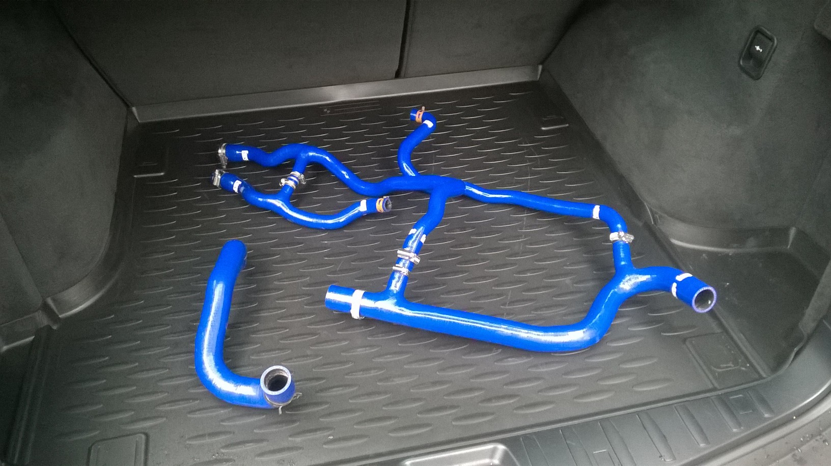

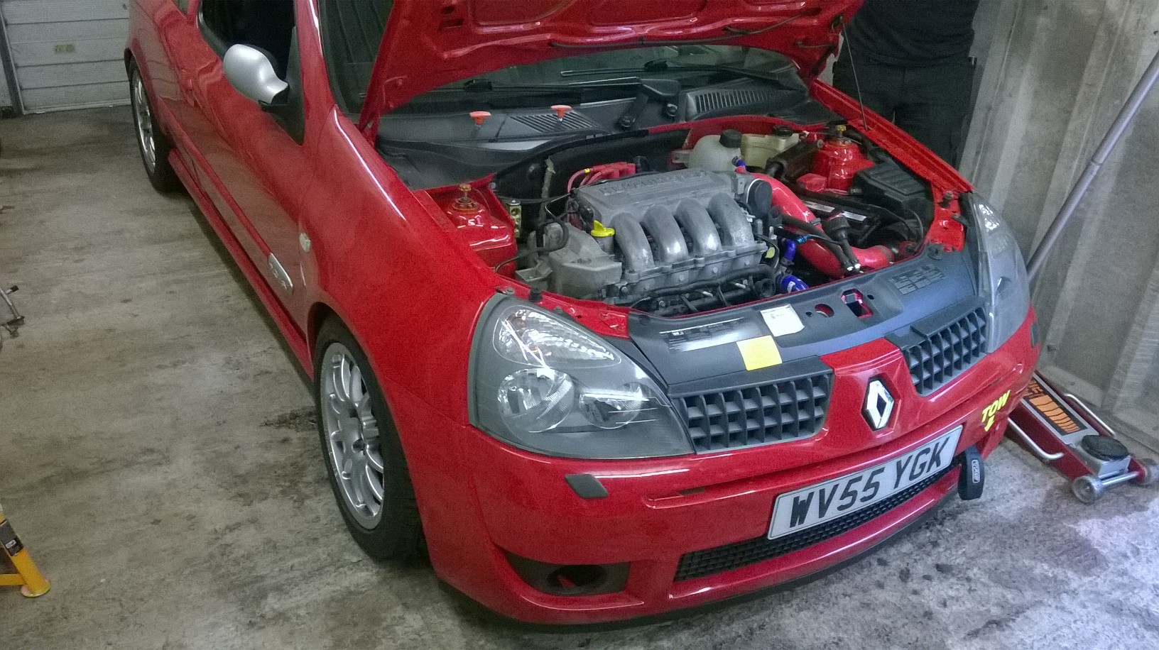

Not much of an update today, but just a couple of photos of the bits that will hopefully be fitted this week............... Blue maybe not the best colour to go with the red, but they came at the right price :smile:

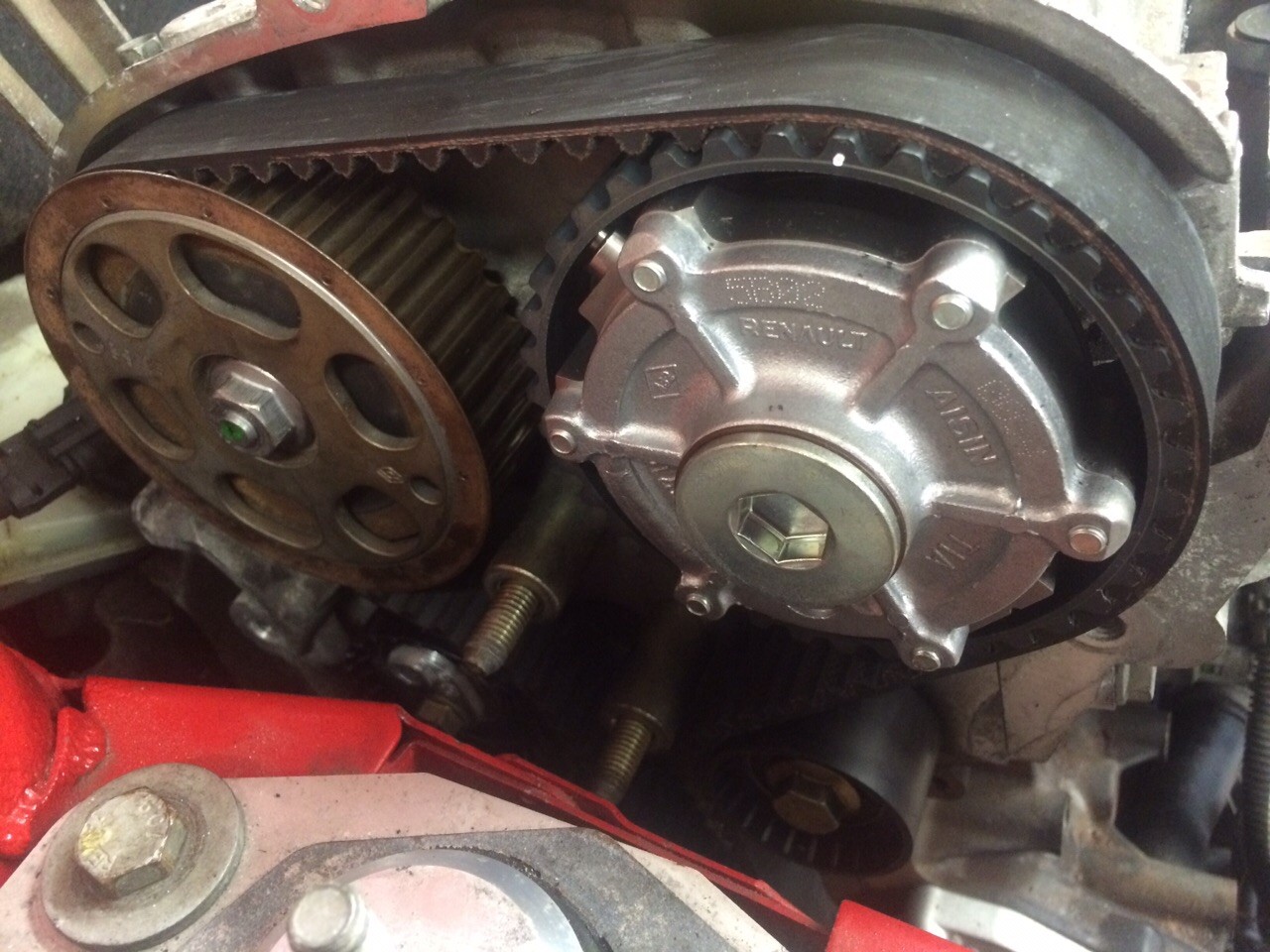

Well its about time for a quick update on the Trophy. Work has been busy lately so the car has never moved at all and It was about time the new parts get fitted!

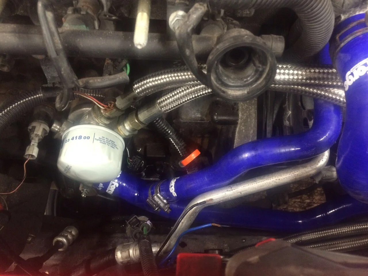

The first phase of the mods will be:
  • New Timing belt kit, water pump & Dephaser pulley
  • piper 285 cams
  • cam & crank shaft seals

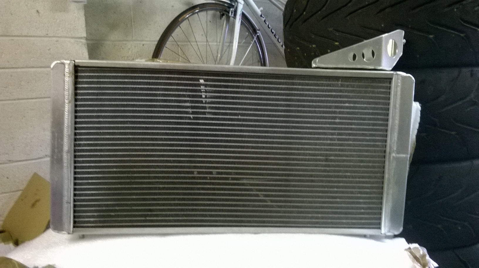

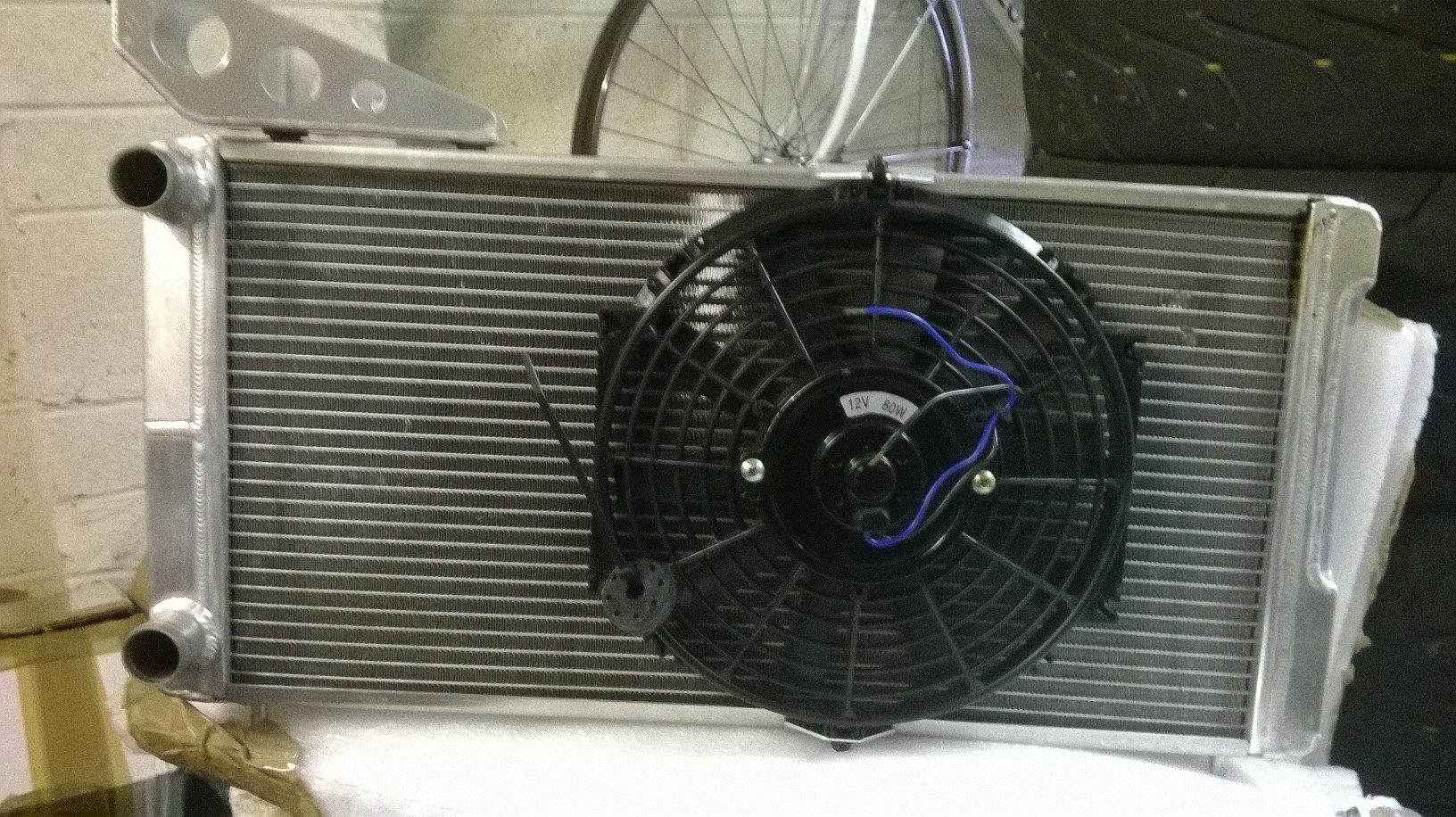

  • alloy radiator (matching header tank will be fitted once throttlebodies & ECU go on in the second phase of mods)
  • silicone hose kit
  • aircon & alternator removal
  • cup alternator set up & belt
  • oil cooler
  • all along with the fresh oil & filter of course

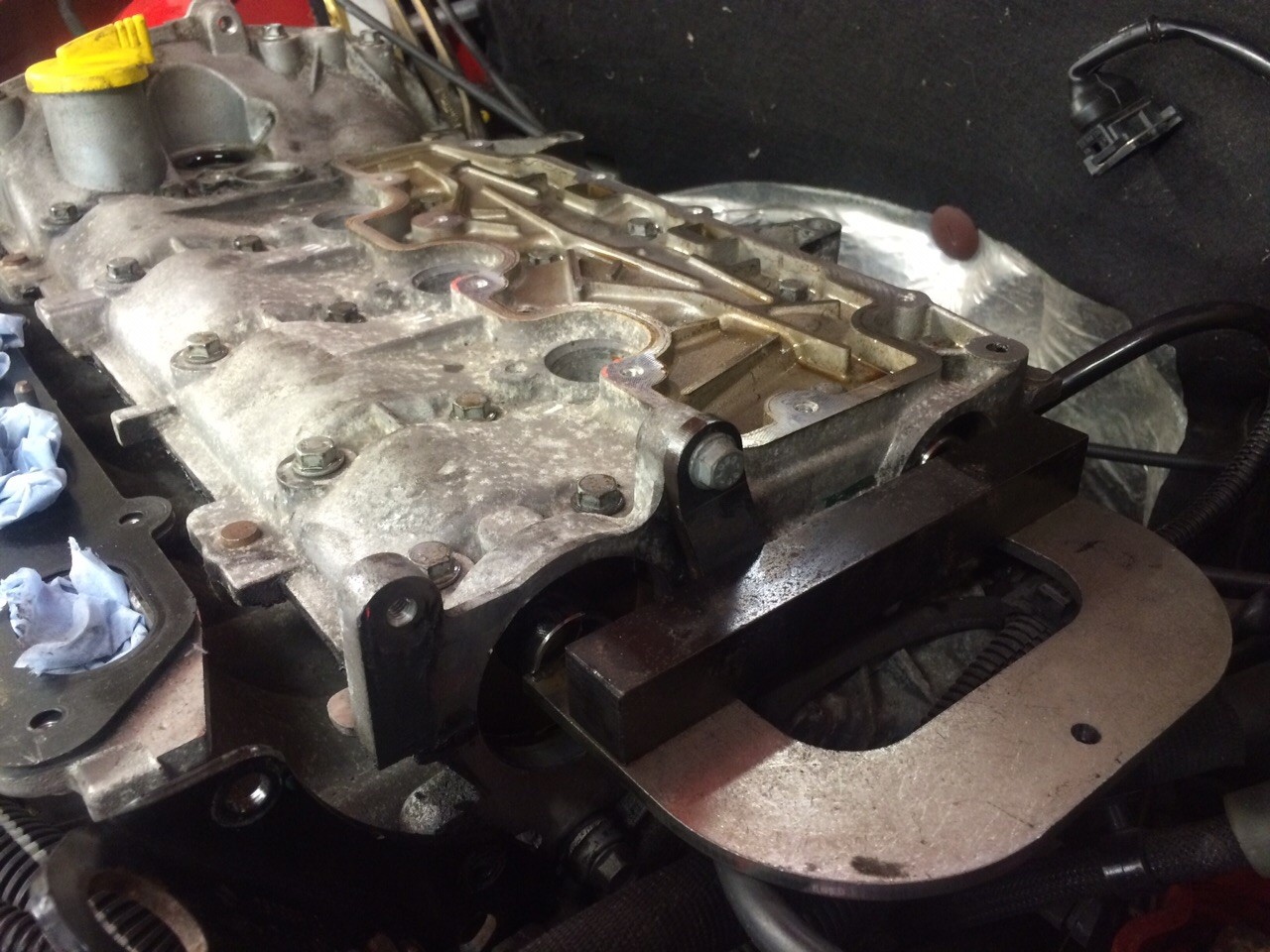

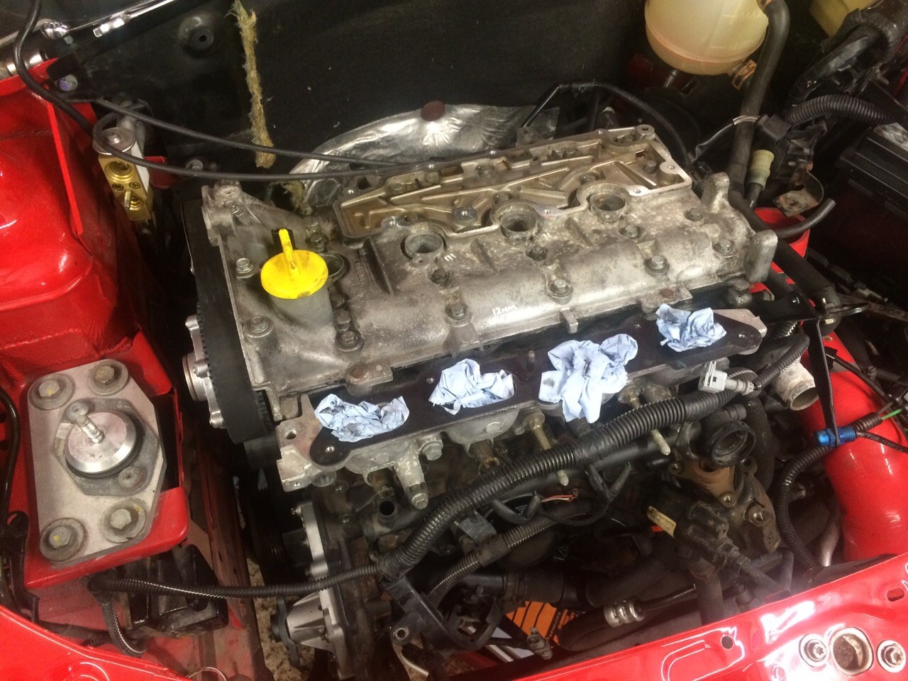

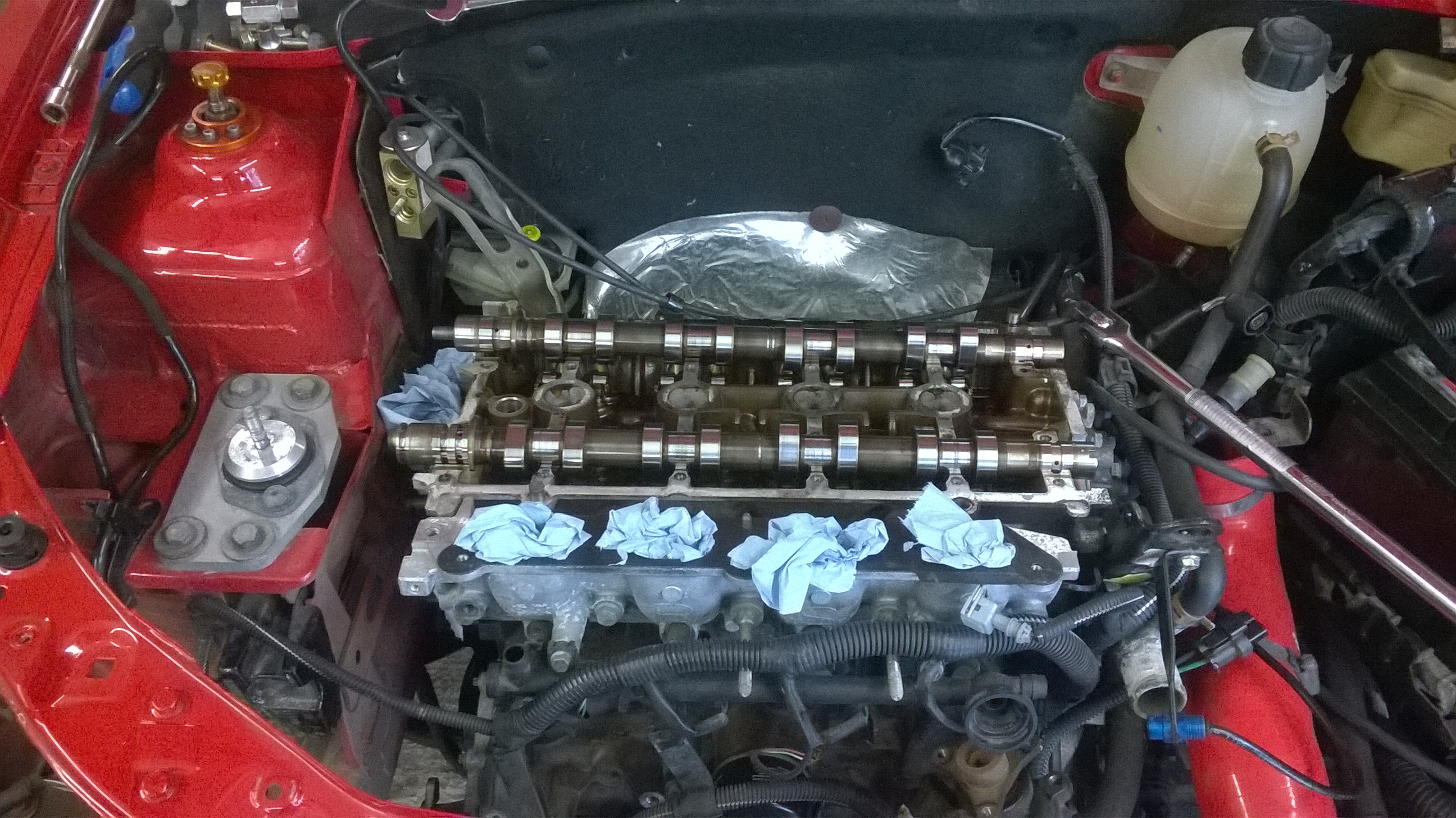

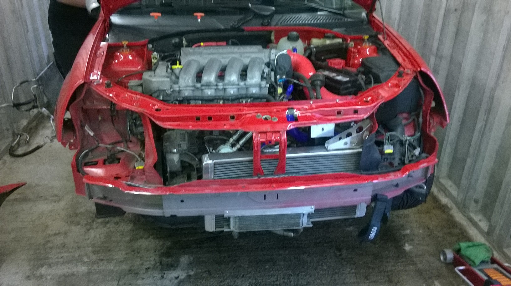

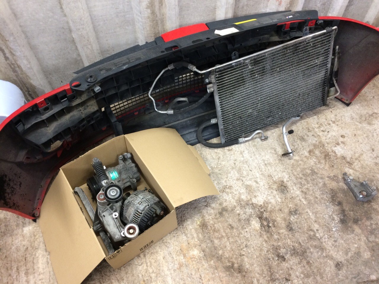

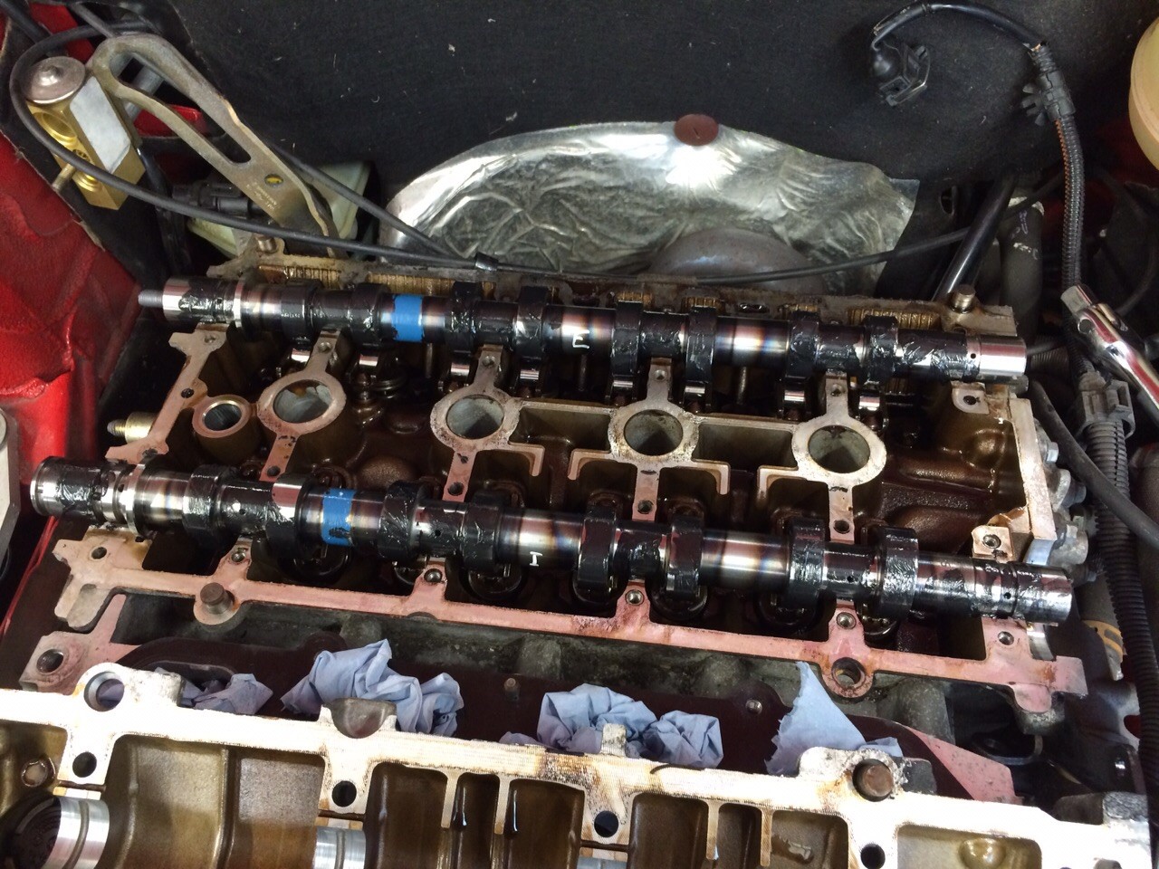

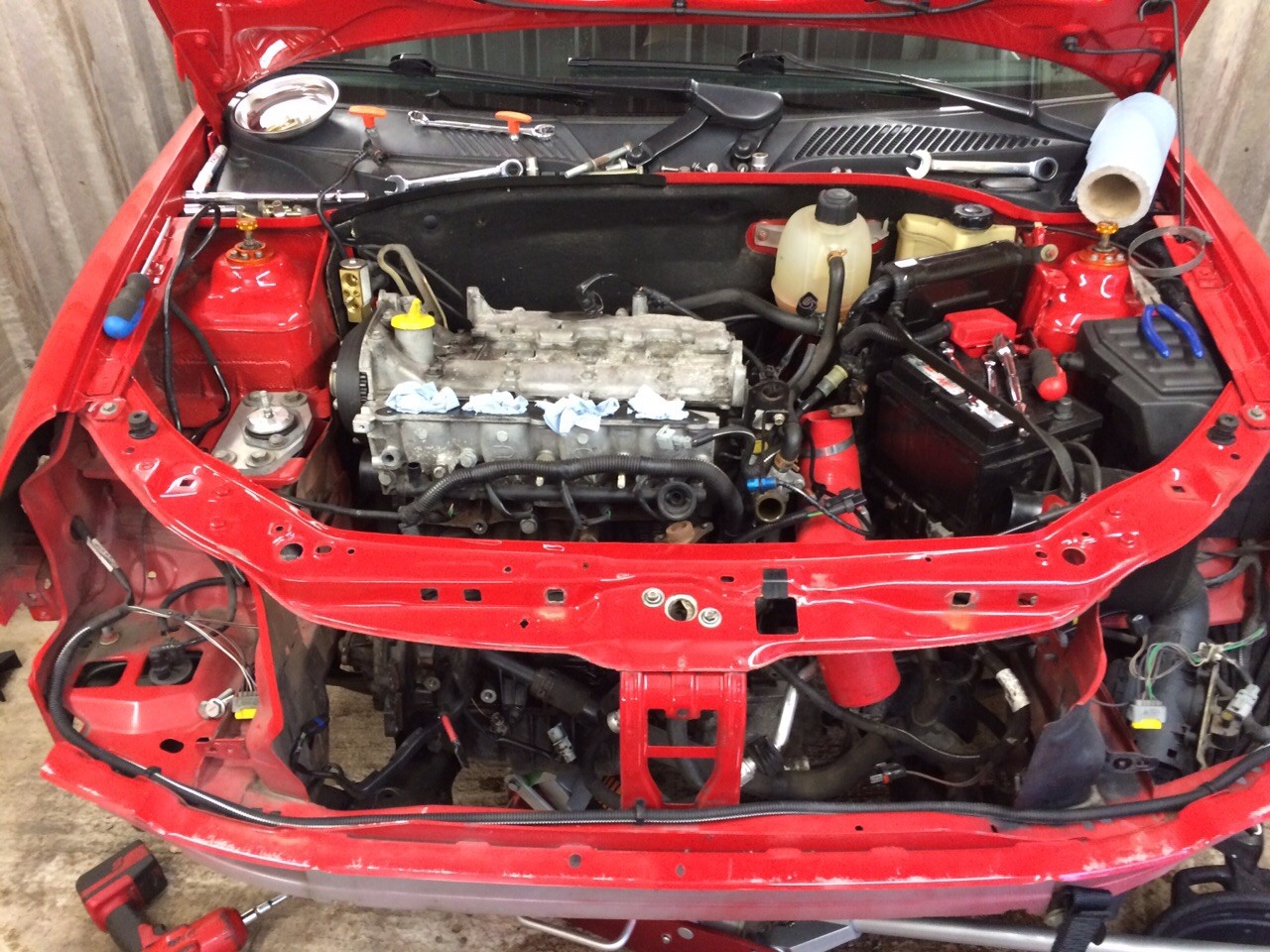

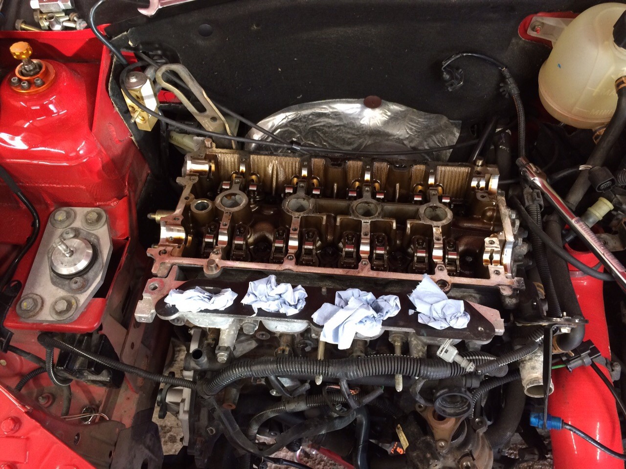

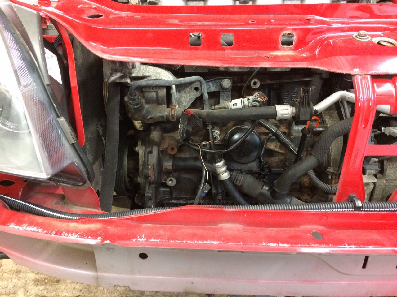

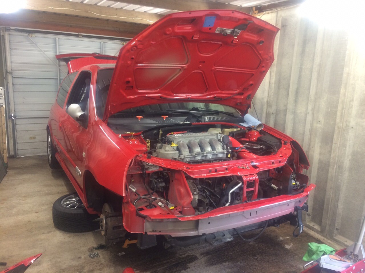

last night started the strip down - so a few photos of last nights progress below, hopefully all will be ready in advance of the 14th July track night and we can see if it improves anything!!
shall keep things updated as the week progresses :up:

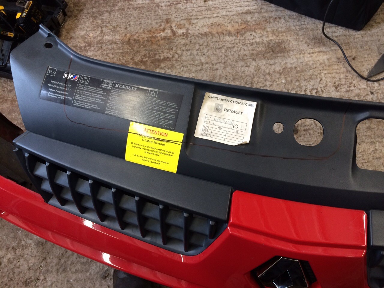

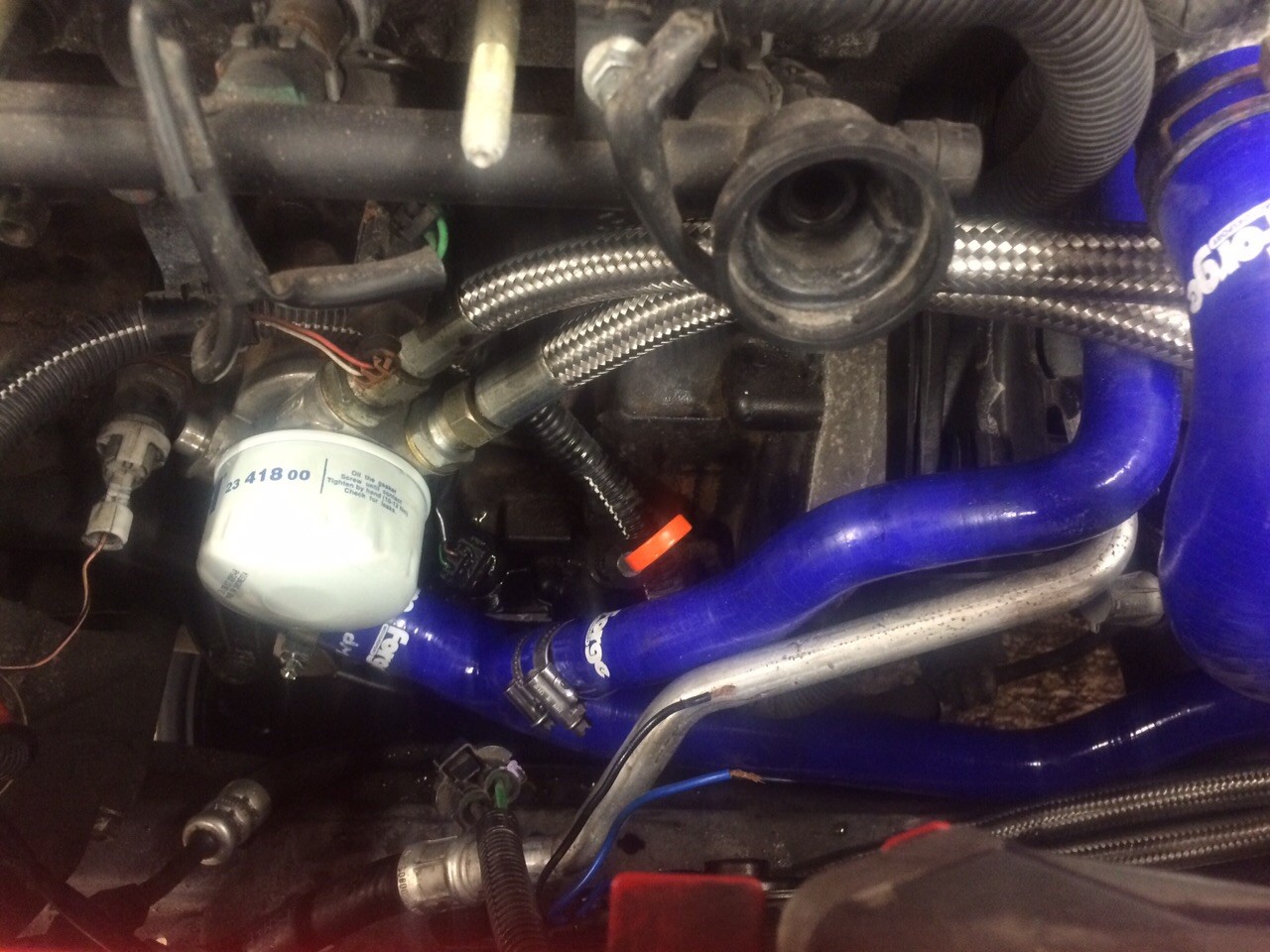

Todays update
Steady progress so should be all back together by Saturday...... sorry photo's a plenty but they really show it all, and I suppose a good record of work done :up:
Still a little lost with the oil leak around the sump though! doesn't use that much but after a track day the sump is wet as the oil is as thin as water.... was positive that it would be crankshaft seal as the sump gasket was replaced a few months ago, but crank shaft seal was bone dry!!. Didn't seem to be the rocker, although slightly damp at the rear it never showed signs of being wet. Never mind, rocker sealed, cam shaft seals new, sump gasket new & crank shaft seal dry! will get the oil-catch can on after its built up and help it breath a little better and keep looking unless anyone has any suggestions???

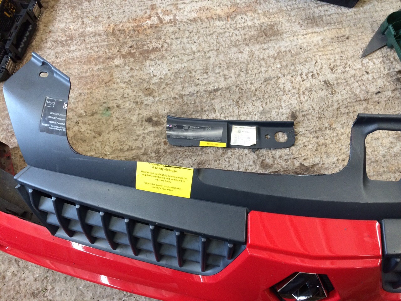

Aero catches ordered for bonnet & bumper as well today so that will be the next modification on the list in advance of the ITB's.

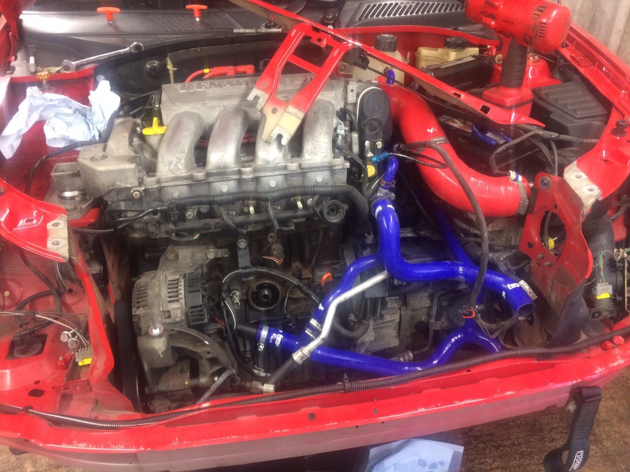

well todays update following another late night (big thanks to my mate Gaz for his help with this :up:).......
Car is built back up with (almost) a couple of finishing touches to be completed and was planning a run in at the weekend before the track day if all goes according to plan! picture rich story below:
Great progress mate. :smile: I ran the AH Fabrications radiator setup on my high-comp ITB build and it was fantastic at keeping everything cool. :up:
Yeah it's getting there mate, bit of me says I should have just put the ITB's on just now as they are lying there waiting, but it will be well into August before I can get it mapped and thought I could fit a couple of track days in between with just the cams in. Fingers crossed it all goes as planned and I start to see & feel the benefits :up::cool:

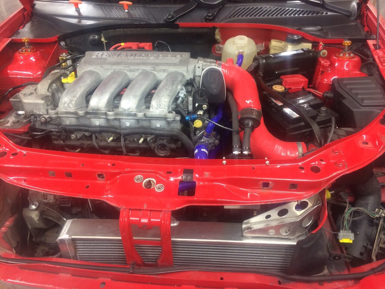

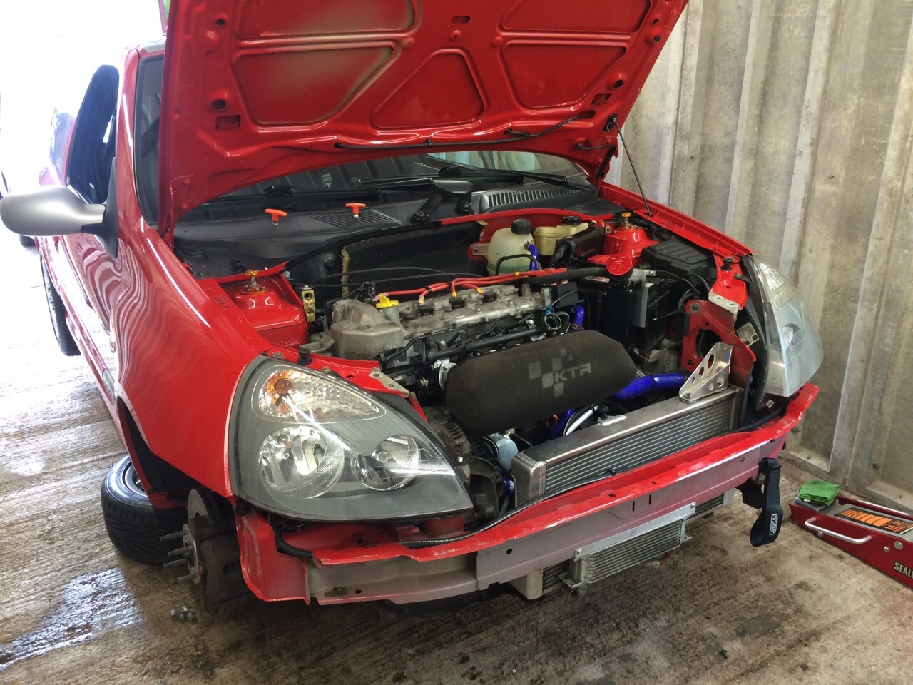

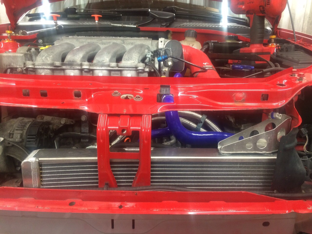

Well another photo update ............ phase 1 modifications complete :tongueclosed: ! Big thanks to Gaz for his hard works & @Ph1 Tom for bits of advice through the process :up:, im sure there will be a few more texts during the phase 2 ITB install, although I think the hard works has been done!

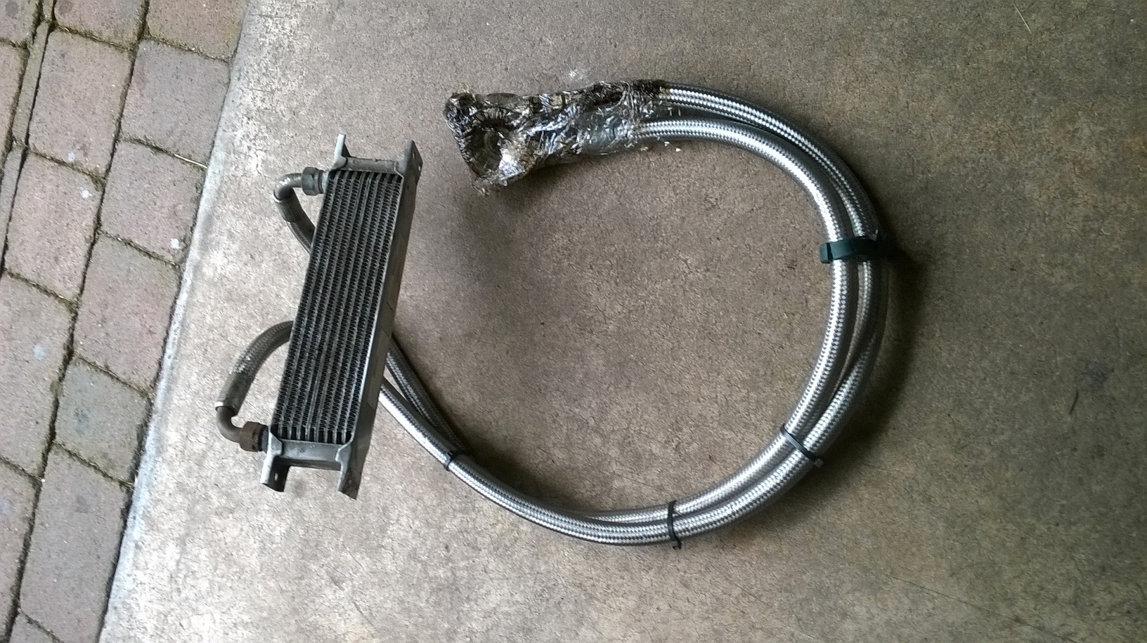

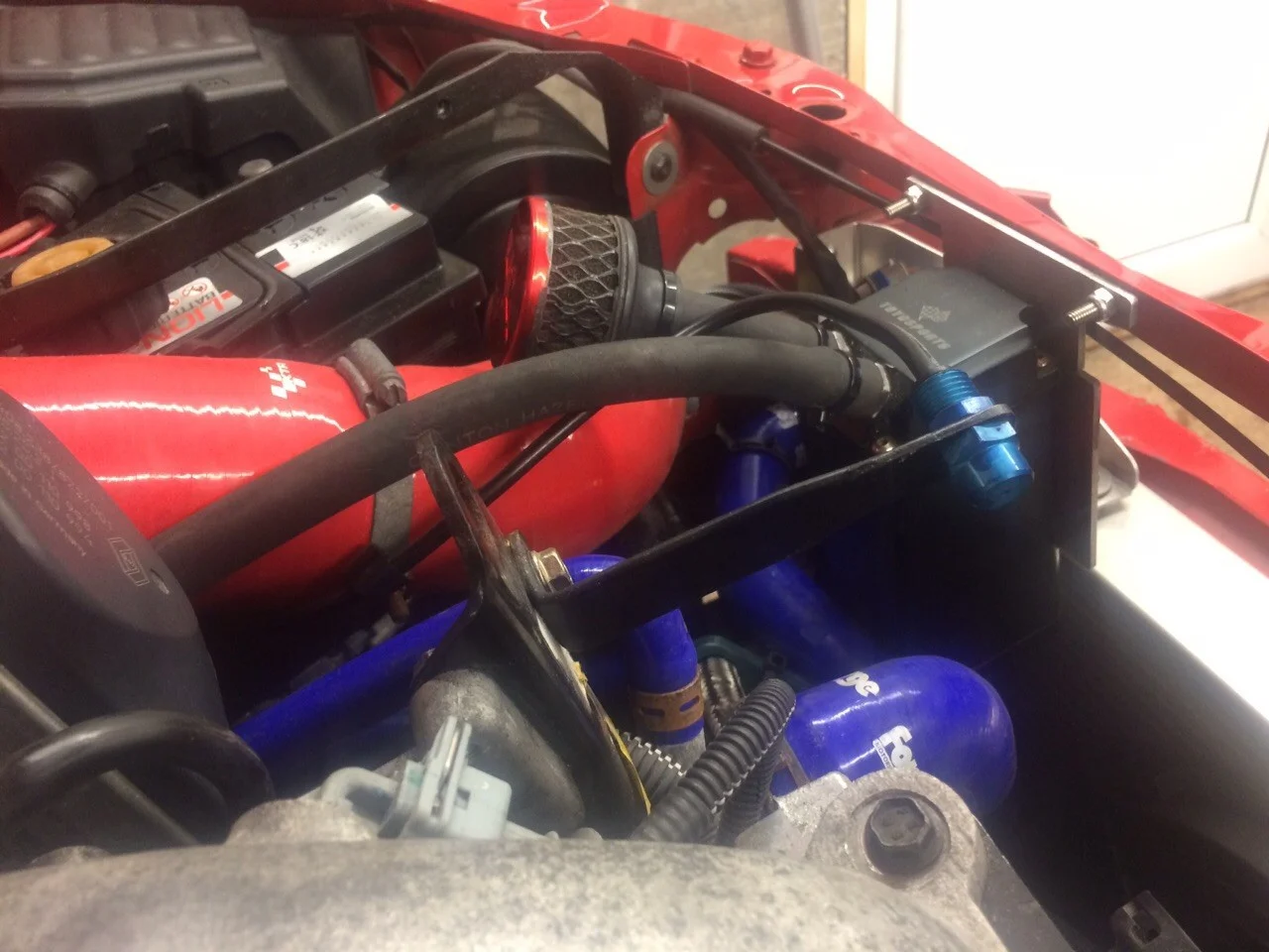

Had to fabricate an alloy bracket to mount the oil cooler, just to ensure clearance for the pipes, works a treat & fits very neatly......
Anyway before the front end was built back up came the all important running period as specified by Piper..... more of a worry as it was a 20 minute period spent looking for water & oil leaks as both systems have changed, at quite a bit of revs which I really didn't like!! plus side, no leaks, water or oil from anything installed an all sounding very healthy :smile:.....

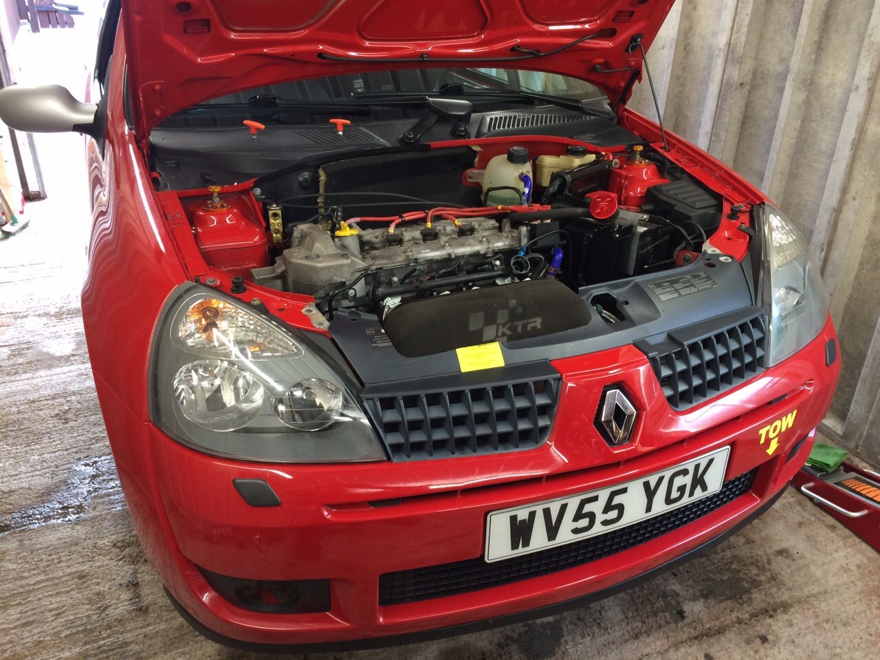

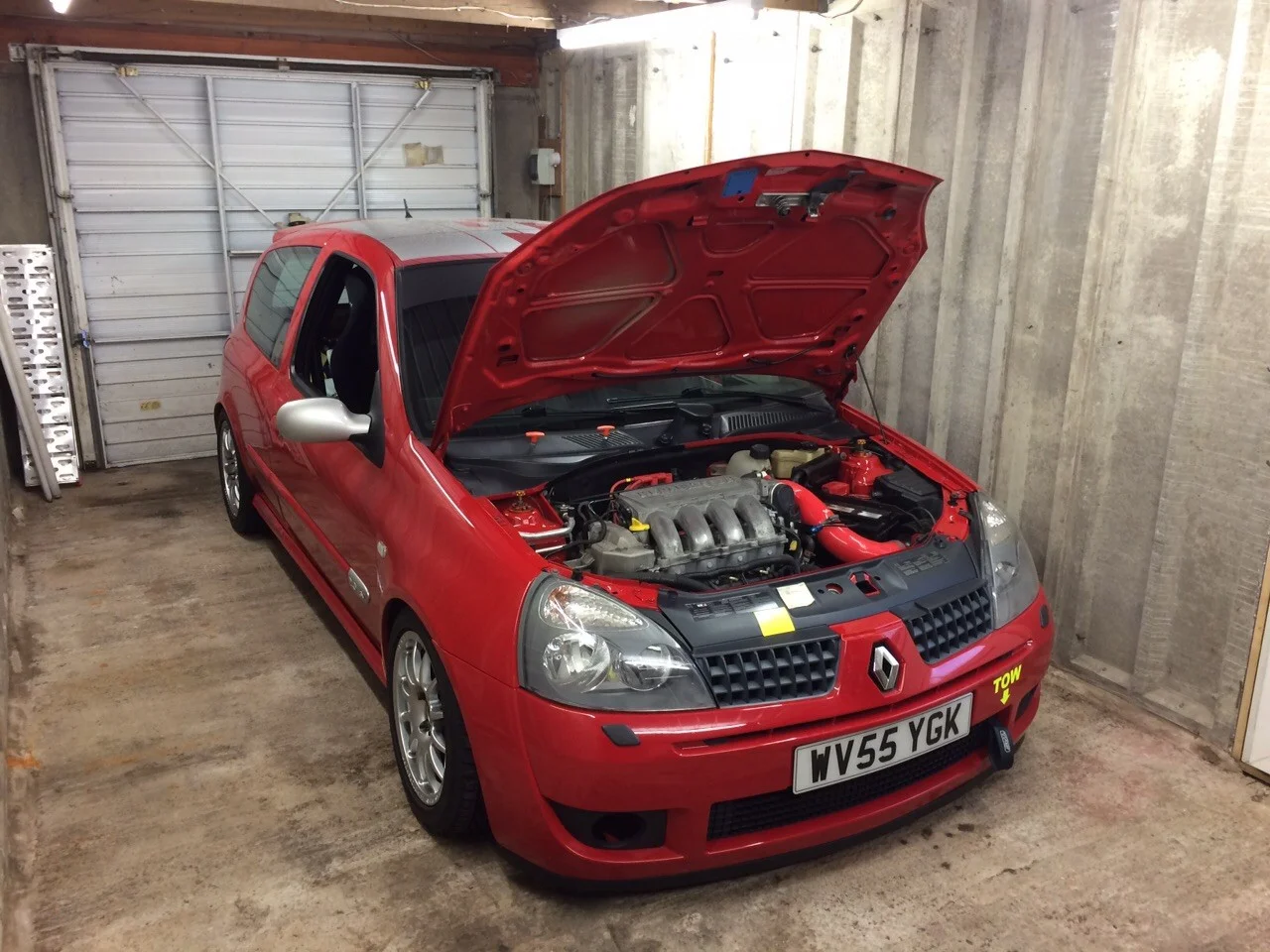

Everything on, looking neat and tidy and ready for the MOT tomorrow (all going well and time permitting)
Oh also managed to squeeze a brake fluid change in too as its been a year! replacement for super blue, now its kinda clear but hopefully just as effective:tonguewink: Seemingly changed after 15 years as the American market deem blue unacceptable????? figure that one out!!
Anyway it is all built up as you can see below, just needs a plug for the silicone induction kit where the breather hose has been removed, so all going well (work dependant) ready for Tuesday night at Knockhill!! hope to see some of you up there :stig:

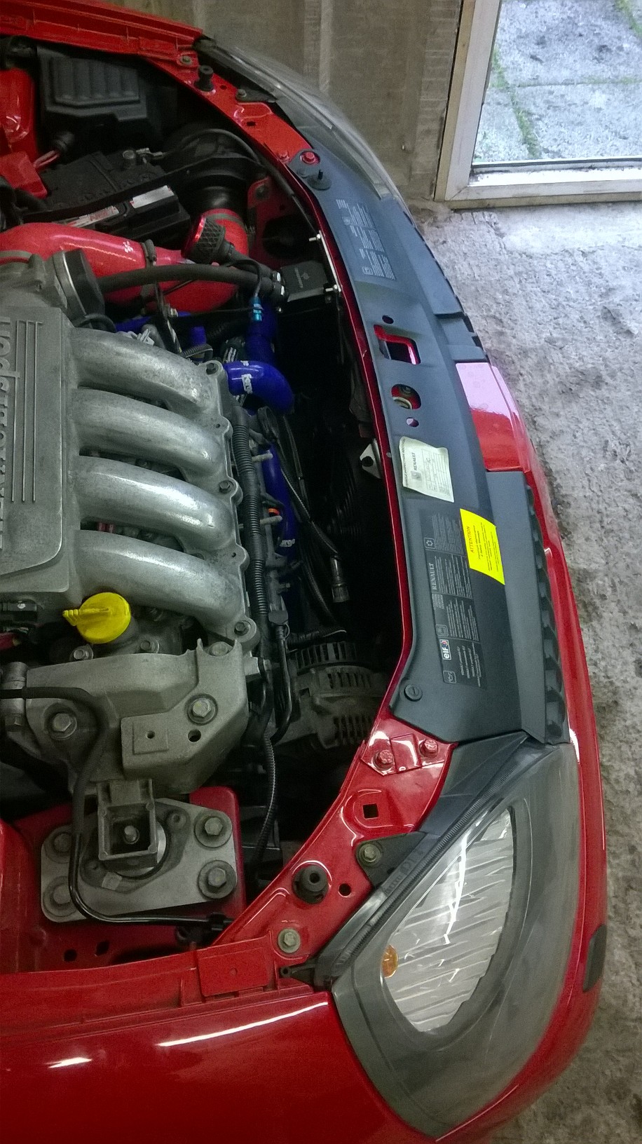

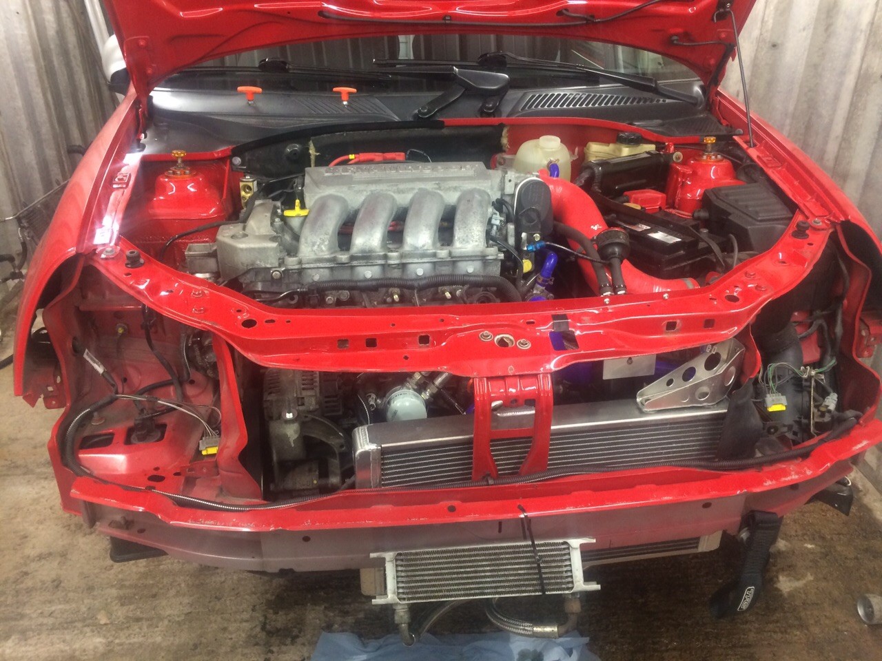

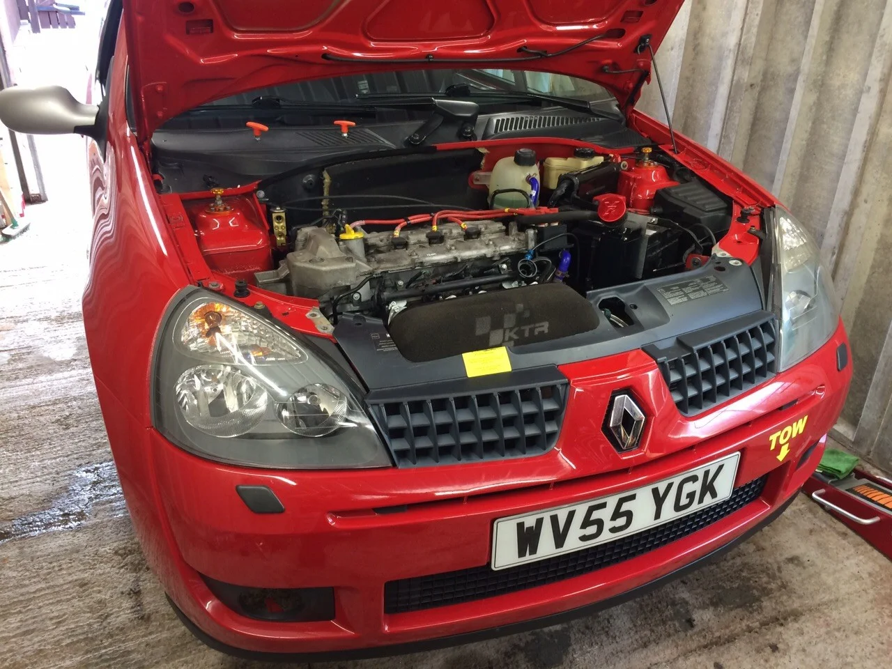

Well things have progressed a little further...... I think the pictures below save me typing a lot so i'll summarise at the end as I need a little help if anyone can assist........
Now comes the help required.....
I am currently talking to K-tec re the ph1 throttle peddle mounting bracket and the slam panel extension brackets, and hopefully they are willing to sell these separate but it seems they only like to sell the complete kit, i.e. a full throttle body package!! I've heard a lot of positive thinks about them and their customer service so hopefully they will, but failing that does any one have one that they don't need??
Other than that hopefully everything will be good, I have a few small tidying up things to do but really incidental............. assistance greatly appreciated and I'll keep you update as things progress.

Well as a plus on K tecs side. Sean was first class with advice today and hard wiring the TPS will be happening! :up: Can't really understand why they wouldn't sell the parts, as they have them made anyway?... Never mind :up::down::down:!
A little mod to the throttle peddle and that should be in place soon and I'll have some brackets made for securing the grille.......

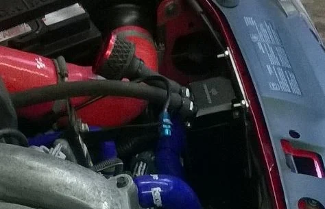

Hi, Can I ask a quick question, I need one of these oil catch tanks/breathers and your looks like a great shape as its not too big.
Have you got a link or the name of it so I can buy one.

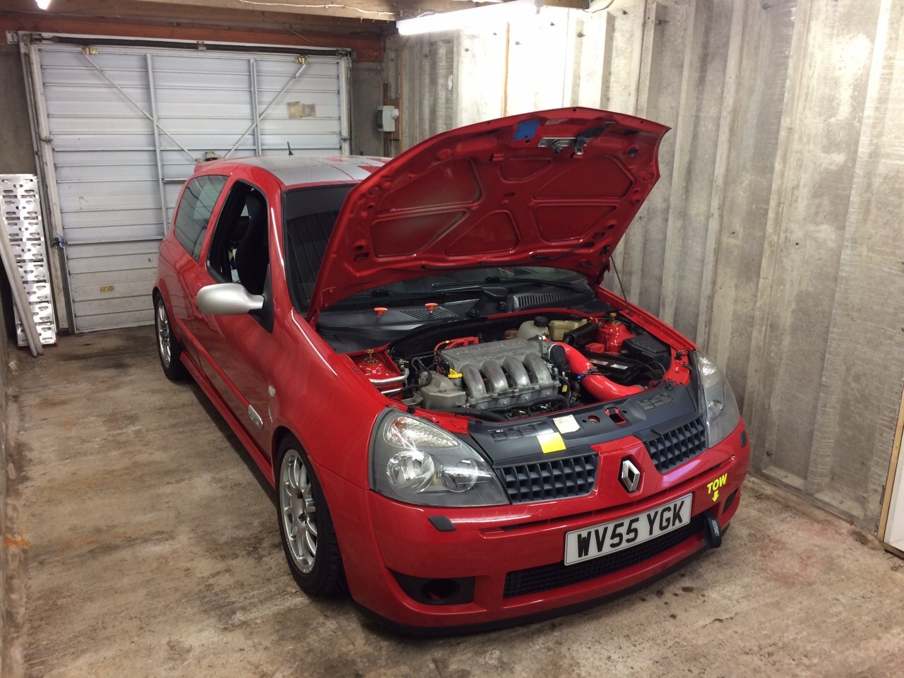

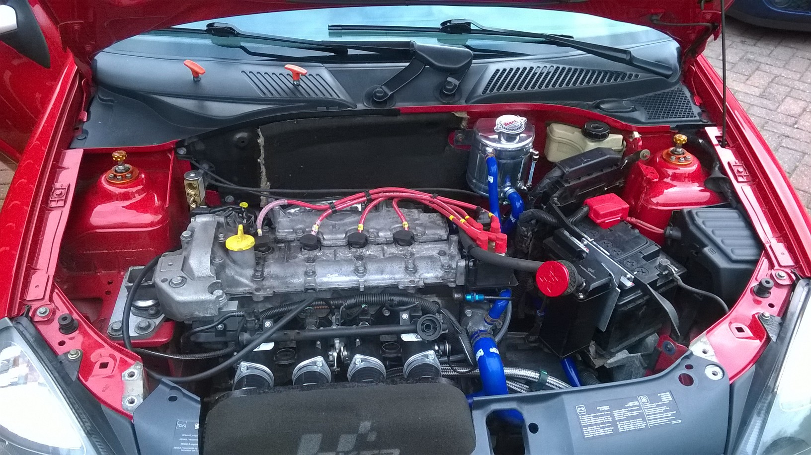

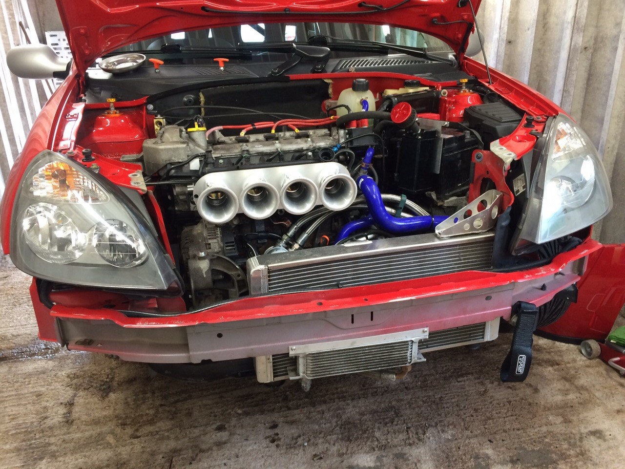

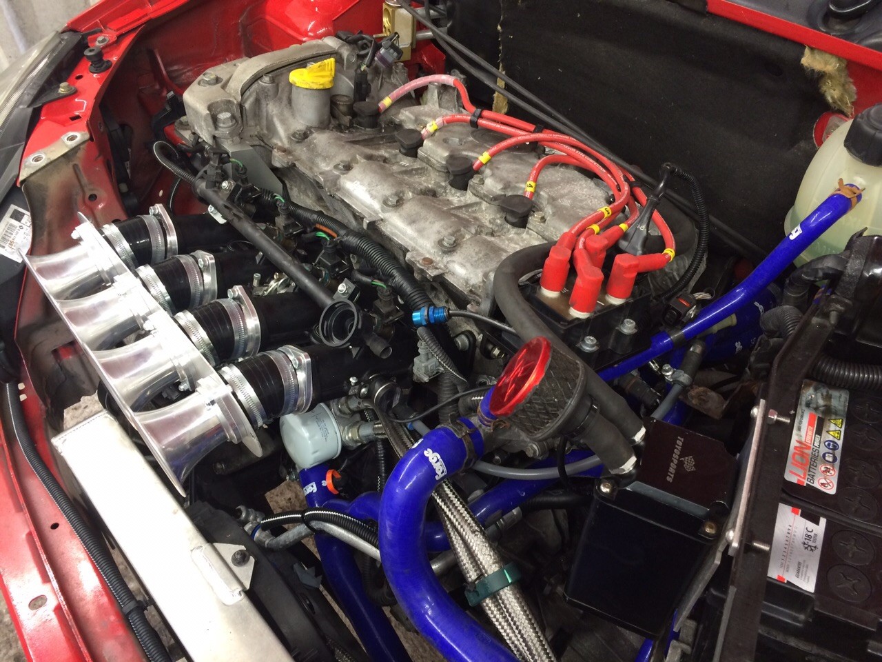

Well another update in the life and times of Trophy 381............

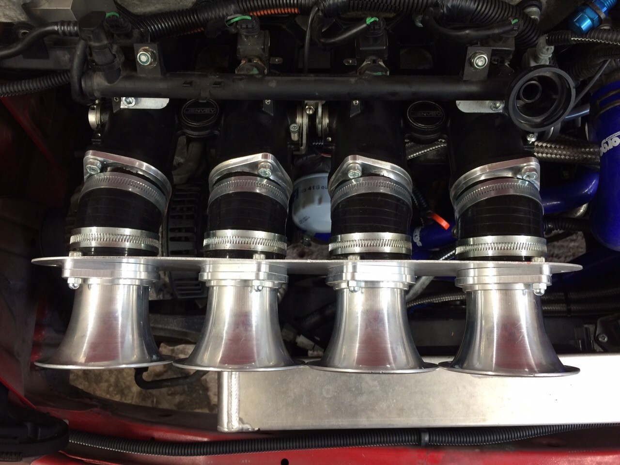

ITB install completed after a few nights of hassle, car finally running after a new TPS arrived from Jenvey today 😢. Spent 2 nights trying to get the base settings working with the K-tec software and couldn't get it to set up. Turns out the original TPS was faulty!! anyway new one arrived today, set up and ticking over and running on base map. Think I need a to give the throttle peddle a little more free play as its instantaneous just now and I would prefer a tiny bit of movement on the peddle before take off :smile:. Will be phoning RS Tuning tomorrow to check availability for Rolling road set up, so finger crossed I see some of difference with the cams & the ITB's :up:
Oh another small note, removed the breather elbow to help enlarge the breather hole, just looked awful small so now 3 or 4 mm bigger!

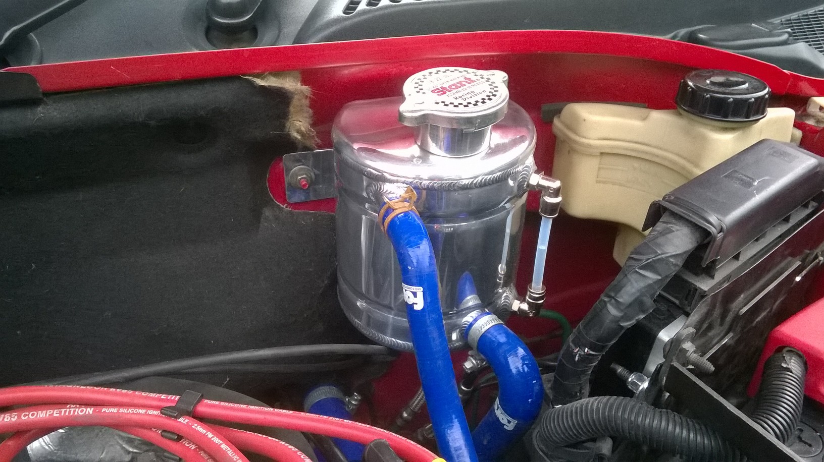

The other small addition is an A H Fabrications header tank to complement the radiator install............ not needed, but looks nice :tonguewink:
hopefully the weekend frees me up and I can get to work on the aero catches, clean up the engine bay and move on from there.
