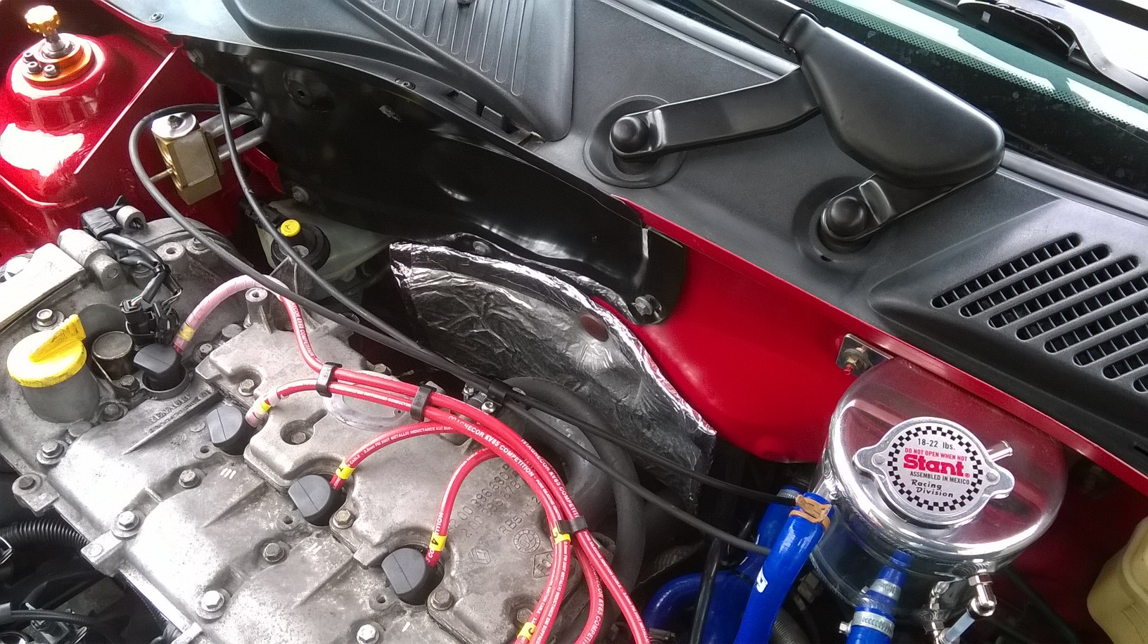

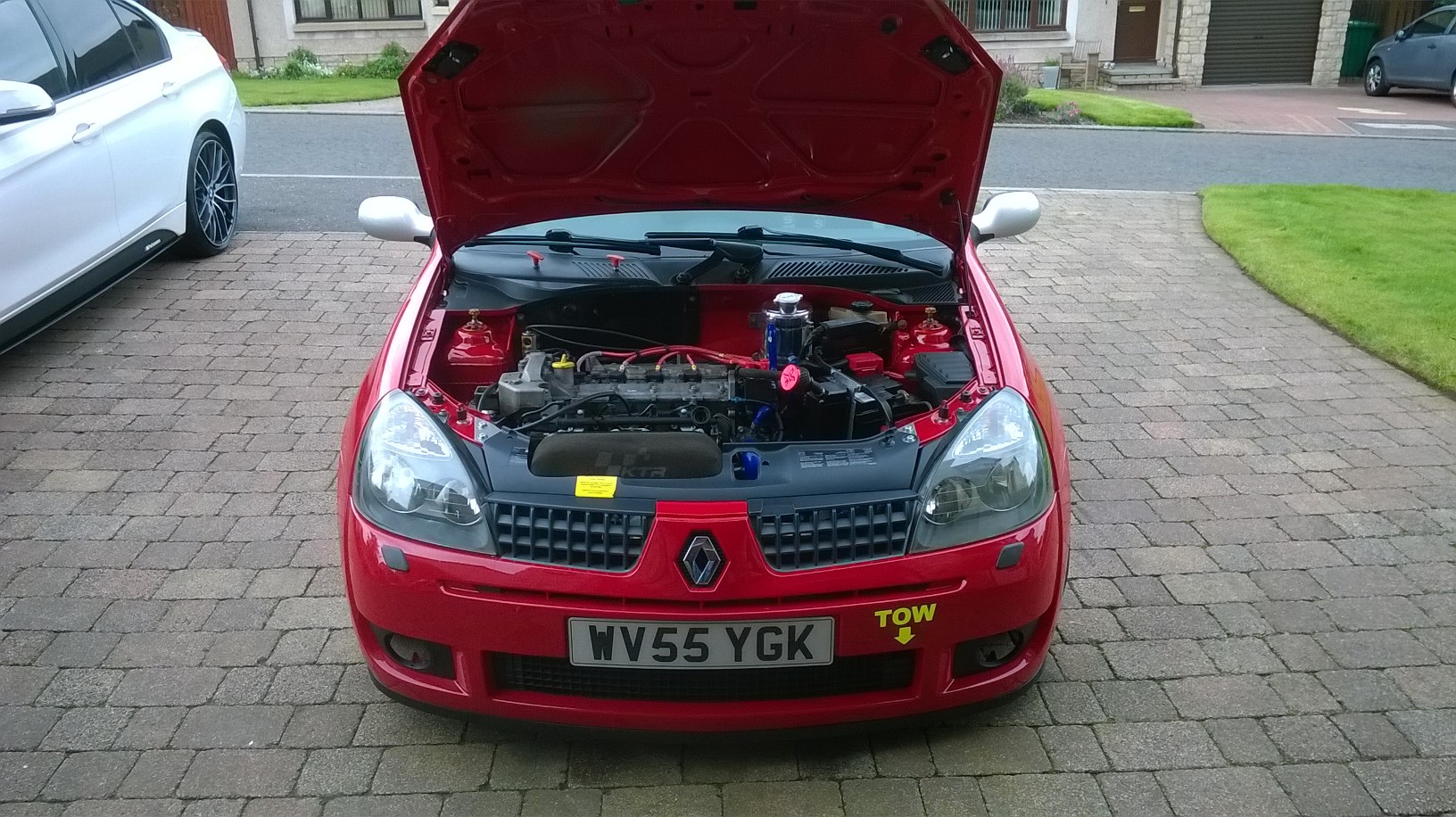

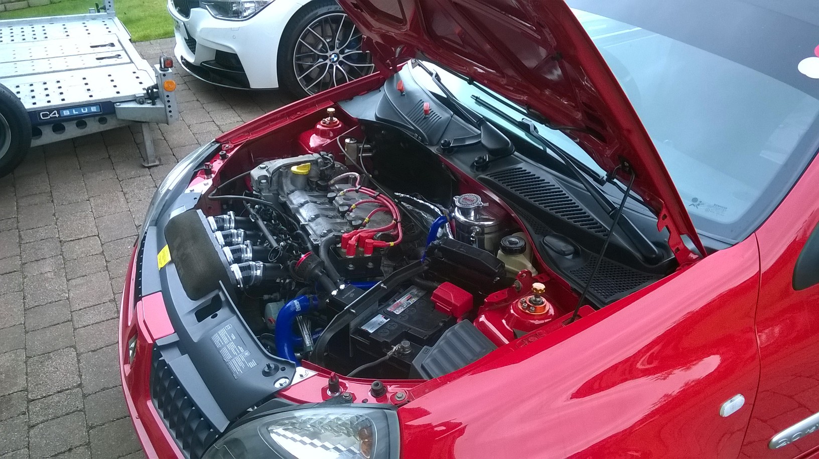

Well, I made a little progress over weekend, weather didn't help mind you but in between the rain showers I managed to get the aero catches fitted to the bonnet, which allowed me to get the bonnet secured and get out for my well awaited test drive. roads were very wet and although it started to dry they were still a little greasy, so no surprise it liked to spin up in second and third!! must admit the grin factor is there, the car feels very strong low down and through mid and high rev range and the noise is deafening :smile: :up:............ before the ITB's, even though it was loud outside, inside wasn't that bad with the usual engine noise for a car with no sound deadening, but now that's drowned out and the car is just loud (in a great way!!)....... not caring what the rolling road says, the noise is worth it alone :astonished:. The difference in driveability was very noticeable on the base map alone, so i cant wait to feel how it goes after its set up on the rolling road........ so after the high of the test drive I spent the rest of the morning, and early after noon, cleaning up the engine bay, fitting the slam panels extensions and generally tidying up things (a few boring photos of the weekend work and results below)
the phot below just a trial fit before they were removed and all the exposed edges coated in red hammerite! hate the thought of any rust getting In!!
i had ordered up from Renault the bulkhead heat shield above / behind the manifold, but my impatience meant that i tidied up the exitsing one, removed the sound deadening and applied some metal tape to the edges. I like the cleaner look of the bulkhead vs the back padding! it will be a quick change over when the new one arrives :up: (I've removed the large lump of brass from the air con pipes too and i'll remove the stuff behind the dash over the winter if i find the motivation)
Well I've made progress on the list a few posts back, so as soon as the new silicone breather piping arrives that can be added. I have already received the new ram air breather filter so that should smarten that up soon :cool:, and if the new springs ever arrive from AST then that can be finished off as well!! also still getting the replacement ITB filter sorted too so hopefully that arrives soon too!
That's about it for the weekend, time to sit back, relax and eat crap in front of the TV now.

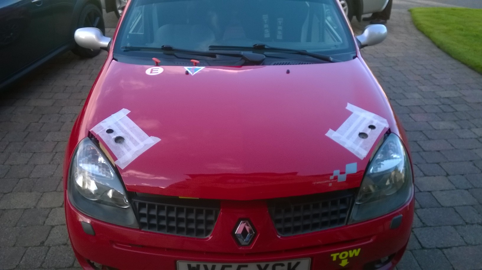

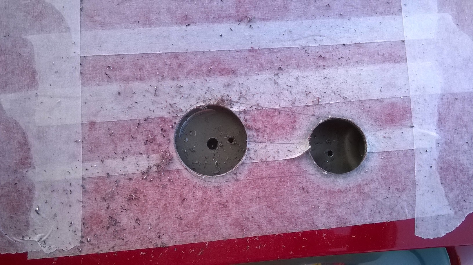

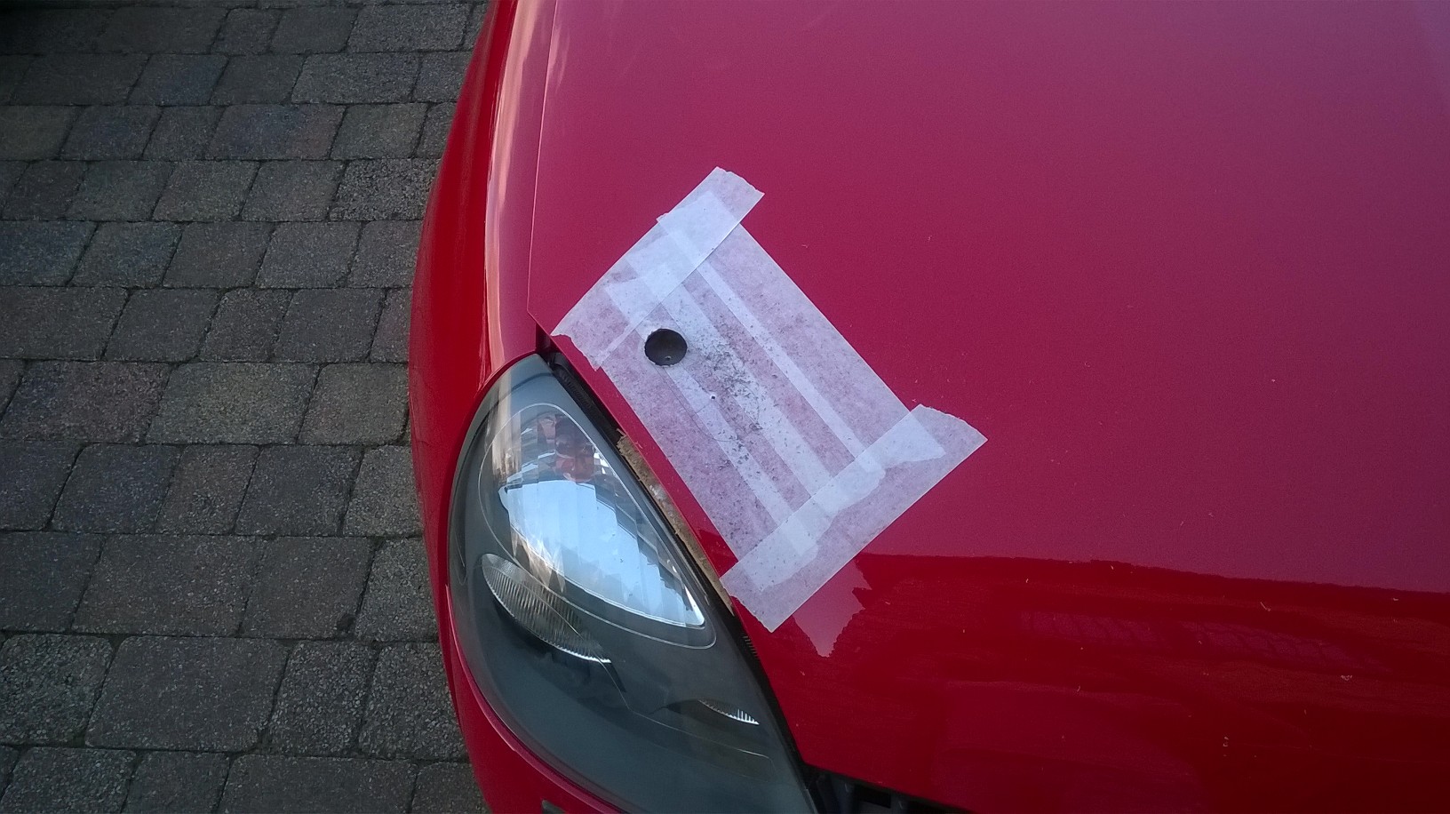

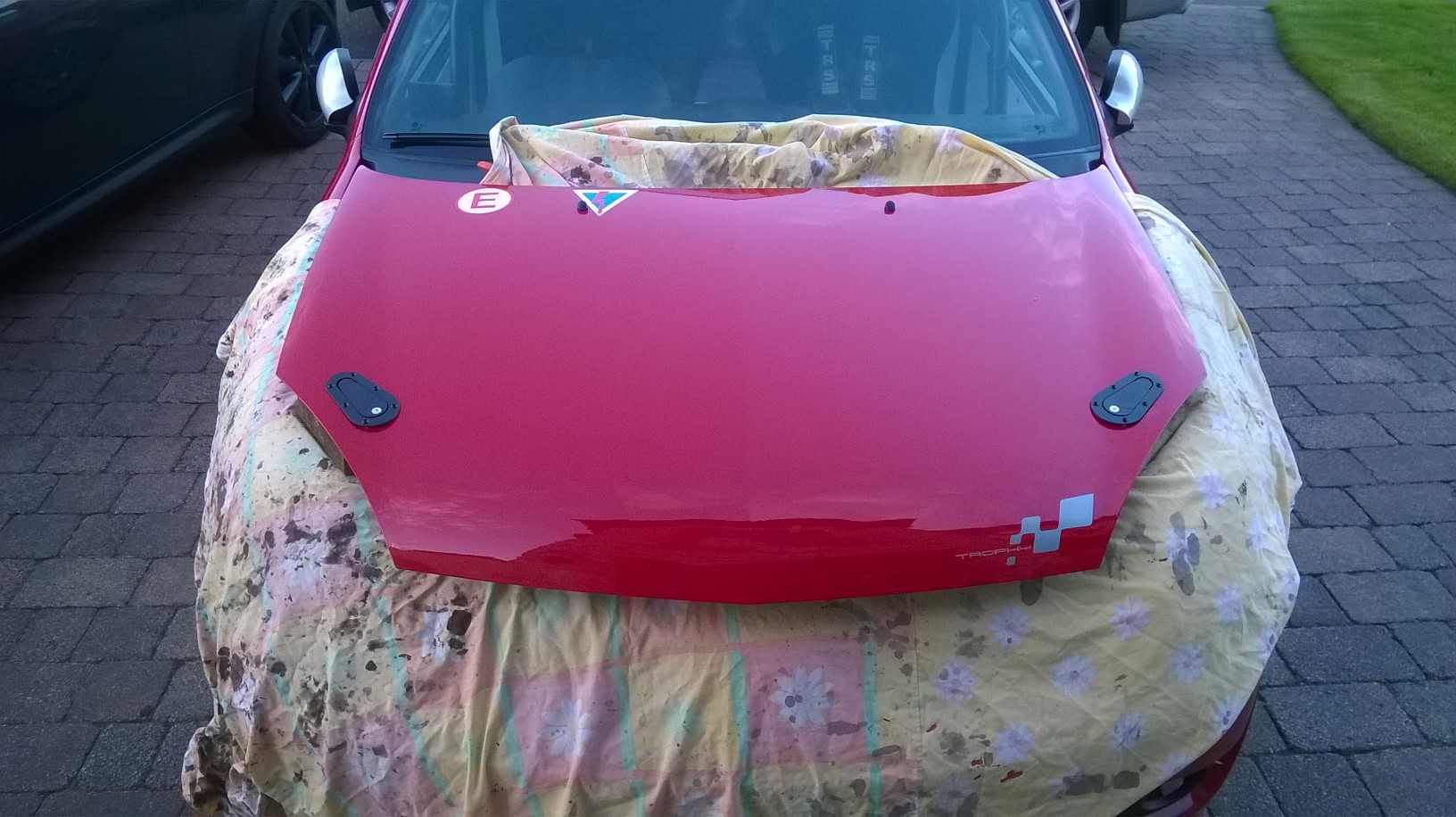

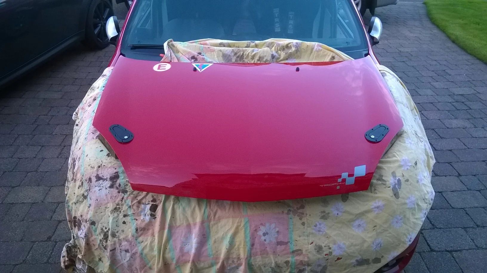

Any tips on cutting the bonnet for 'catches?
  Supercharged AG 200
This is absolutely mega mate! Love it.
Time and patience mate lol!! externally its pretty easy if you have the correct size hole saws and a grinder, always tape the bonnet up and drill small pilot holes first as a guide!!. Under the bonnet I should have got cutting disc for the Dremmel to tidy that up but I used the grinder as well. I will go back an tidy that up later, its not that bad to be fair, but I am a neat freak and like things just right lol - keep trying to tell myself its a track car after all!!

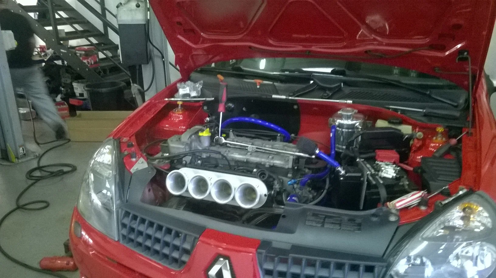

Well today's update.............. The last couple of days have been a bit of a pain to tell you the trust, topped off by missing out on today's track day at Knockhill! bit of a s**t@*r, but a time line below of the weekend events starting on Thursday night
Thursday:

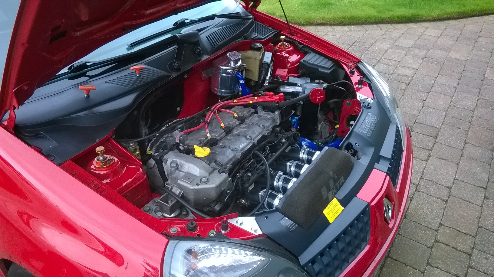

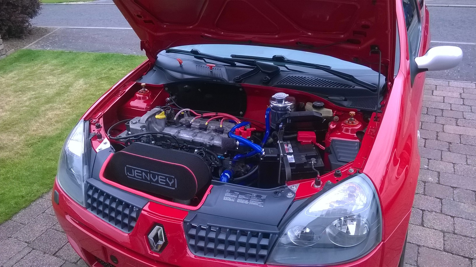

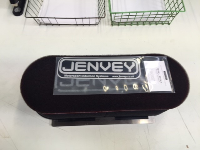

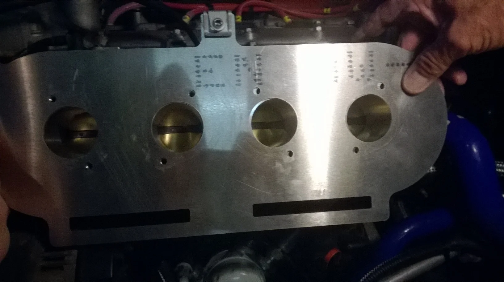

Get back from Aberdeen to find the new filter has been delivered from Jenvey, so quick change and set to work fitting it, its kinda late & I should have just put the Trophy on the trailer and not bothered with the hassle, but when you get something new you just have to try at least............... So, bumper off, ITB extensions (Ph1 Toms elbow kit to put the filter into the grille) dismantled and the new backing plate fitted, re build everything and try to shut the bonnet and no joy, the Jenvey back plate lugs and the size of the filter over the k tec one mean that it isn't going to happen!! not wanting to cut the bonnet or butcher it to be fair to make this fit, I think lets remove the extensions, fit the back plate direct to the ITB's and get the filter on in a suitable lower position, simple you would think!!, not so, Jenvey had manufactured the back plate incorrectly (gap between the middle 2 is 4mm / 5mm too close together) and that means the holes are out and the plate cant go on! out by 5mm so no point in even trying to adjust them, of course I had the movement in the silicone elbows before but no such luck going direct!!
so after the best part of 3 hours p*ss*ng about in the drive, the car gets built back up as it was before we started, minus the trumpet extensions, and loaded onto the trailer at "23:30". Im sure the neighbours were loving me, but since we were leaving at 4:30am the next day, better that than loading up at that time 😞!
Friday:

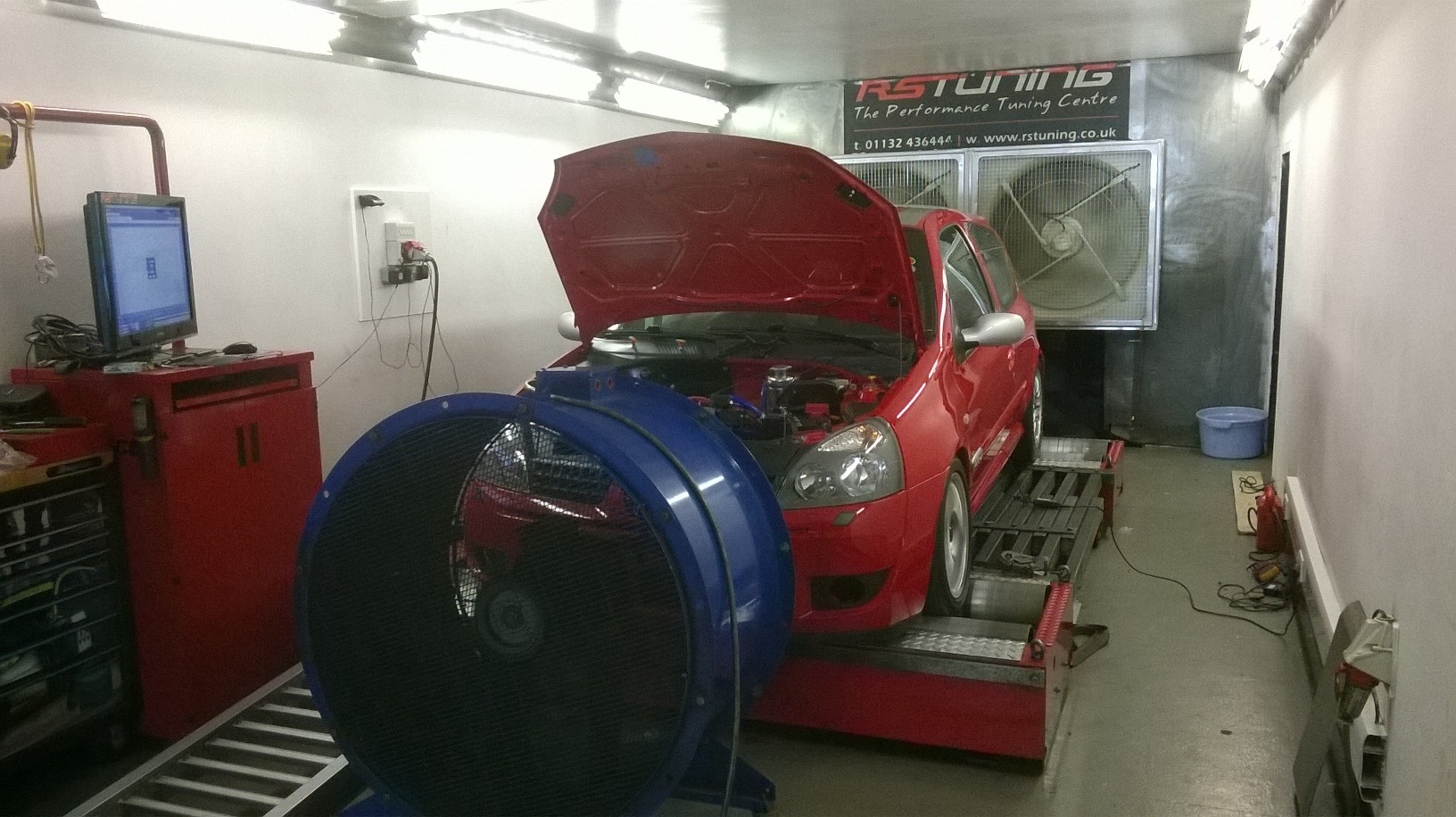

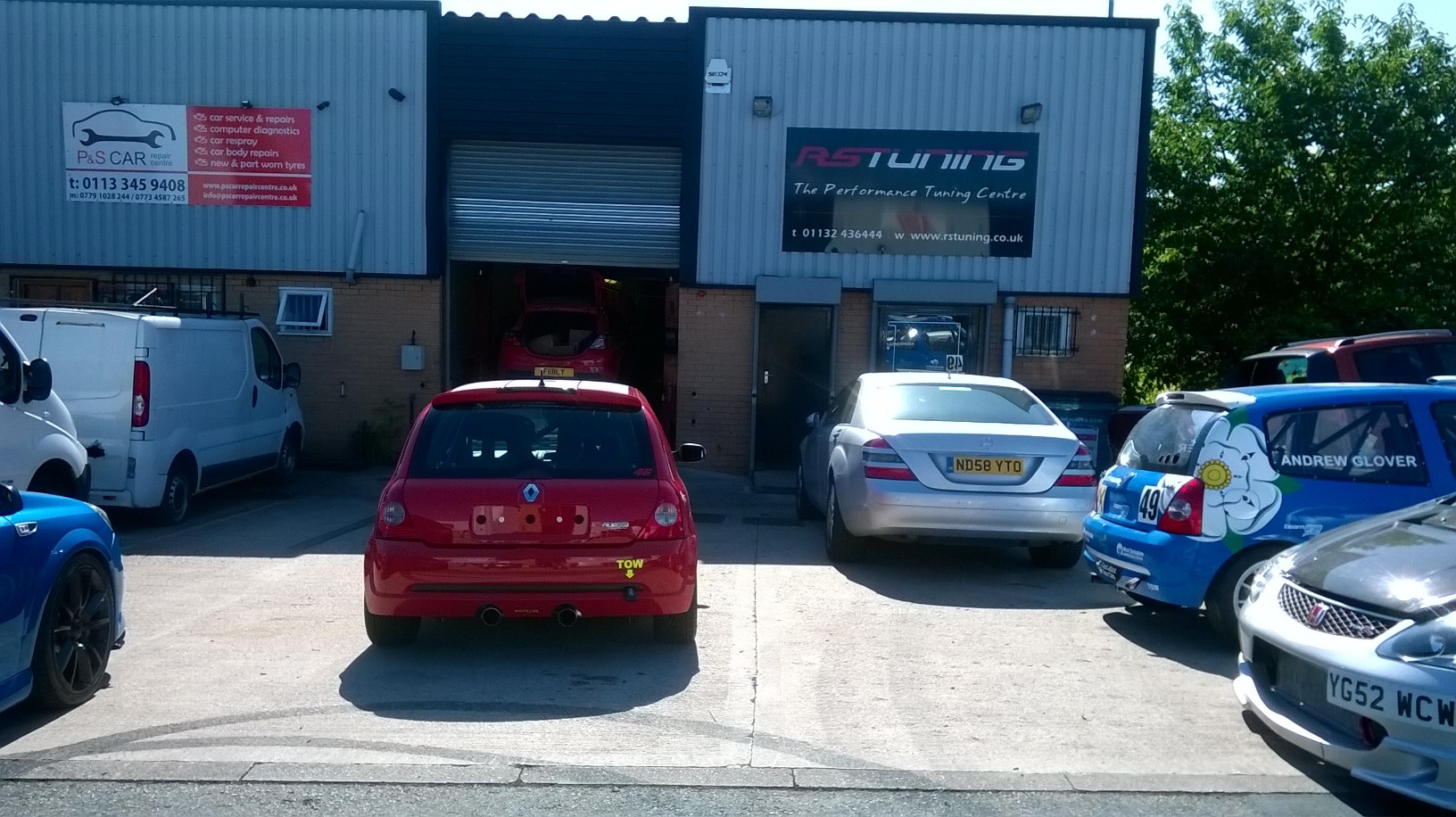

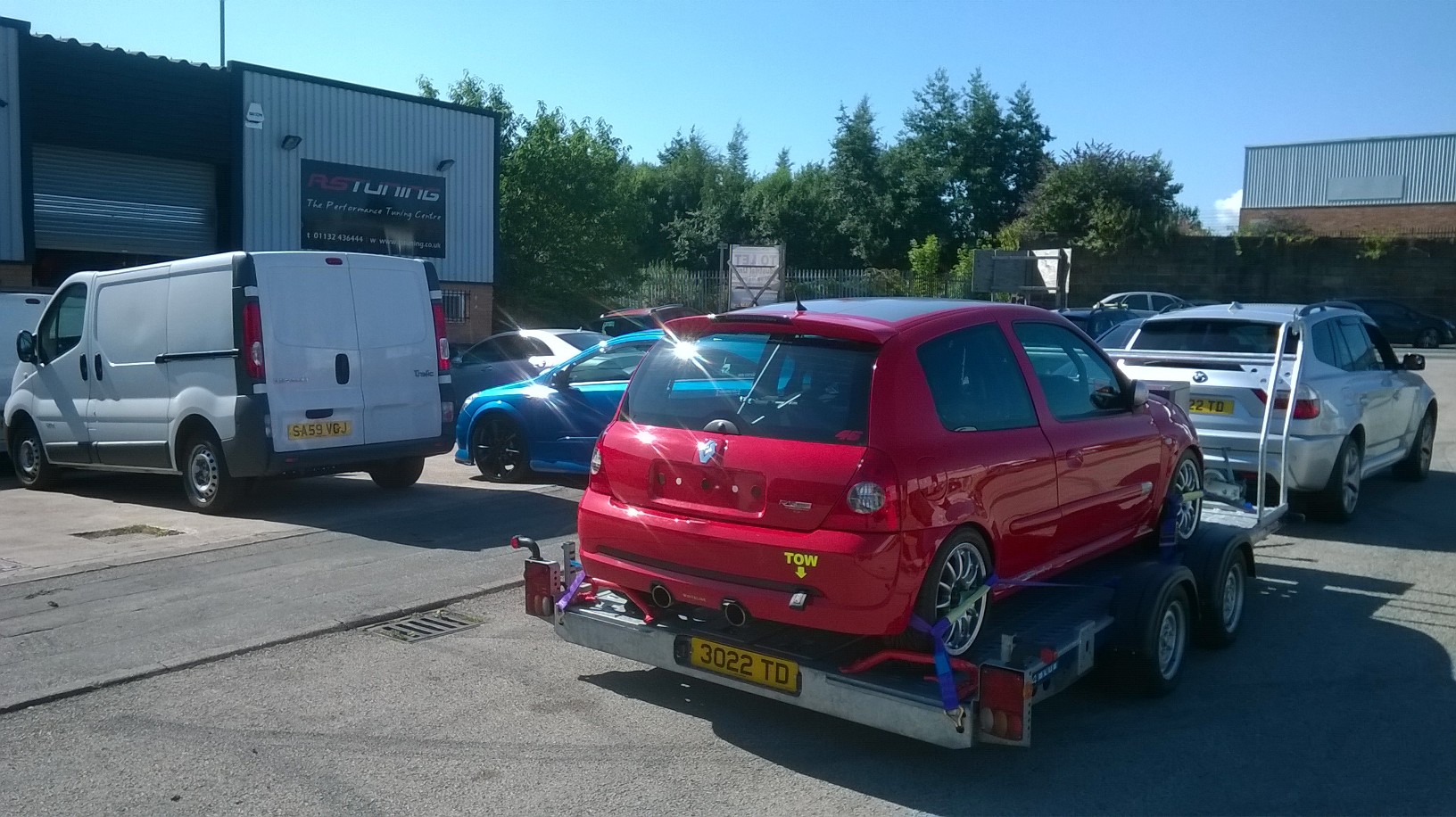

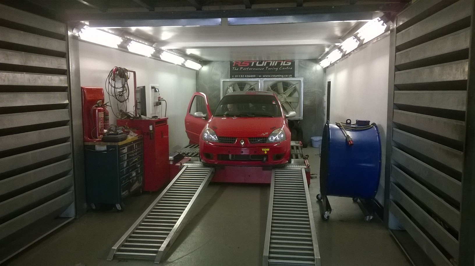

Up at 4:00, showered and set of by 4:45, a little tired but still excited about the day ahead! arrive at RS tuning at about 10:30
Started off very poor at 182bhp.... Paul & Andy couldn't understand it, after analysis, which included a compression test (which was all good) only thing left to check was the timing, which was out........ Major thanks to them for taking the time to do this as it would have been a 12 hr round trip for nothing if they hadn't......
spent 2hrs resetting it and its on the rollers again and straight up to 190 & mapping starts again............... although things still things weren't going to plan... (beginning to feel like another Life and Times of a Trophy at this point, sorry Andy, couldn't resist - @SharkyUK )! The car seems to level out after 6300 rpm!! Paul couldn't understand it, every thing seems right, the spec means 200 comfortably and we are all scratching our heads! As a comparison they put a high compression build they are doing on the rollers with the a similar spec. it has cat cams of equivalent spec to my Piper 285 cams.... and the same spec ITB's from K tec, it just had the high comp internals.... anyway he ran that, overlayed the graphs and from from 0 to 6300 revs mine and it were almost identical bhp and mine actually had slightly better torque! then it just starts to flatten with the high comp going up to 198 bhp at the high revs.....!!
By this time between tiredness, sheer frustration and just generally getting pissed off I had just lost my enthusiasm.....😞 but Paul was sure it had more to give!
Any way he ran it quite a few more times and with no improvement, as hes starting to look as frustrated as me, he opens the drivers door to talk to me, as he let off the power, and when free wheeled down his rollers quickly stopped.... looking conused / concerned he got out and started feeling my wheels which were getting quite hot..... we found the found the brakes have been binding binding on!!
As this is now nearing 5pm, time is not on side at all, we give it a little while to cool down, stick a bar in to squeeze the drivers outer pad back and he gave it another run, 196.2 & the passengers are still binding slightly and no doubt the inner pad is doing the same...., also the car is roasting as its had a fairly long time on the rollers........... Any way a maybe something salvaged from the day, but I'm still a little hacked off, but 196 with binding brakes maybe means it has a little left....................??????

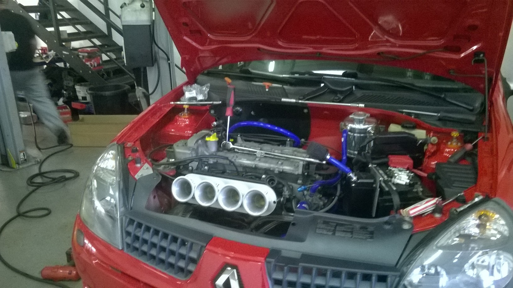

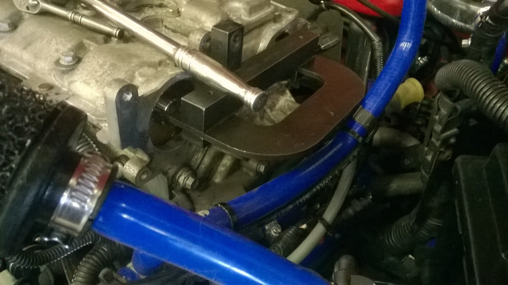

Morning of pottering with the Clio :smile:, as the ITB bend extensions wont work with the Jenvey filter, I trial fit everything, and enlarge the grille cut to let more air into the filter since its not sitting directly behind the grille any more....... you'll note the blue silicone breather to match the forge hoses and the new ram air breather filter too
