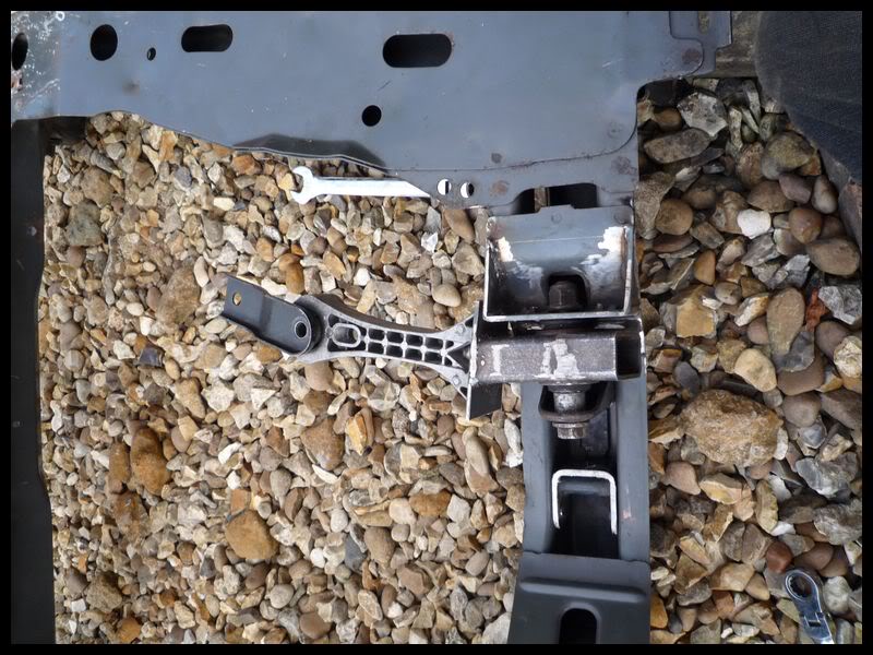

I finished this 3rd engine mount a little while ago and I've spent some time wondering whether i'm happy with it or not.:rolleyes:
The problem with it becomes clear further down.

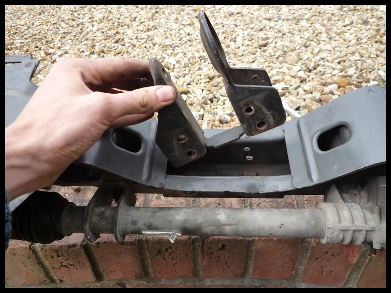

Firstly. The bolt holes for the VAG dog-bone are further over to the N/S of the car. This means I needed to move the mounting for the dogbone on the subframe over to the N/S

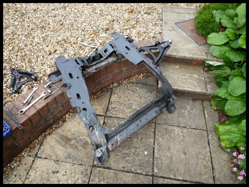

Subframe out (again)

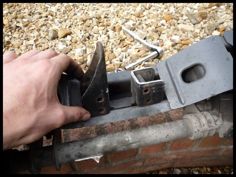

Remove the Renault Dogbone support.
Grind the bit that I don't need

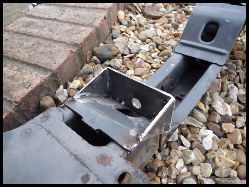

Then I spent some time grinding the Galv off the subframe and welding in a new support for the dogbone mount.

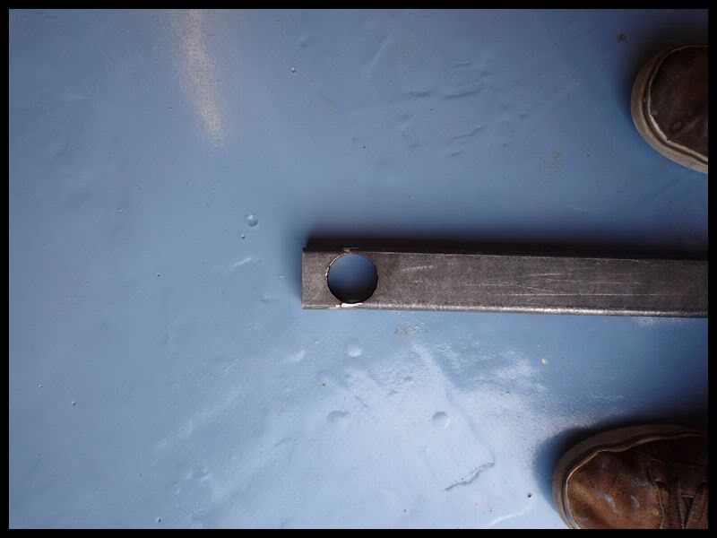

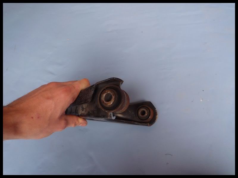

Then, I started with one of my old valver wishbone bushes,
Chopped it out.

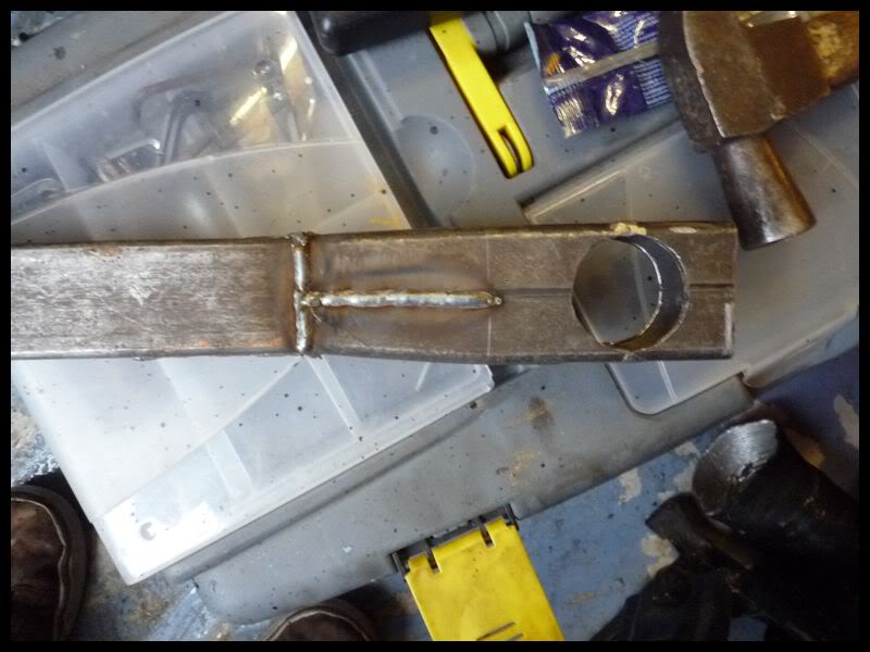

I then needed to mount this into some box section. I couldn't think of any other way of getting a 40mm diamter hole through my 3mm wall box section. So I used a grinder to cut a half circle profile in two bits of box section and welded them together in the middle. The result was a little better than expected. It's a friction fit in there and needs drifting in and out with a hammer.

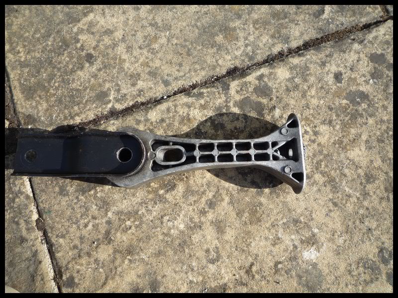

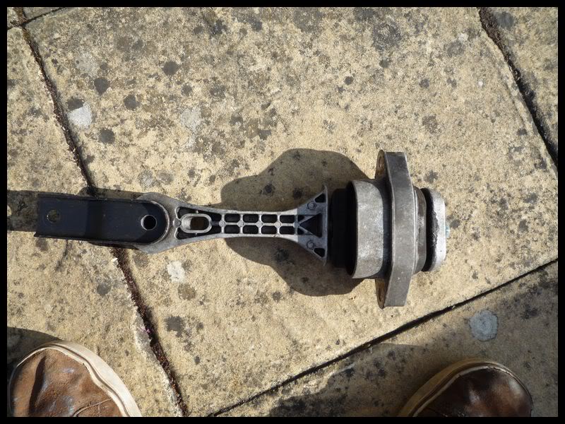

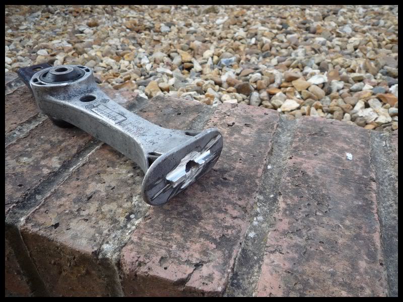

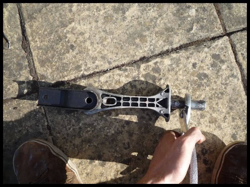

Then I turned my attention to the VW OEM dogbone mount.
The Left mounts to the underside of the engine and the right to the subframe on a standard Golf MK4
Remove the bush on the right and your left with
Remove some more and your left with
Leaving the locating lugs from the original casting, I did this:
Eventually Left with this

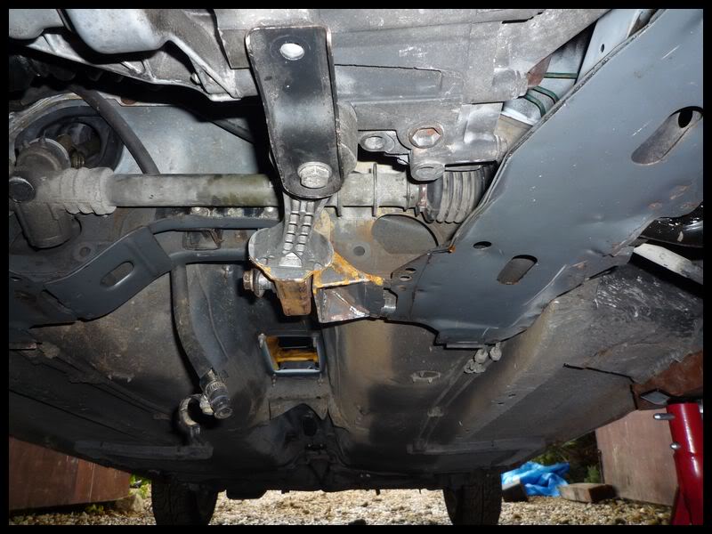

I'll get some pics of it from under the car in a tick.

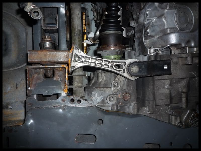

Problem
My problem with it, is that it's had to be bent to meet up with the engine correctly. This means the engine will be pushed side to side slightly by the dogbone under accel/engine braking. I've not decided whether to ditch it and go for a different one yet but I'm happy with the positioning of the engine.

Heres the pics of it fitted.
I've also been trying to shift the engine with my foot on the sump to try and stress the dogbone. There is a very slight shift of the engine transversely which the other 2 engine mounts can't really resist. So I'm now thinking I might have another go.....but that's ok, as i've had a really good idea. :D

looking good, but i wouldnt be happy with that angle myself. It may well work but it would bug the f**k out of me knowing it could be better!

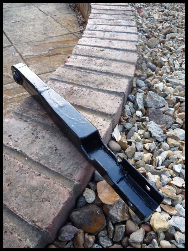

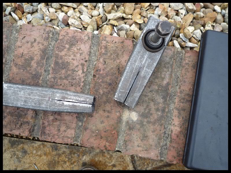

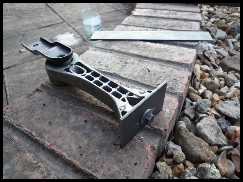

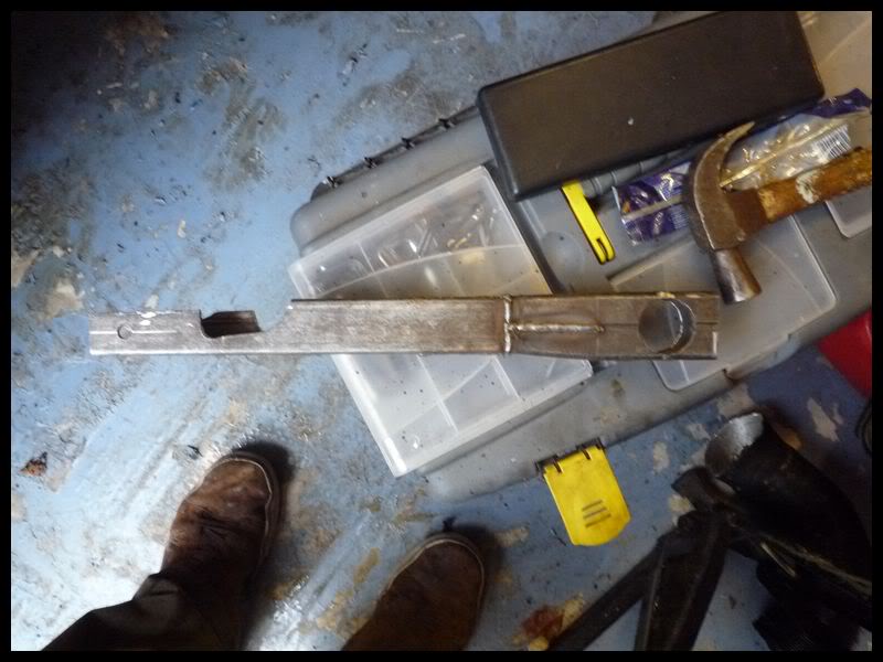

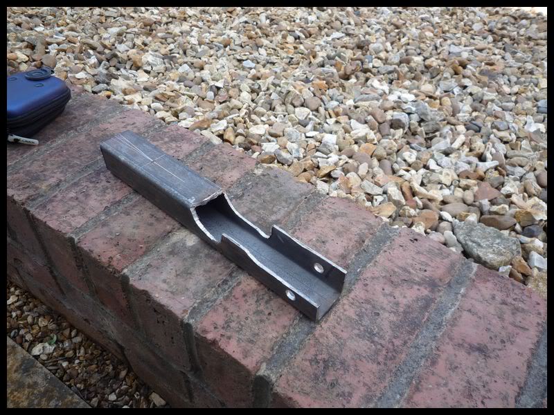

Just wasn't happy with the last dogbone mount. What with the angle it was at, the extra lateral leverage on the other engine mounts caused by the adapters etc, I just decided to start again.
New mount is essentially a f**king girder. It will allow less engine movement which will make the car pretty harsh, but easier on the downpipe/boost pipes.

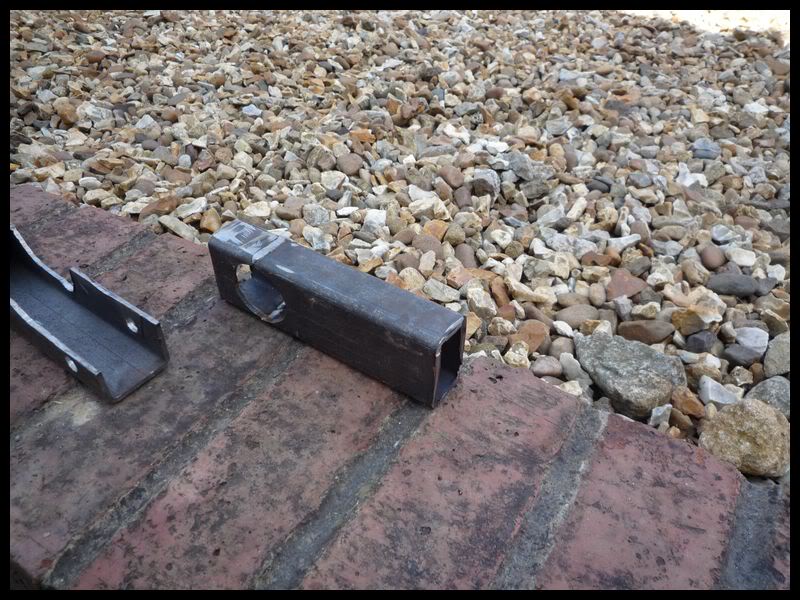

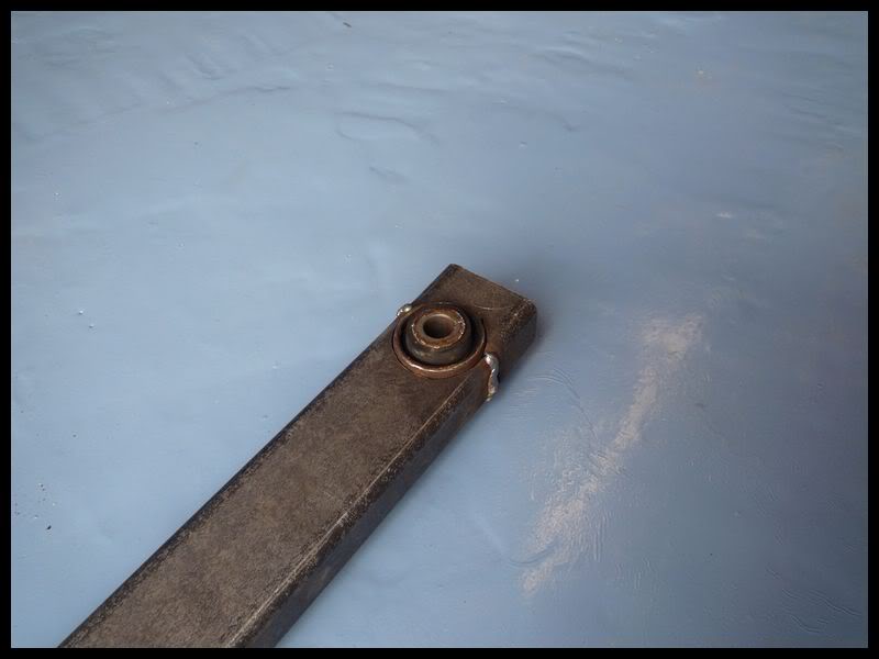

Started out the same:
Then made this bit that bolts onto a stirdy looking lug on the gearbox.
The two box sections used are different. The one for the bush is 50x30 and the one on the car is 40x40. By taking 10mm off one side of each (making 40x30), i managed to join them together pretty neatly. I was pretty pleased with the results.
Sprayed up and extra strength welded in at weakest section

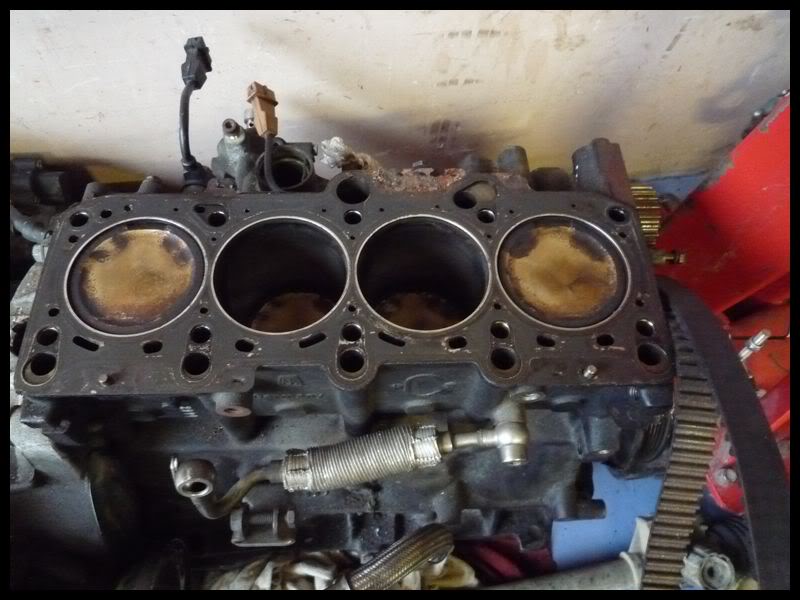

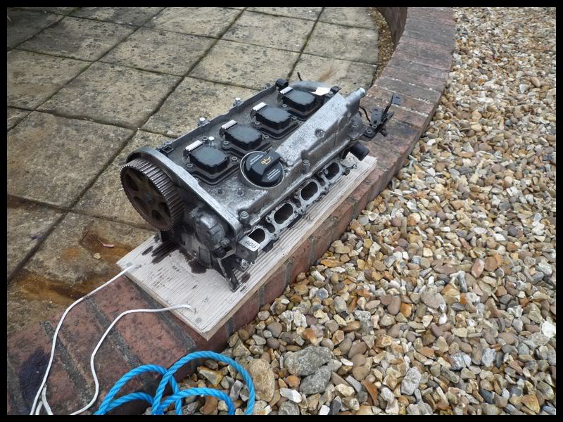

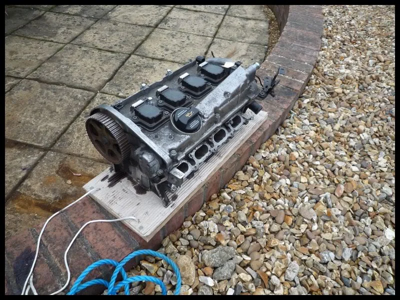

After that was done, I needed to remove the head to take to my fabricator to have the manifold made. :cool:

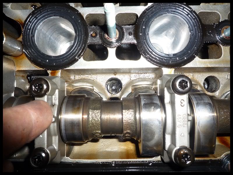

Pulled the engine out and removed the rocker cover.
The head bolts......looked a bit like torx, but could tell they were different.
After some detective work I found out they are "Ribe".
Going to need to grind up one of those to get the torque right when I refit.
10 head bolts out and the head off. No bent valves and an entact headgasket from what I can see. All looks good
all looks in order, little carbon deposit, no more than expected

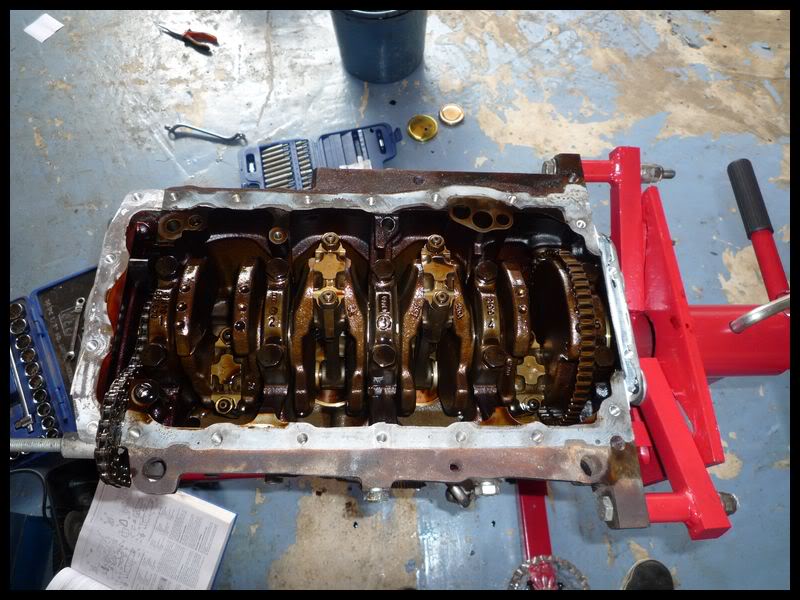

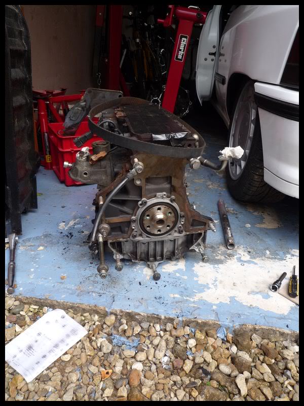

Next, the bottom end.

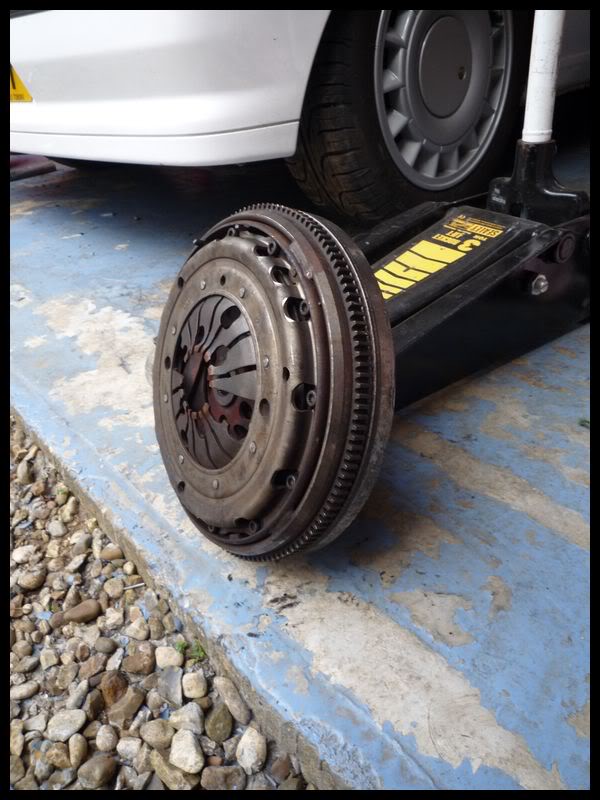

original clutch coming off:
Clutch
20vTurbos come with a "dual mass" flywheel as standard. I still don't quite get this, but it means the flywheel has to be replaced with the clutch. Everyone recommends a G60 flywheel (which I am still looking for).
As for a clutch to go with the G60 flywheel, I'm after something that will take 340lbft so hopefully it will withstand the limit of the turbo's capabilities. I rang Helix (who are just down the road). They quoted me £470! This is not something I can afford. A mate put me in the direction of CG clutches who will do a paddleclutch for £266. I've got no idea if they are any good and I'm tempted to just stick a VR6 clutch on it for the min (they handle around 280lbft).
Bit stumped there.

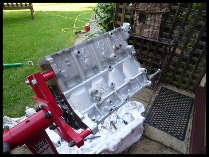

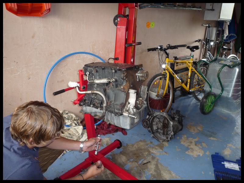

Finally got hold of an engine stand, Ben helped me out having the sump off.
Pleased with the condition in the bottom end

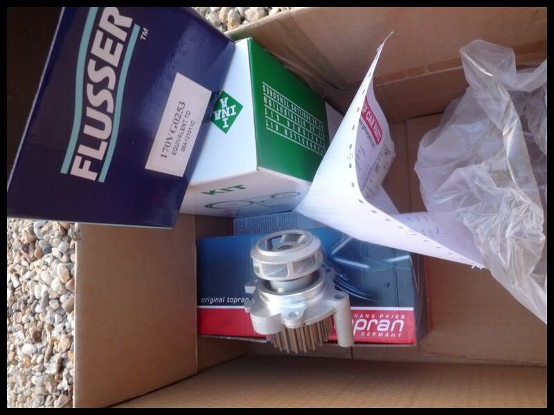

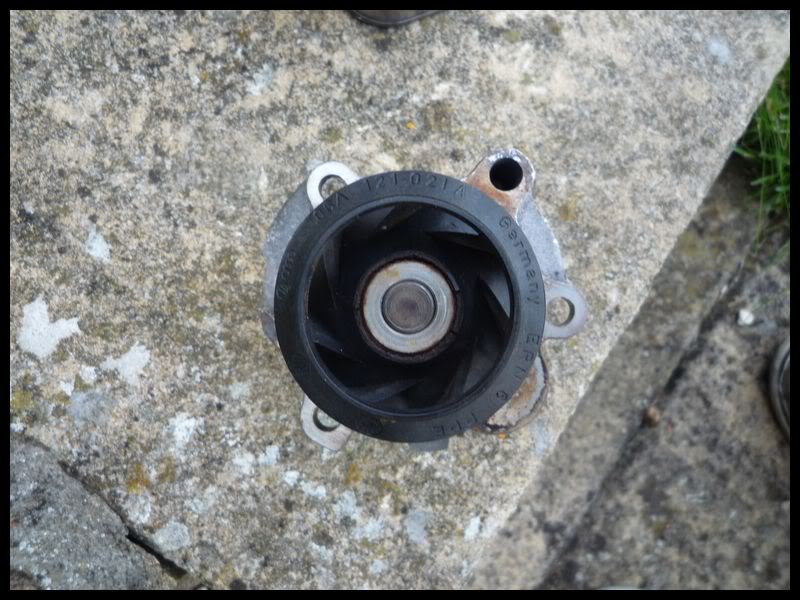

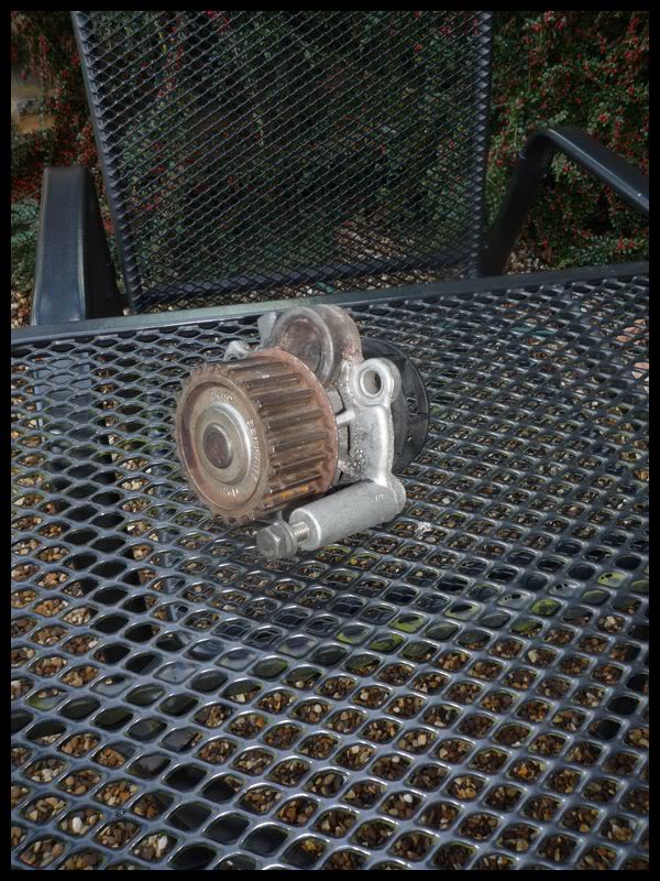

I removed the old plastic impellor waterpump, which was starting to fail (second pic)
Painted the engine up. Nice sensible practical colour ;)
Got a little box of bits from GSF (oil pump, new metal impellor water pump, cambelt kit, head gasket kit) still some more bits to source, will probably have to go to VW.

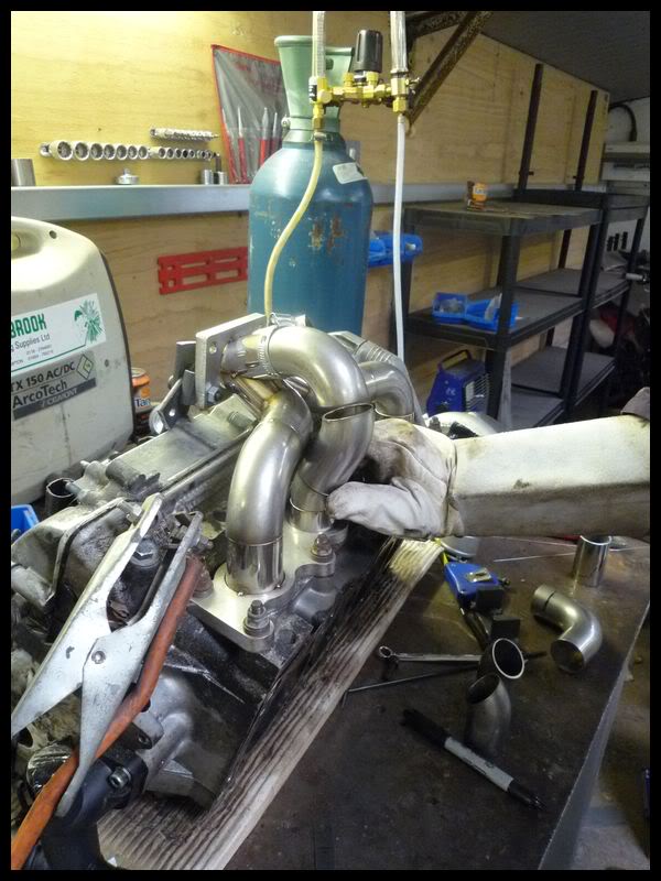

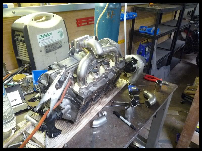

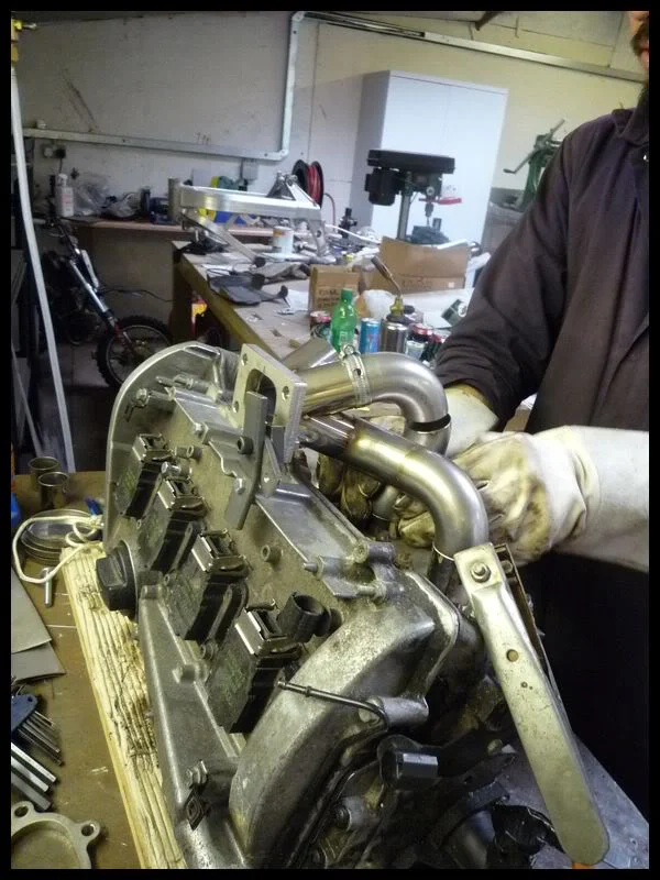

Heres the manifold progress. He's just getting the lengths equal and tacking together before breaking it up, polishing the metal and welding it up.

The guy is a legend and can near enough anything, especially if you can find an engineering drawing of the flange. Me and the guy making the manifold spent along time deciding on turbo position. It's quite close to the bonnet (rain catcher will probably have to go), bulkhead clearance is fine, and yeah, I'm pretty close to the brake master cylinder too, but the manifold and turbo clears it easily. The brake lines are further down the bulkhead and they won't see most of the heat, and i've got a RSi heat shield guarding them all (no idea where i got that idea ;))
It's a GT28RS, but due to lack of cash it'll only;) initially be running tops of 270-280bhp as I can't afford pistons (to drop CR), rings, bore hone, etc etc.
I'm actually going to leave the BE stock for now, which is a shame, as I've already got rods.
I'll PM you a price on the manifold. It's fully back-purged, guy has many years experience welding for Prodrive, he's based in farthinghoe (just up the road from brackley) so not too far from you. Mine should be done by wednesday.

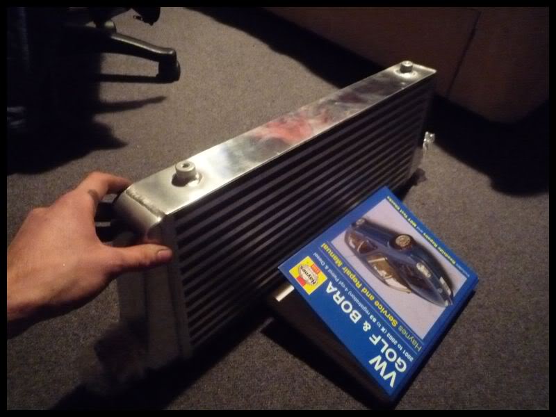

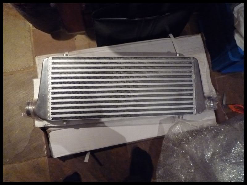

This turned up today:
Anyone who's interested in the size, give me a PM. It's about the biggest thing you can realistically get behind a MK1 bumper. The bumper is still going to need a little modification (but then what the f**k doesent on this project). I'll be mounting it this week sometime with a bit of luck.
