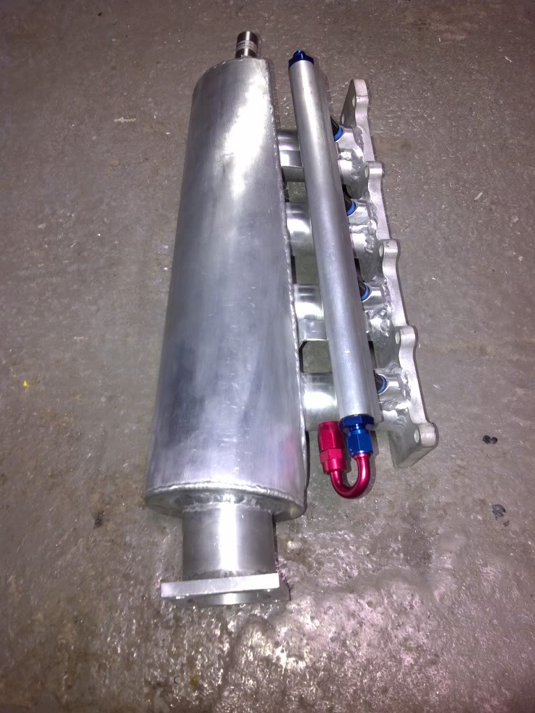

After having looked into inlet manifold designs when making my own, now that's its made I can easily understand how it can cost £700.

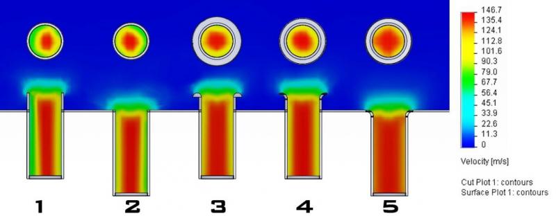

The plenum design is as important as the size and the trumpets should be raised off the back plate and not flush. The air velocity is faster in this area and flows better. It also increases the runner length without making the manifold any longer. I opted to retain the standard bonnet catch so kept the runners short on mine.

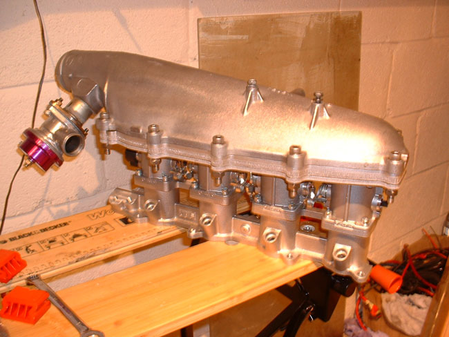

All F1 inlets, BMW M engines and ones from cosworth, skunk, AMS, ect all have raised trumpets. OEM is purely for cost purposes, not for optimum performance. Why do all these companies and design have raised trumpets if it is detrimental to the flow?
Skunk inlet
Can't find a cutaway one of the Cosworth D power inlet.
Most F1 inlets I would expect to have trumpets becuase of the plenum design and pulse tuning runner length.
Only way to be sure is to do full flow analysis of both on the final design.

Another point that I had a lot of head scratching was the location of the injectors. I read up on loads of conflicting stuff but ultimately the F1 guys know what they are doing. They have the injectors spraying directly into the trumpet parallel to the airflow. I tried to work out a way to do this but on the design I had gone for it would not have been easy or even possible.
If I was to look at redesigning it, I would go for this method but it would involve a far more complex design.

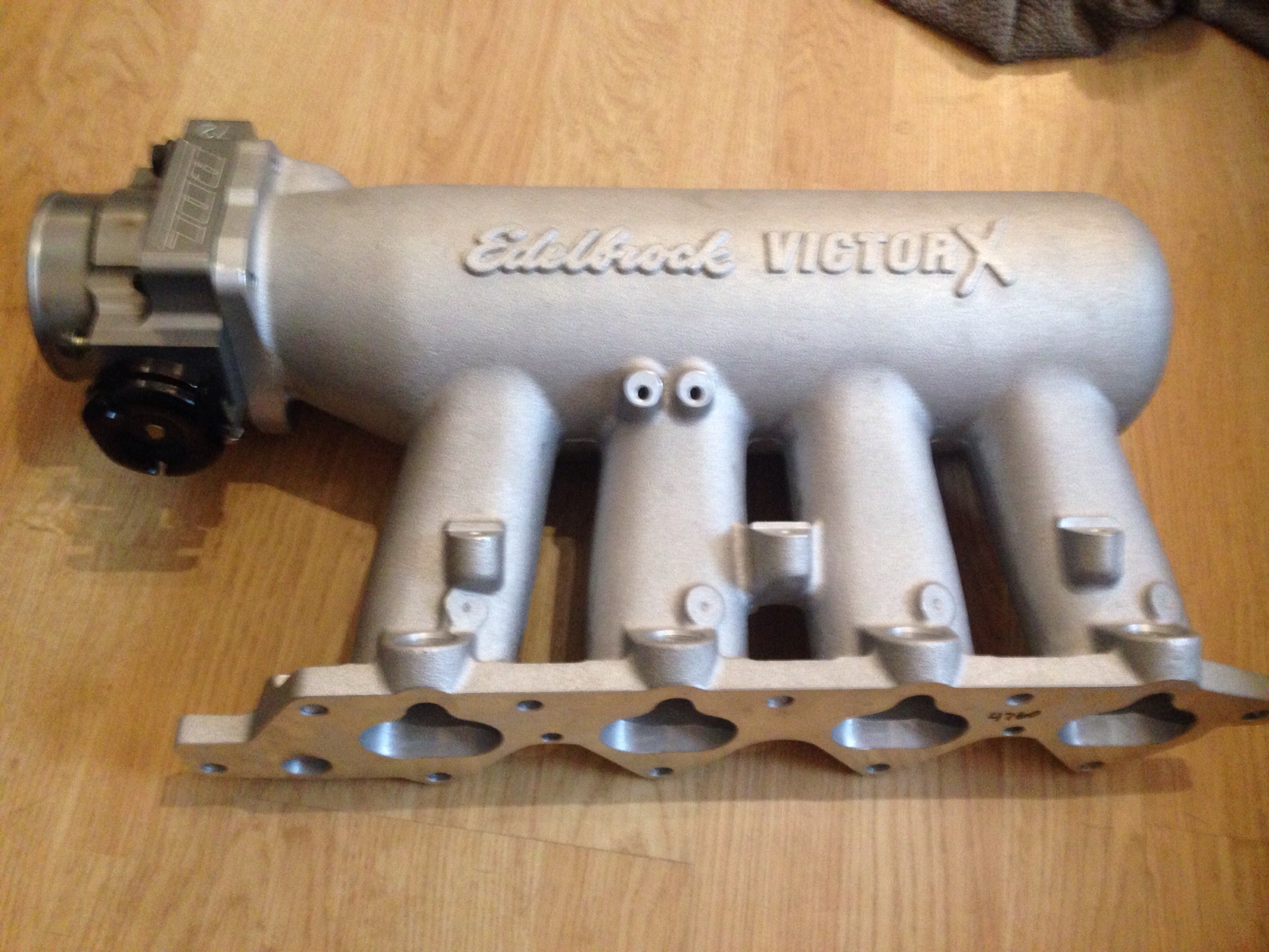

Is that for a F4R head? Looks a good piece of kit but the injector cut outs on the flange won't meet up with the head. Out of curiousity, does this have flush or raised trumpets?
It's a Honda one I've bought a f4r flange and going to chop and weld it on. Injector bosses welded into the runners or just use the other 4 that are underneath. It's got flushed trumpets
