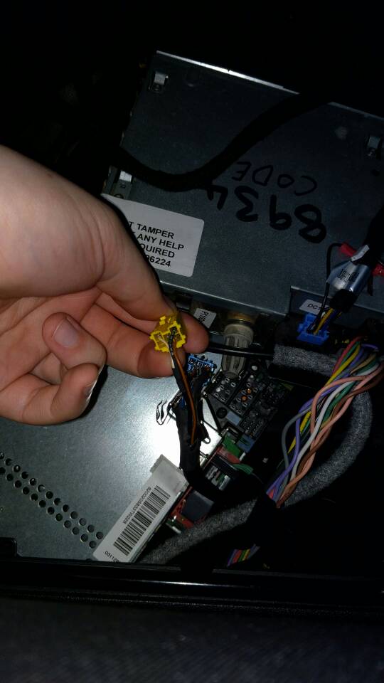

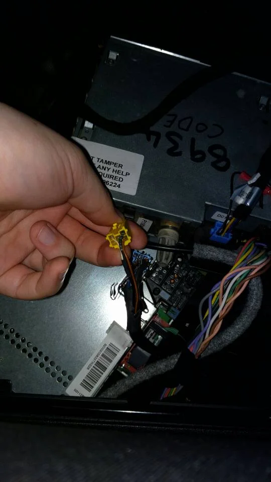

So I'm getting closer.
Got the stereo working with the standard loom and the Bluetooth in. Hooray.

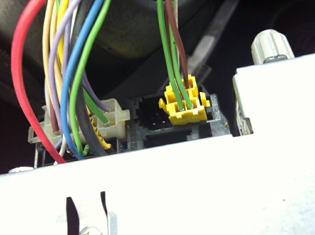

Issue now is that the clock works, but there's no radio display or stalk controls which I believe are both controlled by the yellow plug. My yellow plug looks like this:
And the 197 with update list from factory looks like this
Any suggestions welcome. Think I'll take the dash off at some point and have a look.
welshname
On second look there seems to be the right colours in the loom that went between the headunit and changer. But that's no use as its not connected on that end

So a little bit of progress but in reality a back step.
Had another fiddle around last night with the stereo setup to try and work out what does what.
The yellow connector that controls the dash and the stalk controls in a 197 that comes with and Update List stereo seems to control the inputs from the CD changer on the unit I have. The stalk and display are controller by a separate connector that's specific to the CD changer unit.
For now I've gone back to the standard setup as I'm away in the lakes this weekend and wanted to be able to fiddle with the stereo without pissing around under the seat. I've put an email in to a local mobile auto electrician explaining the situation and I'm waiting to hear back from them. Fingers crossed they can sort it for me.
My advice at present is to not bother with this as it's an arse ache. But as I've come this far already I'm going to carry on and hopefully be able to show everyone what the electrician has done so it is possible for others to replicate in future by splicing looms etc.

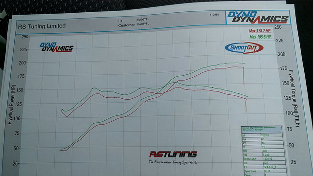

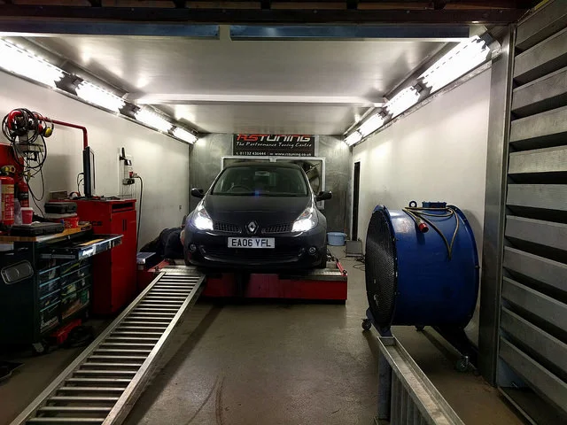

So went to RS Tuning today and had the car mapped. Paul said it was the worst flat spot he'd seen from just a catback. Ended up with a decent gain and the car is SO much more driveable now.
Before: 178.7 BHP
After: 185.6 BHP
Not sure what these usually run but Paul said it's about right for them. He also said he thinks the timing might be out a little but it doesn't look like it's affecting the power at all. He was fairly happy with the BHP increase too.
Clio 197 On The Rollers
by Rhys Bartley, on Flickr
197 Dyno Graph
Can't recommend getting this done enough.
