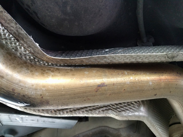

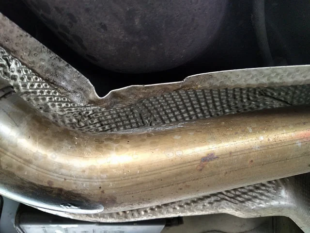

So I figured that after hearing a knocking from the exhaust towards the rear of the car on overrun I'd have a look today, seeing as I also wanted to set the exhaust clamps so they weren't hanging down and catching on speedbumps.

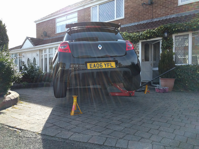

Car jacked up:
High Enough?
by Rhys Bartley, on Flickr

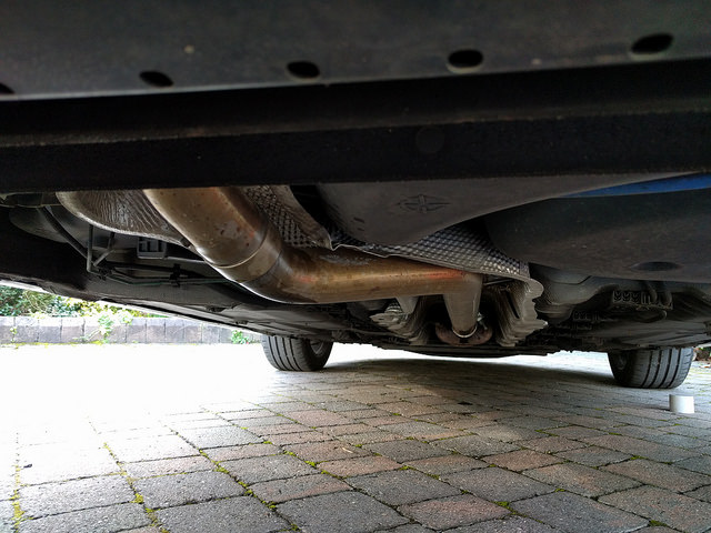

Got under the car to be greeted by this:
Exhaust Knock Found
Bit of forcing with the rear end of my ratchet resulted in this:
Exhaust Knock Fixed

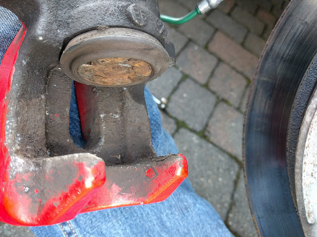

Next on the agenda was to figure out what was causing my rear brake to bind. Span both wheels and the drivers rear spun freely, but the passenger one needed some force. So took it all apart. Turns out the piston was pretty much stuck and wouldn't go back in any further. So after a lot of force I finally got the piston to push back all the way and it seems to move freely in and out now, but I'll look to refurbing them when we have some slightly more consistent weather.
Rear Piston
Then adjusted the handbrake also as it needed doing after I'd free'd the piston.

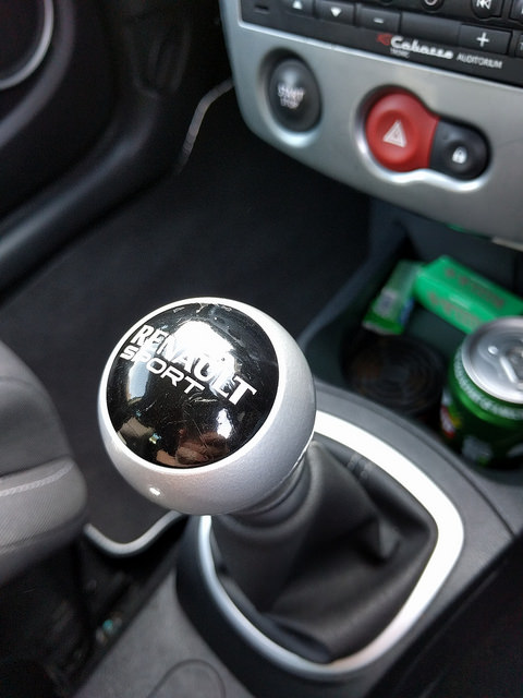

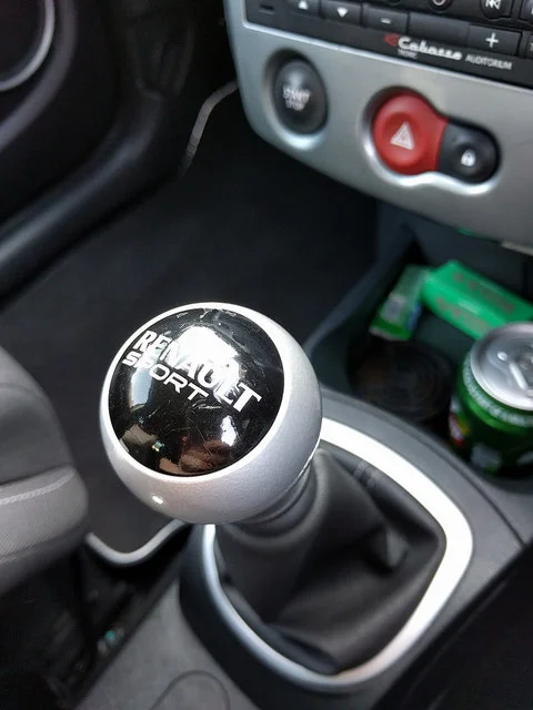

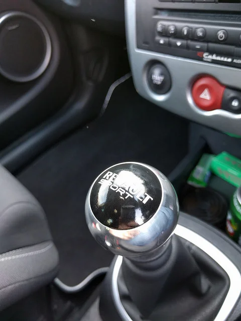

I think I mentioned this earlier in the thread but I was really unhappy with the quality of the gearknob I purchased. It looked like the insert had been wrapped in plastic whilst the gel was still wet, and I didn't really like the painted finish either. So I got in touch with the seller on eBay and they offered to send me a replacement with no painting.
Old one:
Old RenaultSpot Knob
New one:
Shiny New RenaultSport Knob

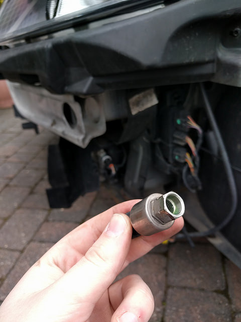

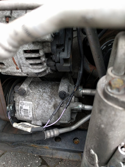

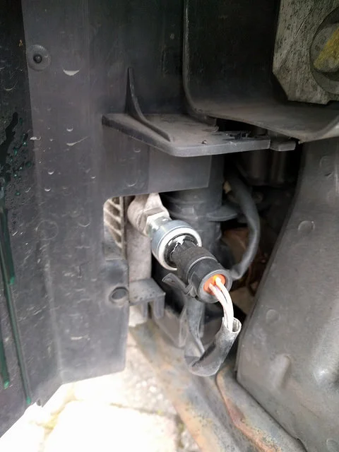

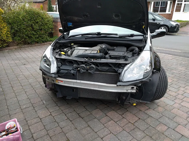

As the weather was hot recently I discovered that although my AC says it's working, it's not. It's got the common "cold loop" problem. I figured it would be the pressure switch originally so I set about changing it.

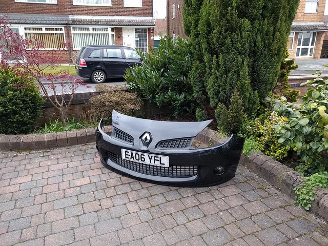

First off was removing the bumper. I don't know why everyone has said it's a nightmare on the Mk3 as it's really not. Probably easier than Mk2.
Bumper Off
Bumper Off 2
Old one out
Old Pressure Switch
And new one in. Stupidly easy job.
New Pressure Switch

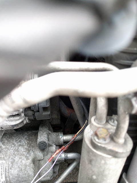

I also noticed the wiring to the compressor has been crimped and it was looking very corroded in there so I replaced the crimps and heat shrunk it.
Corroded Connectors
Re crimped and heat shrunk
Unfortunately to no avail. Turns out it's probably the connector on the compressor and Renault have a recall for it. Checked my blue sticker under the bonnet and looks like mine hasn't had it yet. Going to ring them and see what's what. Hopefully get it working again.

So...to update.
First off the issue was actually corroded CAN wires down behind the back of the fuse box. These eventually broke and this is why the car wouldn't start again. All these were fixed on Thursday. So Thursday evening I collect the car. No issues and even my aircon had started to work again...result!

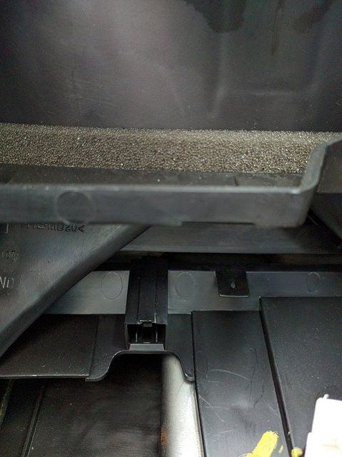

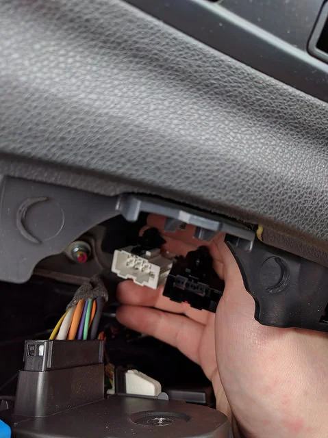

Then I went looking for the stalk control plugs which it turns out is completely un-used by the CD changer setup and is plugged into a plastic blank in the top of the dash behind the climate panel seen here.
Stalk Plug Blank
So with that all I had to do was extend the aerial (badly) and wire everything in along with the xcarlink bluetooth handsfree adapter I purchased just before I bought the car.

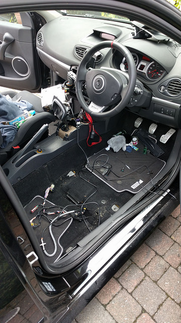

Took the driver seat out and started to try and hide all the extra wiring as all that was now needed there was the airbag plug and the aerial. As you can see there are a LOT of extra cables now I've removed the CD changer setup, luckily they all fit under the carpet where they come up from as there's a large void there.
Extra wiring
I ran the aerial extension under the carpet where the join is, along the centre console area and up into the dash and back out where the stereo is.
All back together again

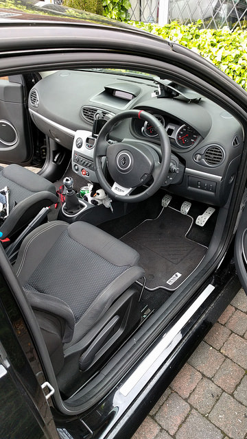

So everything works and all you need is the non CD changer stereo and an xcarlink adapter. Stalk controls work and everything which I'm pretty impressed about. Only issue I've got is that I could do with sorting the connections properly as I've butchered them so far with adapter I've got from when I routed the sky aerial but they are too loose and I get a lot of crackling. I'll order them in the week and get those sorted, really simple job tbh.
So yeah this is it all finished
Non CD Changer Stereo Installed

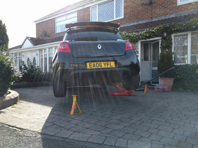

Sorry to hear you're having so many issues mate. One question though. Can you explain this pic??
How is the rear being lifted when the jack is at the front and the axle stand isn't even touching the car? I'm baffled.
The jack is at the rear jacking point lol. But the chassis is very stiff. The drivers front wheel is almost off the ground at that point too.
Stalk Plug Blank
