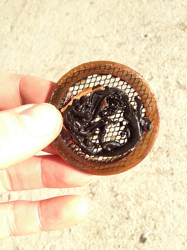

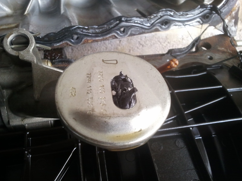

Rhys Beal Car ph1 172 Apr 1, 2013 #1 http:// Untitled by Rhys Beal, on Flickr On another note, how mush tension should the oil pump chain have? Attachments 8609434079_f9b3c80825.jpg 126.9 KB · Views: 111
D Dan@SJM Car 07969 124504 Apr 1, 2013 #2 Correction. "Why too much silicone shouldn't be used" The chain shouldn't be overly tight tbh, but it's not loose if you understand me?
Rhys Beal Car ph1 172 Apr 1, 2013 #3 I will concede your correction My chain feels fairly loose tbh. Around 12mm of slack
D Dan519 Car DON'T SEND ME PM'S!! Apr 1, 2013 #5 factory fit half the time. Every single one has the white/beige stuff in the strainer. That's had a fair bit more than necessary used though
Rhys Beal Car ph1 172 Apr 1, 2013 #6 12mm movement on the oil pump chain okay before I pop another sump on?
